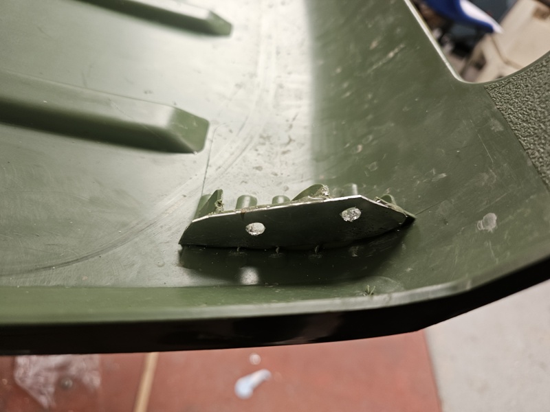

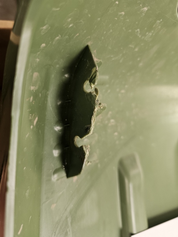

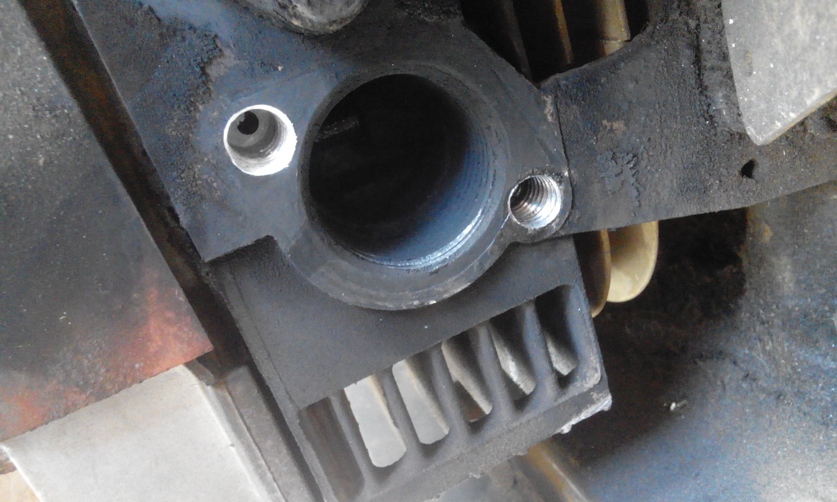

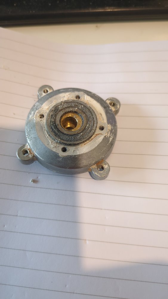

An Aldi Air Compressor Air Filter screw thread.
(Humbrol Polystyrene Cement, clamp and no saga)
Bet it's not polystyrene.
Not Polystyrene, but it is ABSBet it's not polystyrene.

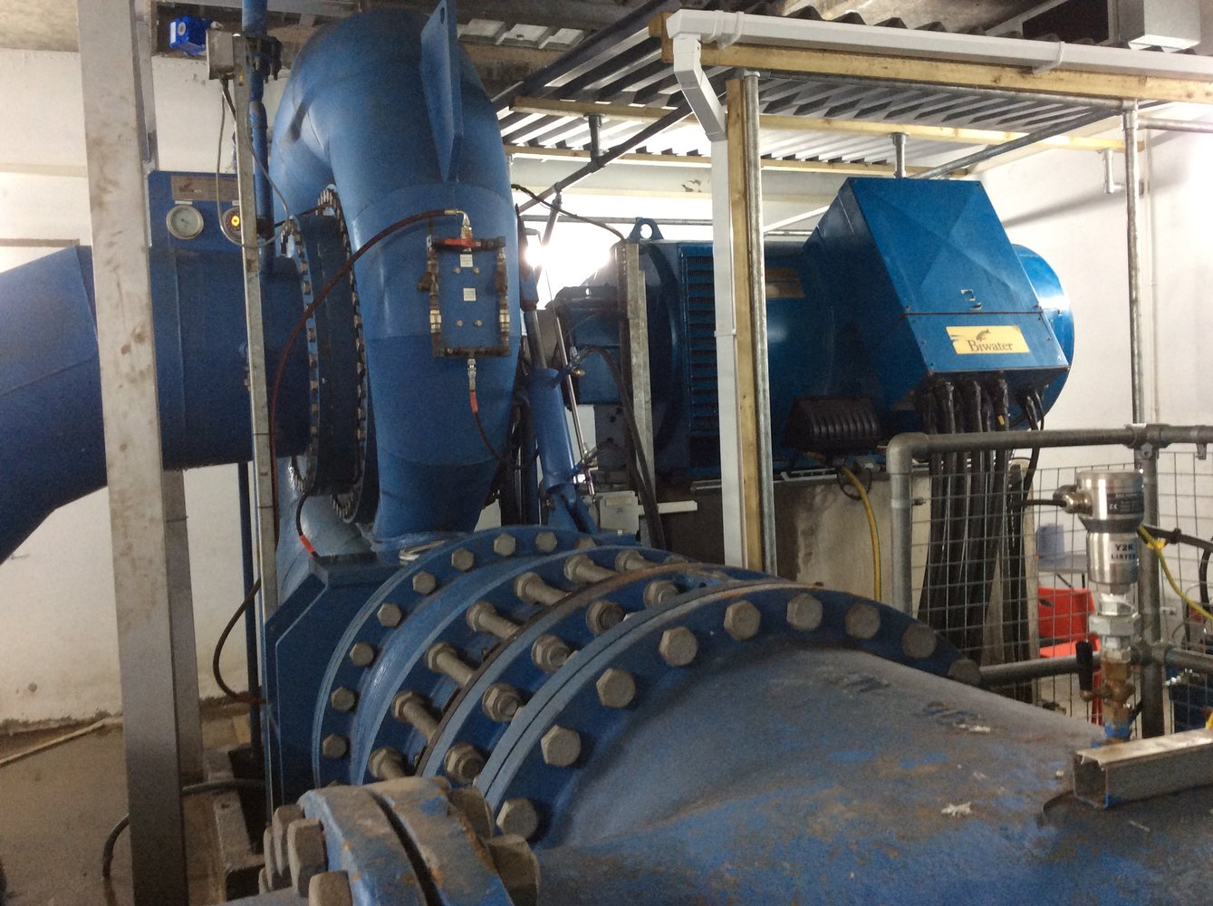

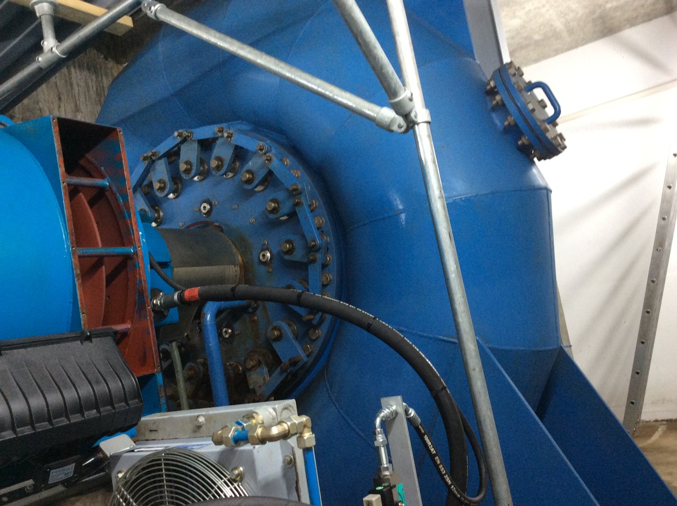

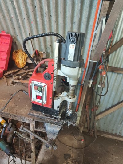

how many killerwatts would that beast be?!Spent the day down the hole, fixing an overoiling issue with this. Turned out to be because the cooling fan had lost a phase, hotter oil thinner oil, so the flow increased through the restrictor.View attachment 450304View attachment 450305

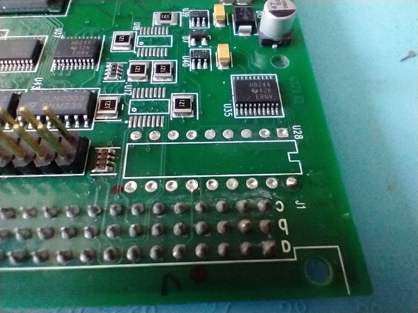

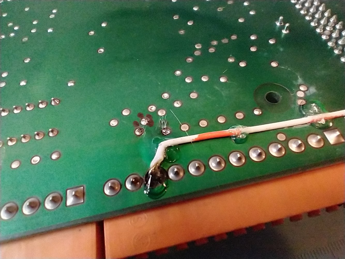

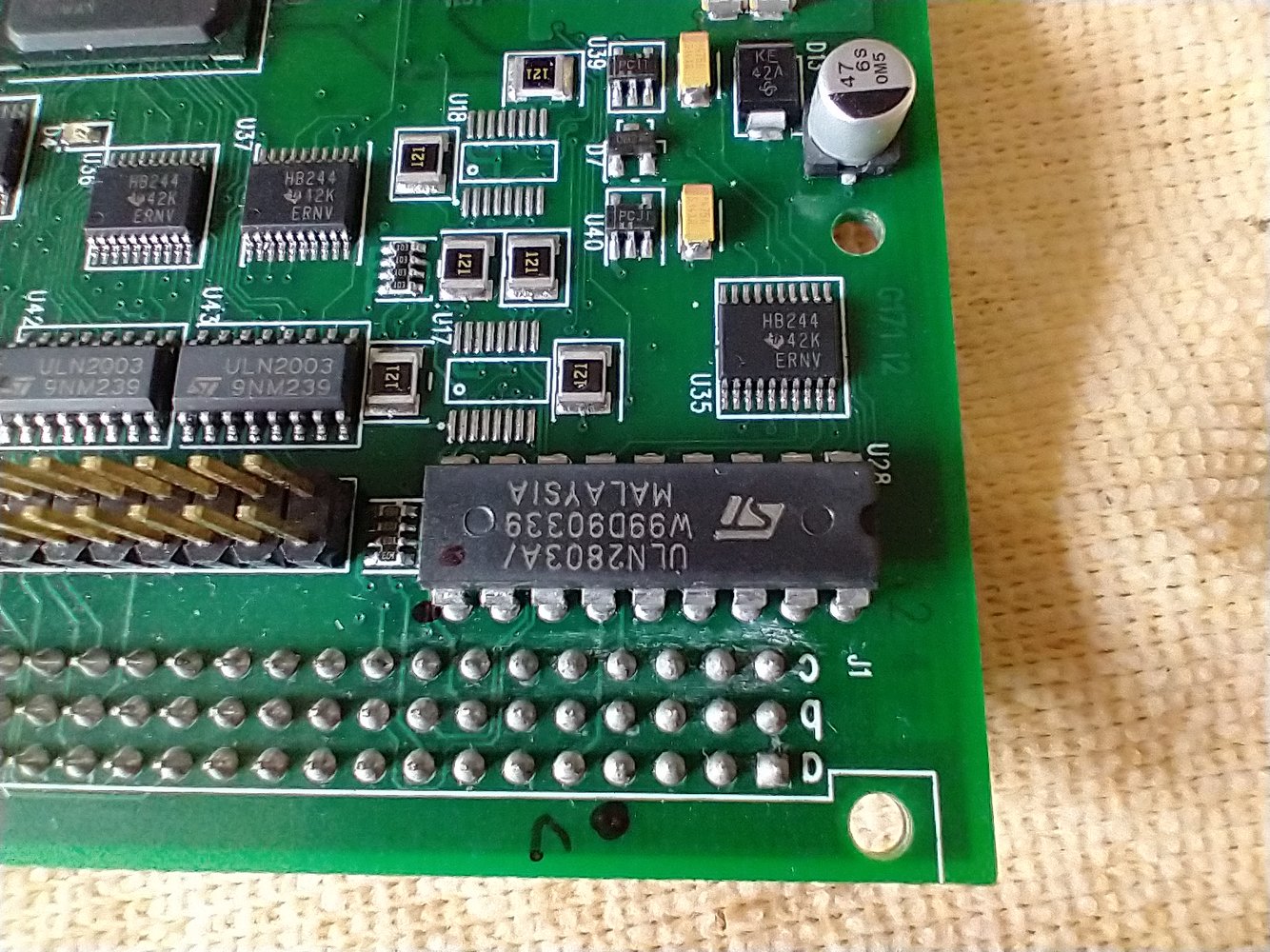

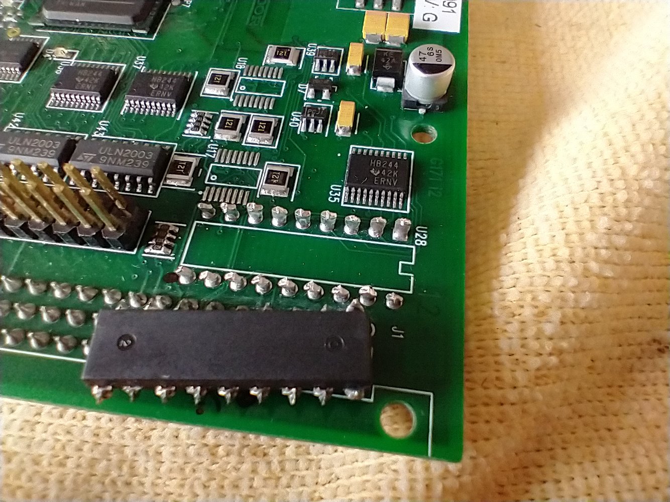

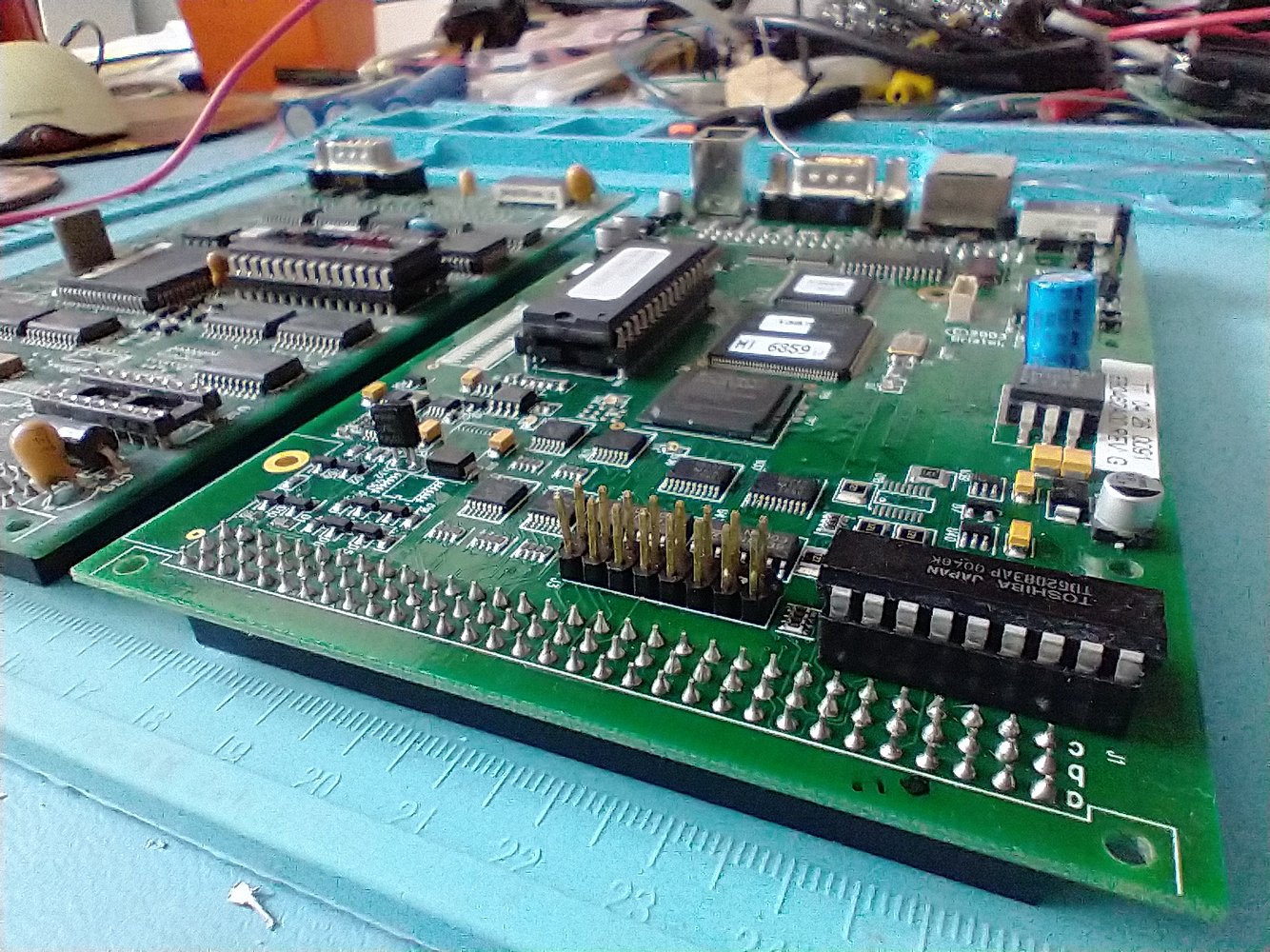

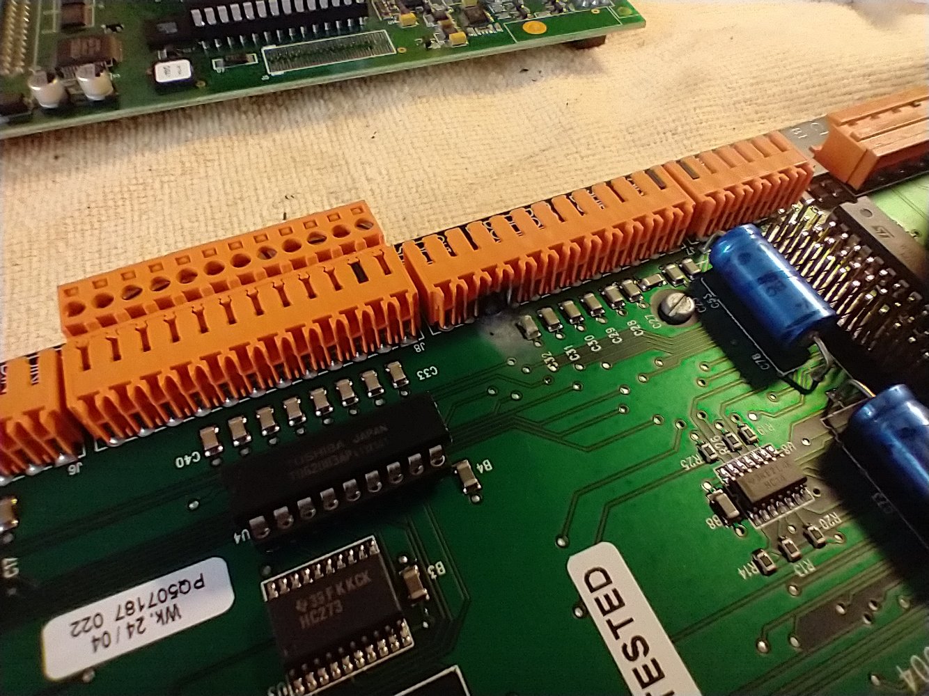

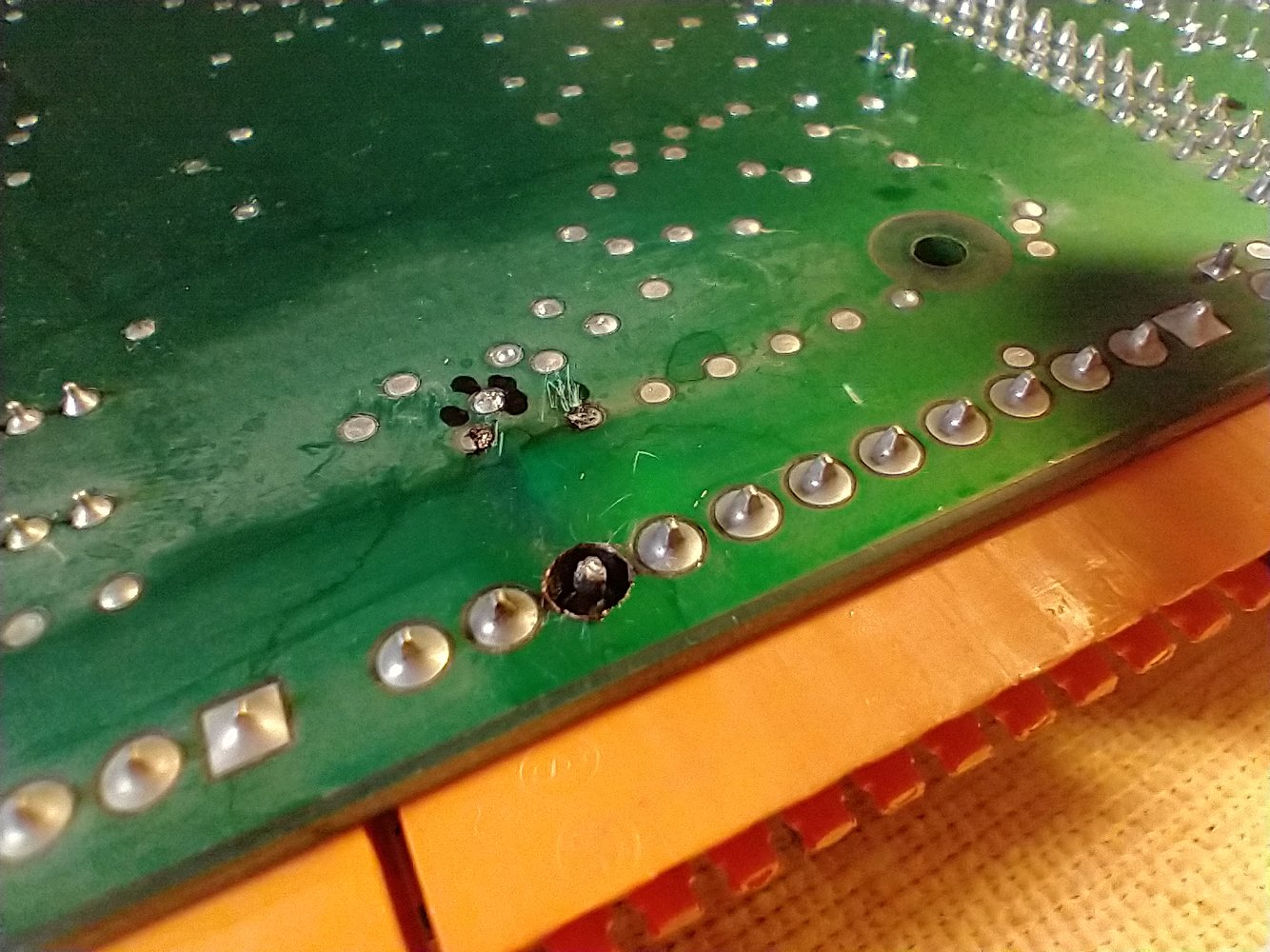

So after a bit more testing today it would appear the Power Darlington has had an unexpected thermal event in the past, shorting everything to ground - okay for the the outputs not so good for the pin I fixed as that is connected to +24V with no fuse. (It's just a path for the back EMF protection to +ve.)Whilst looking through the electronics cabinet of my new Denford Novaturn lathe I noticed a bit of melting going on
The common supply pin for the output pins didn't look happy.
Underside looks worse big blister where an internal trace has vaporised.
This was connected to an octal Darlington driver on a daughter board but I traced it to where it came through the 96 way connector.
There was 140 ohms resistance from driver to output pin. Made up of charcoaled FR4!
I scraped out the black stuff and connection was lost.
A bit of single core wire was used to make the connection it needs to handle 4Amps max as the Darlington can do 500mA per channel so it's a bit chunkier than the usual wirewrap type.
Copious amounts of super glue were added to give the pin some support.
Electrically the dead track is fixed. I'll connect it up tomorrow and see if the Darlington needs replacing too, or if there's anything important where the blister is....

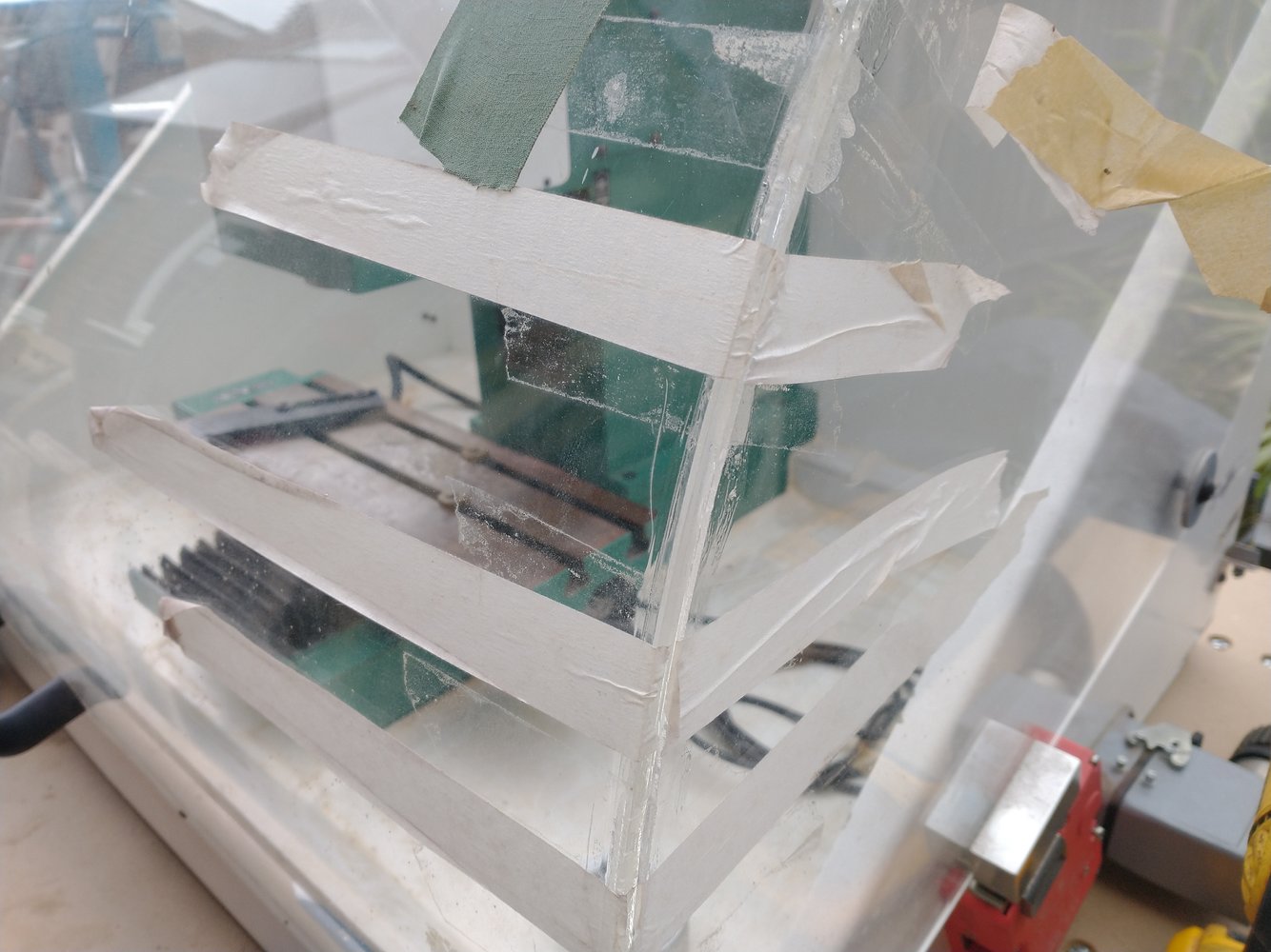

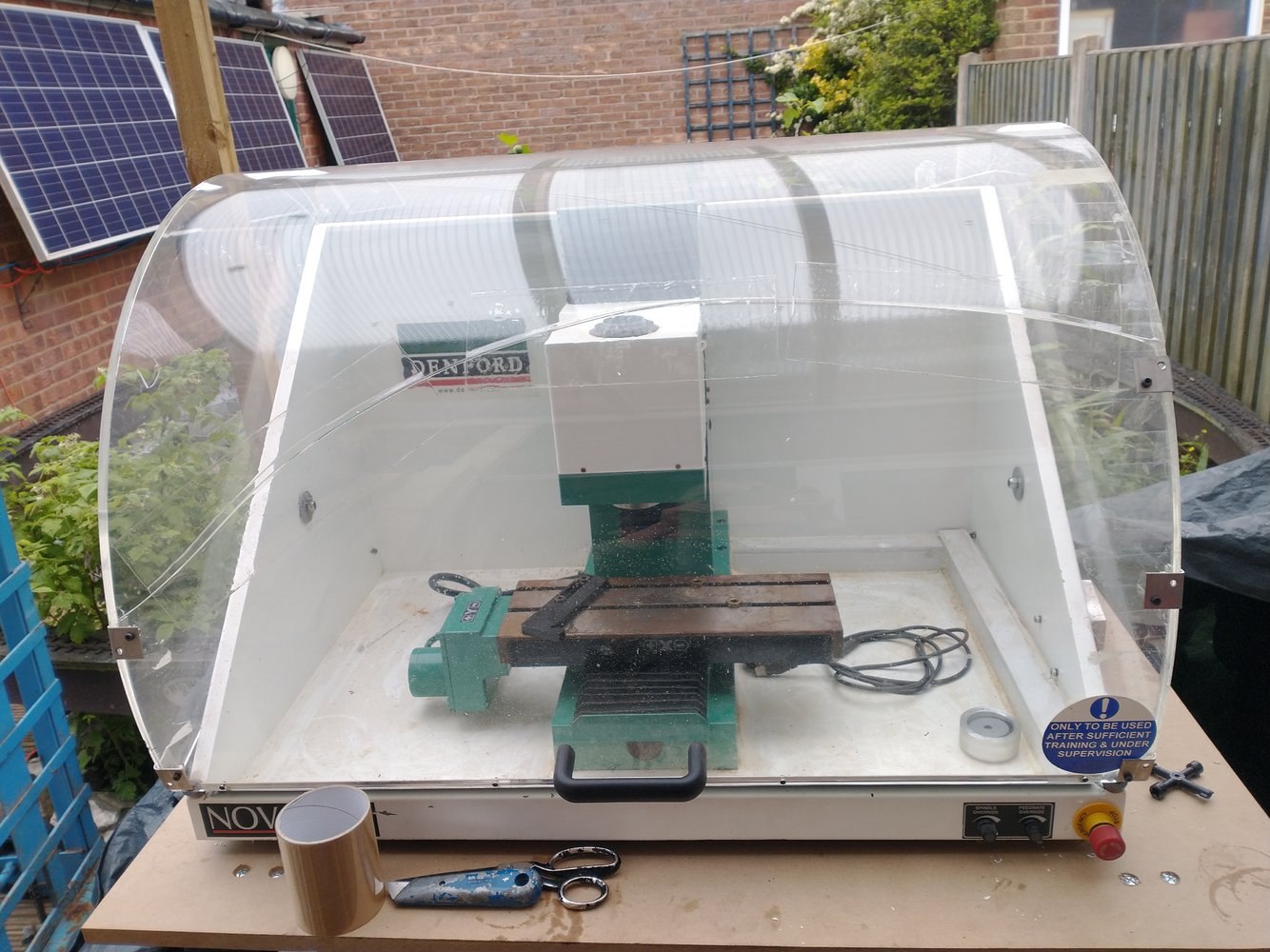

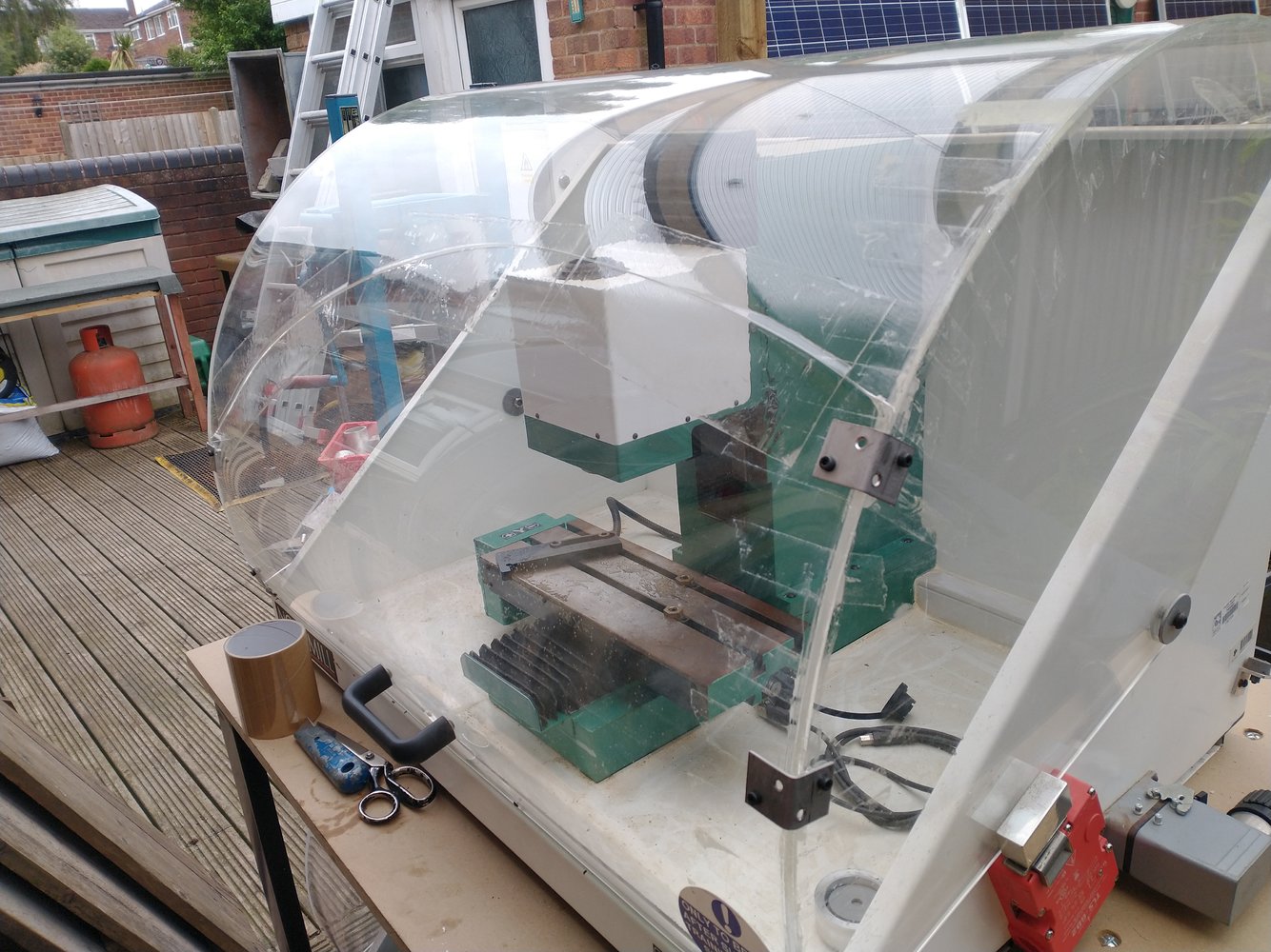

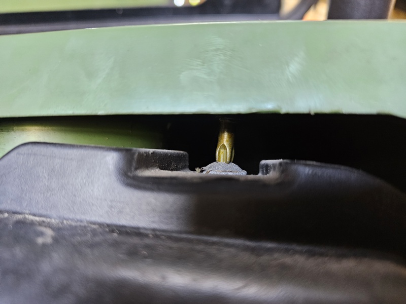

Arguably do you need an enclosure in a home workshop environment, it's surely designed to keep silly students fingers away.Another fix this time on the Novamill, the plastic cover had been expertly "repaired" at a University
The tape surprisingly was really not doing a good job so a few brackets from middle of Lidl and some left over soft top window repair tape et voilà....
Looks a little bit better
I've already disabled the safety interlock so I can open it at any time.Arguably do you need an enclosure in a home workshop environment, it's surely designed to keep silly students fingers away.
Looks like a flimsy pain in the butt to me

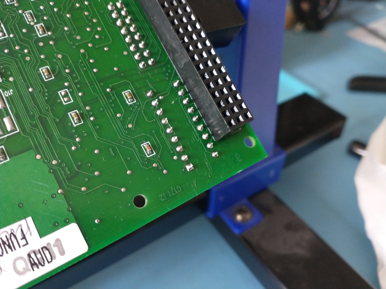

So after deciding the Darlington chip was FUBAR I ordered a set of 3 from the Bay or Evil. Might be a consumable! Time remove the old one.Whilst looking through the electronics cabinet of my new Denford Novaturn lathe I noticed a bit of melting going on
