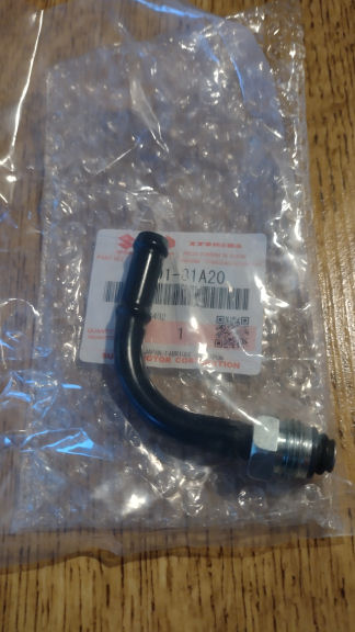

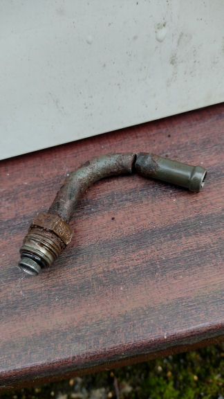

Its amazing how much genuine stuff you can still get from Suzuki, even for models back to the 80sStopped fluid peeing out of my Jimny's power steering
by replacing this
with this
Would you care to guess how much that genuine little fitting cost?Its amazing how much genuine stuff you can still get from Suzuki, even for models back to the 80s
£30 ??Would you care to guess how much that genuine little fitting cost?
£43 off Ebay, most places wanted over £60£30 ??
If you need anything else give me a shout I know someone at Suzuki so I get good prices, can take a while to get the stuff if its not in the UK though£43 off Ebay, most places wanted over £60
Luckily it was the low pressure return which sprung a leak, the high pressure hose is about £250
48691-81A20If you need anything else give me a shout I know someone at Suzuki so I get good prices, can take a while to get the stuff if its not in the UK though
What was the part number Ill get a price out of interest

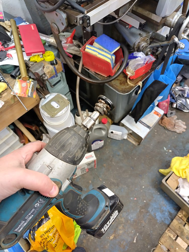

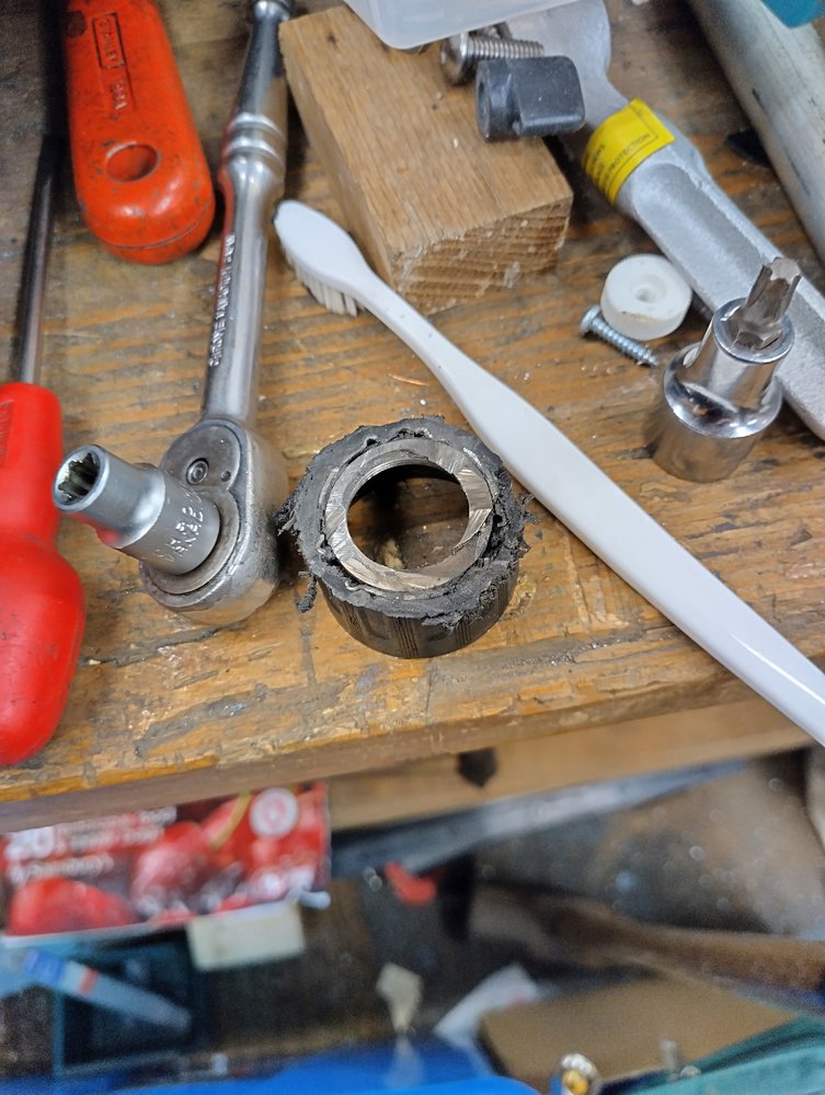

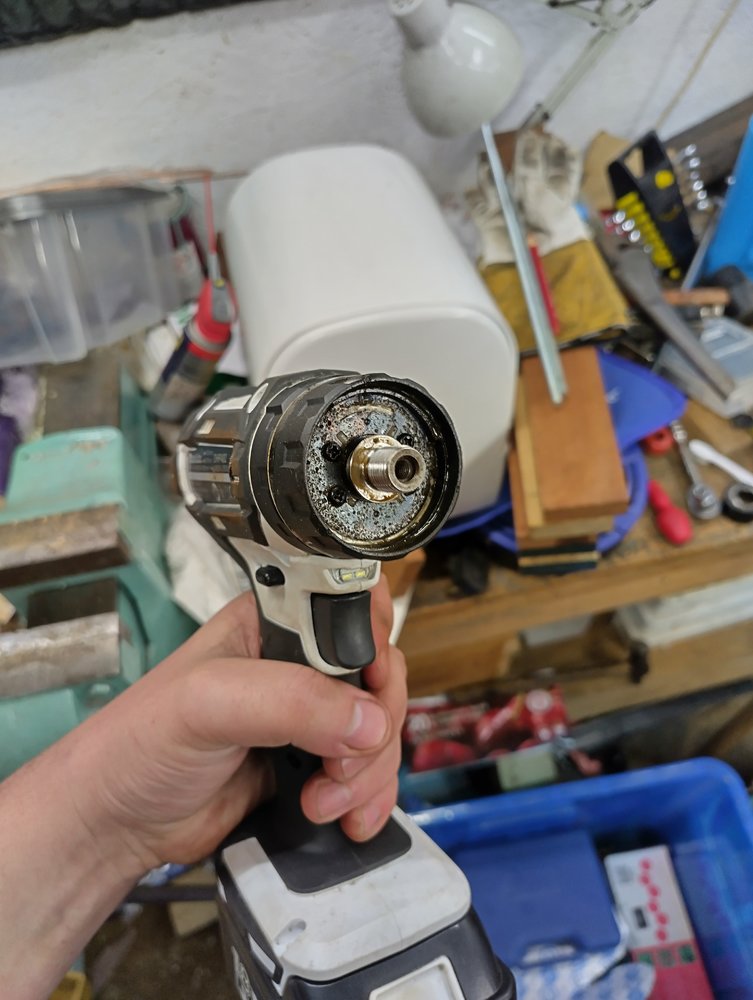

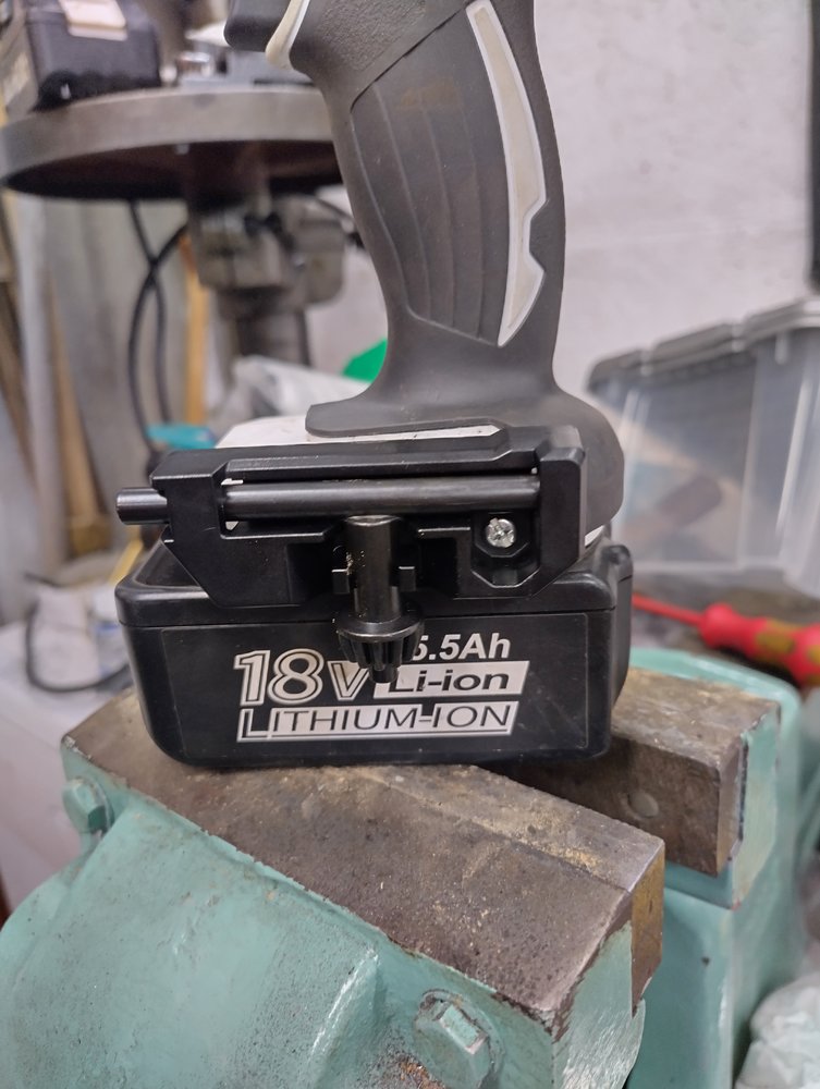

The "replacement" drill I bought when mine went kaput turned up yesterday evening..
Immaculate condition, but unfortunately it had been stored for so long that the chuck had seized shut.
I had several spare genuine Makita UNF ½-20 chucks, but it resisted being soaked in penetrating oil overnight, and all other more violent attempts to open it (including a 3ft scaffold pole on a footprint wrench, which just back drove the treble planetary gearbox), making it impossible to get the chuck off conventionally, sooooooo...
Angle grinder time!
Chopped through the chuck just above the mounting point, then was a simple job to get an impact driver at the retaining screw, and set an impact wrench with a torx bit loose on the remains of the chuck body.
No harm done, just wanted a quick wipe down before reassembly.
I should have a new gearbox for my old one next week and will fit that with the OEM keyless chuck.
But I'm curious to see how the keyed chuck works out... I have wanted a keyed chuck cordless for aaaages, but nobody sells one.
