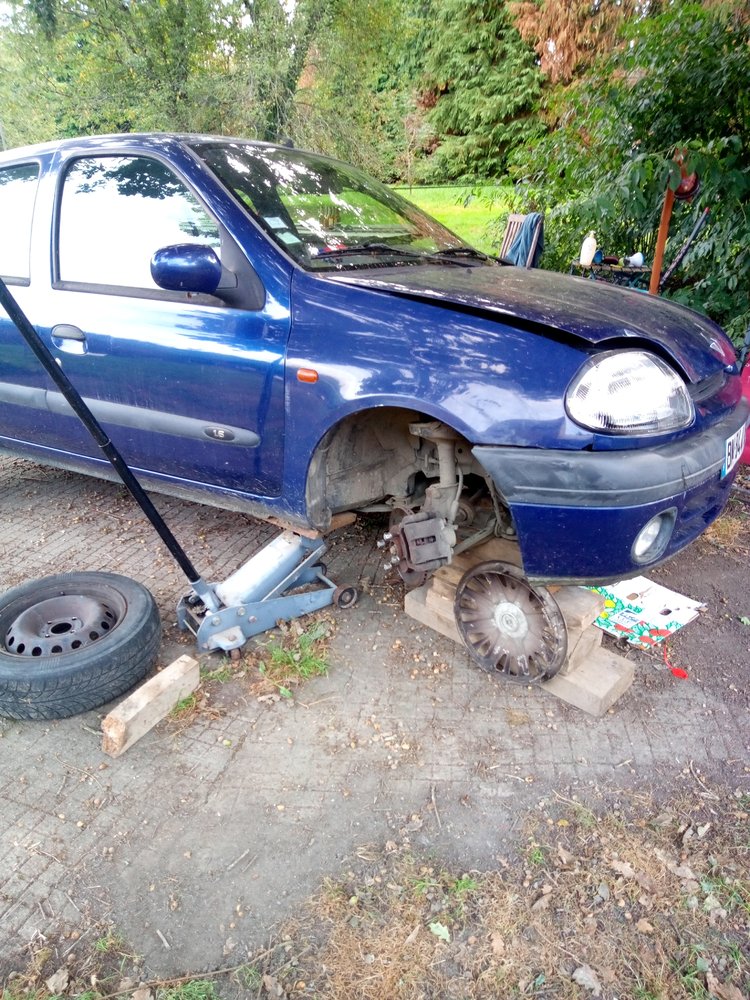

Clio II, 1.6 petrol, power steering and air con. Eventually fought the starter motor out, bloody nightmare.
New starter motor, well, it's half way in, but no further. Just won't go.
Spoke to local garagist, he had the same issue, ended up pulling the transmission shaft.
Really, don't want to do that...
Want to cry....
So inaccessible...
I'm putting it off till tomorrow, clear head, and all that.Not as bad as the sport variant, that engine is properly shoehorned in there, everything is a nightmare.

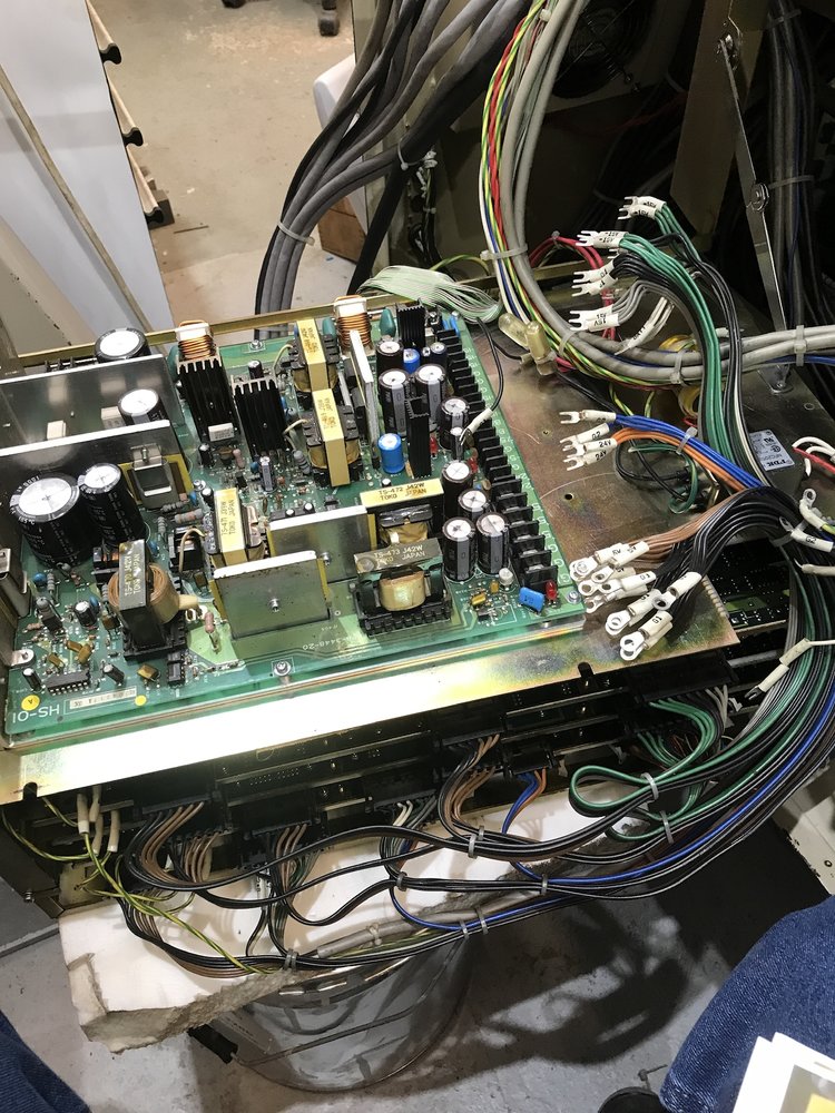

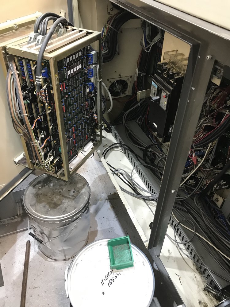

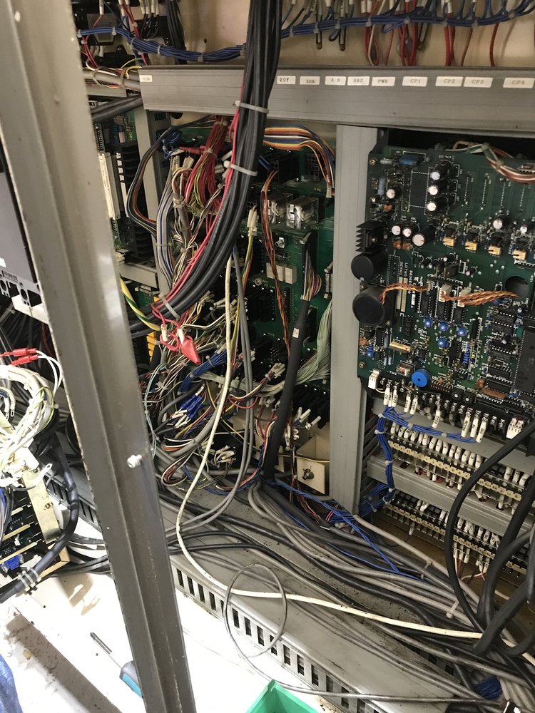

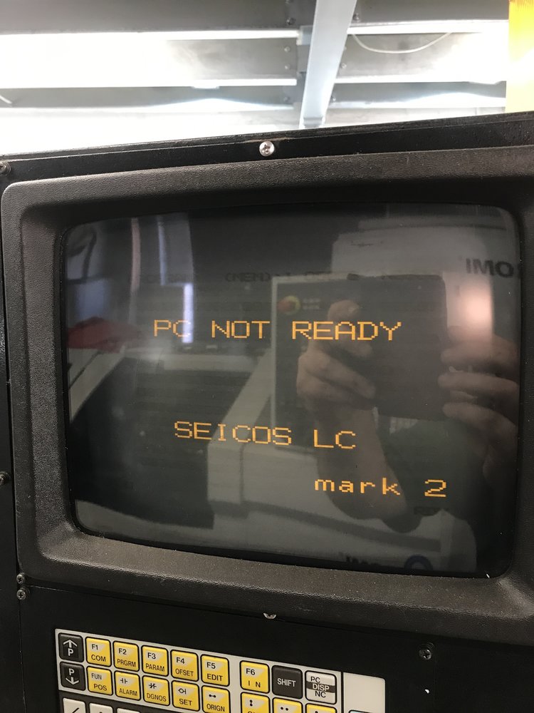

Made good progress on getting the 5 axis Cnc lathe recommissioned. Now ready for reinstalling all the parameters
View attachment 310128 View attachment 310129 View attachment 310130 View attachment 310131

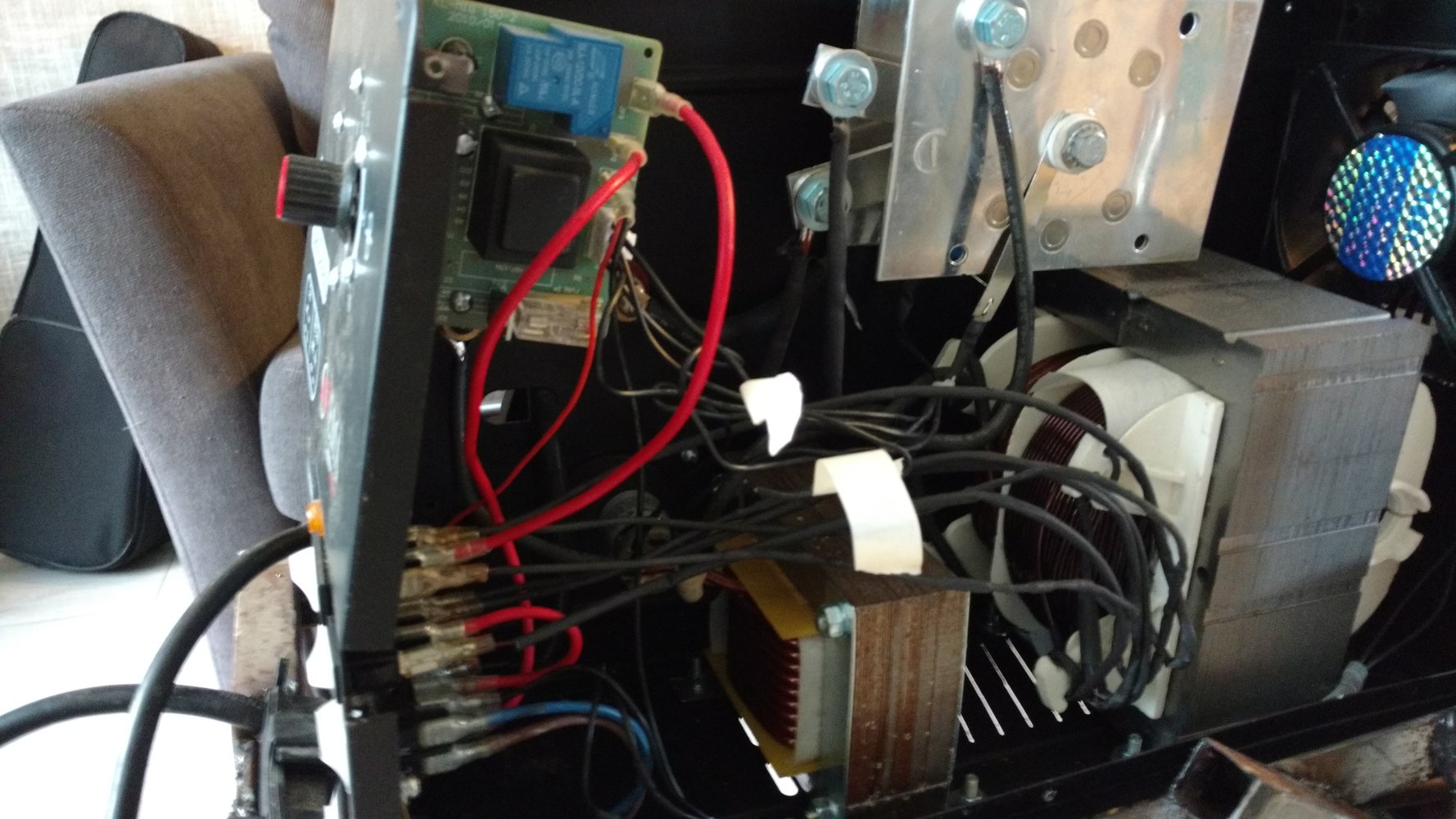

All connected before switching on. Had it totally out to replace all the capsNo wonder it’s showing ‘not ready’ Johnny, there’s at least 20 tag eyes left disconnected on that power supply

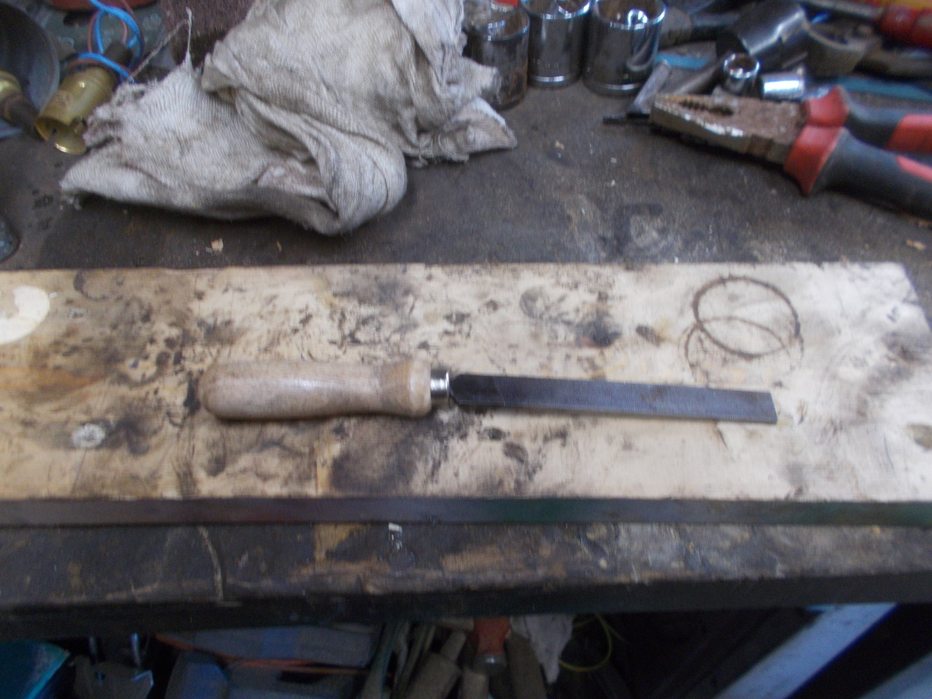

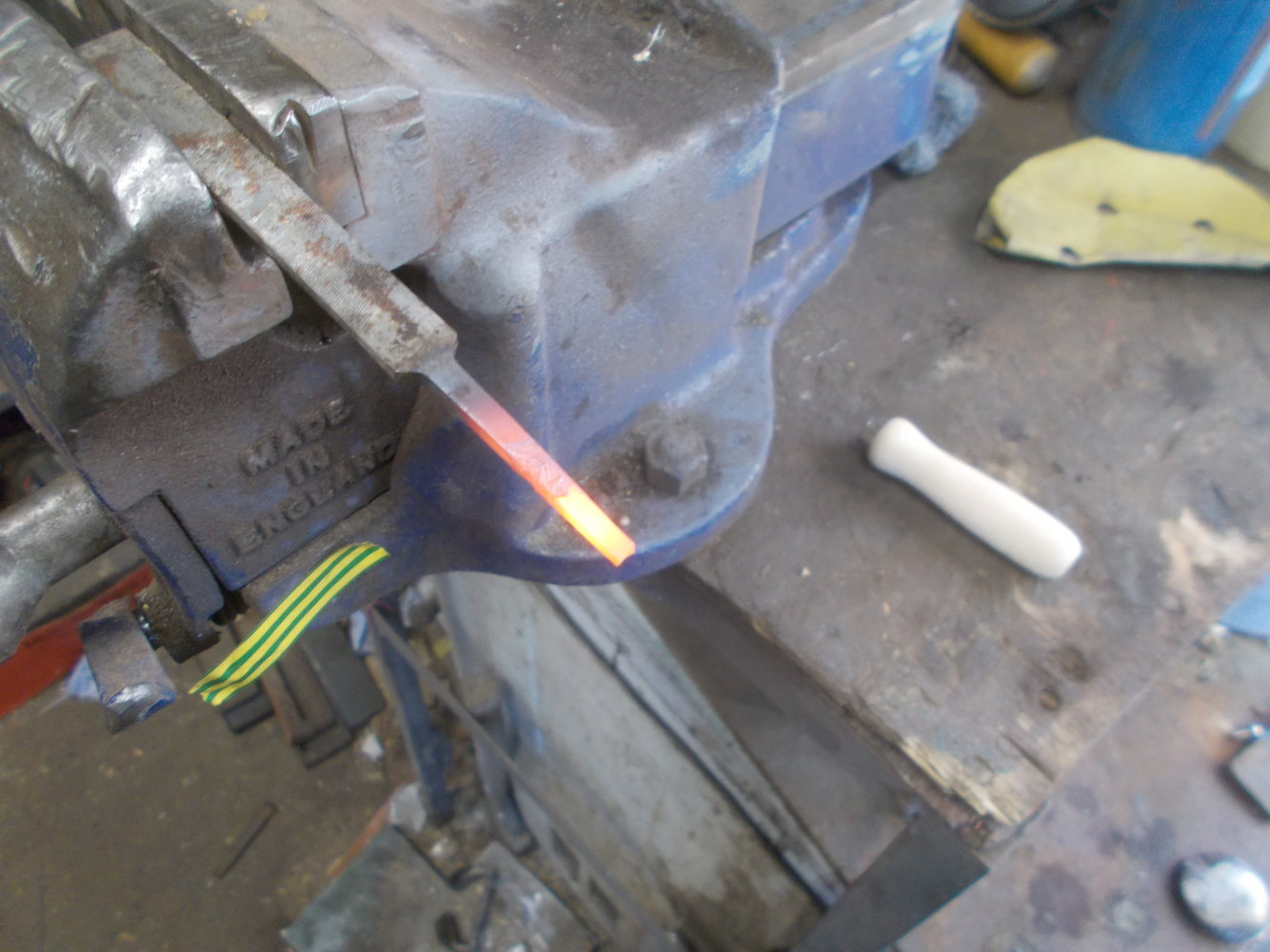

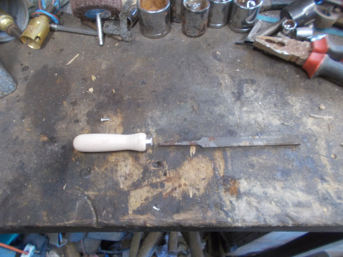

another tip with the hot file tang method........stick a pair of gloves on when you put the handle on............I remember as an apprentice being shown this method, but negelected put some gloves on the wood stain residue took weeks to wear off my handsYesterday was a busy day, guests who left me many items, finished a few on going projects.
Had a few beers.
One of my on going projects is to make a set of files up "On how to do........"
Small file, reclaimed handle.
Bit of heat. The trick is to get the small end hotter than the file end.
When you fit the handle, you want it to slide on. Some times the wood "Screams" as the handle goes on.

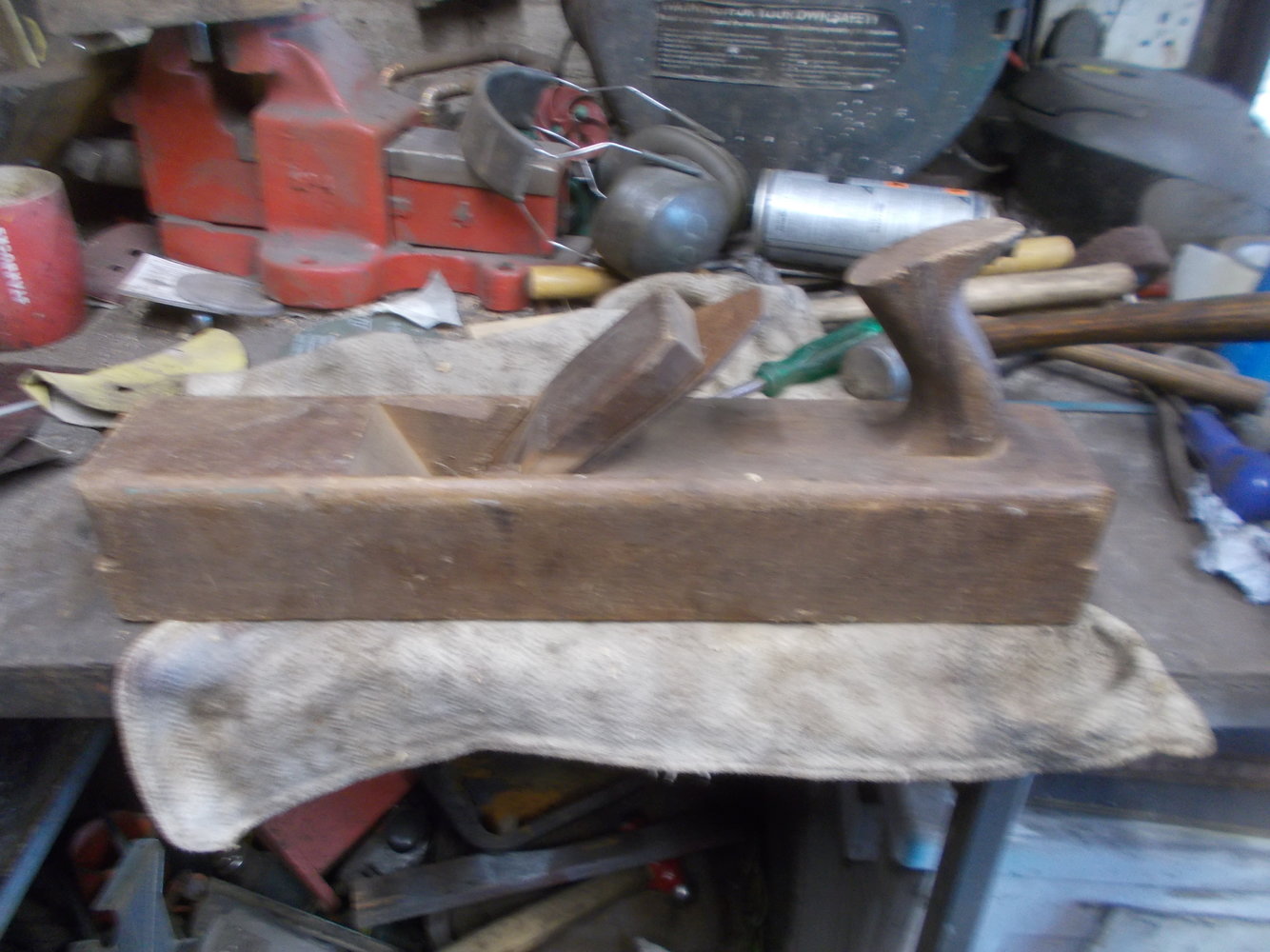

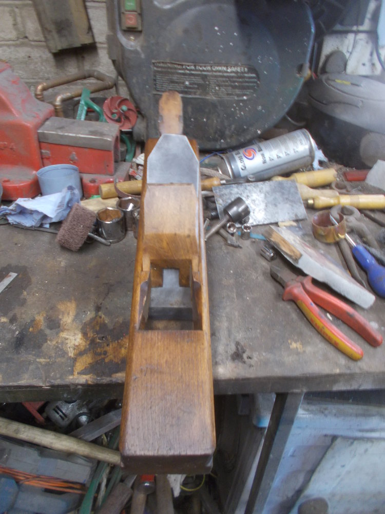

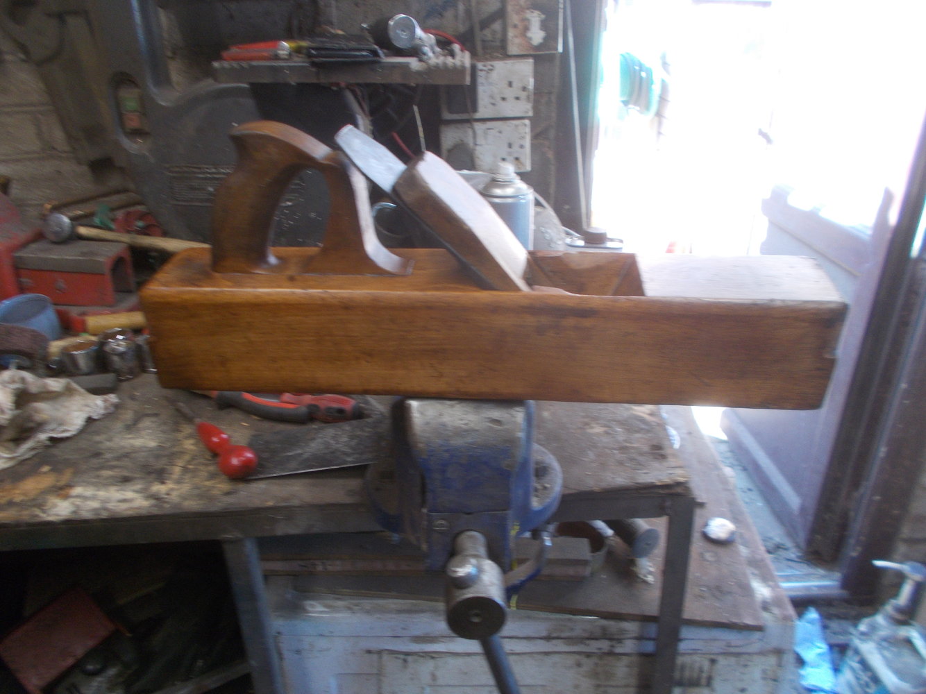

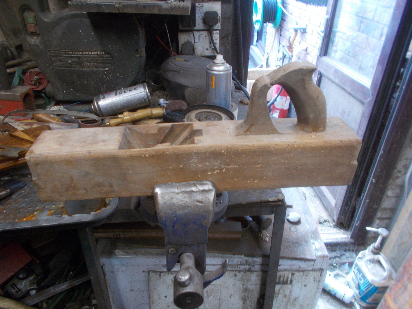

Yay. A worm free plane, the blade was sharp, the wedge was easy to fit.

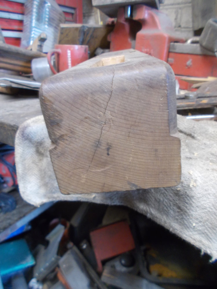

Oh.
This is not good. It goes the whole length of the body.
So nowt to do.
But to clean it up and use it as a display item.
This plane arrived with no blade, wedge and worm.
The worm was treated by:
20 mins. in 90 secs. burst in the micro wave.
Then 4 hours in the vacuum bag with liquid worm killer.
