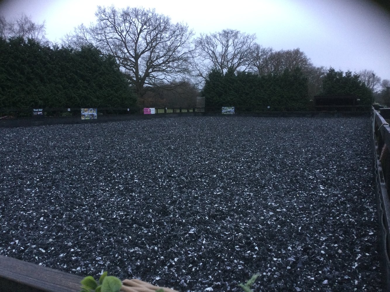

Rubber?Today I made SWMBO semi happy by laying 30 tons of new surface dressing on the school. It only lasted about five minutes and I was then led onto my next task, can't wait to get back to work

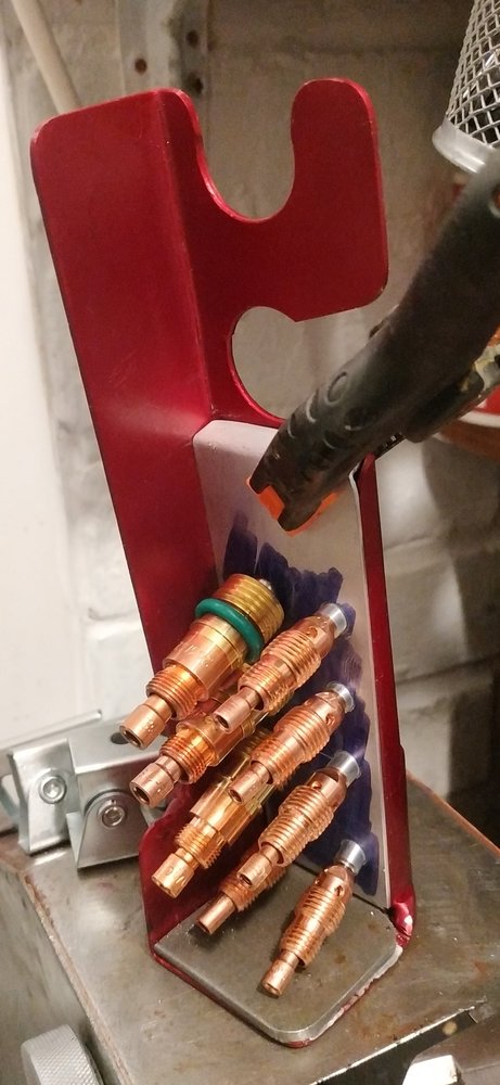

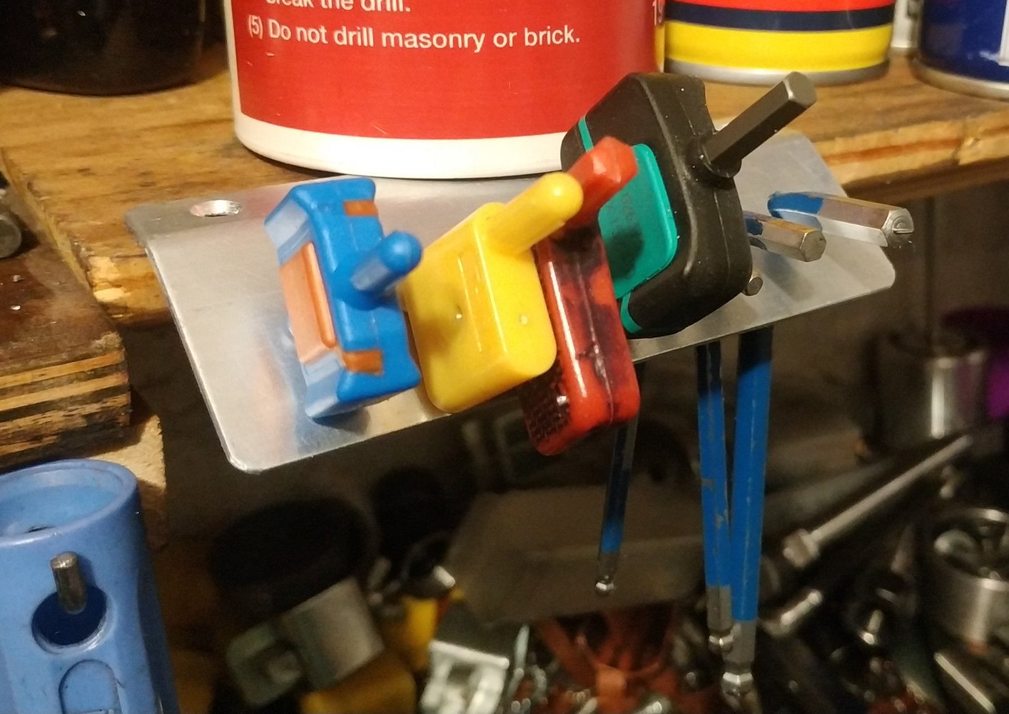

Today I put the angle table and vice into the vice on the Chiron then clamped up a bit of 52mm x 20mm aluminium.
I then milled a bit off it.
Flipped over and milled the other side which gave me a 74 degree angle.
Then I put a 10mm slot down it then put a 60 degree engraving cutter down the edge to give me this.
I then cut some 3mm stainless on the plasma and tested out the aluminium in the press to see if it would fold along the edges without distorting at the holes. It worked but it was really too much for the press with the narrow gap in the tooling. I was really meaning to use it with aluminium but had a bit stainless on the plasma so just used that.
Anyway looks like the tooling will work fine.
View attachment 324661dont you get tapers and flex with all that overhang?
