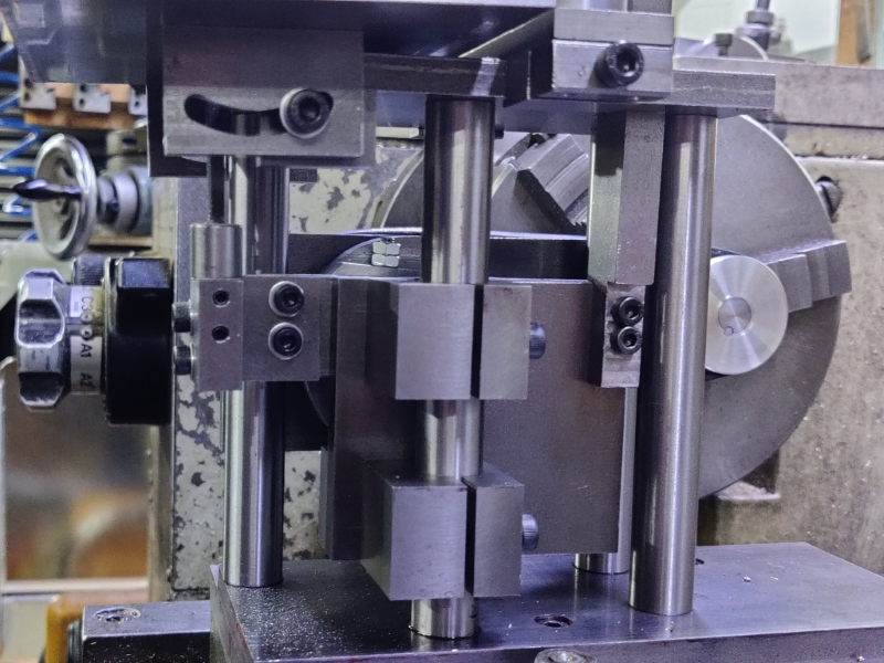

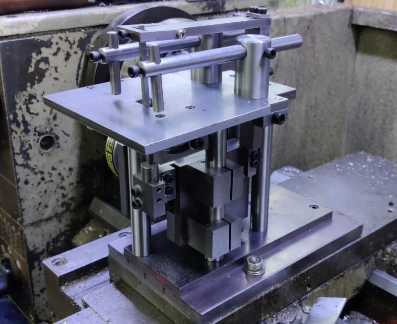

I don't see any grease nipples?Today I made this:
Yes, that's right: it's a small notch in a random bit of 3 mm steel I had lying around. Impressed? I was.

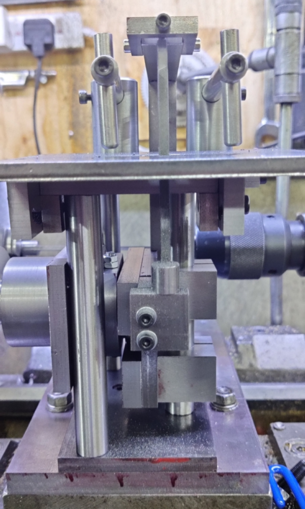

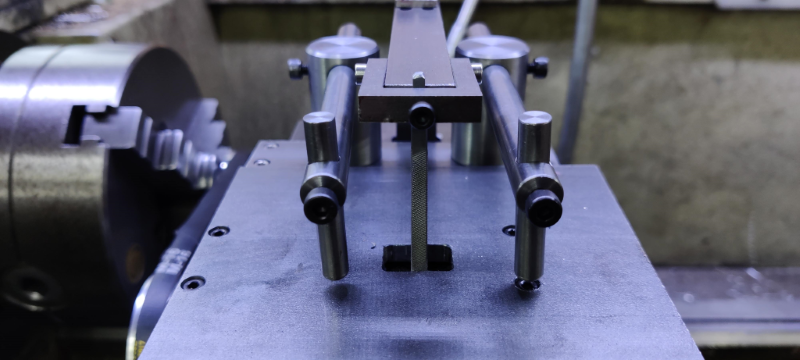

It might not look like much, but in order to make said notch, I made this over the last week-ish:
More pictures:
In case you haven't worked it out, it's Harold Hall's filing machine. I hate filing with a passion, so this should be quite handy. So far I've only prepared a square file, a "tri-square" (why can't they just call it "triangular"?) file and a flat file, but more will come over the next few days.
The "variable stroke mechanism" (adjustable eccentric bearing) is a beautiful design. Here are a couple of videos of it running with somewhere near maximum stroke length (first slowly, then a bit quicker):
I'm feeling rather chuffed with that.
Oh, and if anyone decides to make one of these filing machines, the hold-down mechanism drawings specify two of each of items 1, 2 & 6. It only needs 1 of each. Let me know if you want to make this machine and I'll send you the extras I made (assuming they haven't made it into the bin by then).
It's your choice. Either way a useful bit of kit. Well done.There aren't any (in the design or the reality). Should there be?
The rotary motion uses bearings; the up-and-down motion uses bearings running on ground steel shafts and cast iron "bushes" (if that's the right term) running on a ground steel shaft. I'll probably use oil here and there, but otherwise rely on the sealed bearings. It's not as if it's a machine that's going to be running constantly for years.
Do say though if you think I'm missing something
