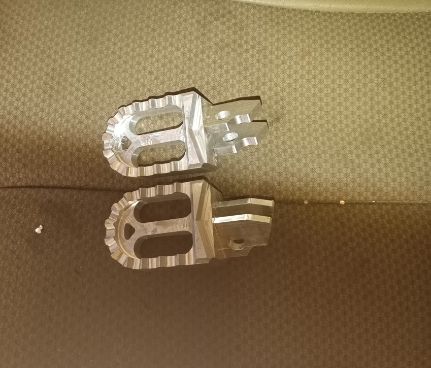

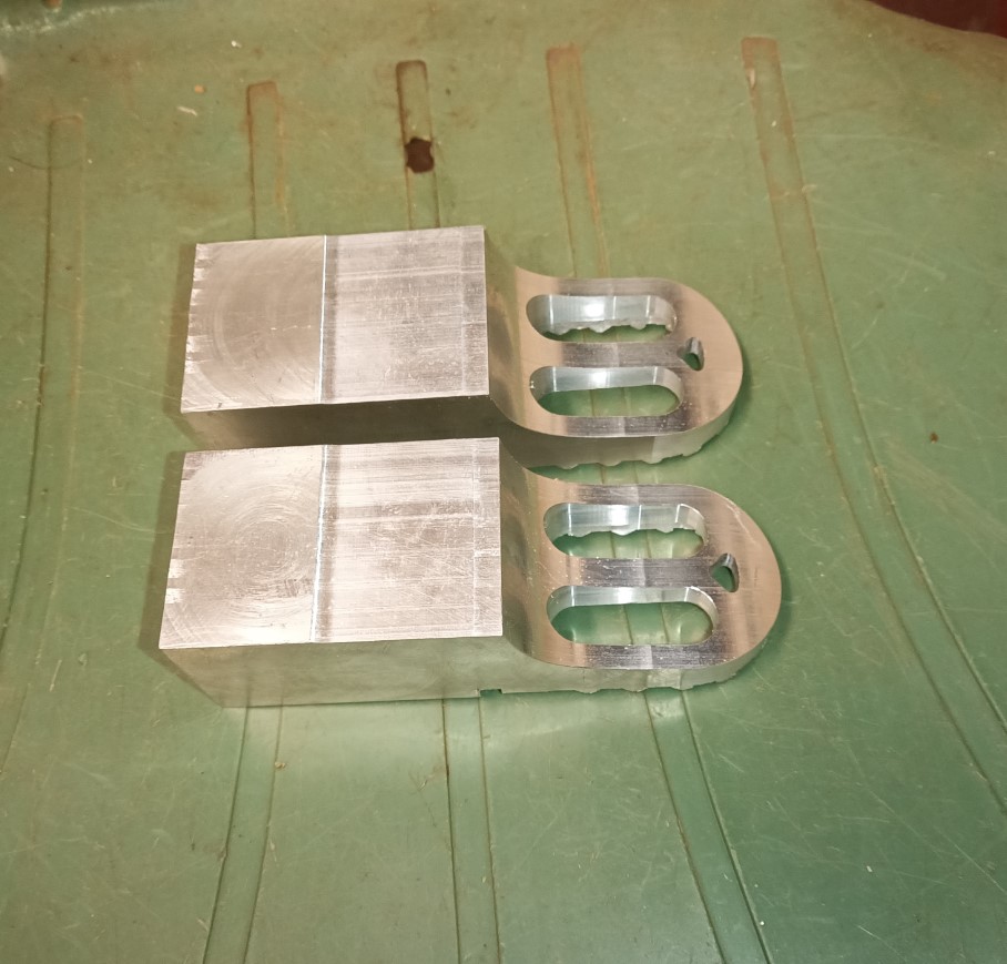

You must be quiet atm, how many sets of pegs have you made now? This the 3rd?Decided to make a start on the one piece pegs today.
Nah, loads on just can't be ersedYou must be quiet atm, how many sets of pegs have you made now? This the 3rd?![]()
Everyone will think you've dropped it!It is currently on my Africa Twin, one side OEM the other custom![]()
You jinxed meYou must be quiet atm, how many sets of pegs have you made now? This the 3rd?![]()
Engineering is the art of being approximately right rather than totally wrong.Profile on the end of the lower one is wrong, it is the left hand pegs profile as the cut out section should be at the top![]()
I thought it was get it nearly right, then be so busy it remains nearly right for the next decade, or until you stop making it . . .Engineering is the art of being approximately right rather than totally wrong.
First piece often is a no go, second try is right at it. Then you make a third to achieve perfection
Right or wrong, they look great![]()

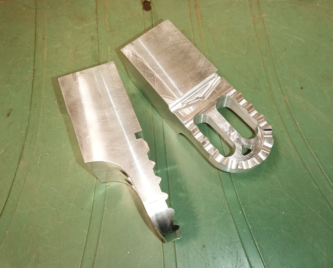

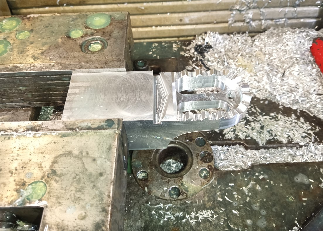

Can you not just use a DBIT tool for the engravingWell seeing as I now have a foot peg that is no use unless I want to turn into a bat and hang under the bike, I decided to have a wee mess with some engraving.
Ah, forgot, I killed my engraving tool a while backOk so what about a 90 degree chamfer tool, nothing to lose as part is scrap anyway.

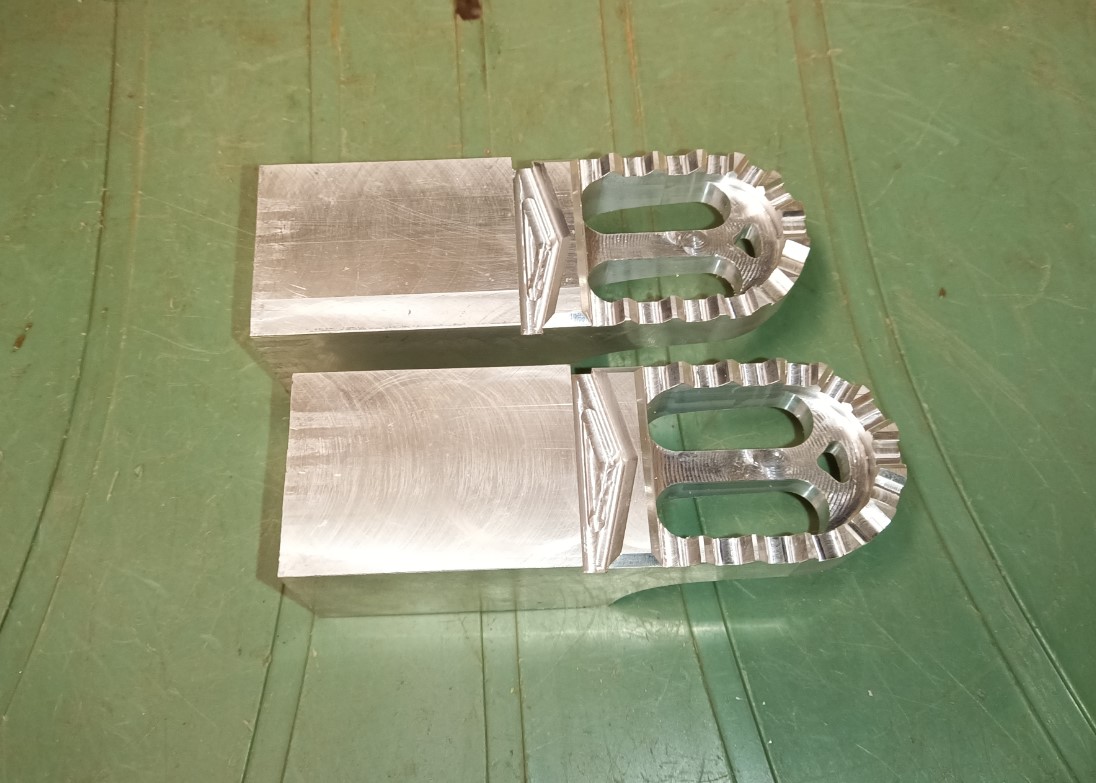

So drew it up, coded, set the peg up in the mill and pressed the button.
Quite happy with the result
