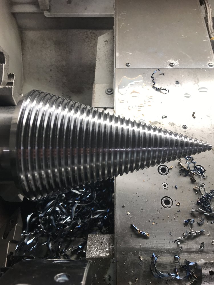

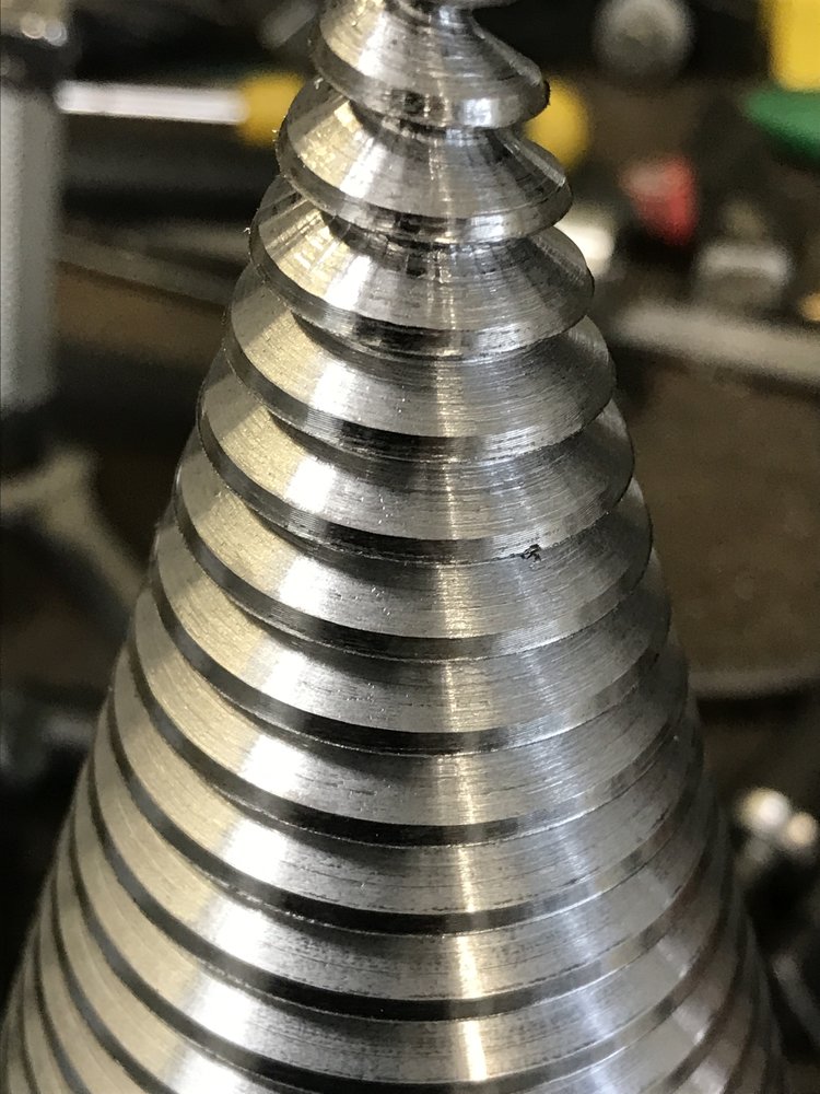

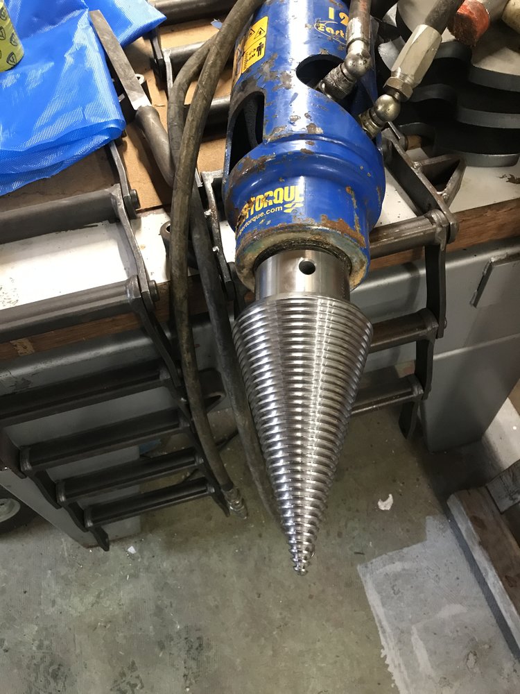

Nowhere near big enough for its secondary usage Lovely job thoughFinished cutting the tapered 6mm pitch buttress thread on the log splitter. I know where I would love to shove that, deep in the Ural Mountains
View attachment 335686 View attachment 335687 View attachment 335688
