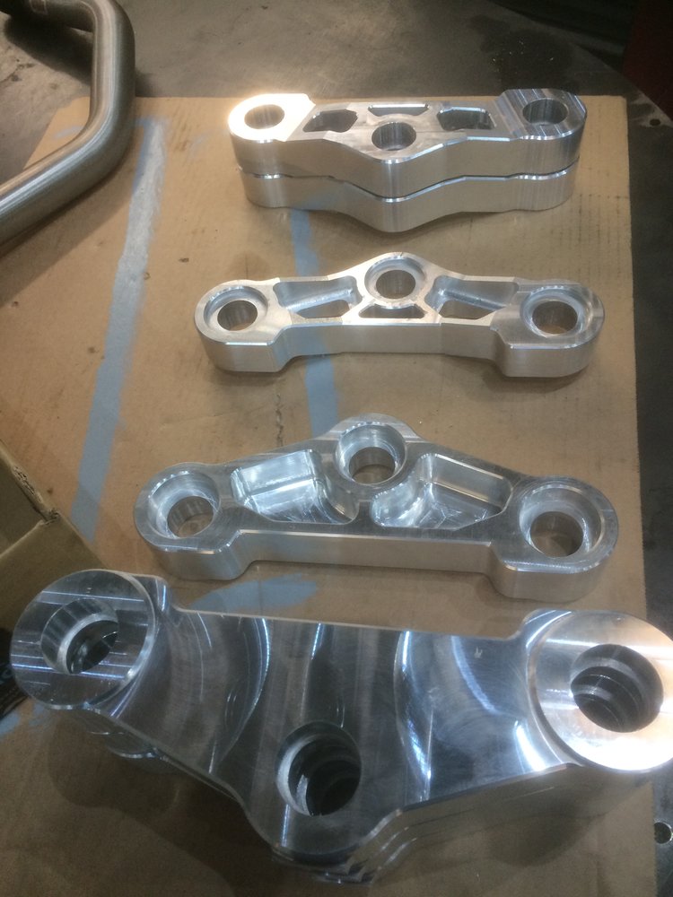

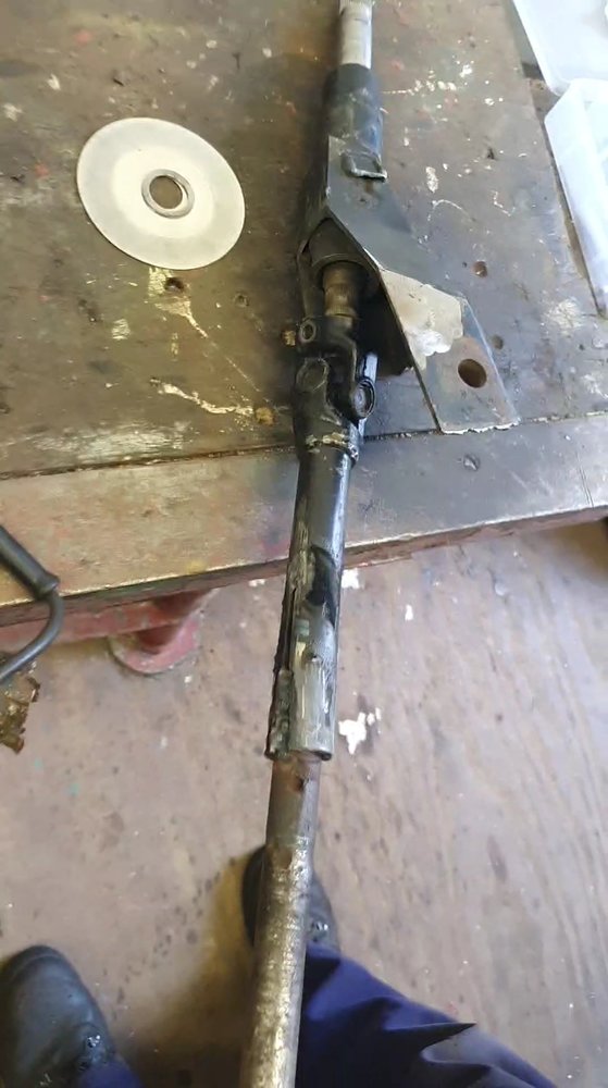

Creepers ? What are they used for ?Finished off the slab yolks today, countersunk, bored and tapped for the clamping screws and then cut the slot in the bandsaw. Luckily I had the foresight to design the slot at 60 degrees to the base which made setting up in both the mill and bandsaw easy with a 90/60/30 set square (I hate I have to say that as it is obviously a triangle and not a square)
Also knocked up a set of creepers from an old 2" prop shaft and some 16mm round bar.
