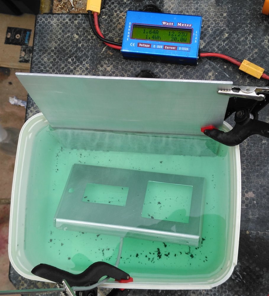

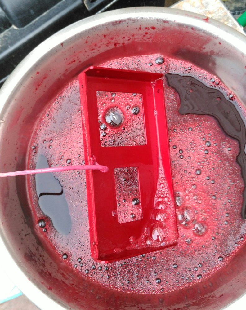

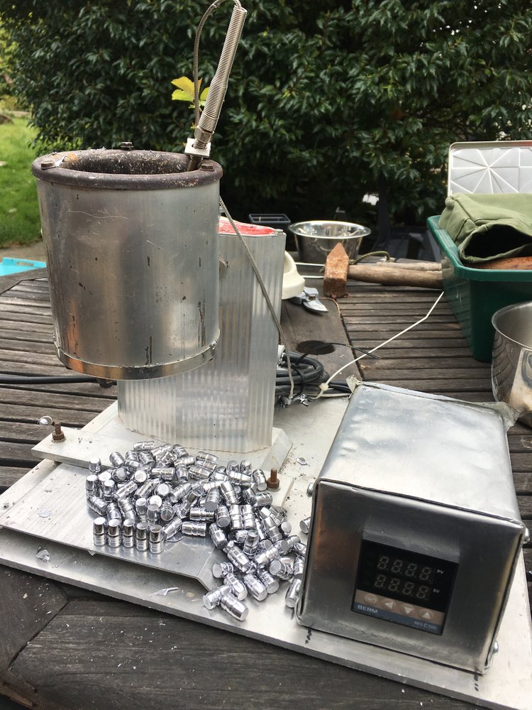

I've been avoiding anodising after a few failures. I had a plan to work round that and another go yesterday.
Black dirt is copper that is being plated out, which is why my acid is slightly green theres a bit left, doesnt do any harm.

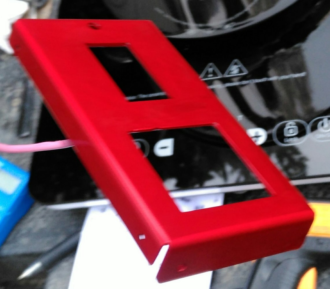

Im doing the front panel of the melter control box now.. waiting for epoxy to cure (heating on hob) then thats going in this afternoon.
The above are using epoxy protected, tig welded connection wires - bit of a pain! Todays attempt Im using a stainless bolt/nut to secure it. Stainless is bad, but Im hoping the epoxy will protect it. If any stainless is exposed, it will get eaten before the aluminium does anything.

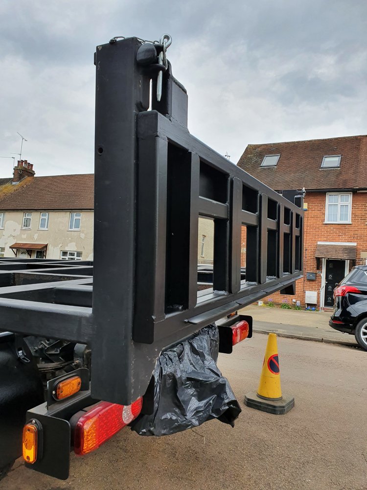

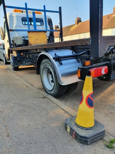

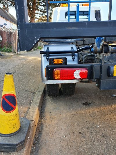

I did hgv chassis conversions for quite a few years and always hated fitting mudwings as they are easy to make look poo.Today. Fitted one side of the mudguards. Got a little fettling to do then remove for paint. A proper ass job to fit.
View attachment 342078 View attachment 342079 View attachment 342080 View attachment 342081

Yer they are a right toss of a job. These set had been rolled slightly out of alignment so that made things a little harder to get right.I did hgv chassis conversions for quite a few years and always hated fitting mudwings as they are easy to make look poo.

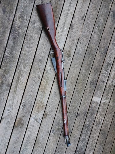

SVD?
Wasn't the mosin chambered in 7.62x39 as the AKM and others Kalashnikov family rifles?
Stocking up for a visit from the neighbours in the east ? Best make it 40,000 .

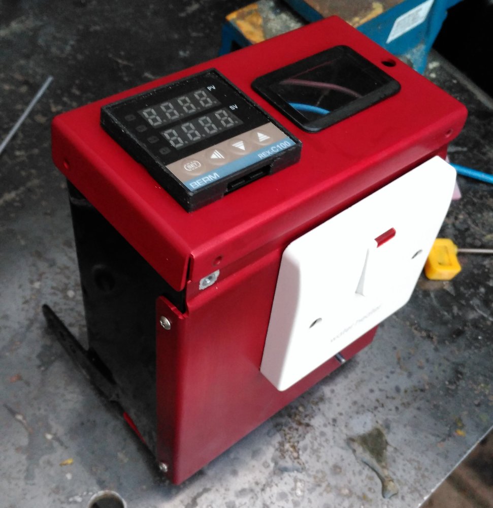

Melter control box, sprayed the back case and anodised the front, quick test assembly.. cosmetically done.
