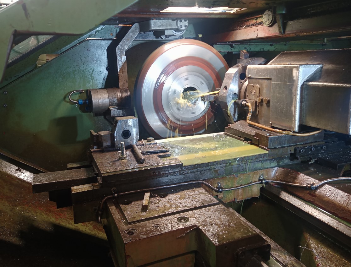

Got some hauler plates in to skim, I was going to do the smaller set last week but ran out of time, glad I did as it means I only have to clean the cast iron from the lathe once
Big plates are bleeding big, each weighs around 35kg and about 480mm dia if I recall, bit of a lift to get onto the lathe and in the chuck but a lot better now I have the foot switch as it means I can hold with both hands whilst clamping.

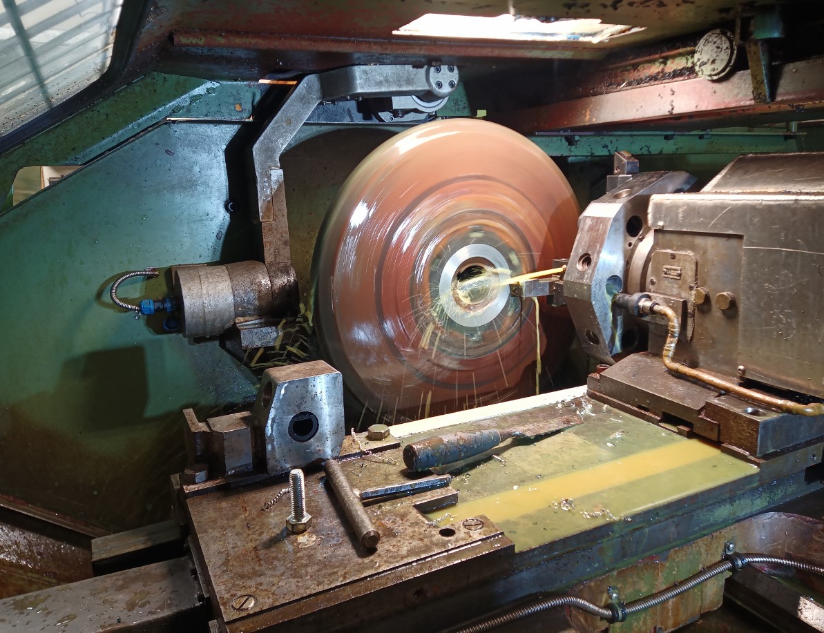

Just starting.
Couple of passes done, still need another to take the final wear off the taper.

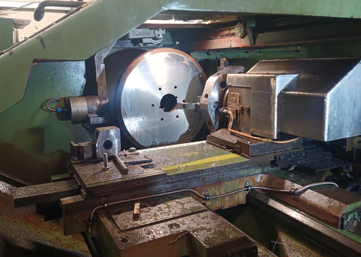

All done.

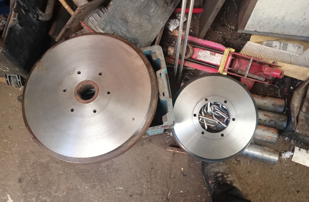

Pic of one of the big plates next to the baby one

Just starting.
