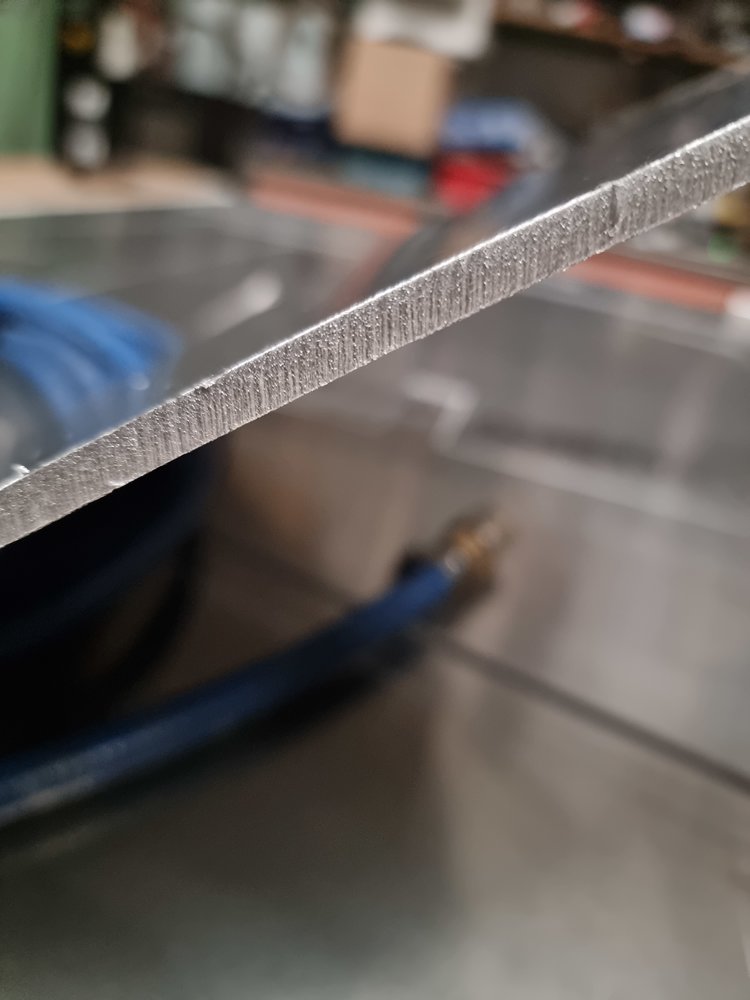

Better cut quality for aluminium and stainless. How much better I have no idea as I have never used it.What’s the benefit of nitrogen over normal air?
Less slag, cleaner cut.What’s the benefit of nitrogen over normal air?
Water table made a huge difference for me on stainless, only the very top of the edge has signs of oxidisation. Keep meaning to weld on a strip at the back of the table so I can fill up a bit more and try submerged cutting.If it’s better on thin stuff (<5mm) which I do most of in stainless it may be worth a shot.
It’s one of those things though, I’d probably try it if I got a used cylinder from somewhere but too much to get a whole cylinder on rental just for a gamble.
Wonder what argon would be like.
I keep thinking about it. I’ve got dust extraction at the moment but wonder about water tray.Water table made a huge difference for me on stainless, only the very top of the edge has signs of oxidisation. Keep meaning to weld on a strip at the back of the table so I can fill up a bit more and try submerged cutting.
Best thing I did was make it a water table.I keep thinking about it. I’ve got dust extraction at the moment but wonder about water tray.
Doubleboost had one but took it out which seems to be what most folk do so I dunno…..
Expensive!Wonder what argon would be like.

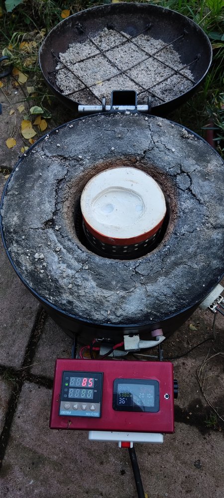

Stick the form to the base plate of the mould with silicone mastic then when it's set make the rest of the cast .Found a spare couple hours to mess about.
Took me way longer than expected to pour the plaster and may have messed up the timing, but it was still very runny. 3 mixutes to mix, powder to water. 1 min to vacuum. 1 min to pour. 2 mins to vac and release.
Upto this point it was going quite well,but who knew that PLA floats!?!
Saw the cows nose bobbing above the surface. Stuck my fingers to try and position it until started to set. I may have cocked this up!
Theres not much clearance between the print and flask so I wouldnt be suprised if it cracks in a thin place.
I went with the measures for a 4" * 63mm flask, 262ml water, 652g plaster, Id say about right, only a little excess.

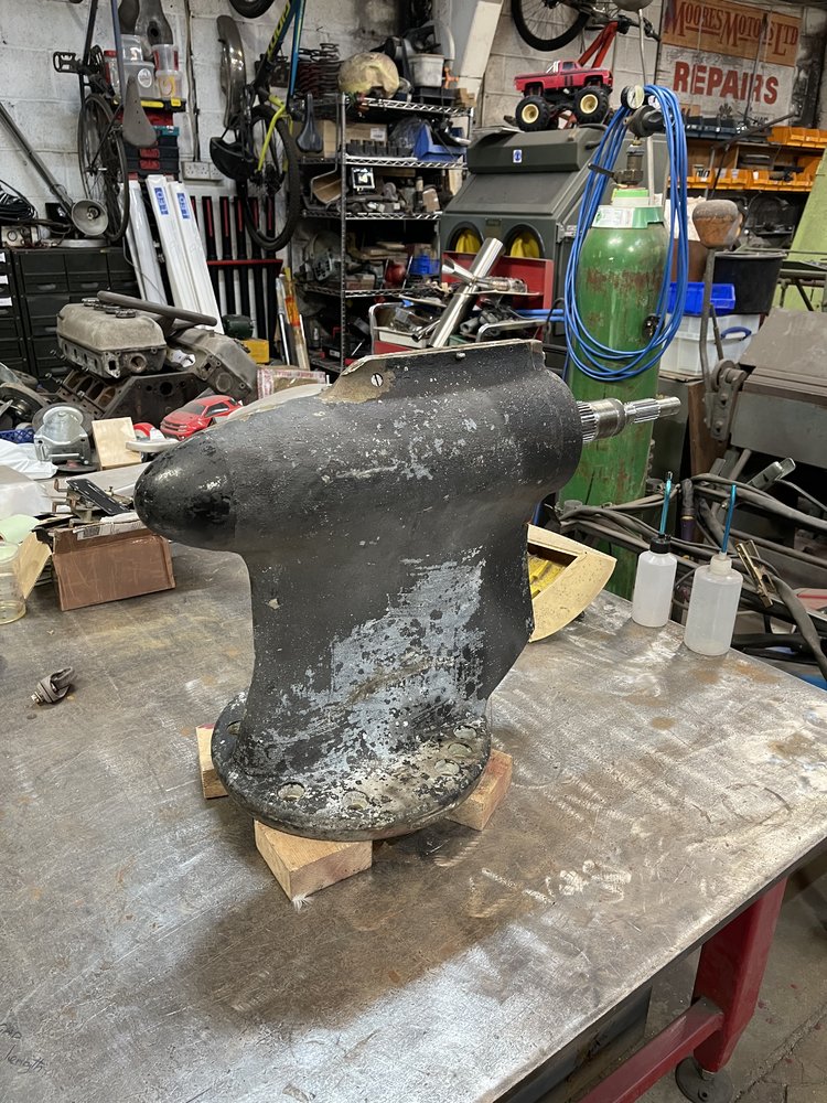

Is it bronze?I spent my afternoon building up and resculpting a big gouge in a marine pod. Not the simplest thing to weld as I was using long 6mm slithers of the parent material as filler rod but it came out ok.
