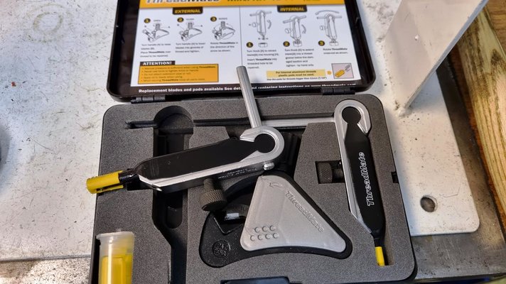

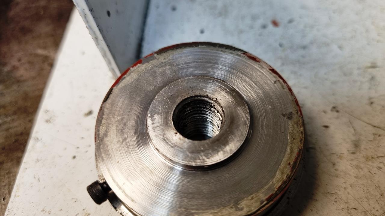

Another **** of a job, I had been struggling with making a bush for something and was trying to work out what internal thread I was copying, turned out to be 13/16" by 20 so finishing that I jumped onto another job that worked out even more bizarre:

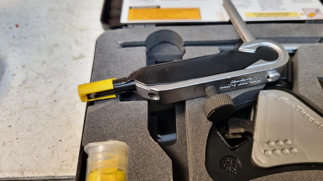

I simply didn't have a tap for this so I reached for one of my get_out_of_Jail tools:
the plastic shroud pushes into the opposite side to the cutter that restores the thread, works really well:
Not cheap though :-(
What's this tool called please?
Thank you!
Carsten
Is this a Chinese copy?It is a "Threadmate" and I had a bit of a look around yesterday to see what they are selling at now and couldn't find one for sale. I do remember though it was expensive.
Found one the same as yours in Australia but no price. I’ve got my sister to investigate……
I hadn’t heard of Hazet. Just googled them and found more stuff to buy!I don't know anything about your specific Aussie offer, of course, but I called my official Hazet dealer here:
Under this designation there is indeed this tool with the identical dimensions as the ThreatMate from @northwest ...
... and Hazet is particularly proud of it: about € 250 including tax!
But there is some confusion:
A stands for external thread;
I stands for internal thread;
G probably just for thread;
At least the external thread version is also available for threads > 13mm (AG-1 @~€ 65, AG-3 @~€200)
This seems to be 1:1 the former ThreatMate (takeover? label?) ...
And then Hazet has probably also a much older own tool at least for external thread still in their program ....
Carsten
