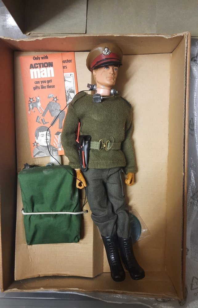

That looks better quality than the genuine AM uniforms...
You'd have ended up as a child labour "machinist" running up loads of AM uniforms after school!Perhaps she could have got a contract with Palitoy!
Not without a nice little lamp above them.You wanna get them sold on etsy you'll make a fortune ! btw that brickwork needs tidying up !![]()
Cracking job, really nice detail, you couldnt have been that poor youve got the one with "real" hair!
My dad was a cobbler and lots of my AM stuff was home made, tiny boots and holsters the best things in life are free or home made, still got lots of AM stuff.Not exactly made today and not by me but by my late Mum. Probably 50 years ago. She was a seamstress by trade having been pretty much adopted by a Jewish family when she fell on hard times after coming over from Eire at 15.
Anyway...as a kid I liked anything to do with Action Man. Not having much spare money, this was Mum's take on a German army uniform:
The dexterity she had was pretty amazing. Gutting when dementia got her![]()
That's a nice job and a great find. However I can't help but appreciate the irony. Taken in by a Jewish family, German uniform?![]()
Wasn't it Yootha Joyce who was always looking for an Action Man with gripping hands? That just shows that it was a fictional comedy.Don't forget the gripping hands!![]()
Gizza job….Wasn't it Yootha Joyce who was always looking for an Action Man with gripping hands? That just shows that it was a fictional comedy.![]()
Looks very close to JD green.I like it.

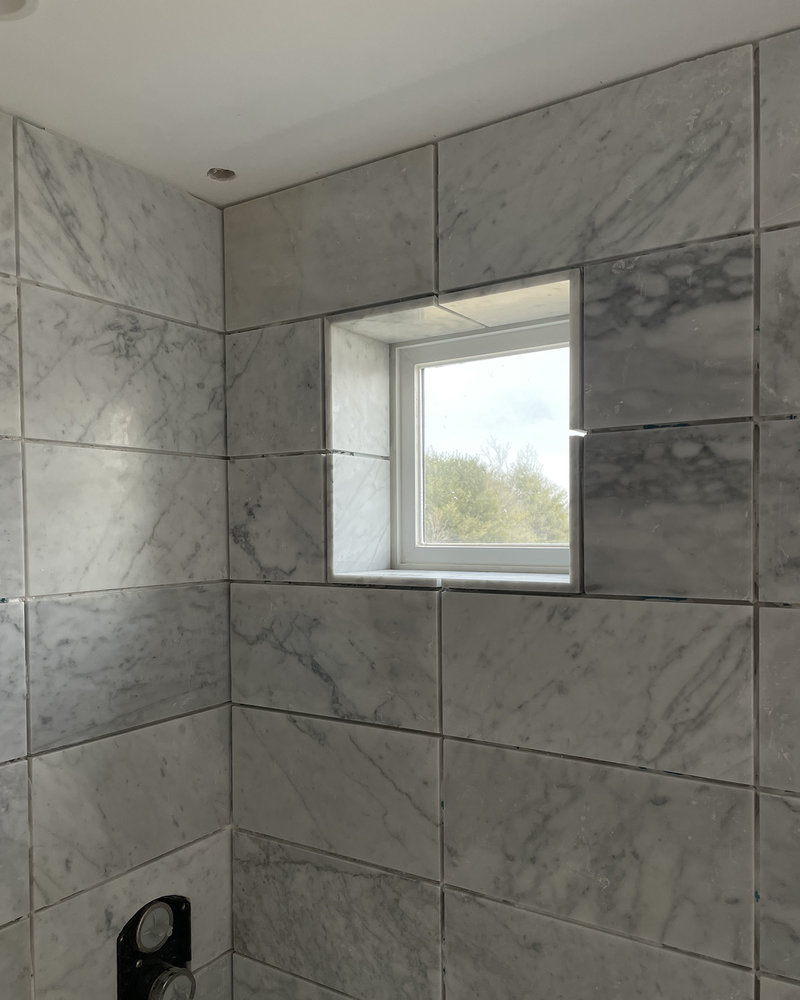

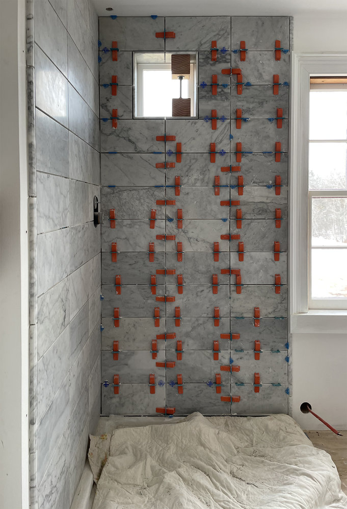

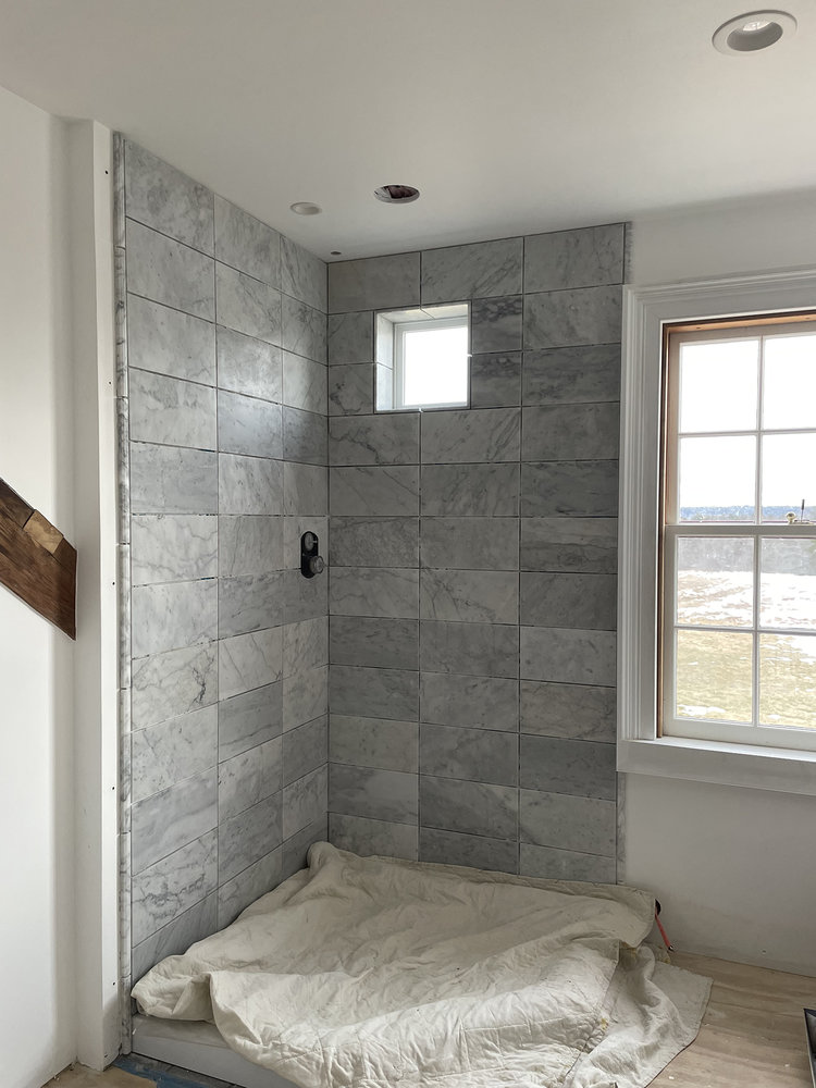

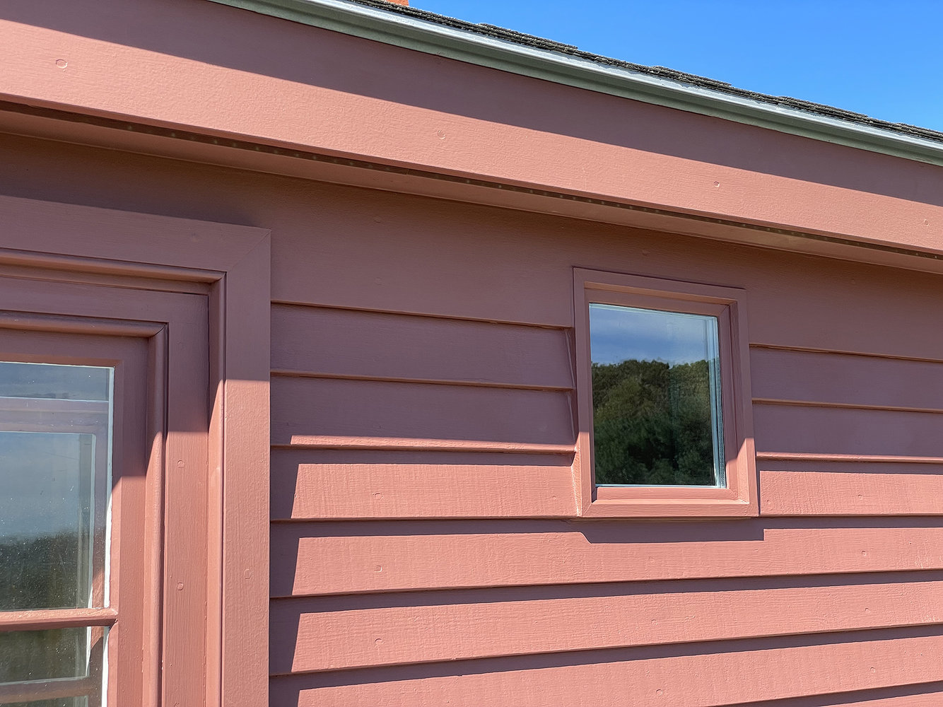

Nice, question is, did you size the tiles to the window, or the window to the tiles?!Work in progress:
Finally got the rest of the marble tiles mortared onto the backer boards of the shower enclosure in the future upstairs bathroom of our 'old house' project. I used a polymer-modified mortar, which is extremely tenacious stuff; I had to replace one tile that somehow had slipped a bit, and it wasn't easy!
It was the first time I used this particular leveling clip system on a tile job, and I think it worked pretty well.
The next steps to finishing the tiles will be:
- Clean up the mortar remnants.
- Grout the tiles with a polymer-modified sanded grout.
- Caulk the outer edges.
- Seal the tiles and the grout with a high-end sealer.
I hope to get those steps done over the coming week or so, sandwiching them between other tasks I'm working on. My lower back has been acting up a bit, so we'll see how it goes.
Work in progress:

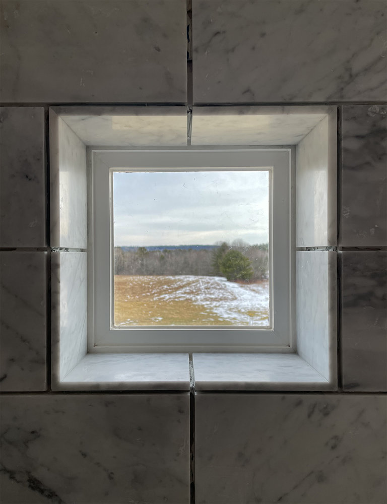

Thanks. It was a little of both. Here are a few details:Nice, question is, did you size the tiles to the window, or the window to the tiles?!
A leveling system can be very handy, especially when the backer board isn't absolutely flat. These backer boards were 'reasonably' flat, but not perfect, as they were installed on rough-sawn studs. The only thing I don't like about leveling clips is that if you get a little too much mortar behind a tile and it squishes out against or inside the clips, it's hard to get it all out while the mortar is wet, so it will require some joint cleaning after the mortar has set, but in this case it wasn't too bad. It only took about half an hour to clean the excess mortar out of the joints in preparation for grouting.Cheers, kicking myself even more, again, that I didn't use a tile levelling system![]()
Thank you. It was a little more work to do it that way, mainly because I had to be fairly precise. I had to re-cut a few of those tiles and do a bit of shimming under the tiles to get the corner bevels and joints to line up well. I bonded the mitre joints together with silicone as I was assembling the tiles, so they're well sealed.^^ I like the attention to detail with the mitred joints at the window, most would have just used butt joints.![]()
That's the kicker for me. My plasterboards and backer boards were dead flat, as was the floor. It was the perfect surface to tile on.A leveling system can be very handy, especially when the backer board isn't absolutely flat. These backer boards were 'reasonably' flat, but not perfect, as they were installed on rough-sawn studs.
Well, leveling system or not, it looks like you did a really great job! That represents a lot of work!That's the kicker for me. My plasterboards and backer boards were dead flat, as was the floor. It was the perfect surface to tile on.
Trouble is I'd never tiled before and got caught up in the moment. Started with the hardest corner first as well!
