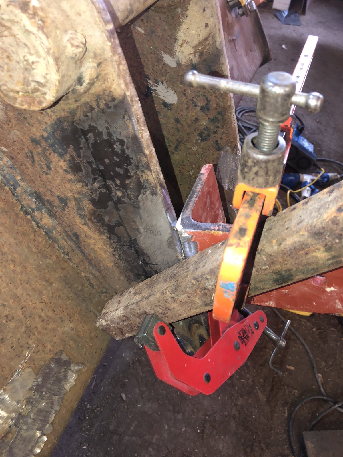

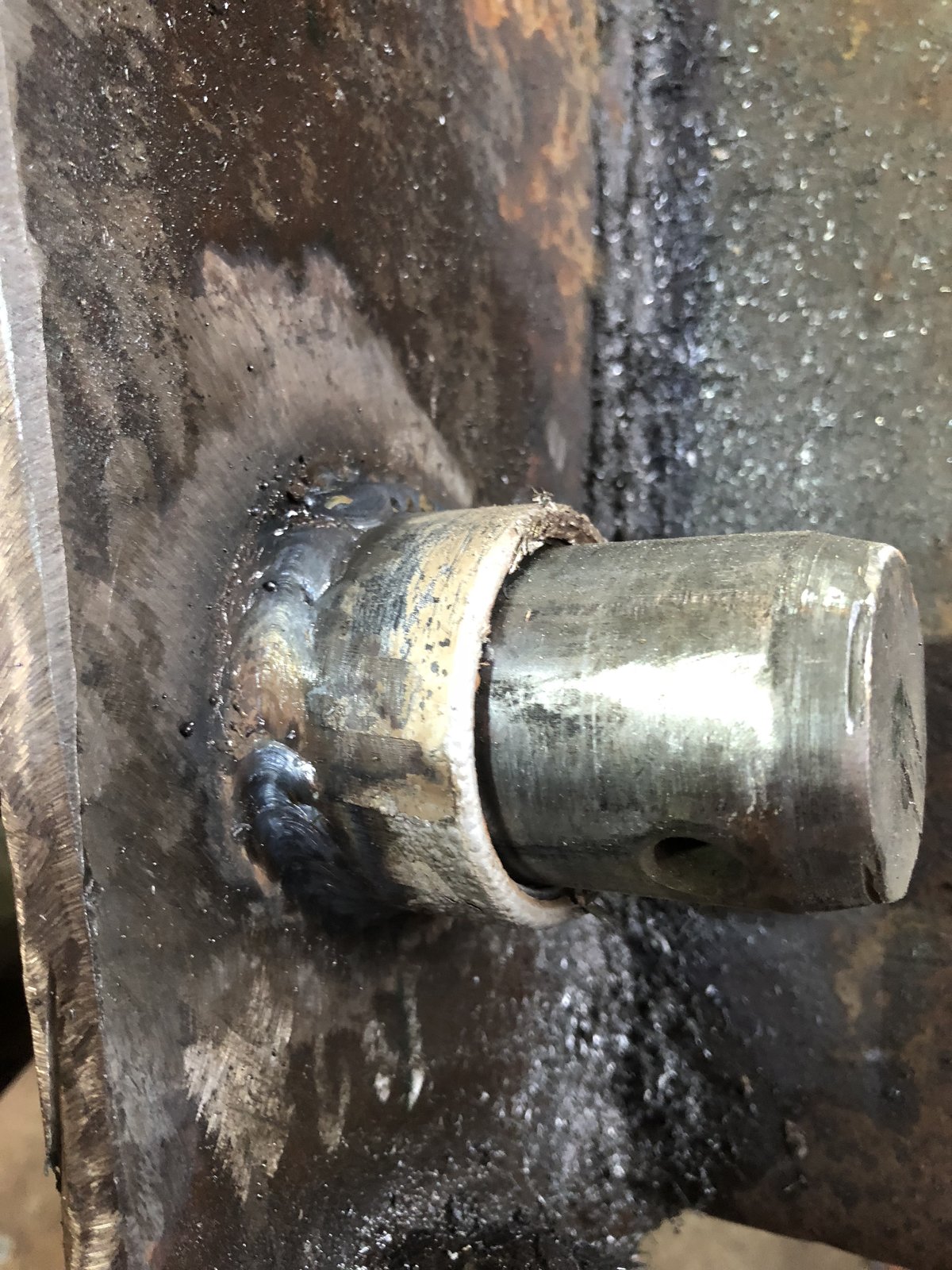

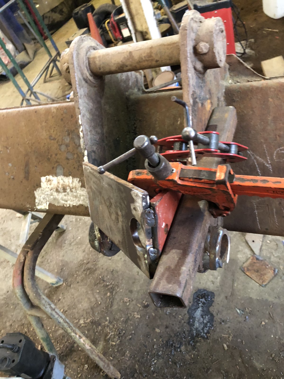

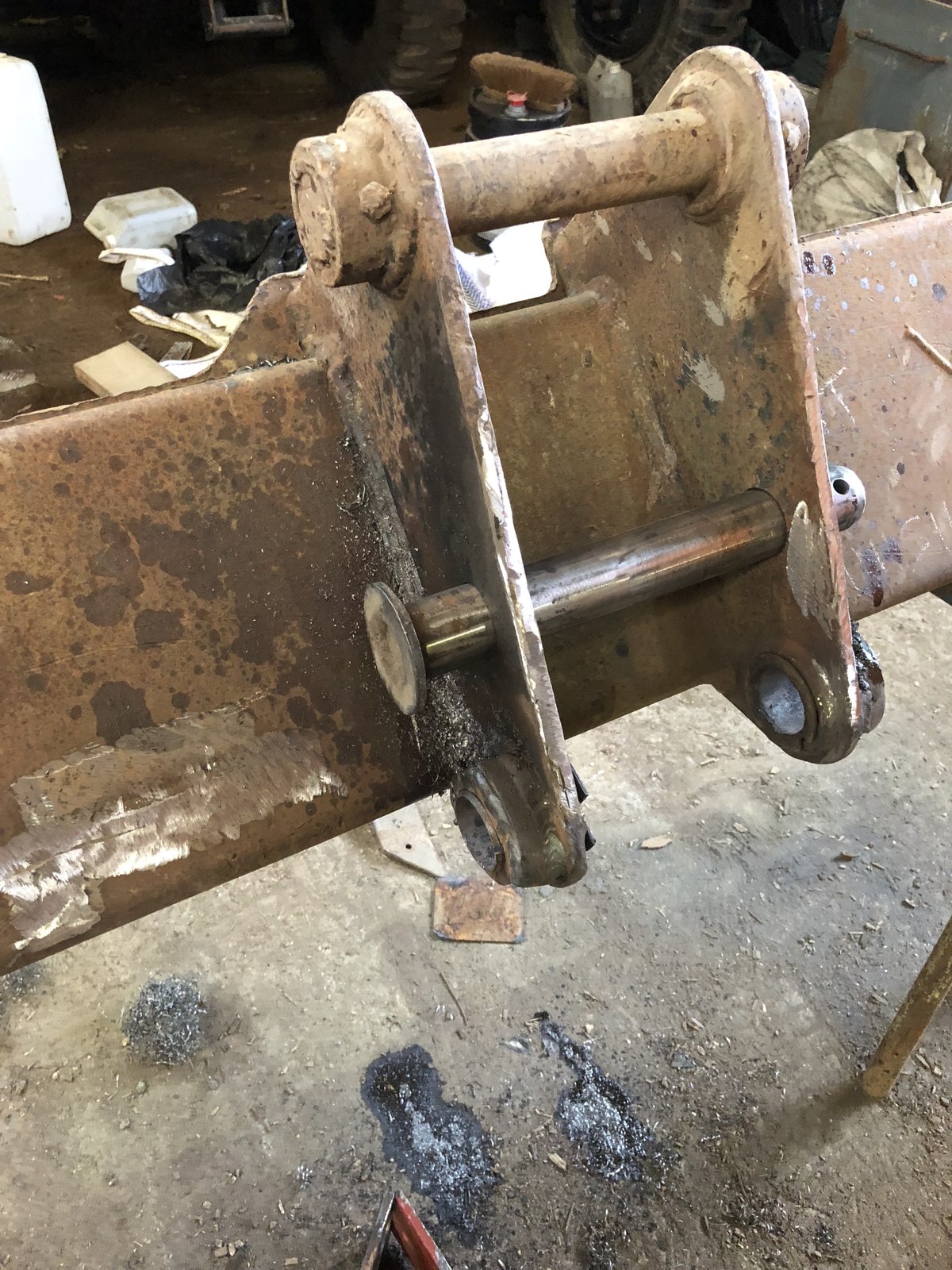

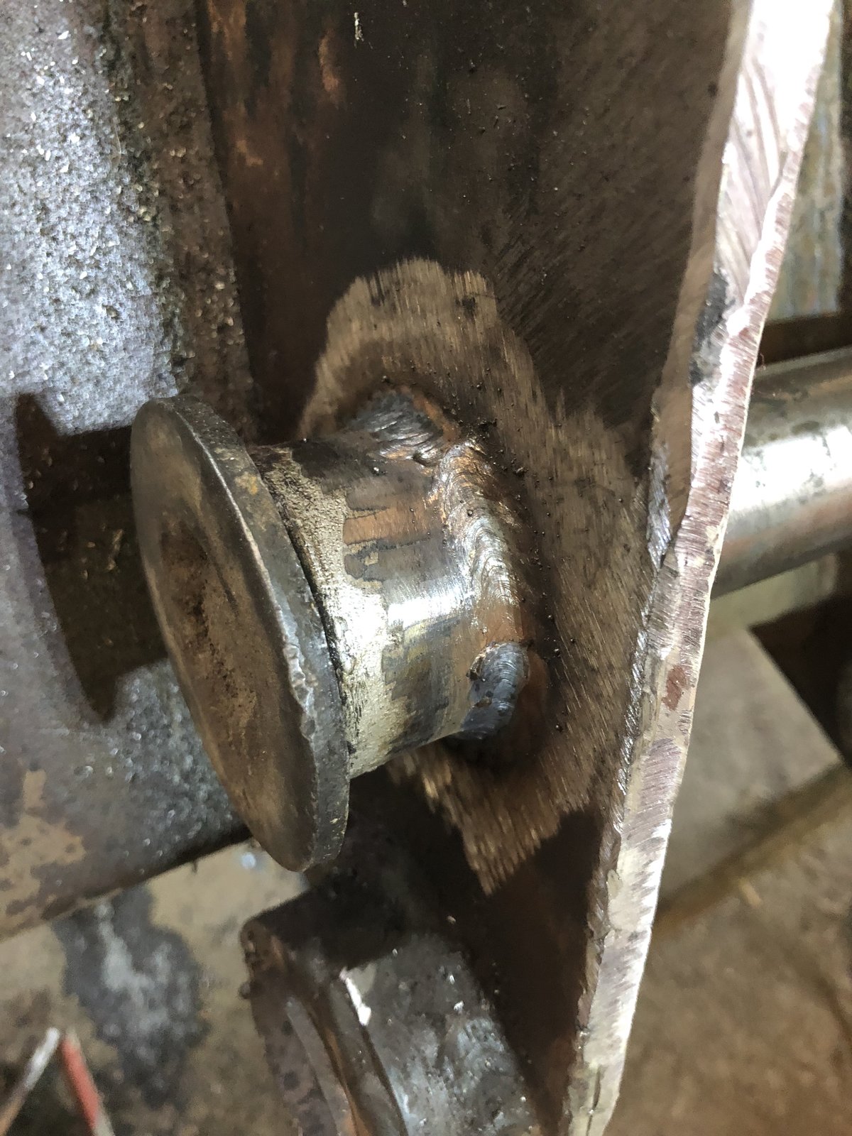

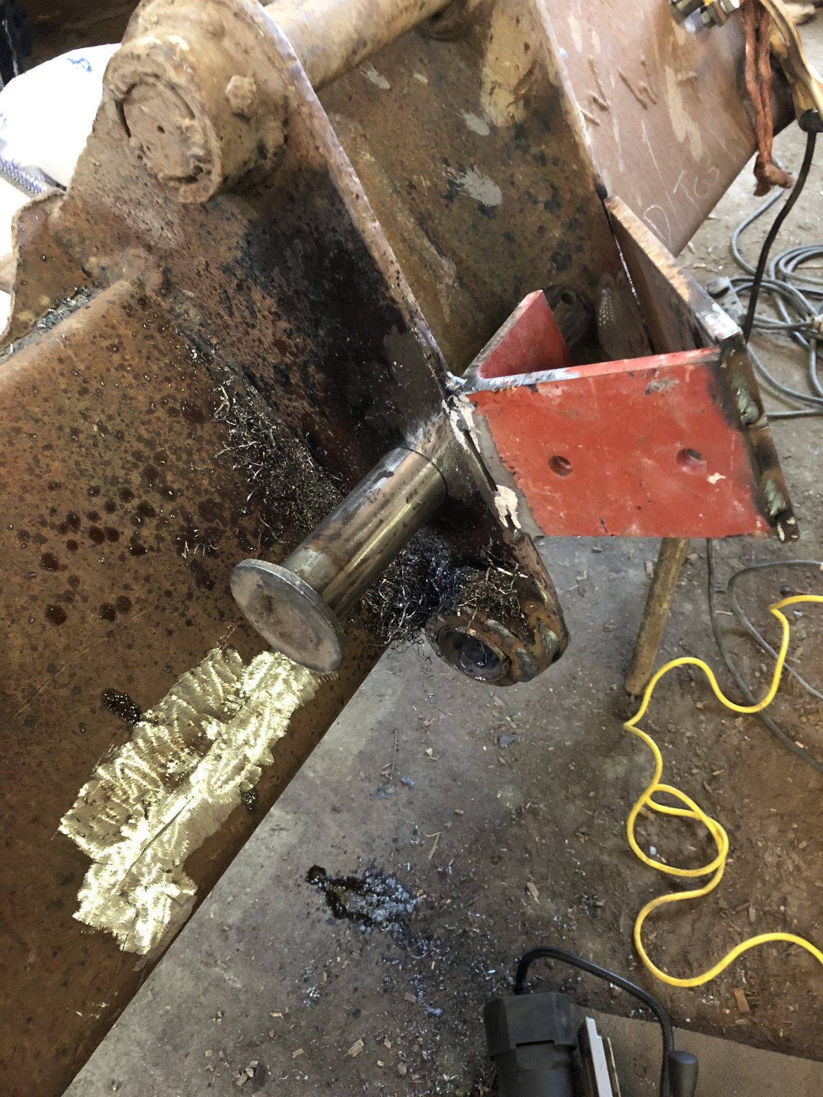

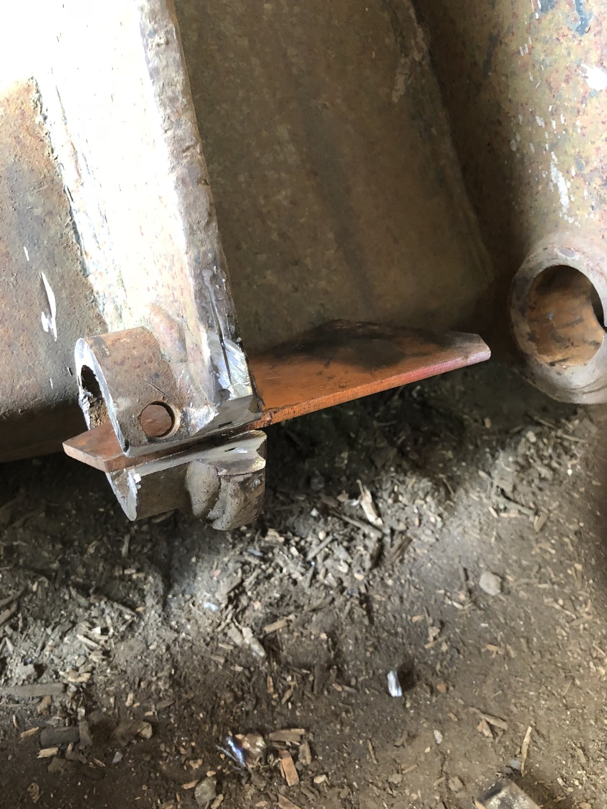

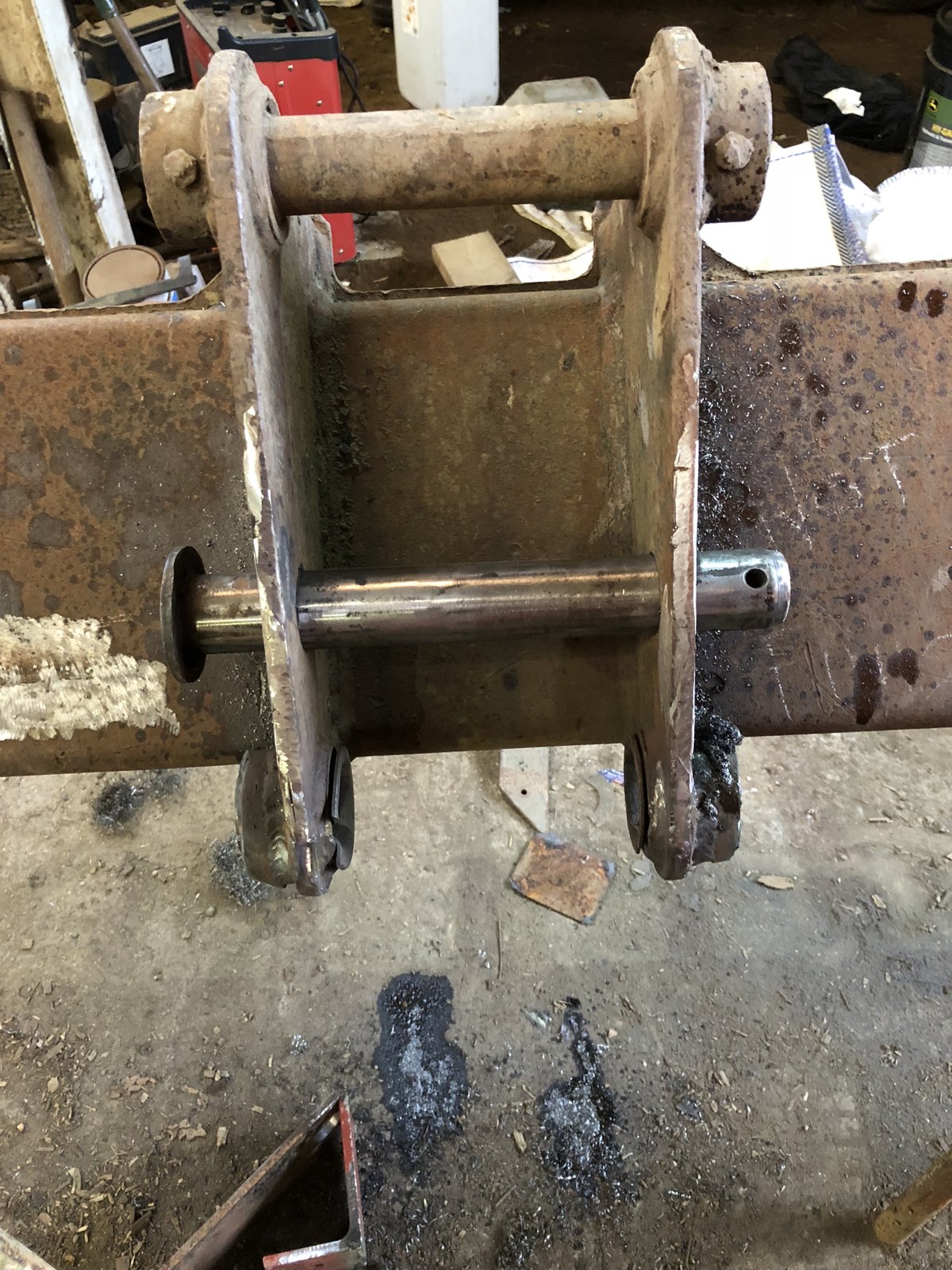

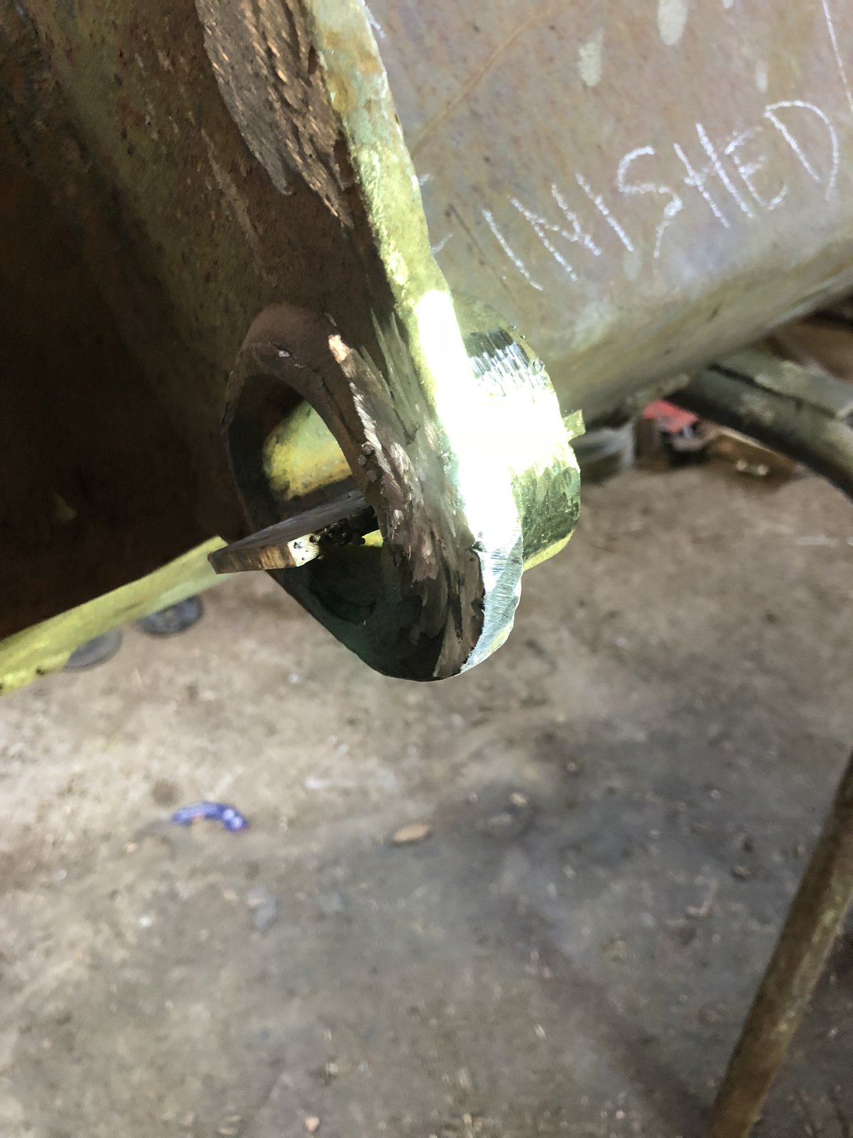

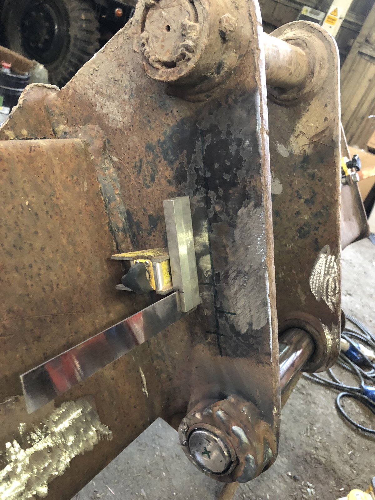

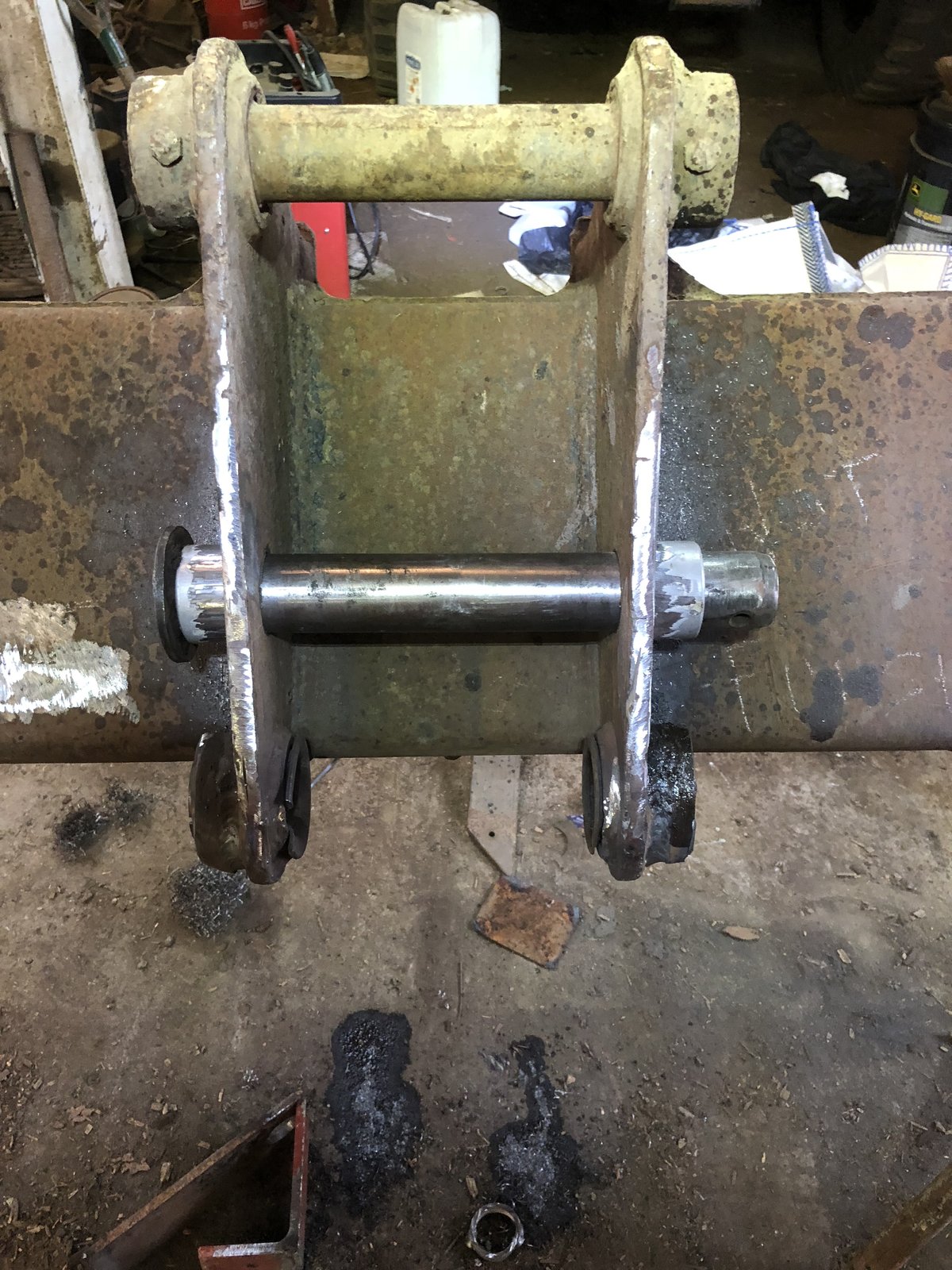

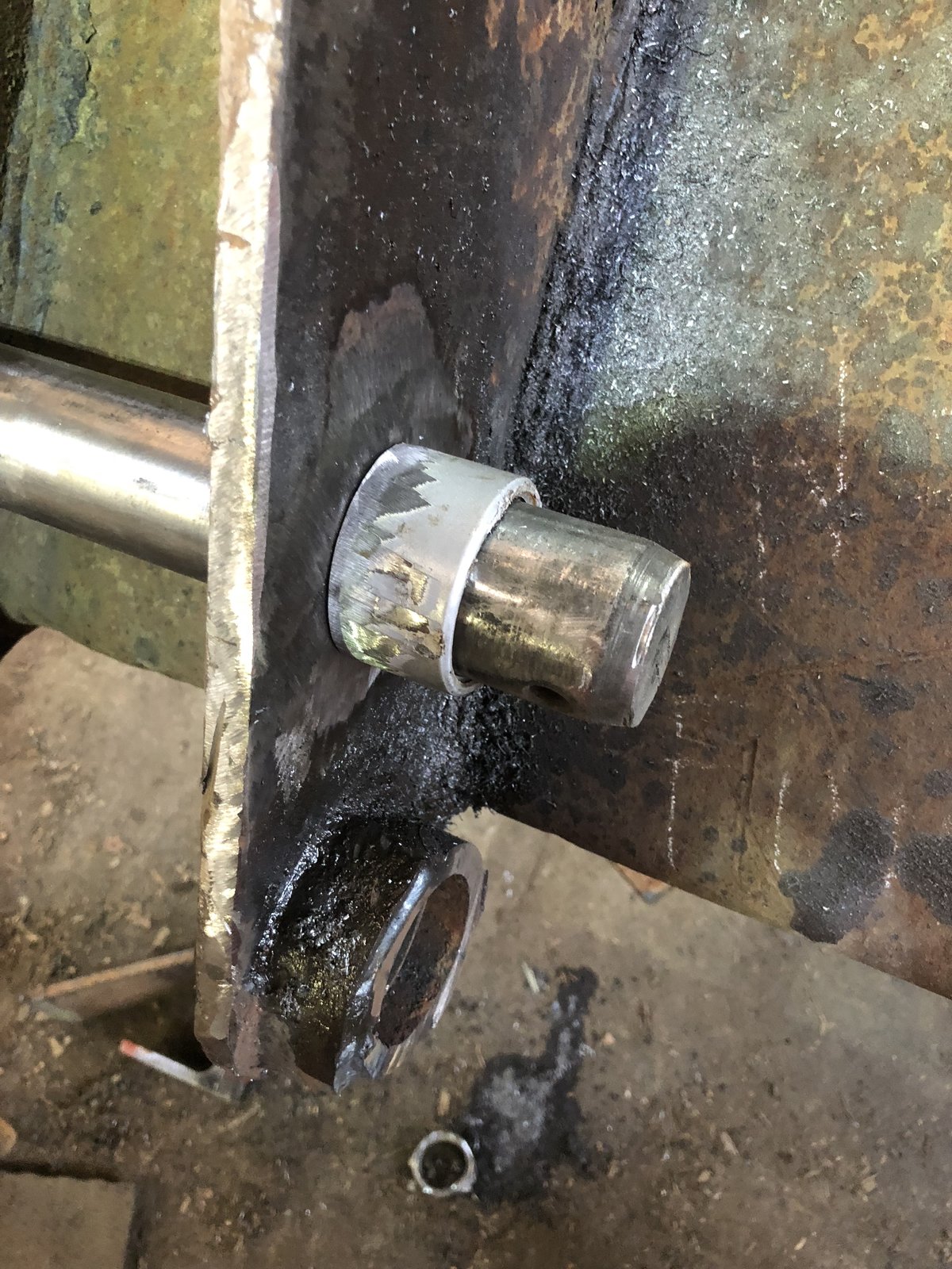

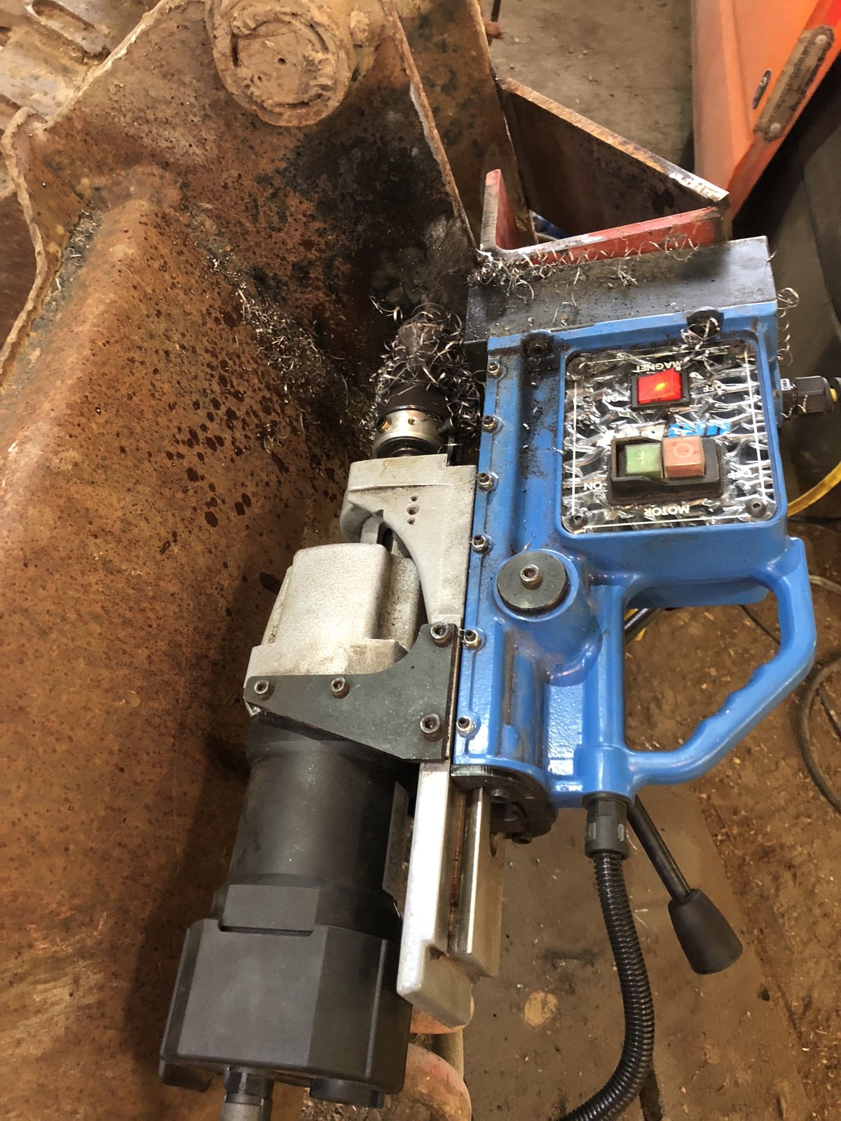

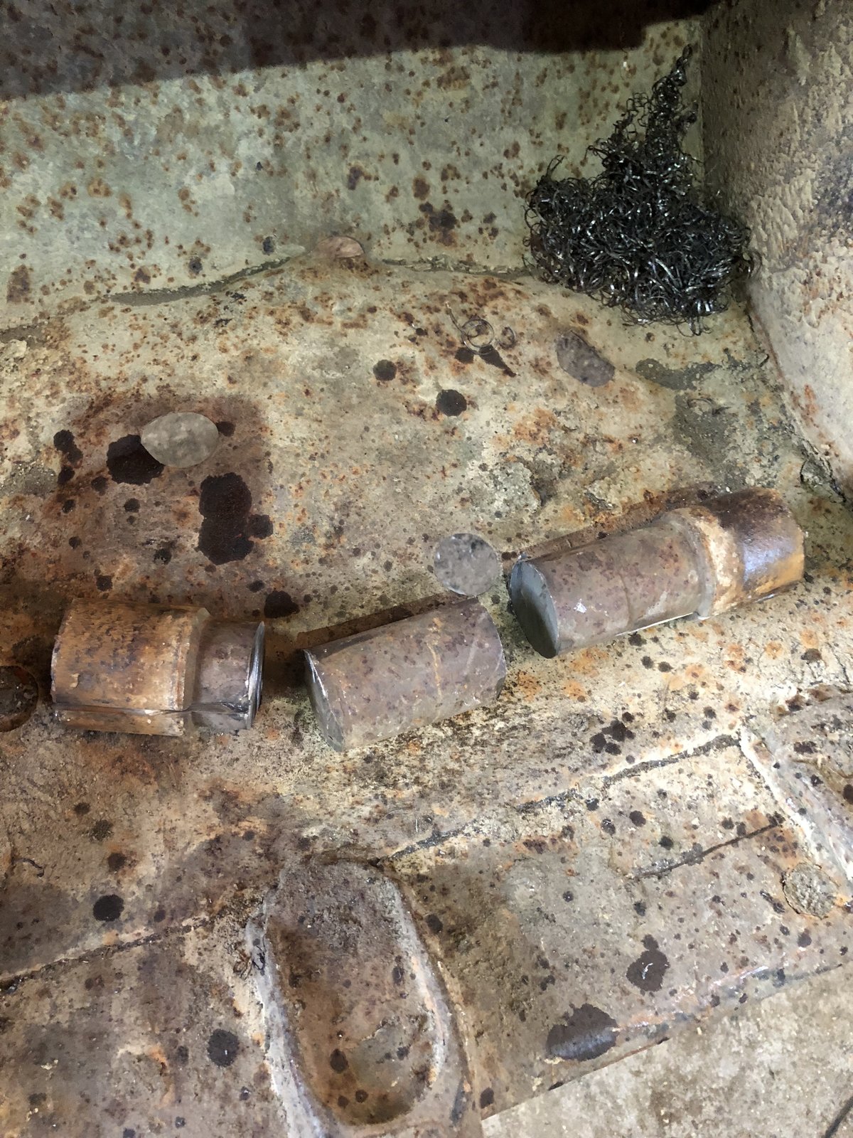

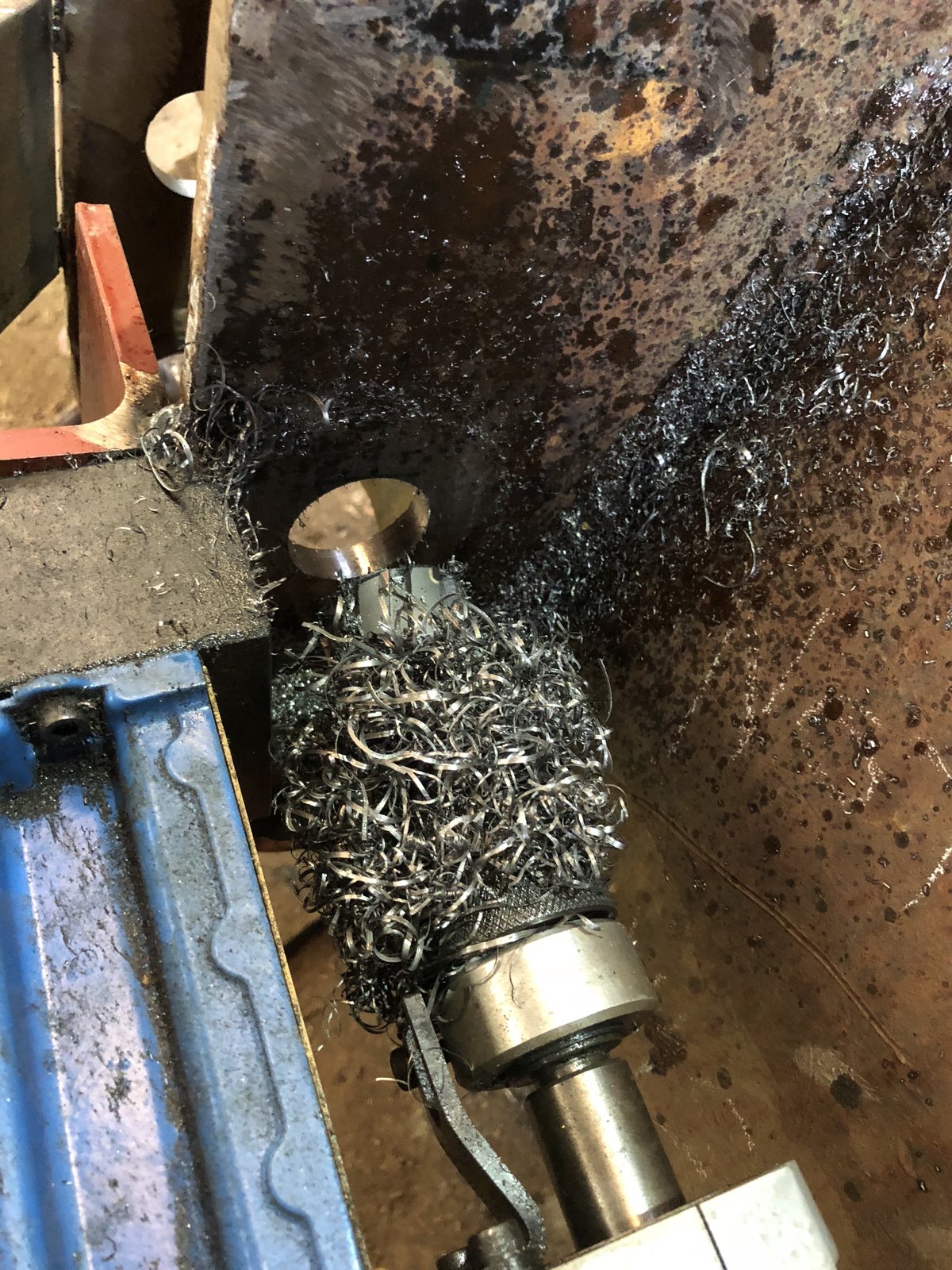

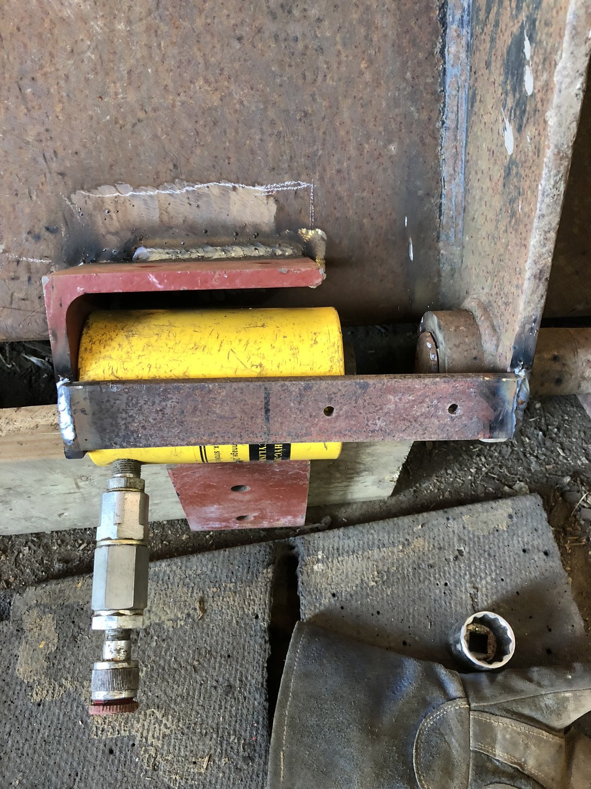

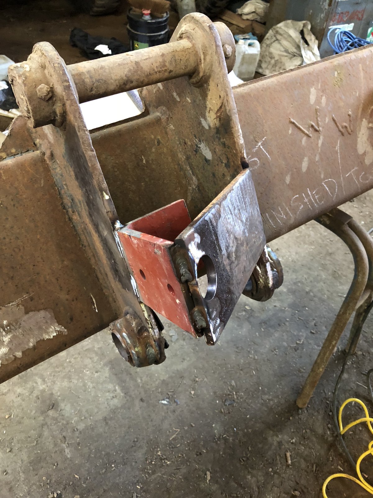

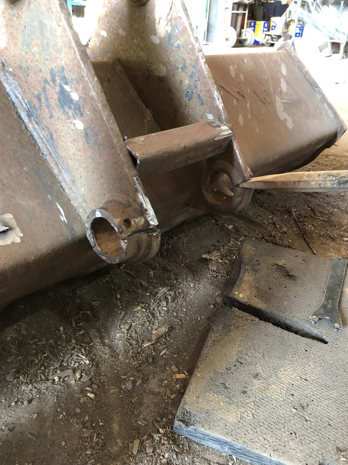

While I was at the farm they showed me a ditching bucket that they needed to get the pin out of. The pin was more than just a bit rusted in, it would not move even with a pushing ram. So I thought I would cut a section out of the pin and there by only have 50% of the pin to move, all that did was bend the ear so I then had to put a release cut on each ear and open it up with a chisel to get the pin to release. Then weld it back up. I used a Copper plate inside the bore so as to stop the weld running into the bore and causing me headaches. The bucket then had to be converted over to a 3 pin setup so it could be used on two different machines again.
