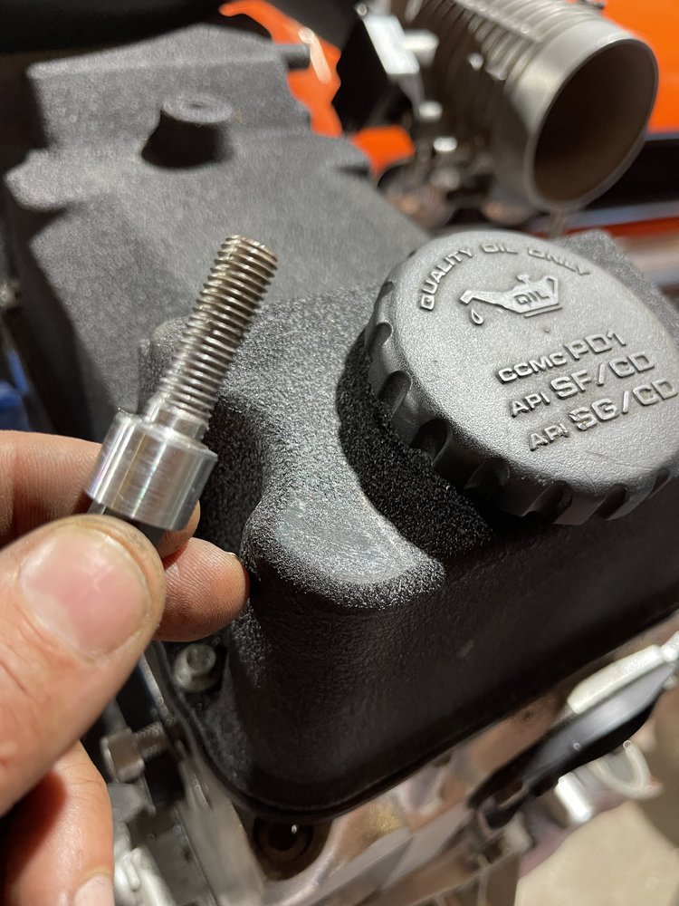

What sort of Mill Drill do you have Graham? Keep us posted on this project - it may be an idea I can steal off you!Over the last couple of days I came up with these two spring loaded plungers.
Made from a couple of 8mm bolts, they're to hold the handwheels on my mill/drill either in engagement or out of engagement. I'll machine a pair of grooves in both screws to locate in.View attachment 413156

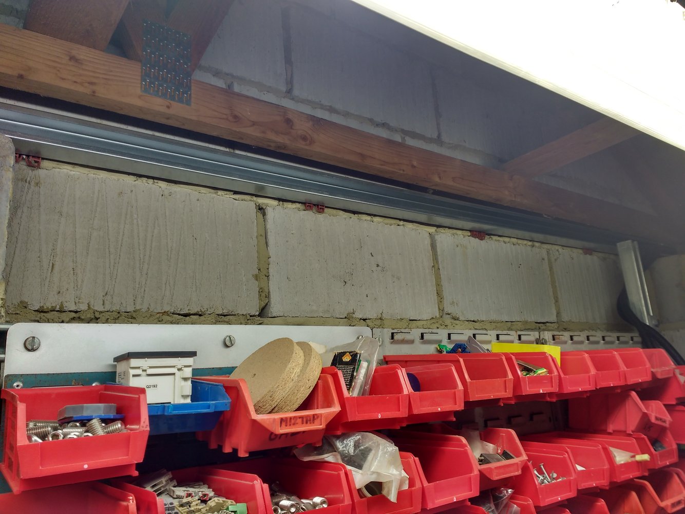

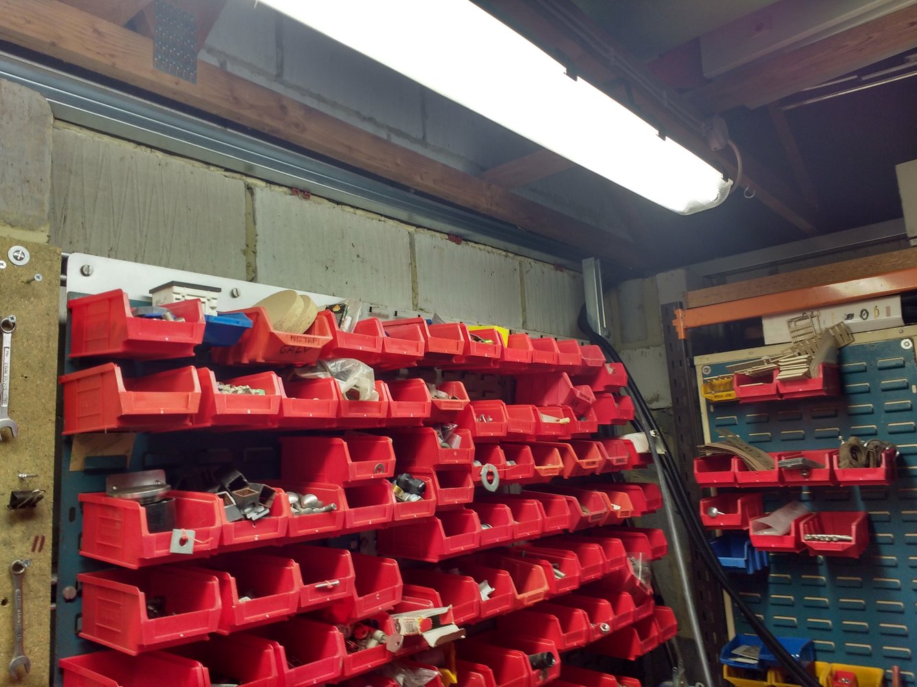

That's exactly what I need to do!More "made a start" than made. Been running 50x50 trunking round a double garage packed to gunwales with tat. Every shelf on every wall full to the ceiling. The plan was to leave a nom 13mm gap between top of trunking and underside of roof joists. This so I could slip plasterboard in there later. Didn't quite work out like that, I'd have had to have cut Celcon columns down. In some places I've just enough clearance to get the trunking lid on. If it comes to it later I can pull the cables out and redrill the trunking but I'd clear the garage first. At least I'll have tidied a length of SWA and two 20mm flexible conduits that have been draped across the garage for the last 3 years and should be able to get my gate powered up:

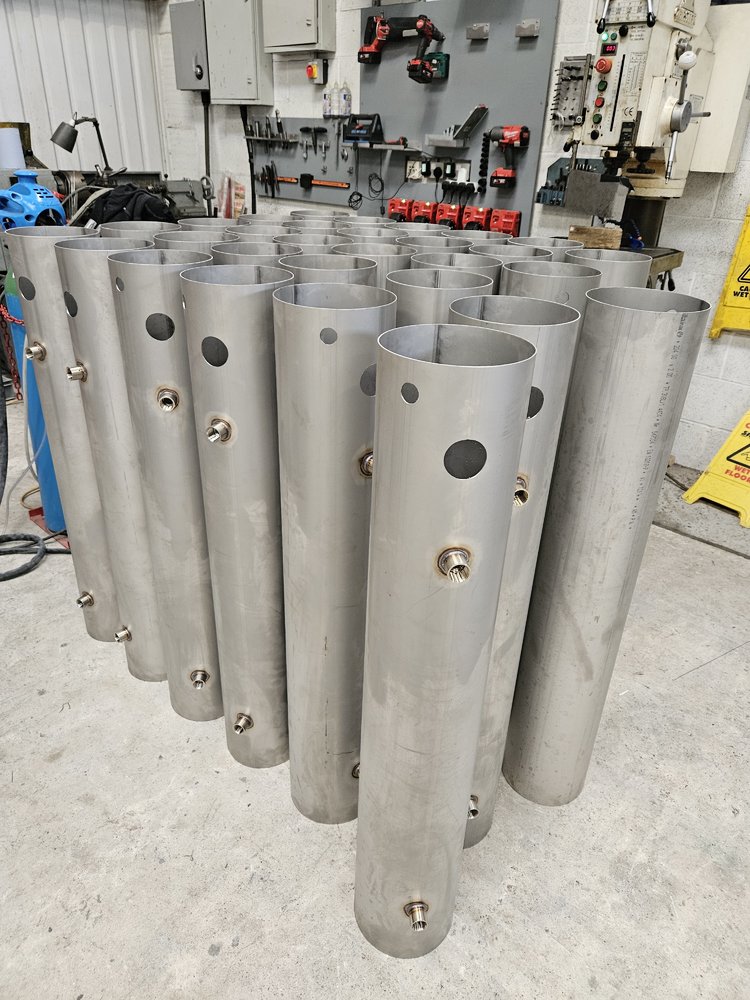

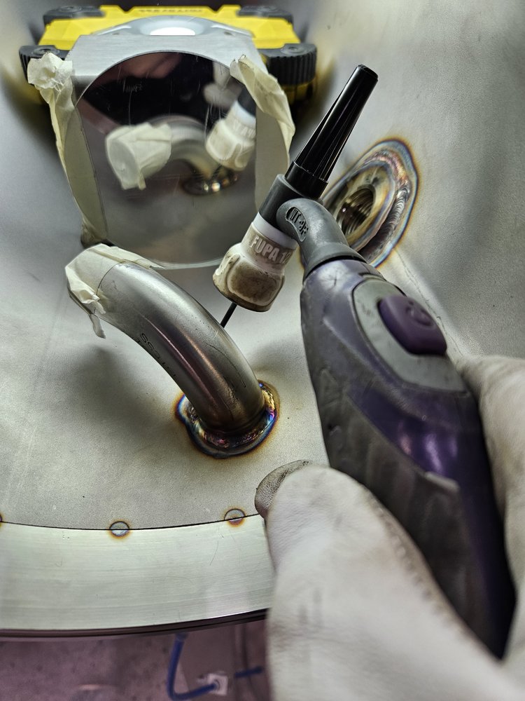

That looks like an artBeen working on some mini tanks this week...
Some fittings welded from one side only, penetrating through so it's a hygenic weld, but on some that wasn't an option, so welding the back side of the inlet bends and the level sensor of them by looking in a mirror
Been over to the tungsten grinder a little more often than usual

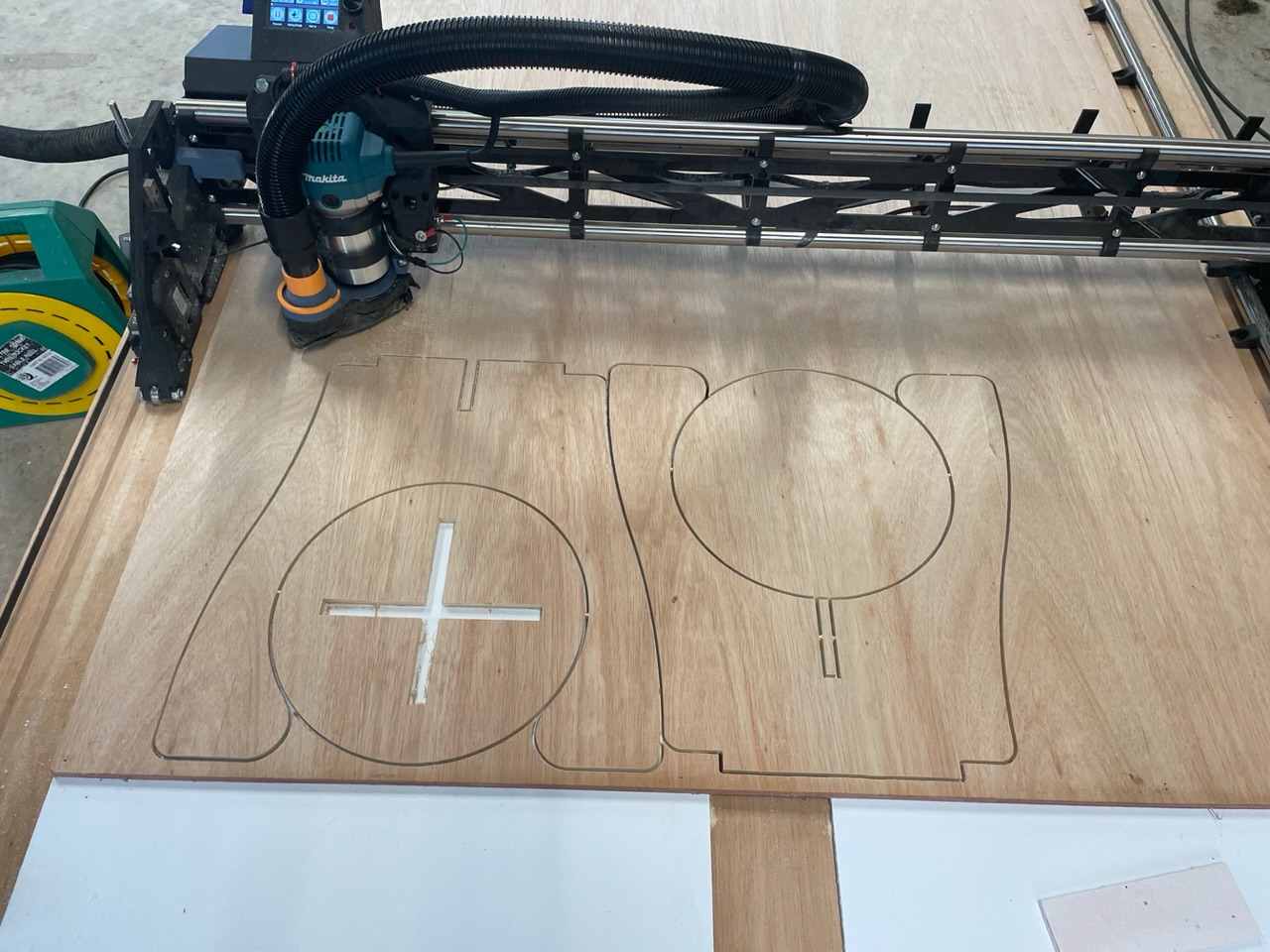

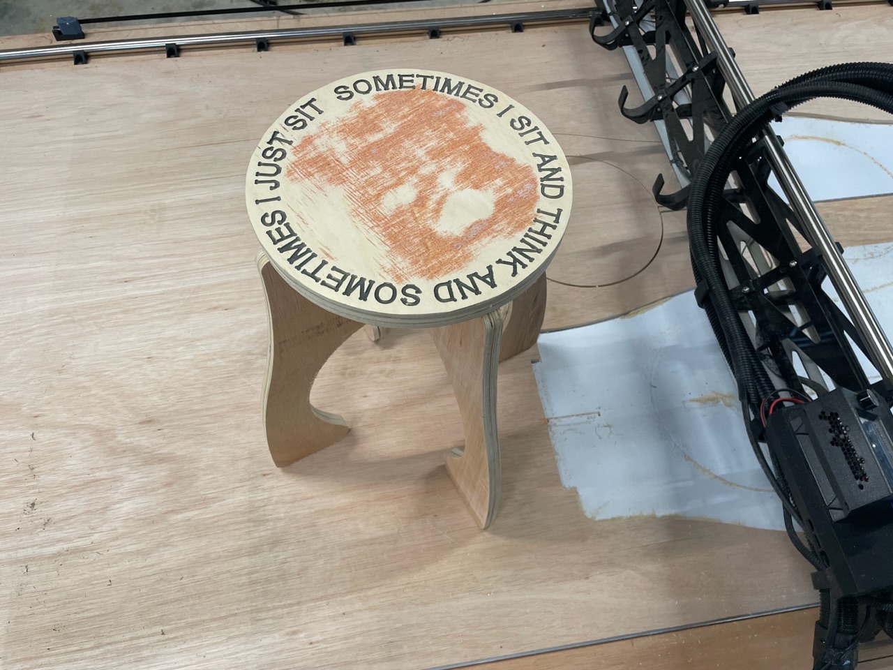

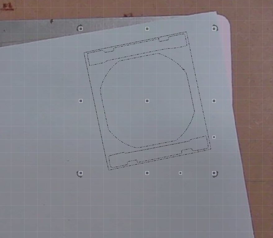

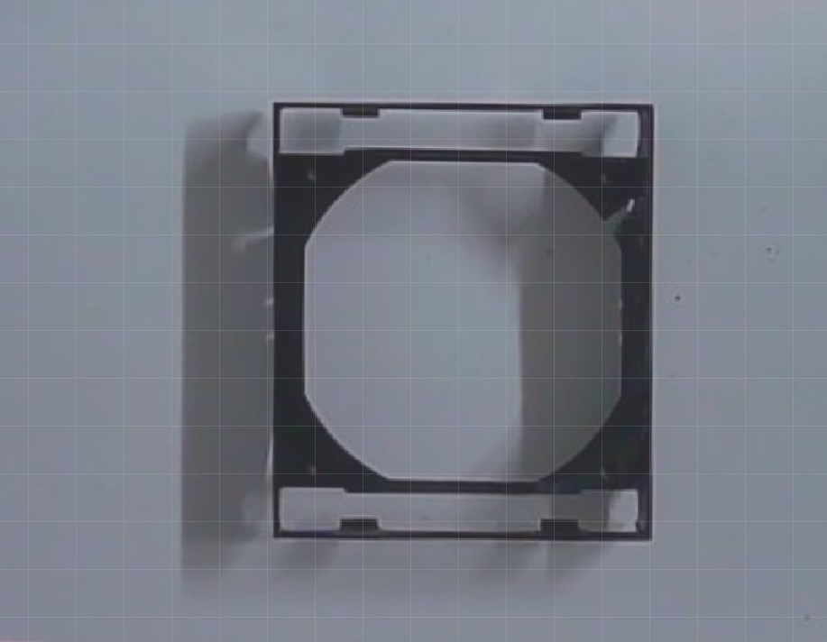

Interesting cnc.Self explanatory really, a thinking seat...
I liked this design as it has really very little waste, and I’m a cheapskate with the price of plywood what it is.

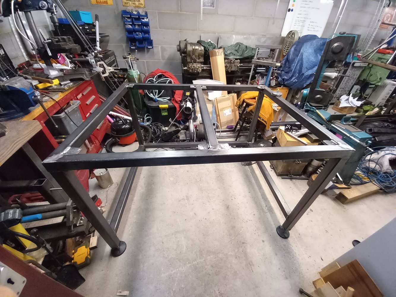

I just throw the nuts into hydrochloric acid and then rinse.A little more progress on my work table. Feet are on, fixing tabs for the top fitted, plus a support down the middle. The middle support will also do double duty as a place to attach tabs for attachment of drawer sliders. I need to buy sliders first to find out the hole spacing. I've decided on plywood for the top. Two stacked sheets of 18mm. The wife has pointed out that this gives me four top surfaces to swap over as they get damaged.
This is where it is as of right now. I've ground the top welds down purely to give a flat surface. The rest are all left to tell a story in future as they don't interfere with anything. It's lovely and rock solid with the adjustable feet.

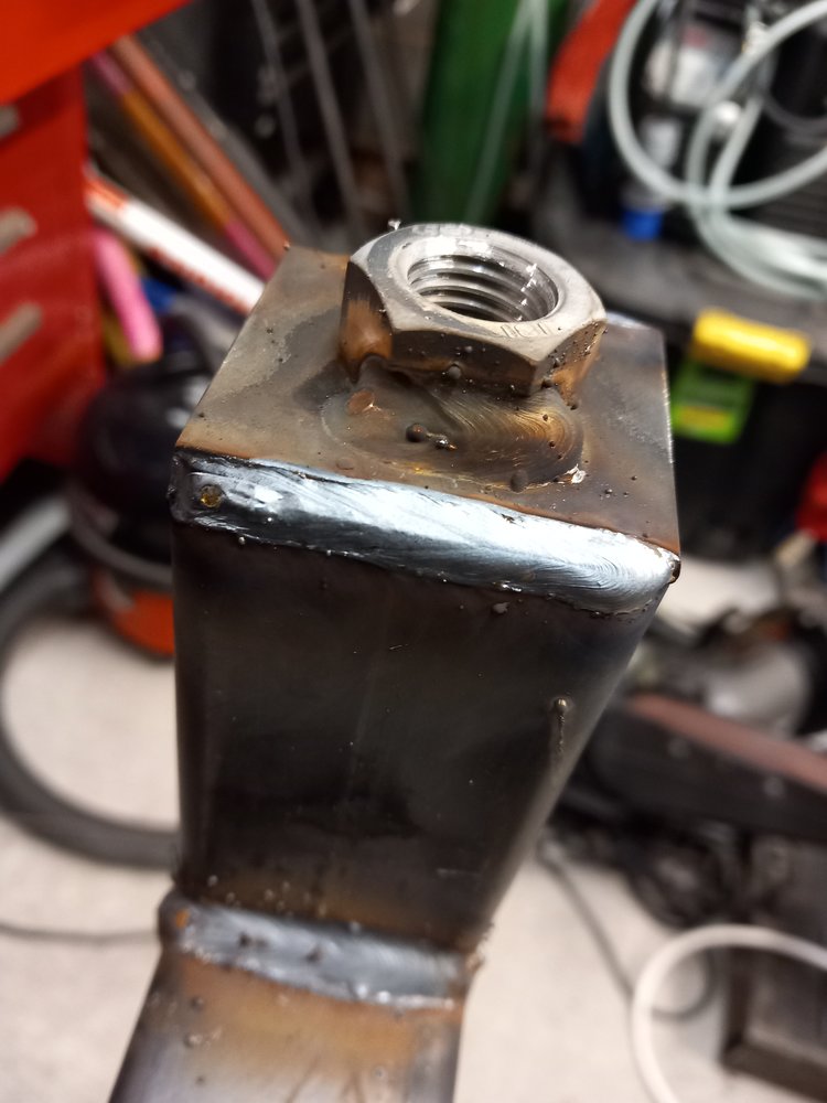

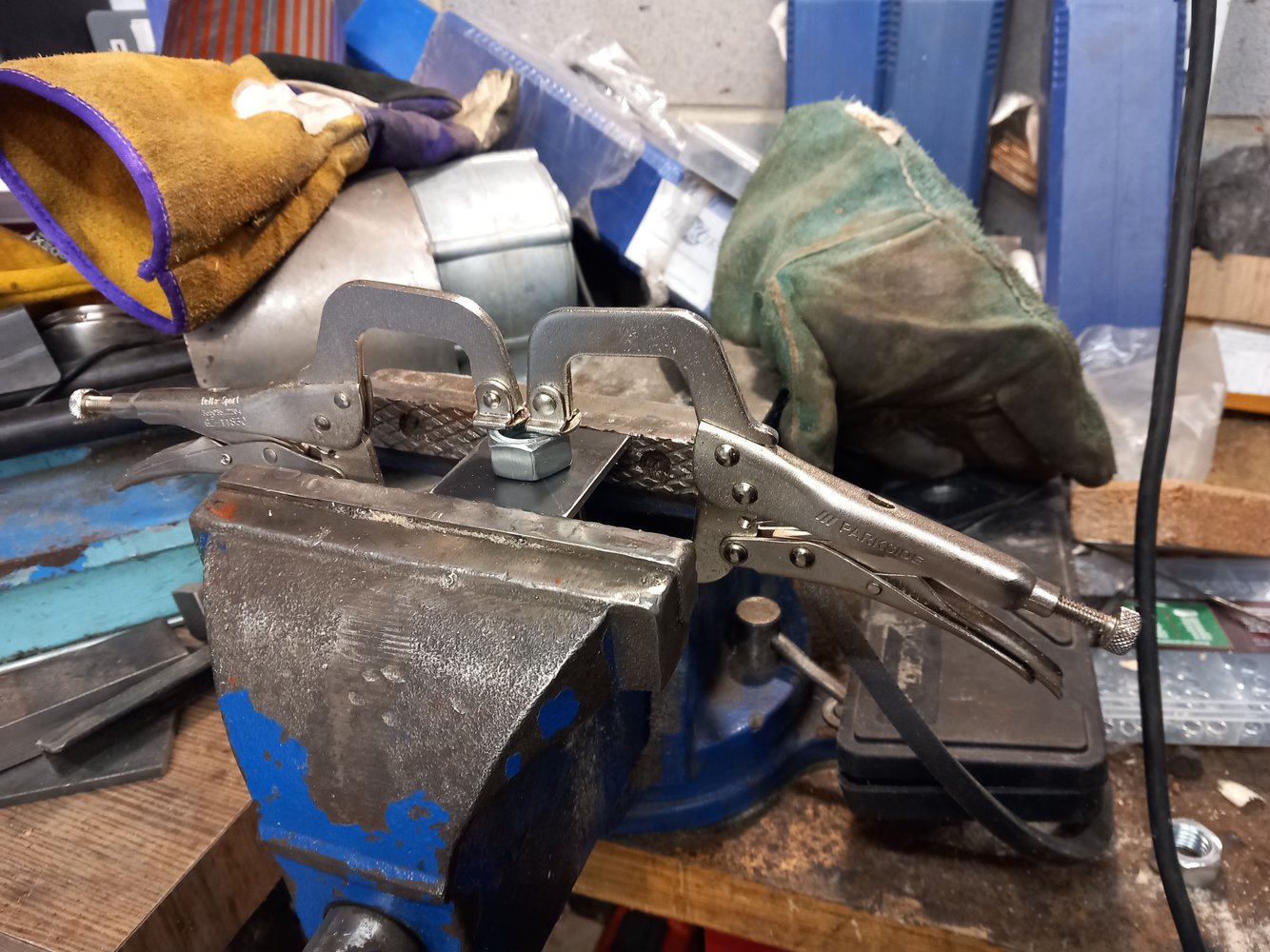

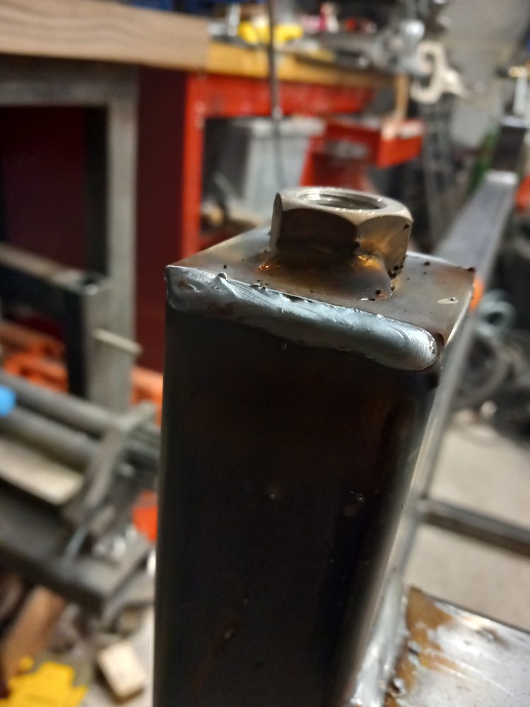

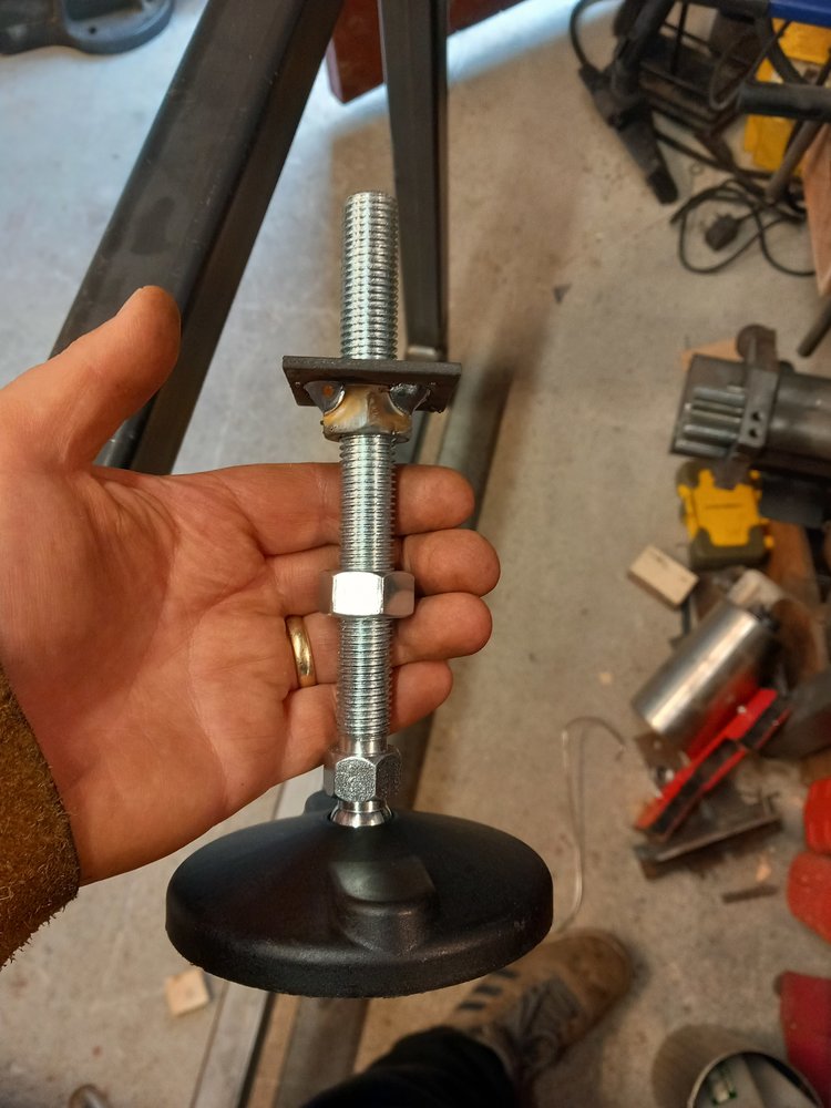

Set up for welding. Cheap Lidl clamps so not worried about them getting zapped accidentally. Zinc ground off the outside of the nut. Can't do anything about the zinc on the threads.
Welded down two sides. M16 by 2mm tap run down to remove any tightness from warping or the zinc falling off. Fortunately, I'm not short of this size tap.
M16 thread is overkill but they were the same price as M12 and all the weight and shock loads go through very few threads, so I went big. I think the foot diameter increased too which is a good thing to spread the load.

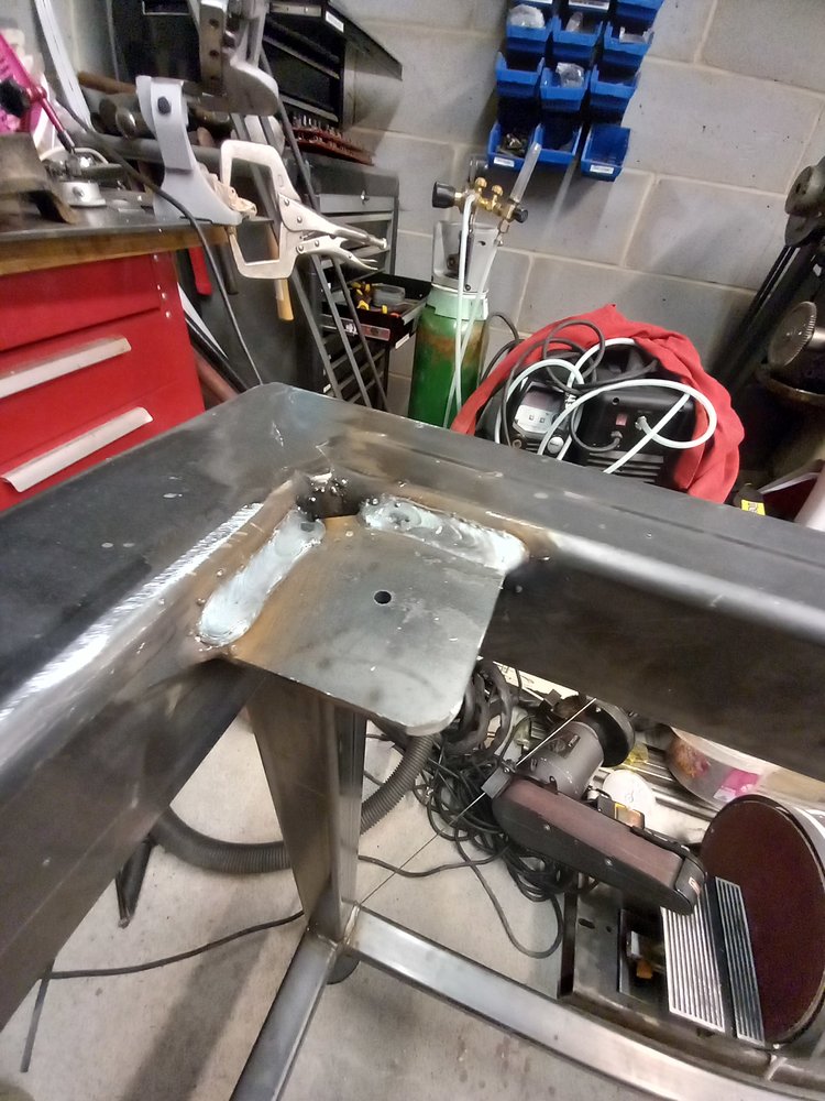

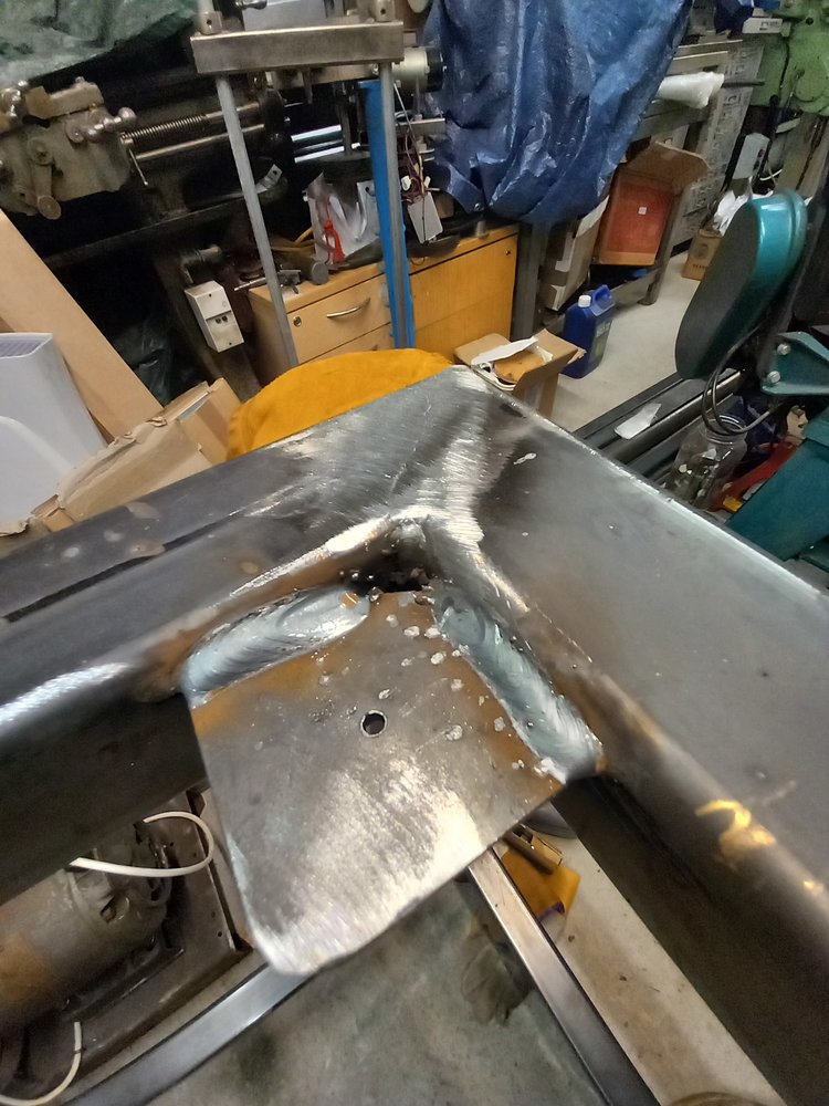

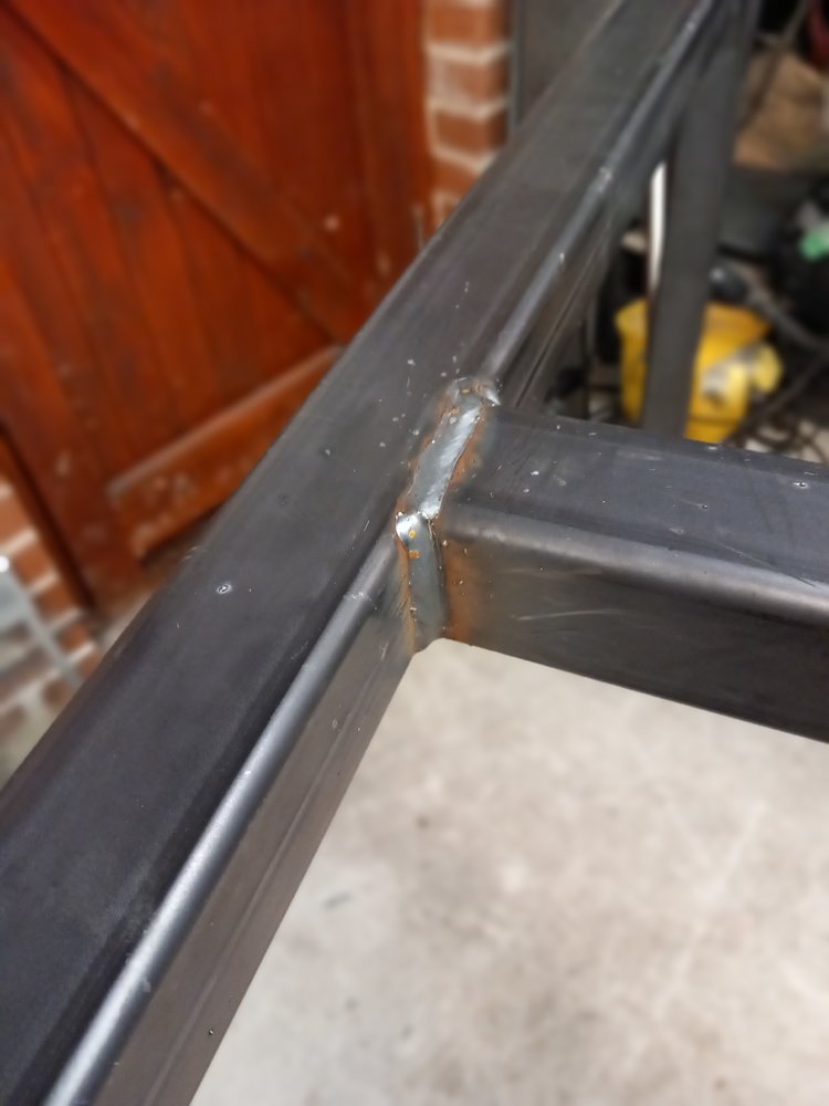

Couple of welds. Needed to run a bit faster on this joint than the others. It caught me out a little at first.

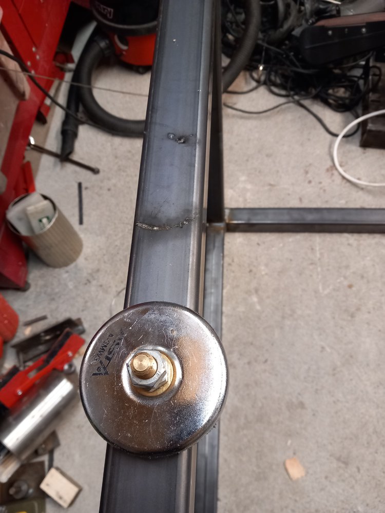

Spotted this evidence of a poor return connection from last week. It had been arcing out. Thought it was interesting and worth a mention. I had mistakenly been rotating the brass thread a lot which pulled the brass screw away from the material so it had arced around the chromed cover edges rather than through the brass in the middle. Lesson learned.
