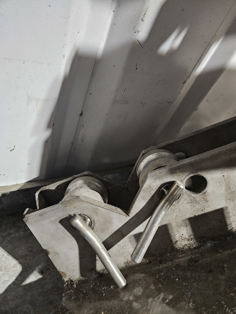

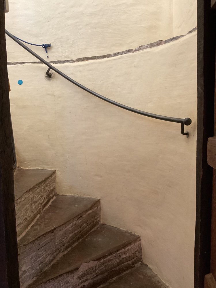

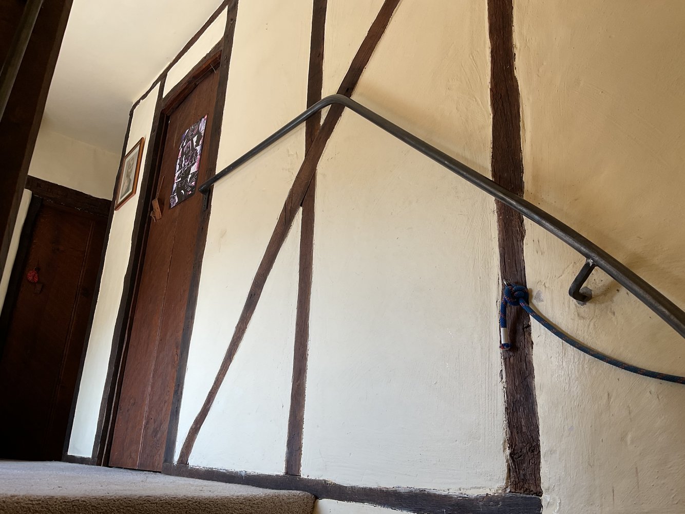

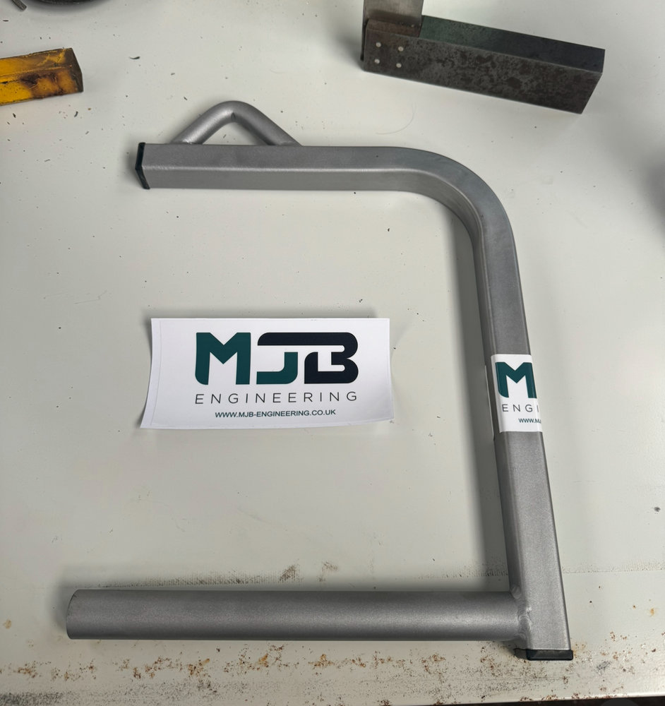

I make them with rollers for doing round bar, minimises drag marks.Cut a bit of 8mm steel to weld to the press tool I made yesterday.
It serves to locate the stainless blanks.
I cut another couple of blanks today and only after pressing the first one did I realise I had picked up a bit of 5mm to cut rather than the 4mm, I had a heck of a job getting the tool out of the stainless. So as I had another I made another tool that was 2mm smaller and got the next piece of stainless pressed and removed easily.
I welded the sizes on them so I knew for the future.
Pic of the 5mm hook after being in the press brake
Next I wondered if I could make up another tool so that I could bend some 8mm round bar that I will weld to the hooks.
Did one and it worked great so thought I would do the other 3 at once and see if it would work.
Easy
I also welded some ID onto that tool
Now all I have to figure out is how to reduce the marks on the stainless as I press them, I used some slideway oil and it did help but maybe thicker oil or grease may work better.
