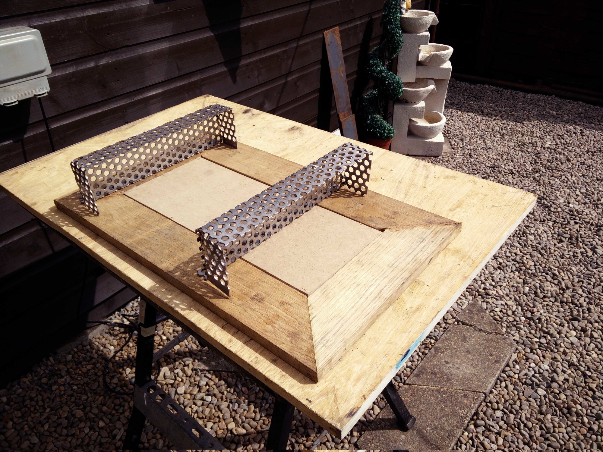

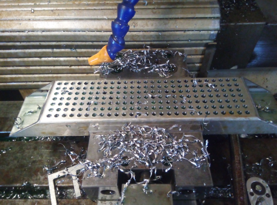

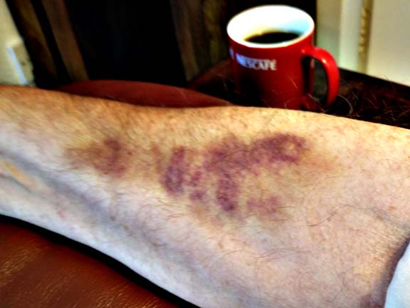

Well, made day before yesterday. An heamatoma trying to prove my bench folder [with myself on the end of the twin arms] was up to bending 2mm perforated stainless sheet. We weren't.......
Even with help it wouldn't do it - started to lift the worktop so gave up. It's fading now......

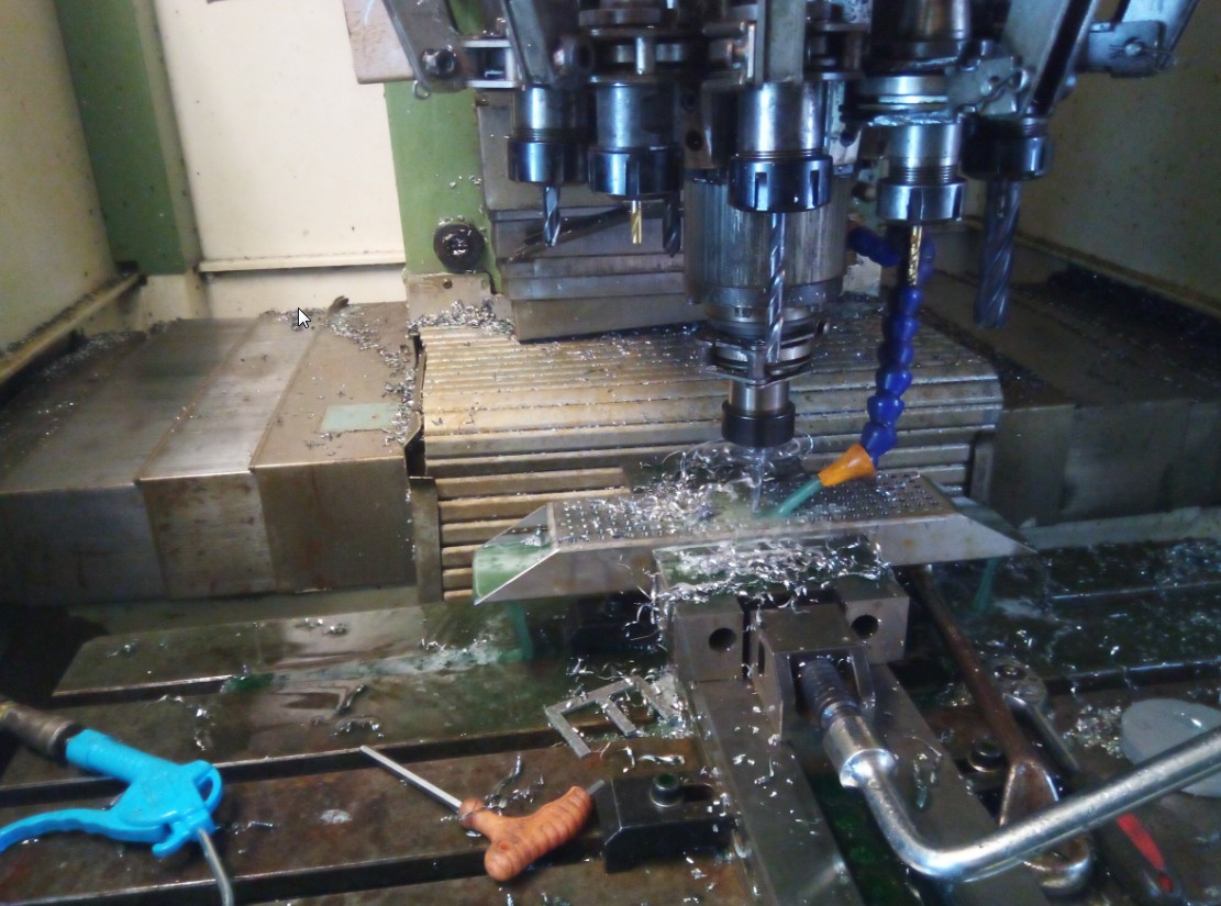

I managed by carefully scoring across the bend line with the angle grinder - no problem.
