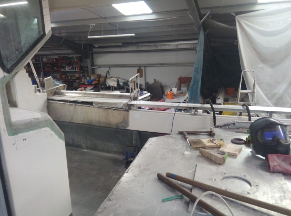

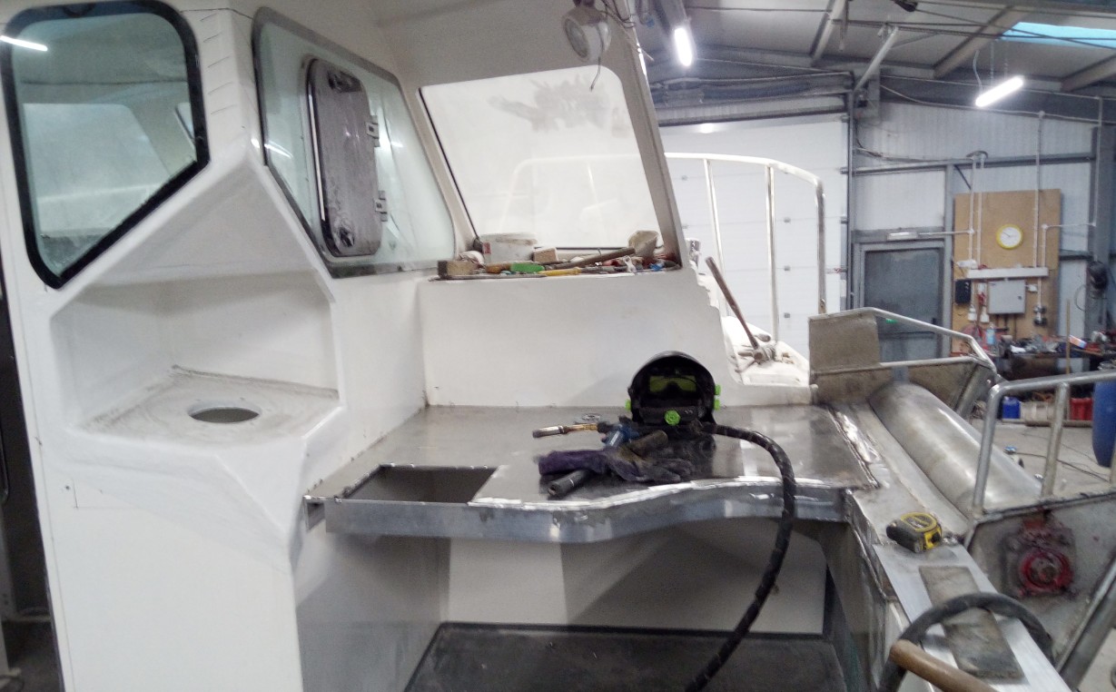

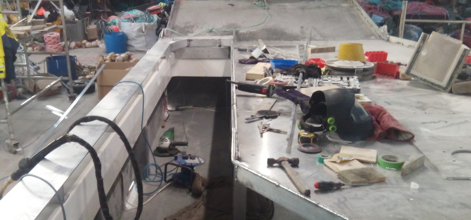

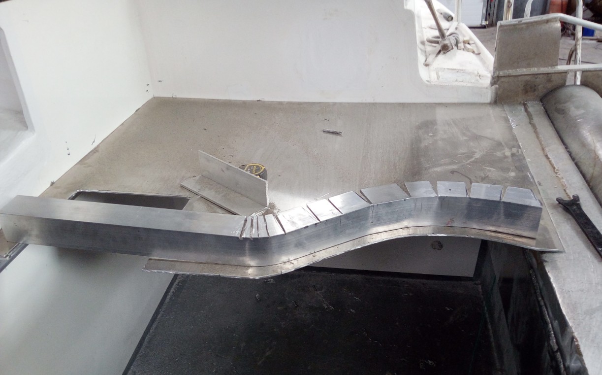

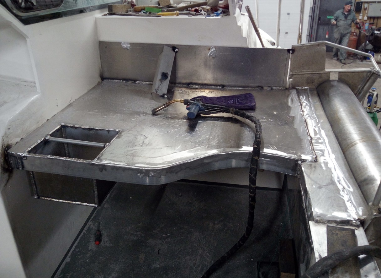

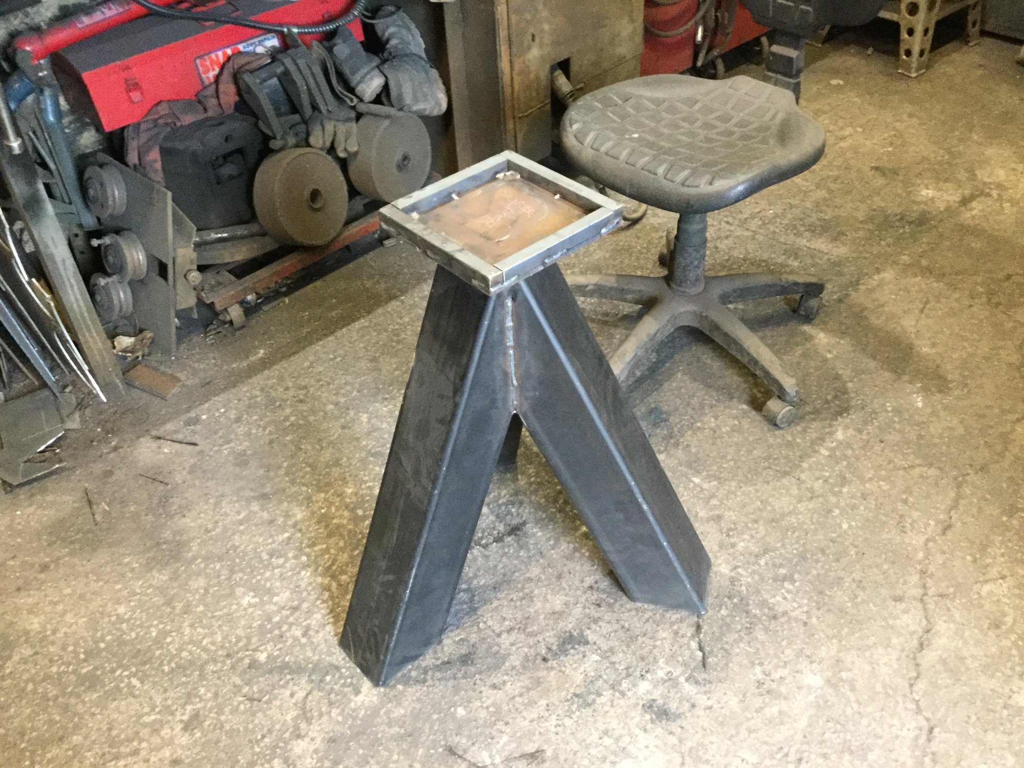

Bit more done today, gunwale raised so that it is level with the roller system and the aft section of the table. Plastic will top this make sliding the creels down the boat easy. Also welded some 3/4" round bar to the top edge of the angle on the table to help for wear on the ropes as the creels are shot from the table.
Also got the supports made up for the lifting section of the table.
Next job is to fit the hauler and make up the roller table and bait box, hopefully will get that done on Sunday..
