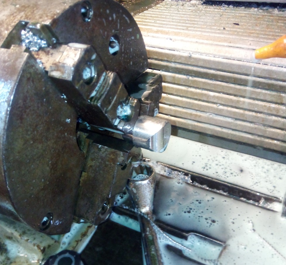

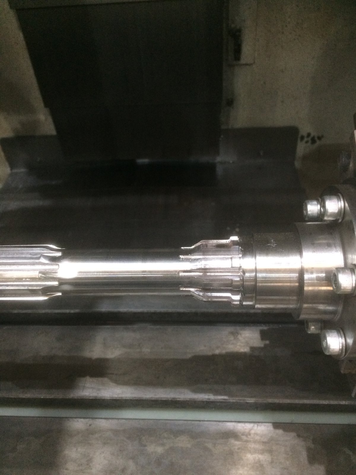

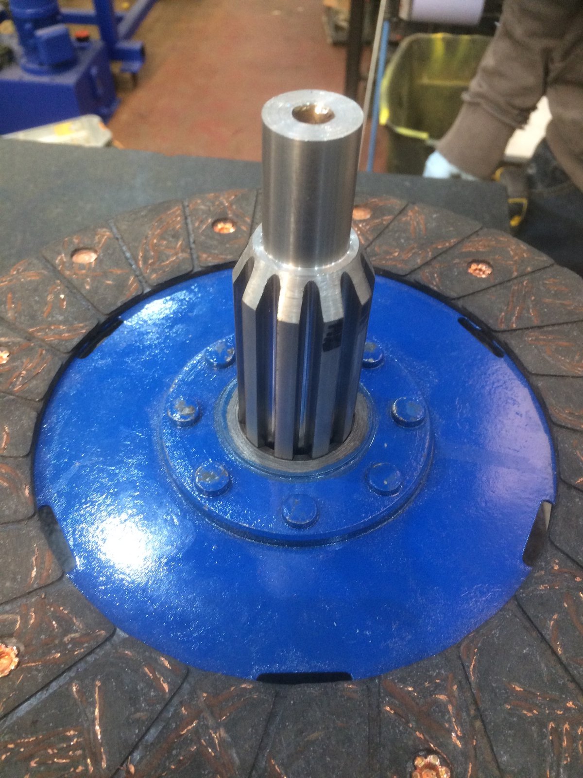

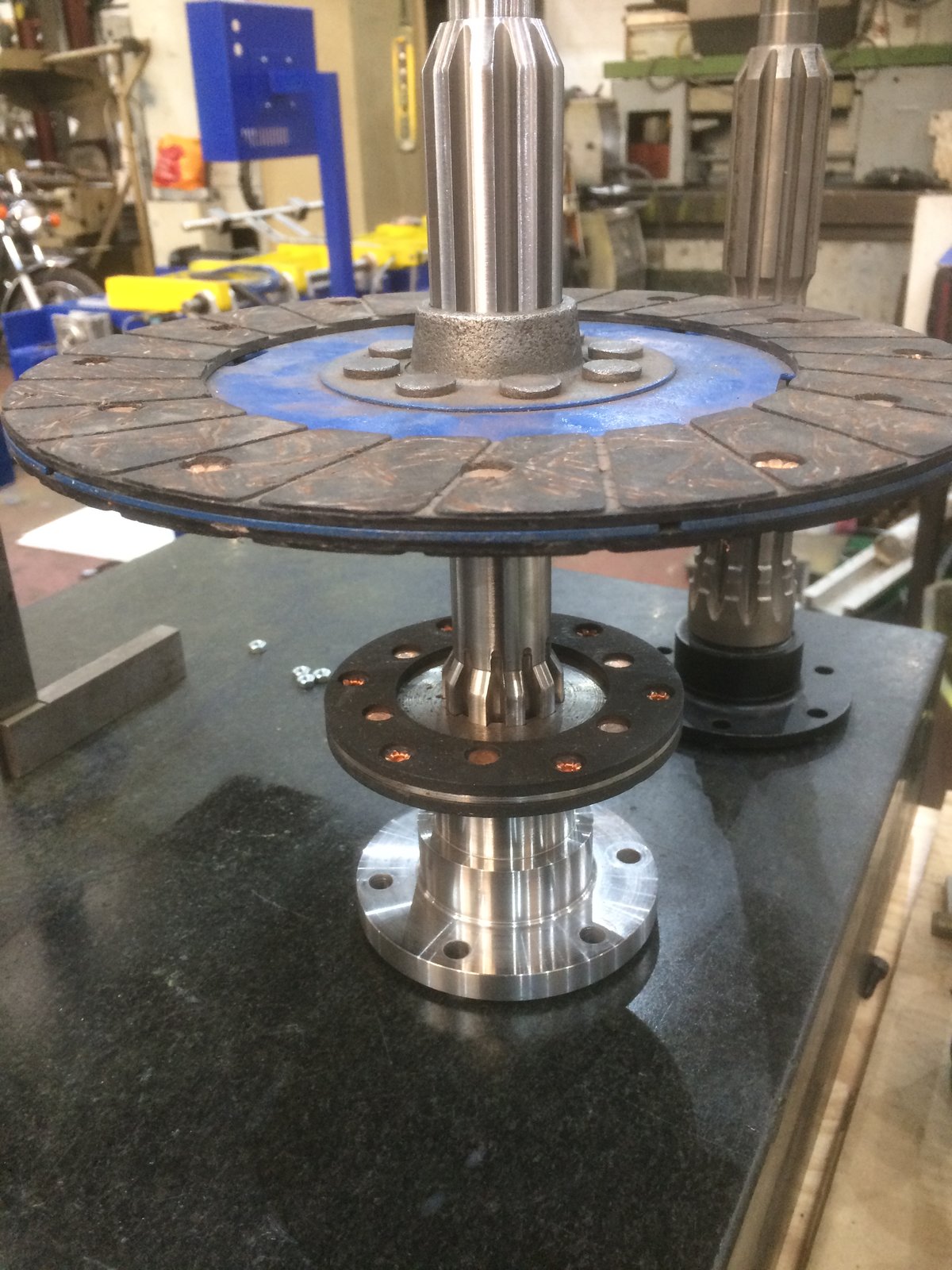

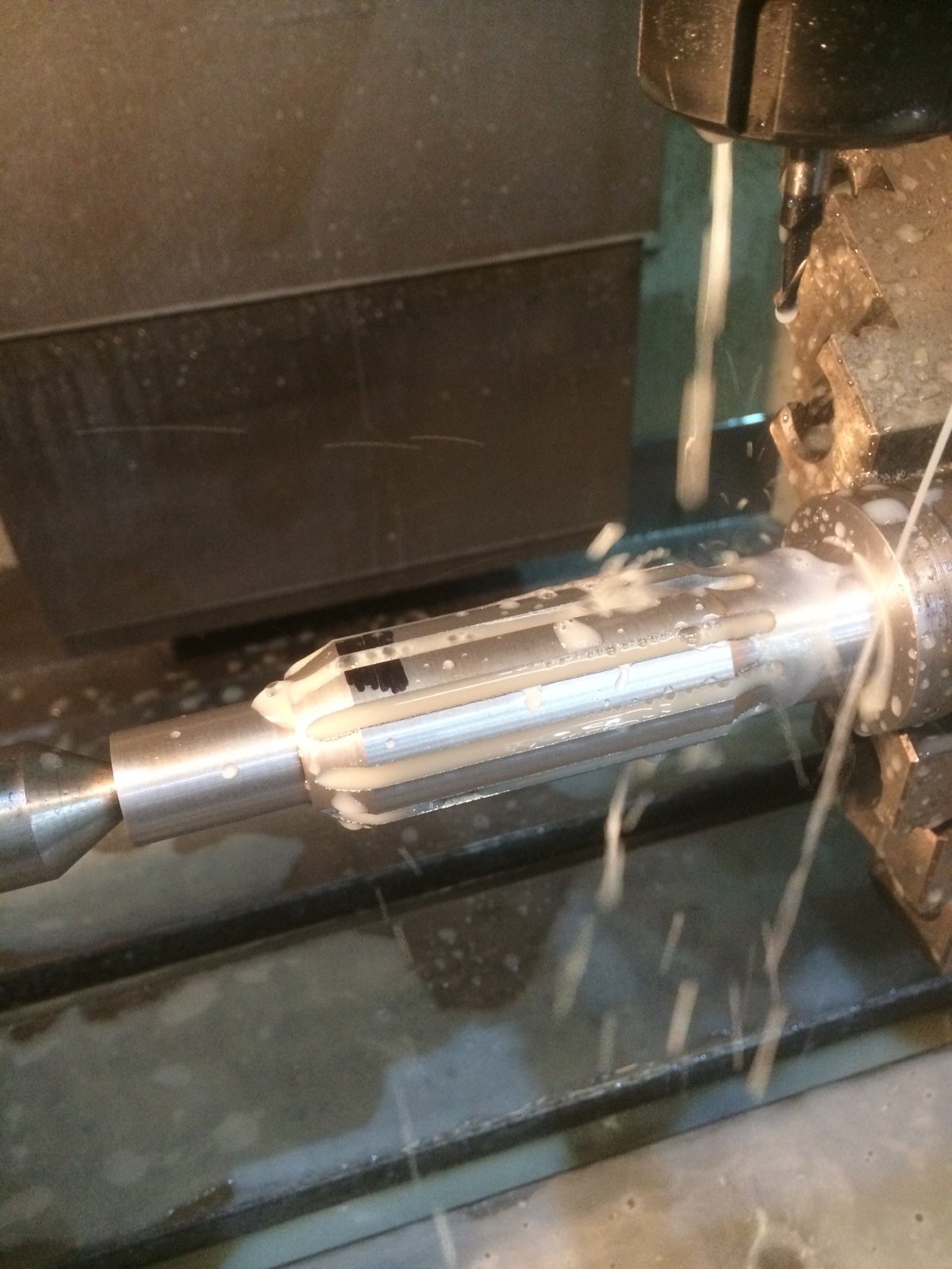

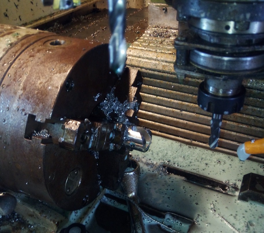

Is that a tapered ballnose cutter? Did you get it specially ground or is it just a standard item?View attachment 174328 View attachment 174329 View attachment 174330 View attachment 174331 Been making a new spigot shaft for a 251 half track. Cutting the splines on the fourth axis worked really well. Strange system in that it uses two clutch plates with different diameters and splines.The smaller one works more like a brake to slow the shaft down and help get the thing in gear. Engine and clutch in the front,gearbox connected by propshaft .
