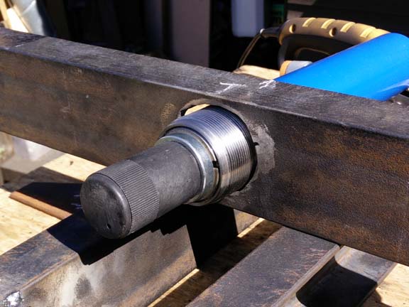

Today, among other things done, I made a hole......50mm through 10mm plate using the largest of my Banggood hole-cutter set. It was hard going and took ages, [I have no idea of what grade the steel is, it's 'skip booty' ] with the drill jamming frequently despite light pressure and copious applications of oil. In the end I had to drill through from the other side to complete the cut. Maybe I'm expecting a lot from the poor thing , but the biggest drill have I could use on the lathe is 16mm blacksmith's shank.
Another one to do yet, then I can proceed with Plan A for the hydraulic bench press.
I'll offer a tip for hole sawing - drill a couple of smaller holes inside and tangent to the desired hole for the chips to fall through, I've found it stops the hole saw jamming up.
Dave H. (the other one)
Keeps em sharp longer too. Been doing this for yearsI'll offer a tip for hole sawing - drill a couple of smaller holes inside and tangent to the desired hole for the chips to fall through, I've found it stops the hole saw jamming up.

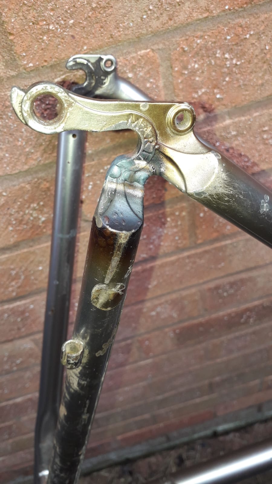

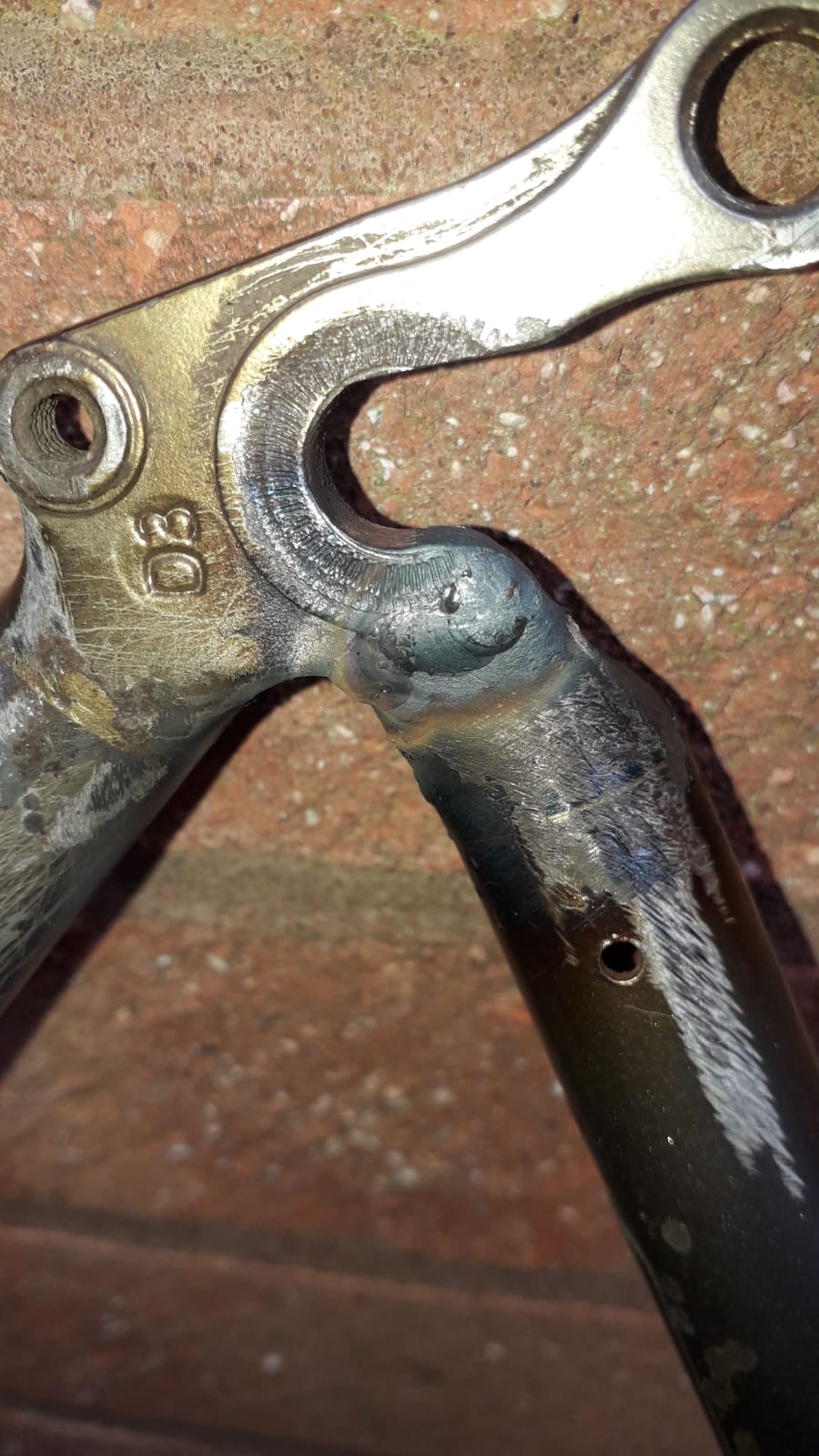

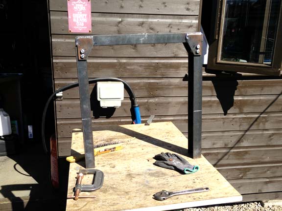

View attachment 176799 Getting closer with the yokes
What are for
A Ducati race bike.

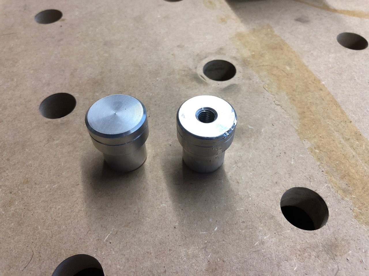

Yup. Wouldn't want to be without them now. Perfect job for a capstan banging those dogs out in numbers.Been making quite a few bits on the lathe slowly getting to grips with the basics. This is a really simple thing but I use bench dogs a lot on my tables and generally buy aluminium ones from eBay. They are hit and miss with wide tolerances which can create wobble and wear the holes. I decided as I needed some more to make them myself. I made mine to be bang on 25mm with a 19.98mm dog rather than the usual 19.75-19.9 (ish) fit. The fit is rock solid, it amazed me how much that tolerance helped in the MDF hole. This prototype took about 20 mins, the DRO really helped and will be knocking out half a dozen matching ones tomorrow!
Mine on the left vs Ebay special on the right
I know its simple but I'm finding it satisfying to be able to make precision bits like this on the lathe to your own spec.
