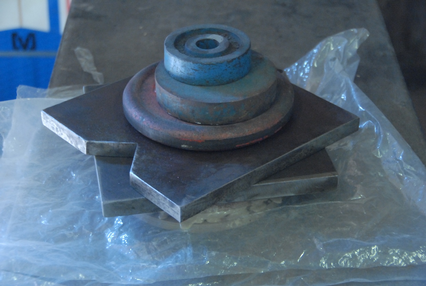

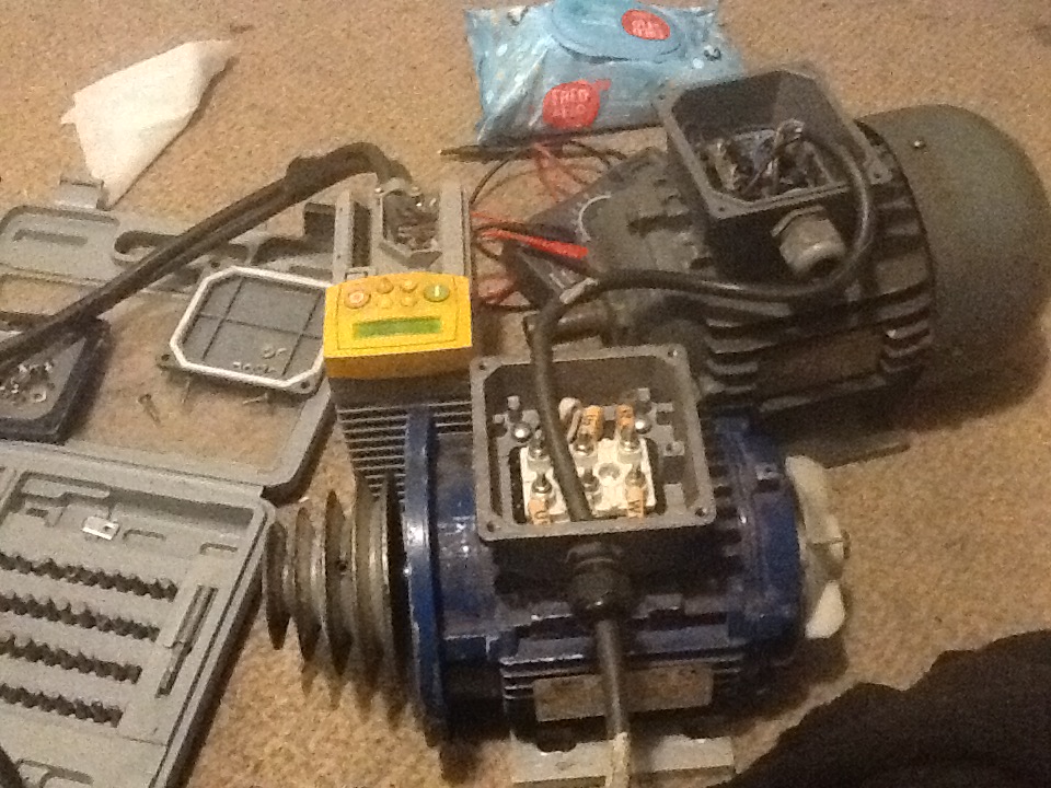

And some more progress.A not very productive hour.

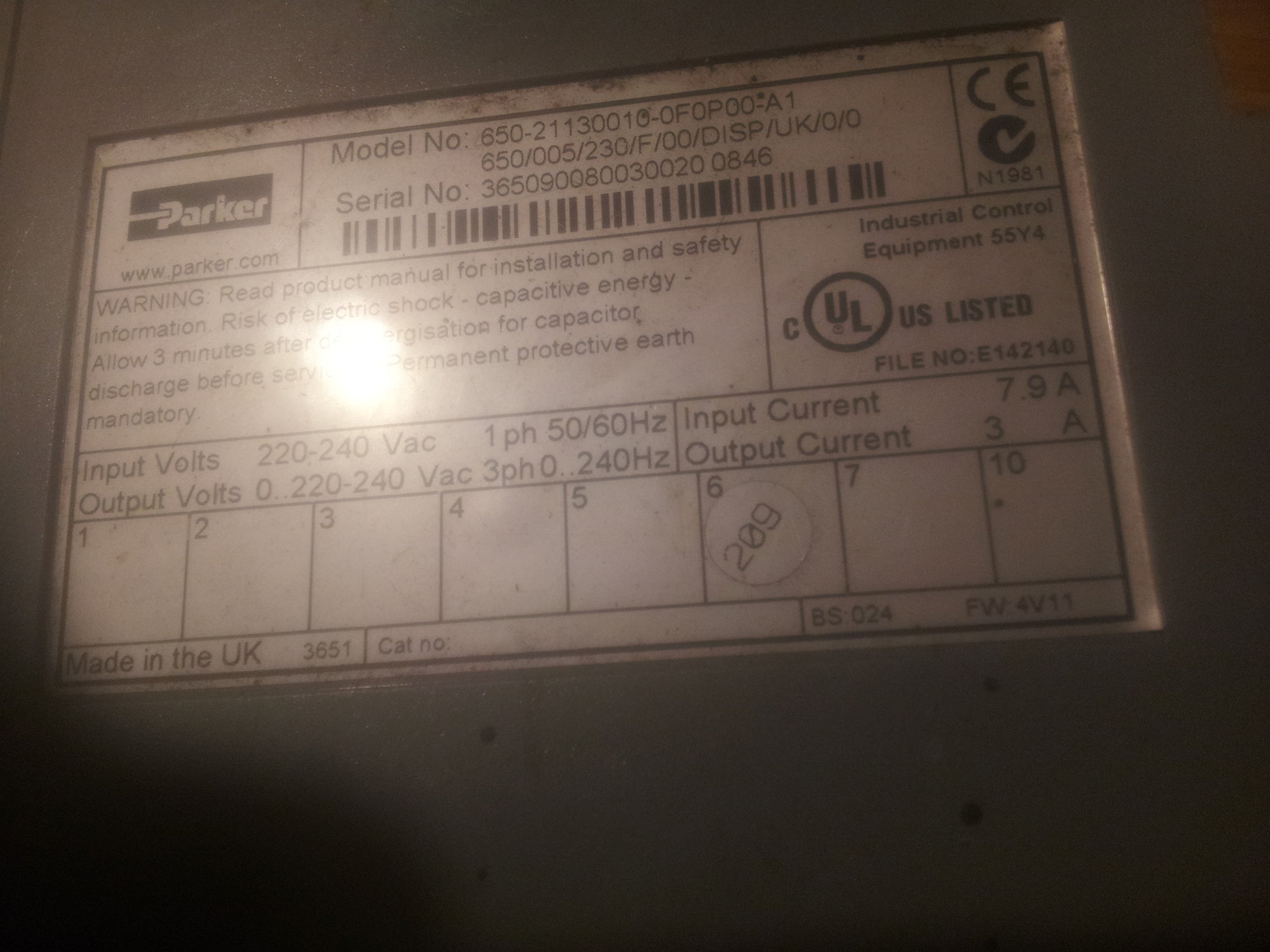

Tranny in the garage has given up. There's two in the lock up and one left on site today.
Hacksaw to the ready and two cuts made. Cleaned em up on the mill. Then clamped the two parts and one original foot in the vice and drilled in one hit.
Il mill some steps in the top tomorrow evening and get the mounting holes transferred over. Bit late now.
Feet for a small 3p motor. Mounts don't line up with my scroll saw base and thankfully this motor has removable feet.

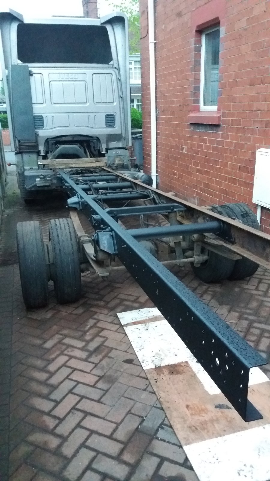

Big hole in that o/s tyre,is that the job to start?A job I wish I'd never started

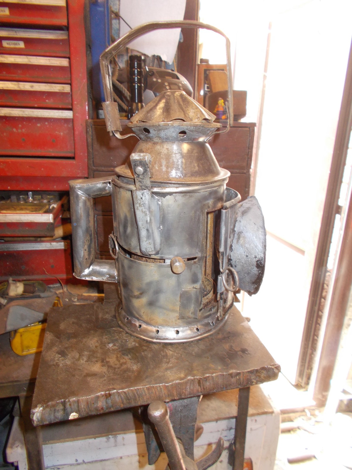

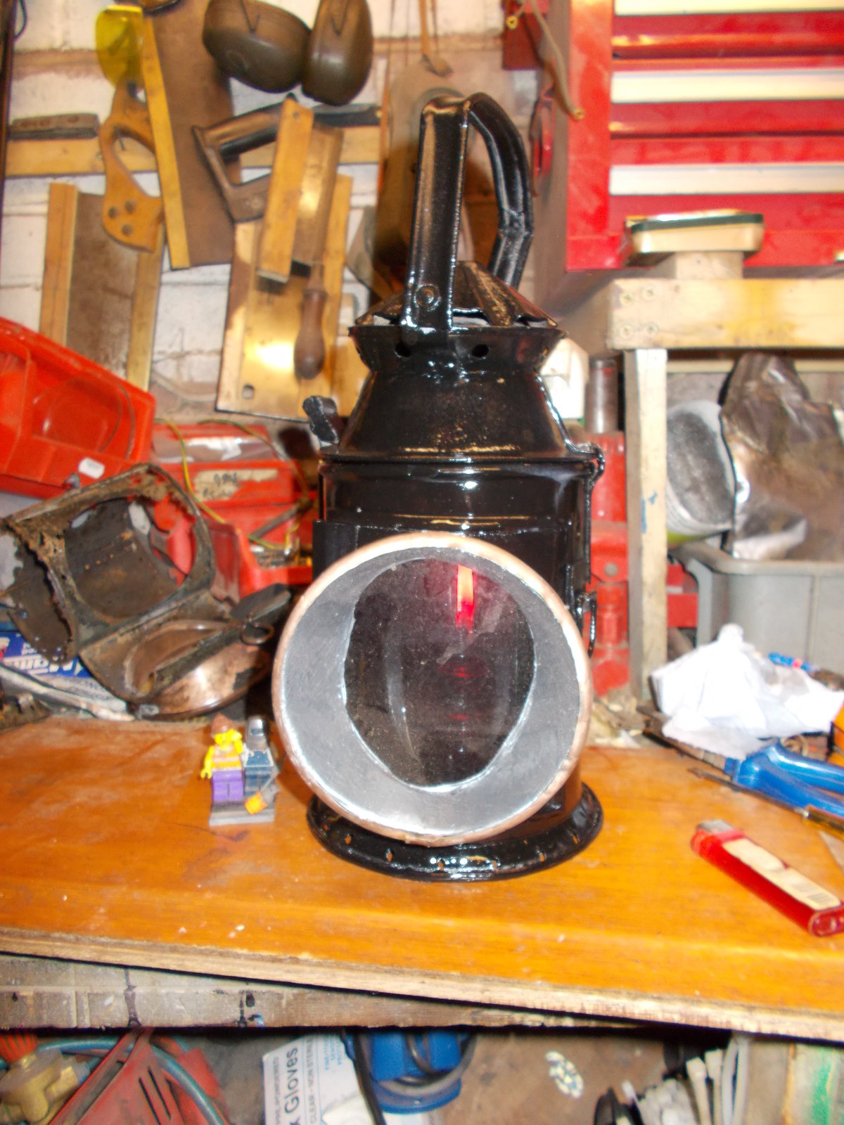

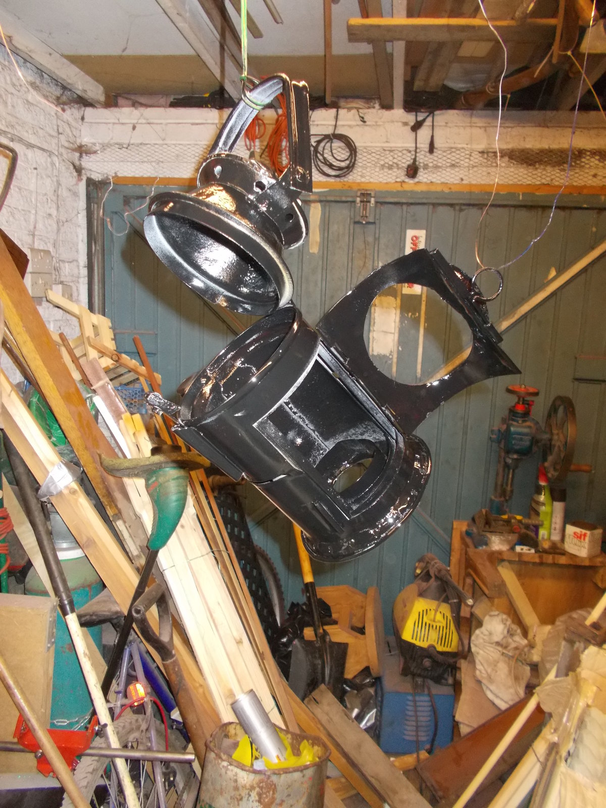

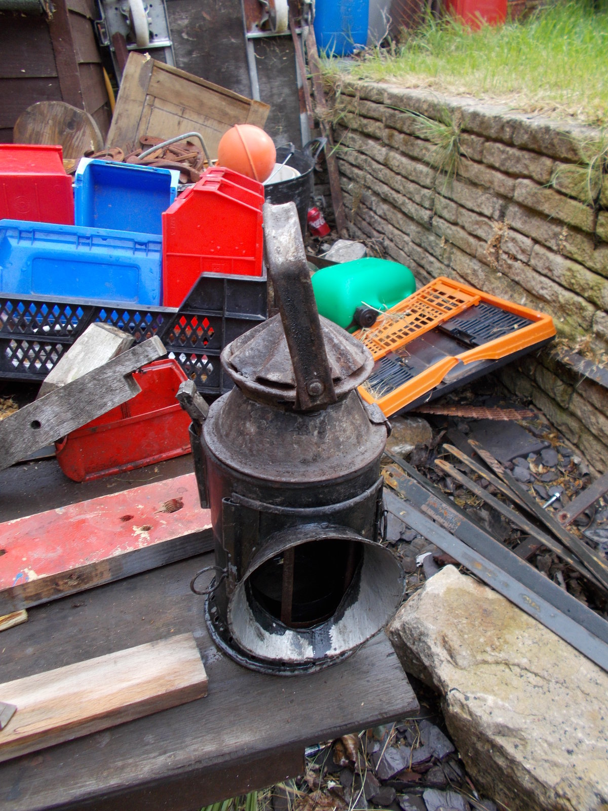

a signal lamp that would be placed inside a semaphore signals lamp holder we ahve a few here and i am now restoring a lattice signal post with lamp holder to hold one of these, they look the part when polished and the wicks trimmed just right.View attachment 176855

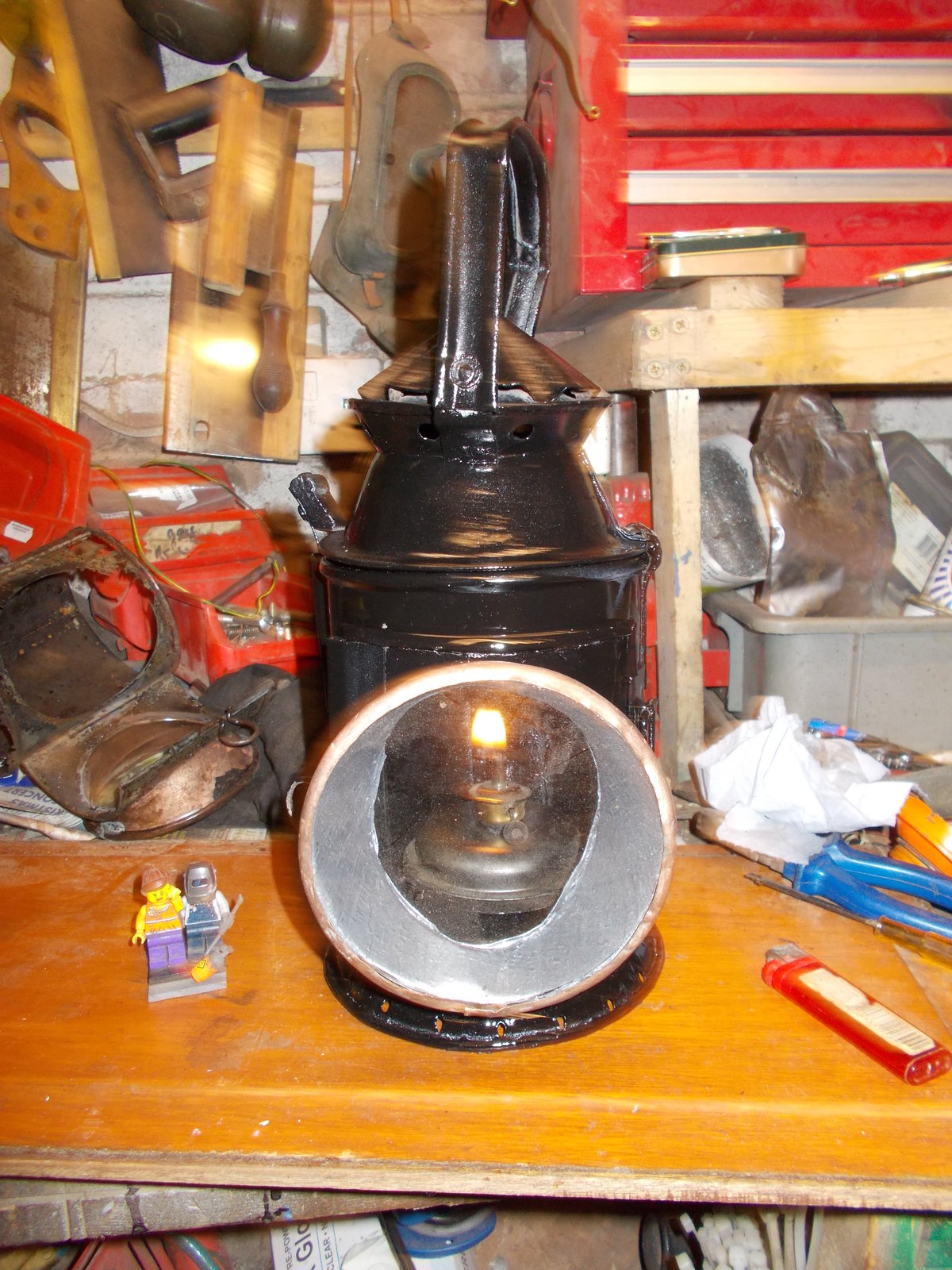

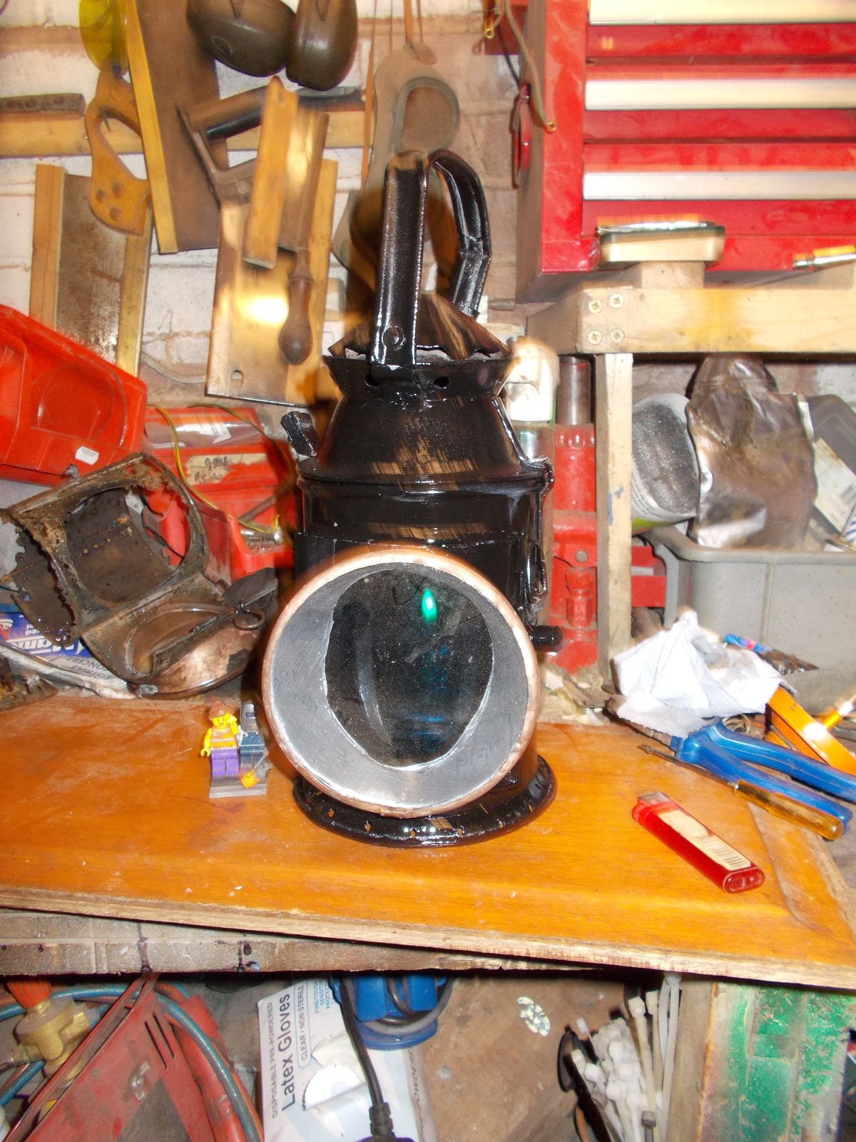

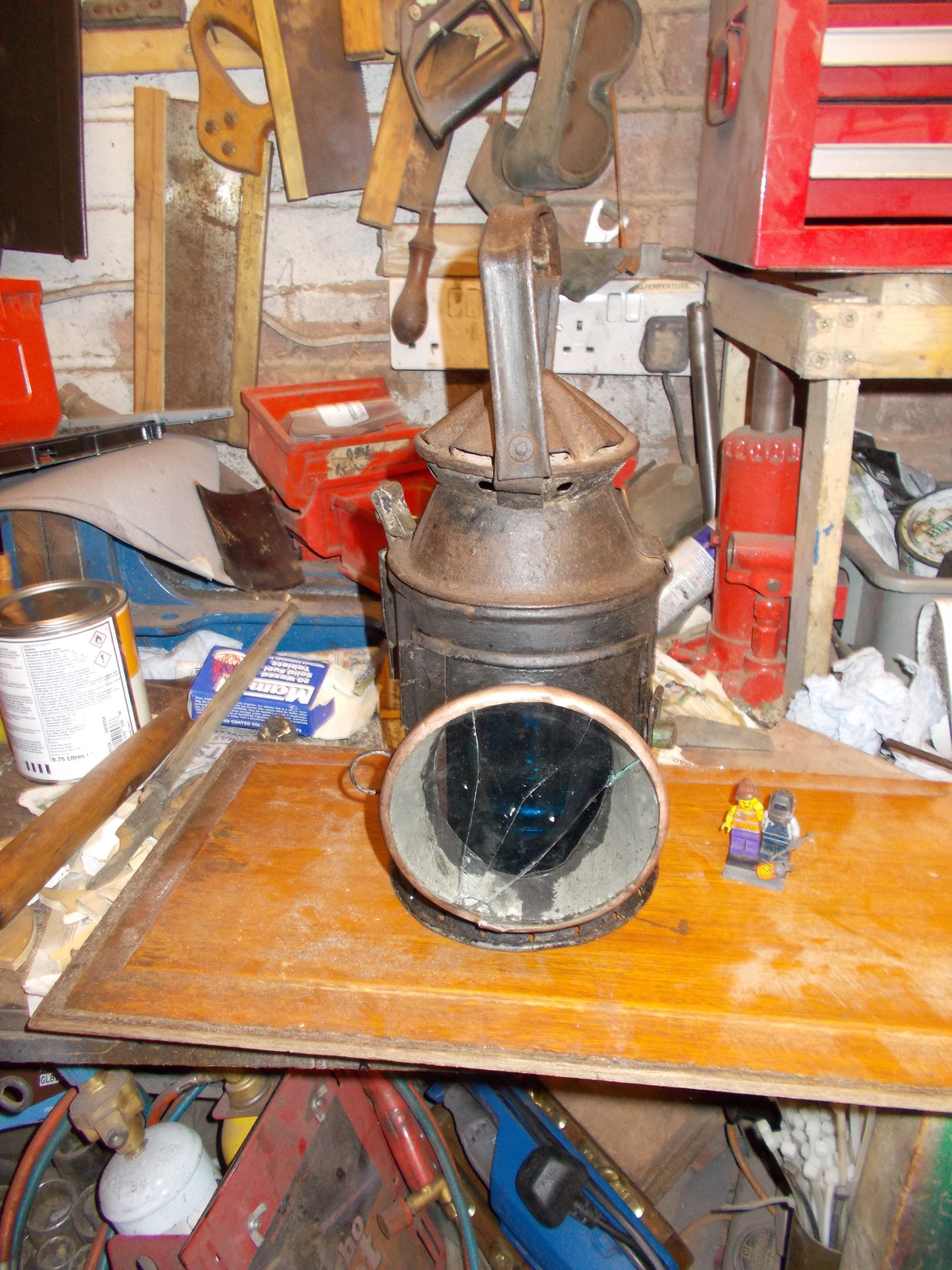

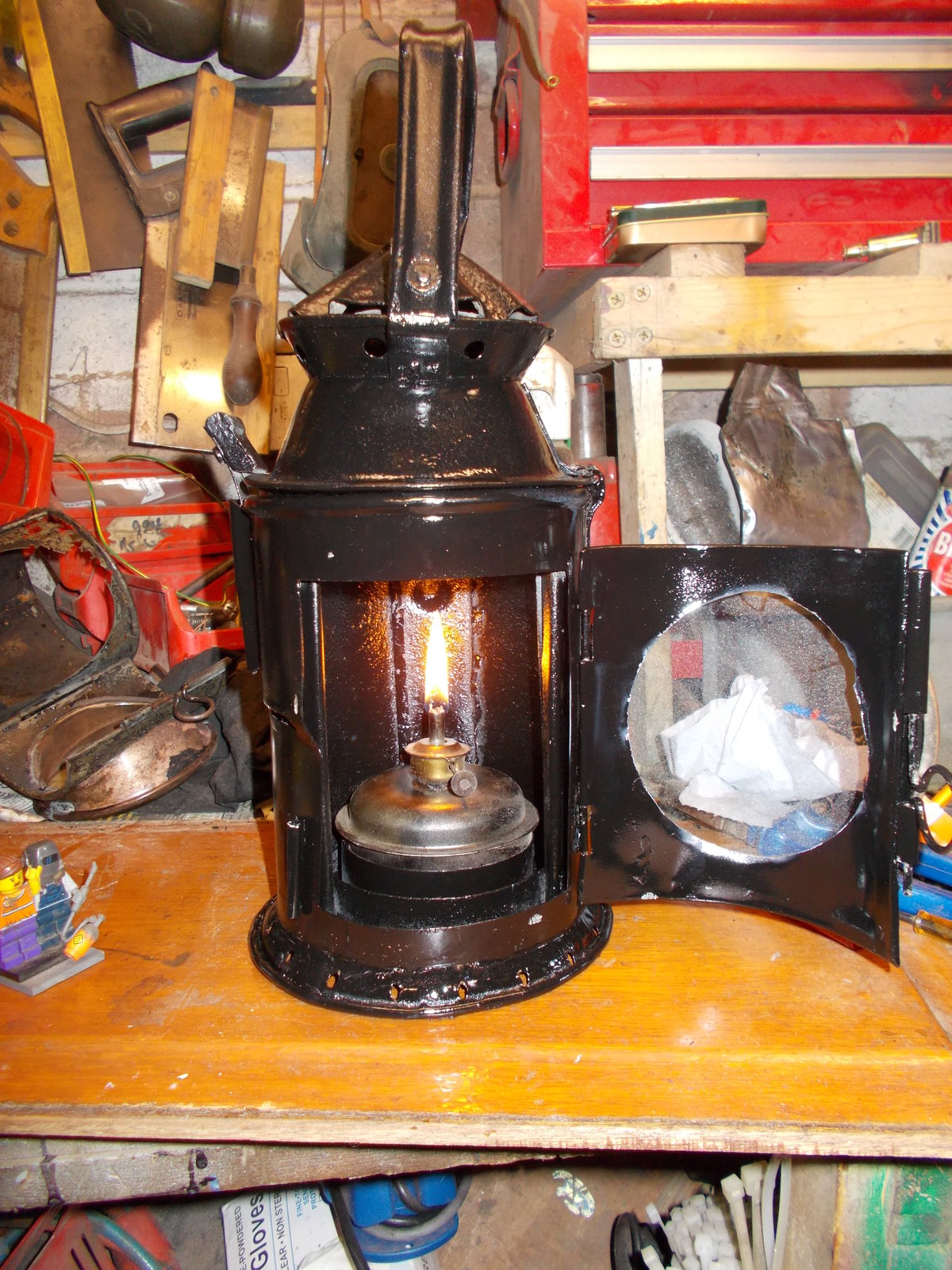

This nice old Railway lantern.
Was in good condition, lightly restored and complete.
Didn't need my to repair and get it back to use. Just a good clean with Meths. to remove some sort of wax finish on.
The wick holder has 2 wicks fitted, But only the longer and thinner one is adjustable. It does work and adjust in a smooth manner.
It is made by:
Lamp Manufacturing & Railway supplies Ltd.
London.
I think this lantern dates from about 1840.
Fuelling with modern lamp oil (thinner than the old stuff) showed a small weep on the bottom copper plate. But a old copper soldering iron was used to repair it with some plumbers solder.
I know I could of used a modern Iron and modern solder, but were is the fun in that?
I had to old tools they may of used in the past.
Besides it was fun.
Finished and working.
Now to find space to show it off.
No holes in the tyres, its a water patchBig hole in that o/s tyre,is that the job to start?

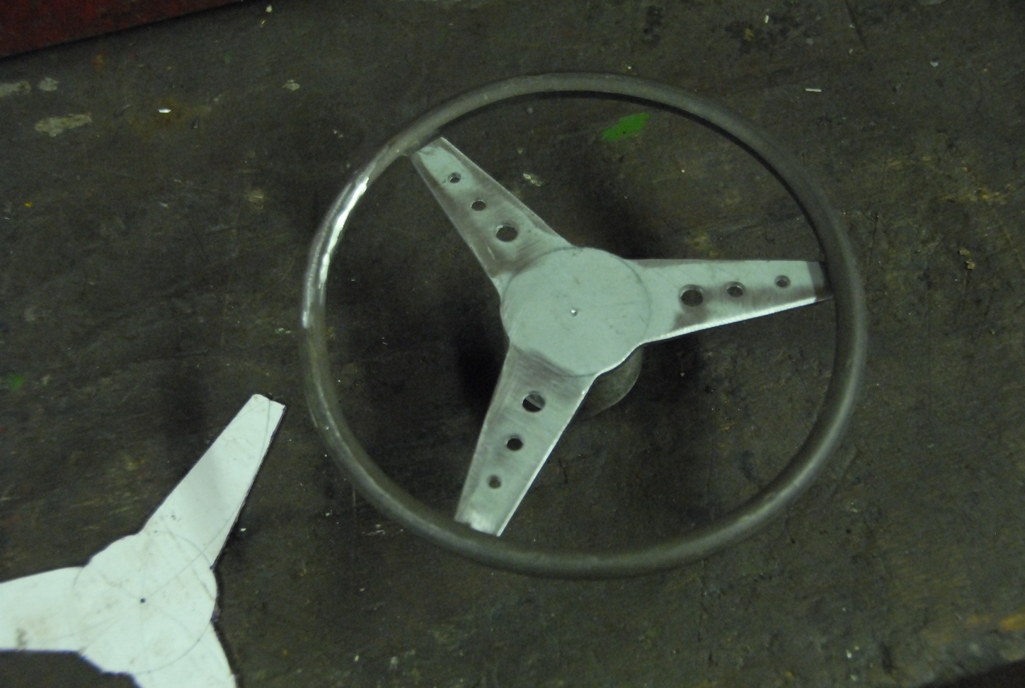

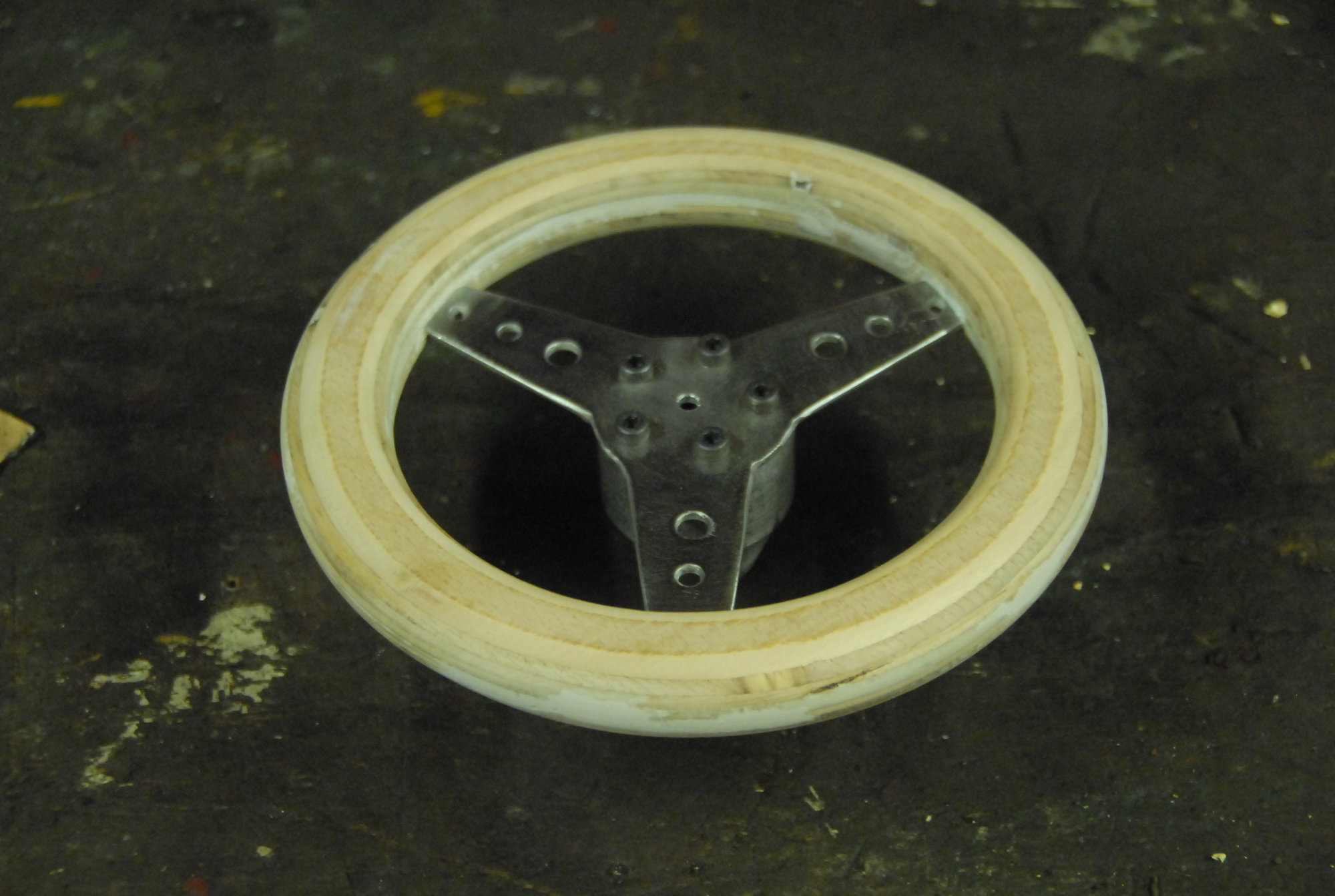

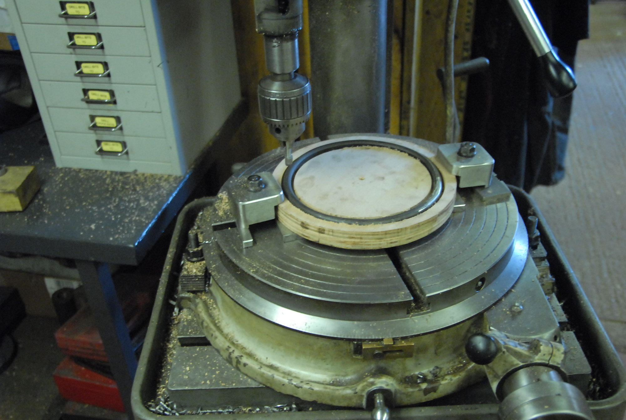

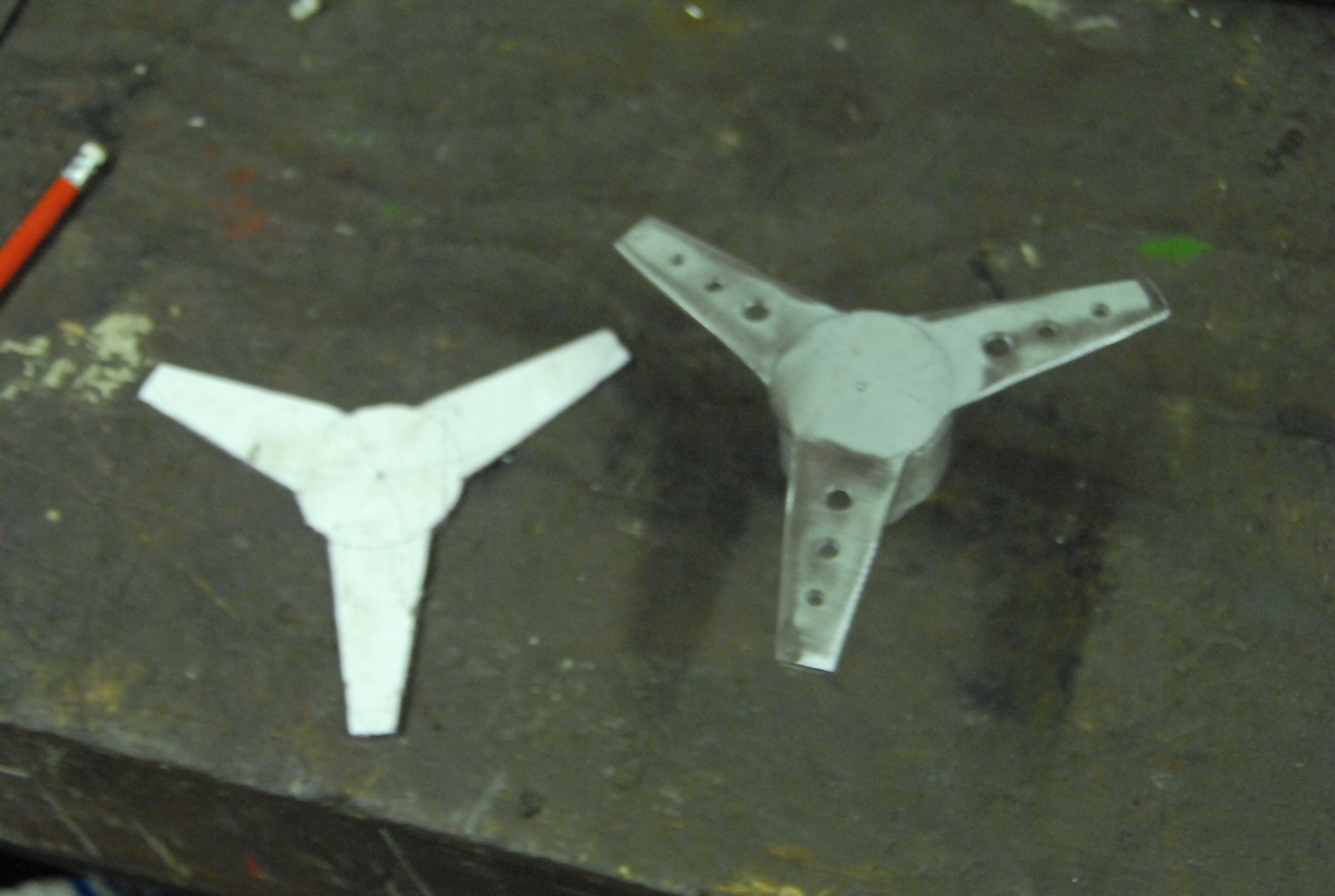

I liked how you have made the steering wheel it reminds me of the steering wheels we made for the karts which we raced in the early eighties when we took part in the Shell National Schools Karting competitions.There some clever stuff being done above love it,

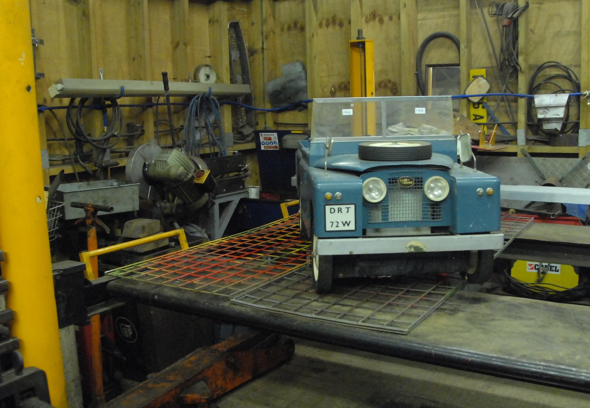

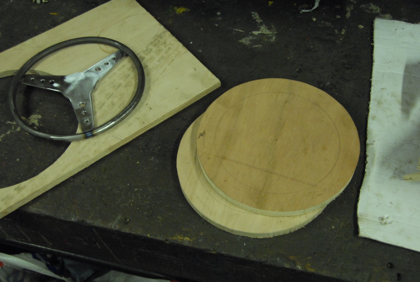

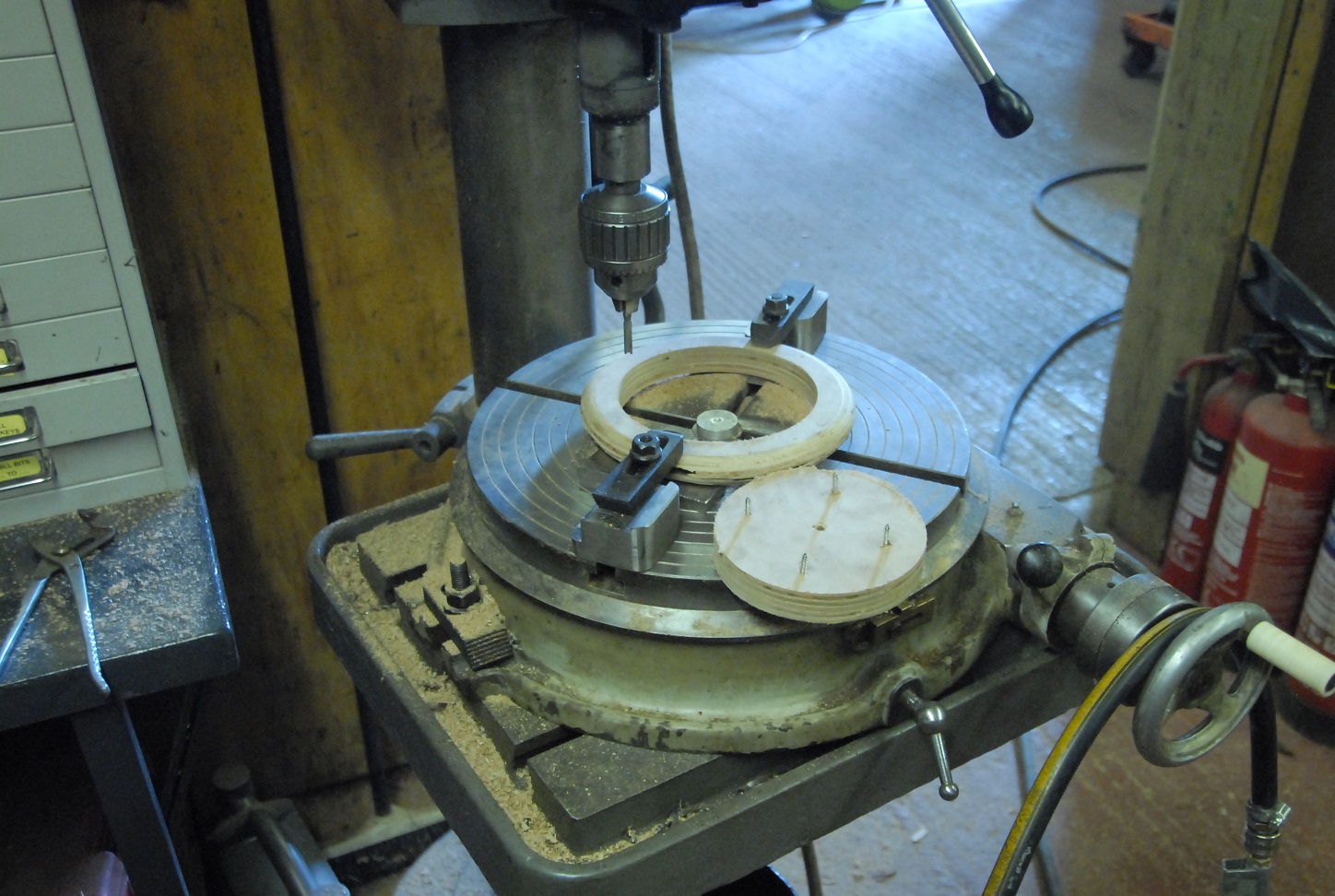

Not today but been working as and when for a few nights. Its not my normal run of the mill but doing a favor for one of my customers kids his toddler broke his steering wheel so , as you do I said drop it of I will sort it I know I could have bought on cheaper and fitted it in less time but we are what we are boys with tools so I decided to make him a wood steering wheel hope the picture tells the story if quicker than writing..,,
View attachment 177547 View attachment 177549
View attachment 177550 View attachment 177556
View attachment 177551 View attachment 177552
View attachment 177553 View attachment 177554
All ready for staining before varnishing its going on this little beauty

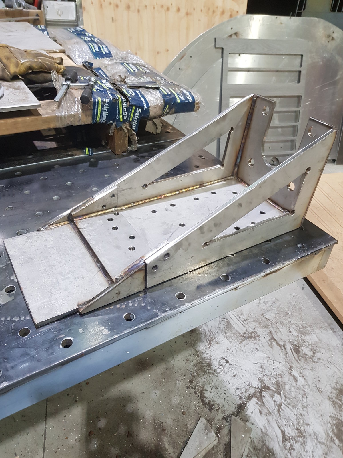

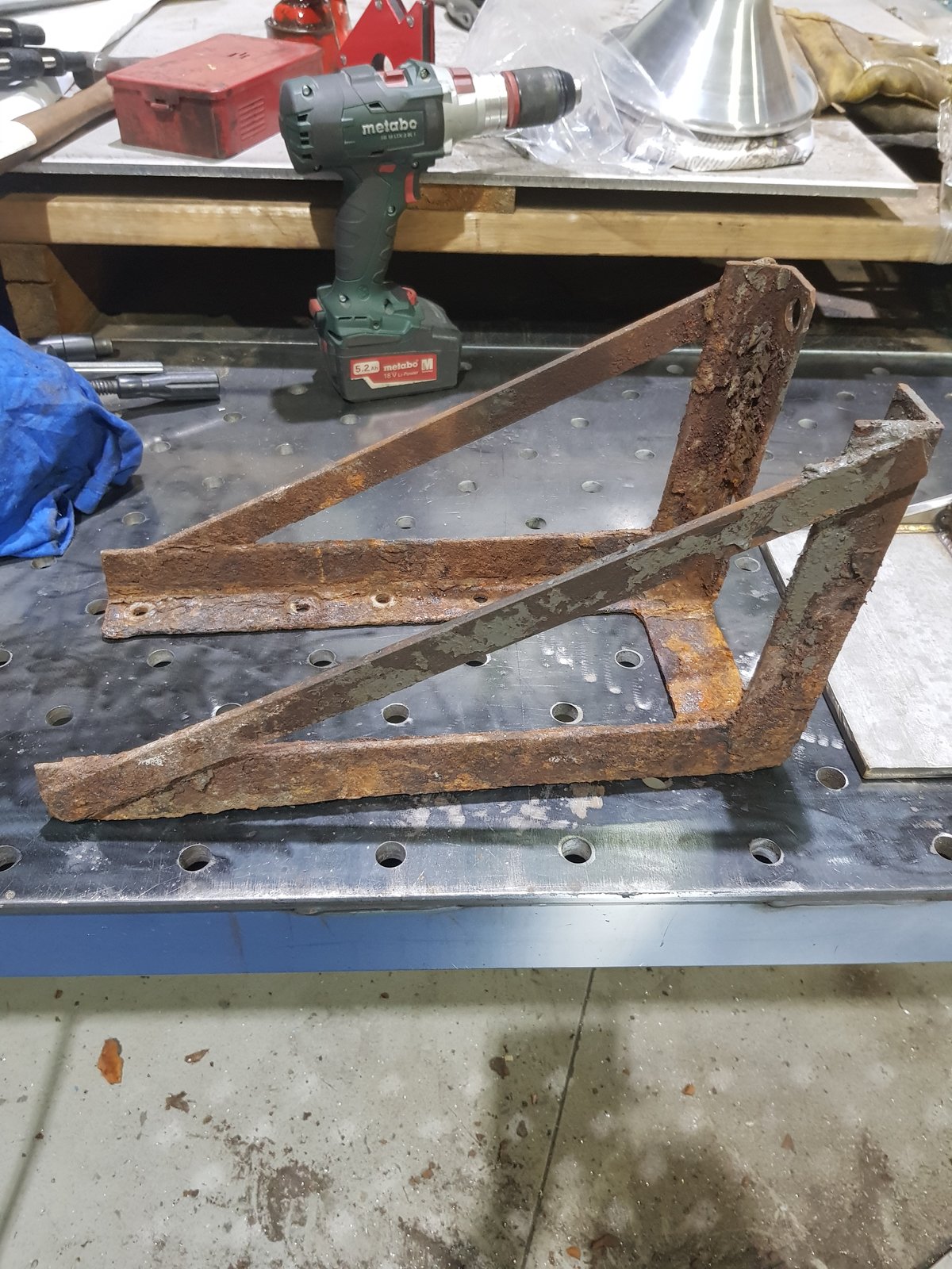

could you not drill the concrete and resign some threaded bar into it? obviously avoiding drilling all the way through!!!Good morning gents my two cants worth, just the last few days
Turned this
Into this
haven't passivated it yet, but you get the picture. This rusty bracket, out of 5mm steel angle was holding a spherical bearing with a taper lock shich was taking all the thrust from the prop shaft to the vessels keel. It was also held down with 6 only 8mm by 40mm coach screws. What possesed the original boat builder to do this is beyond me. Nevertheless he did. The new owner got a rope caught in the prop which just peeled this bracket off the keel. Imagine that. This is still not what I would do, I would at least through bolt this bracket through the keel, but the vessel is in the water and has a concrete keel underneath. Anyway will be passivating the new bracket tonight and installed on saturday

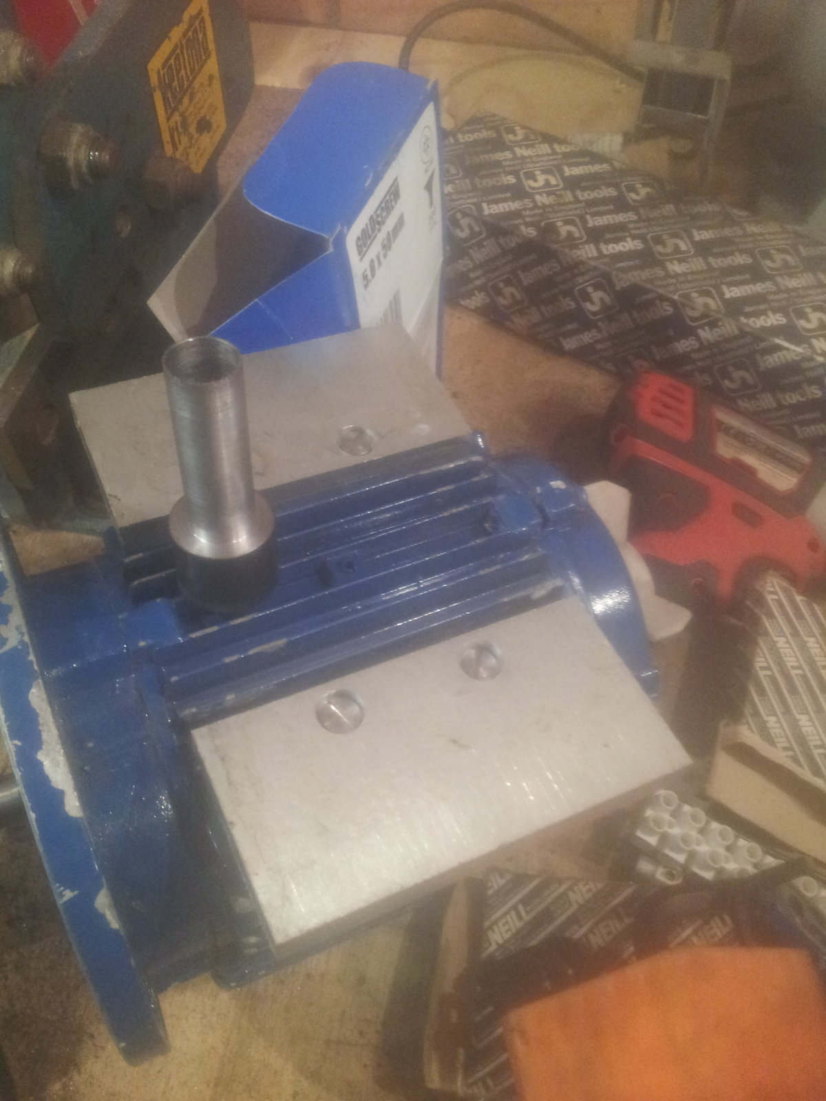

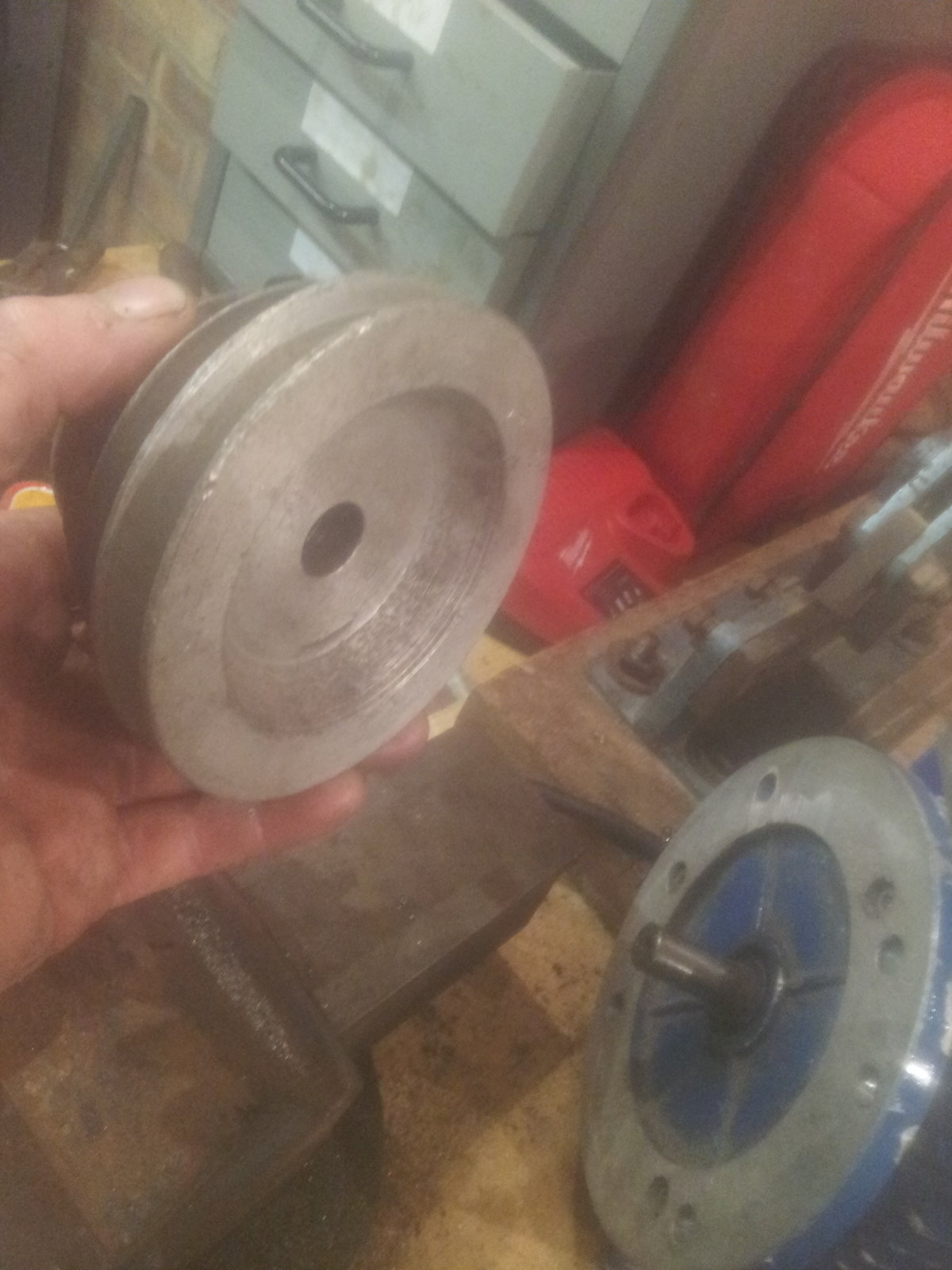

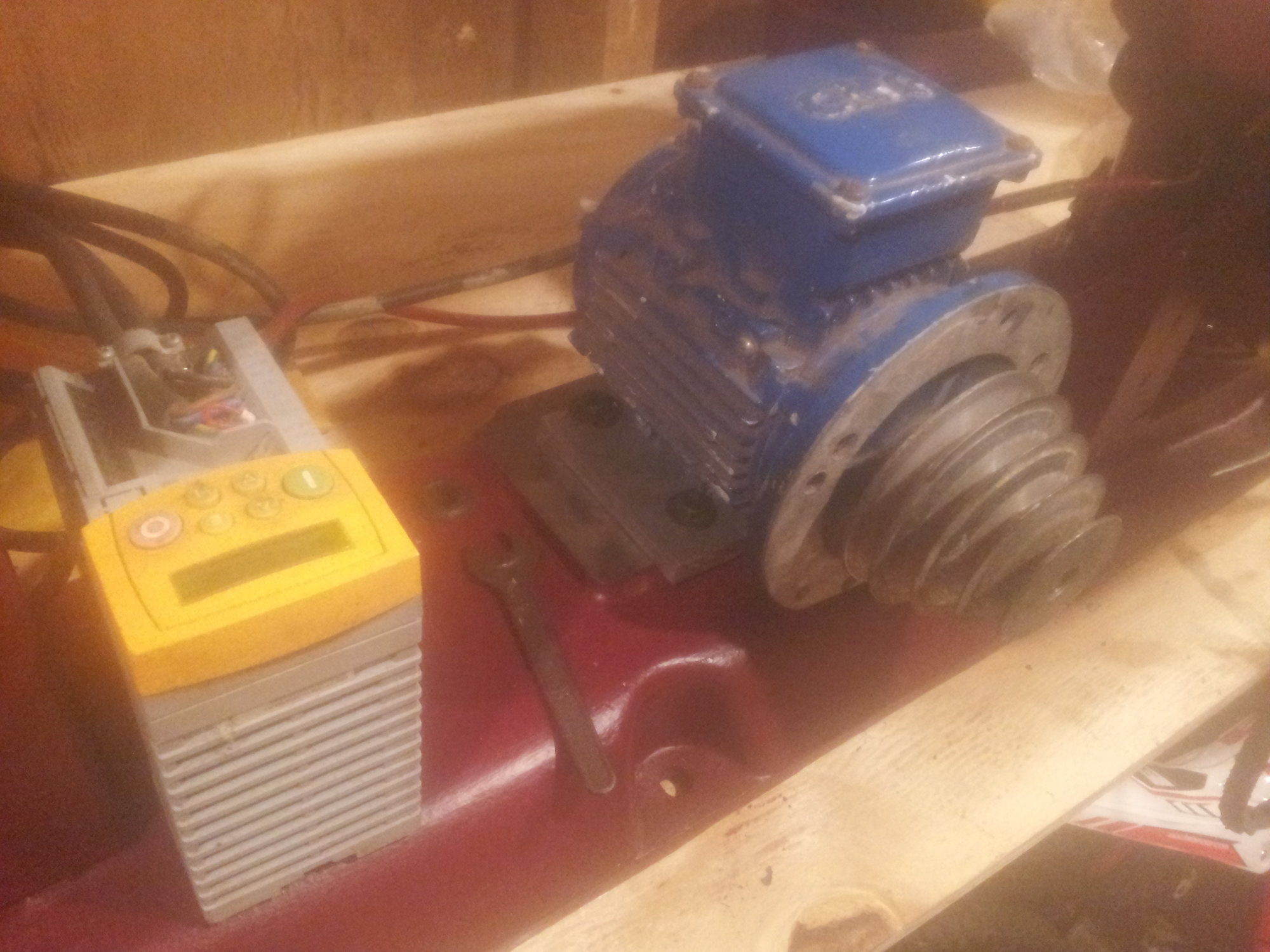

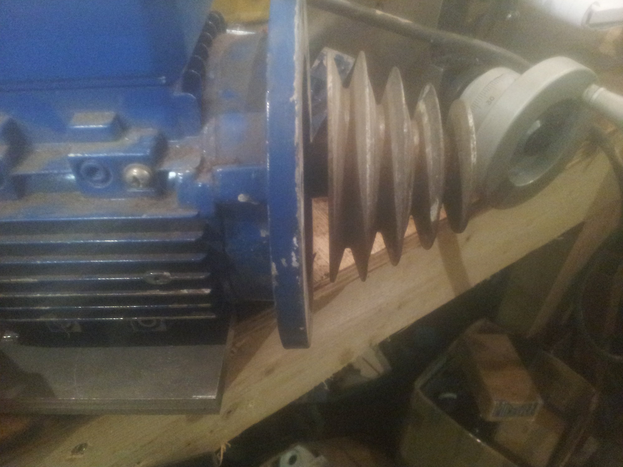

Well that was anticlimatic.And some more progress.

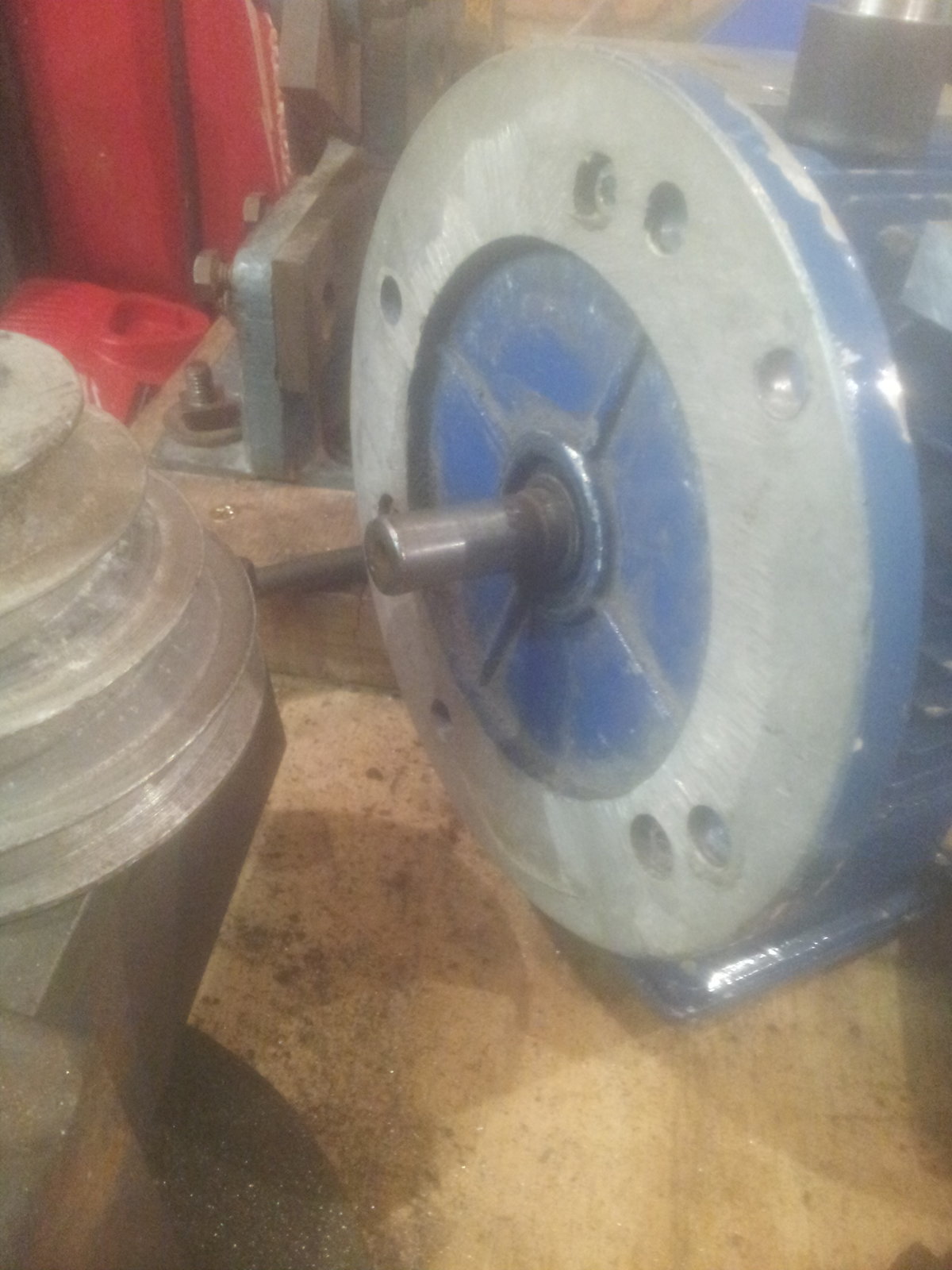

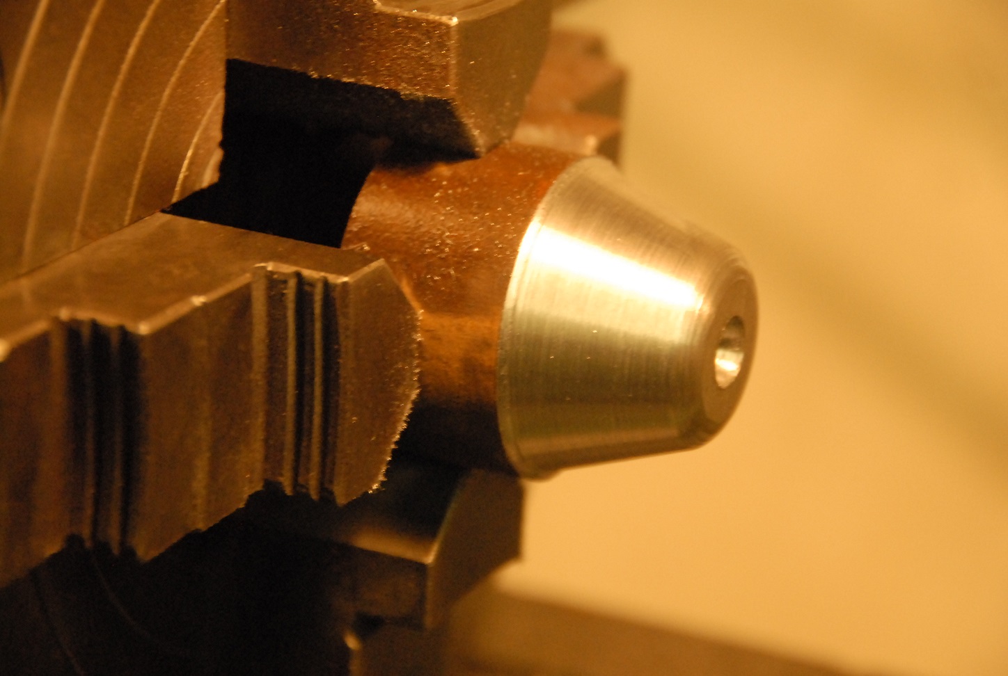

Turned some m6 bolts into round slots last night then went for measurements for mounting holes.
Cant get those until I line up the pulley.

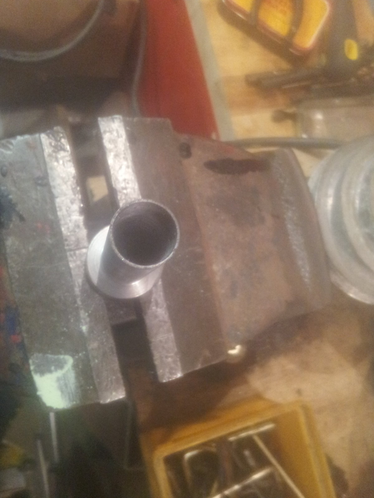

Problem is it didn't fit.
Found a 1" hardened bar and set to it.
Drilled to 12mm then bored out to just shy of 14mm
Left some meat on the bottom and turned it down to 16mm Locates into a ridge on the motor shaft and the pulley sits snug on it. Also gave me somewhere I coukd grip it well in the chuck.
Getting better. Perfect fit on the shaft and bore.
Loctite and pressed into the pulley then get the persuader out and tap it on the shaft.
Il align and mark the mounting holes tomorrow then make the new feet look less like slabs of billet.
View attachment 177529 View attachment 177530 View attachment 177531 View attachment 177532 View attachment 177533 View attachment 177534 View attachment 177535

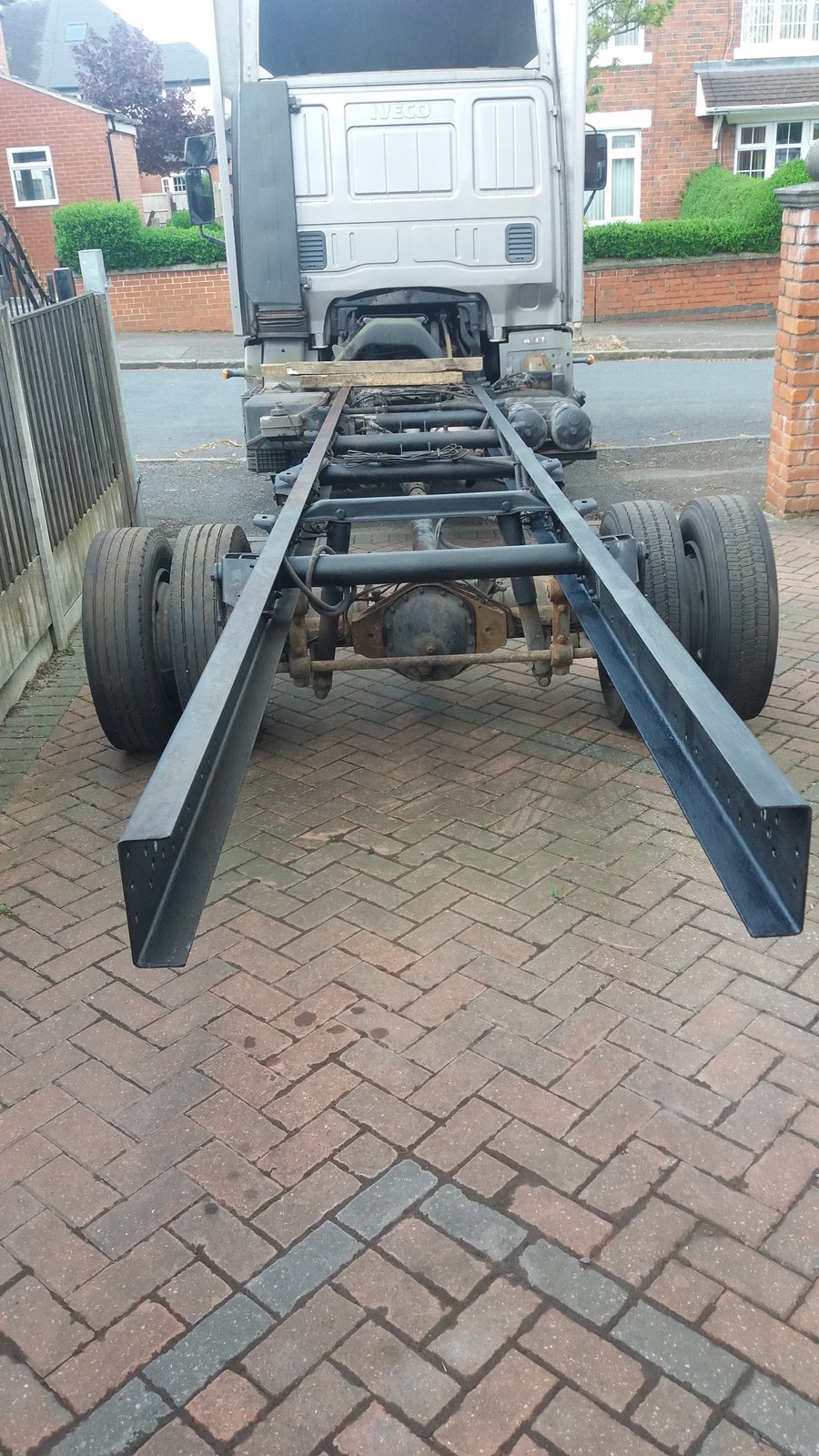

No not if it's private hgv or recovery plus you can keep what you want at home as long as it's not operating from there, I used to keep my 26 ton truck at home plus a few coaches years back.Do you need an o license to keep that at home.
