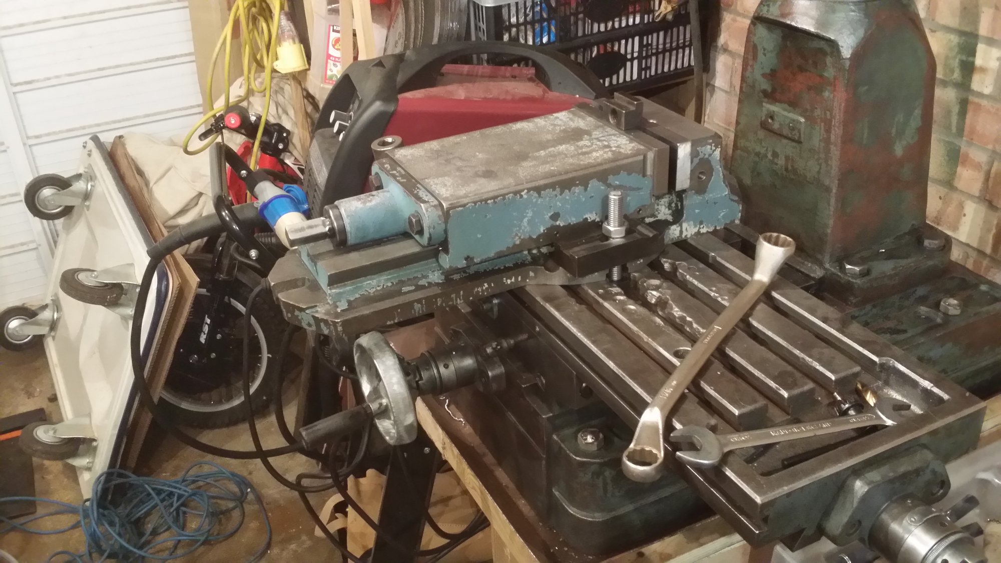

@mrsbruce what is the vice you have?
I’ve got a hobby mat mill and looks to be similar in size. I need a better vice
Also, look at these. (If you haven’t already) Should allow you to hold and clamp most things to the bed. Just need the correct size studding. Made / supplied by warco so they should be able to advise
https://www.warco.co.uk/clamping-ki...s/151-clamping-kits-for-milling-machines.html

Wish mine weighed 5kgThat’s the things I’m waiting for. The vice is an 80mm from Warco, and weighs a scary 5+kilos.

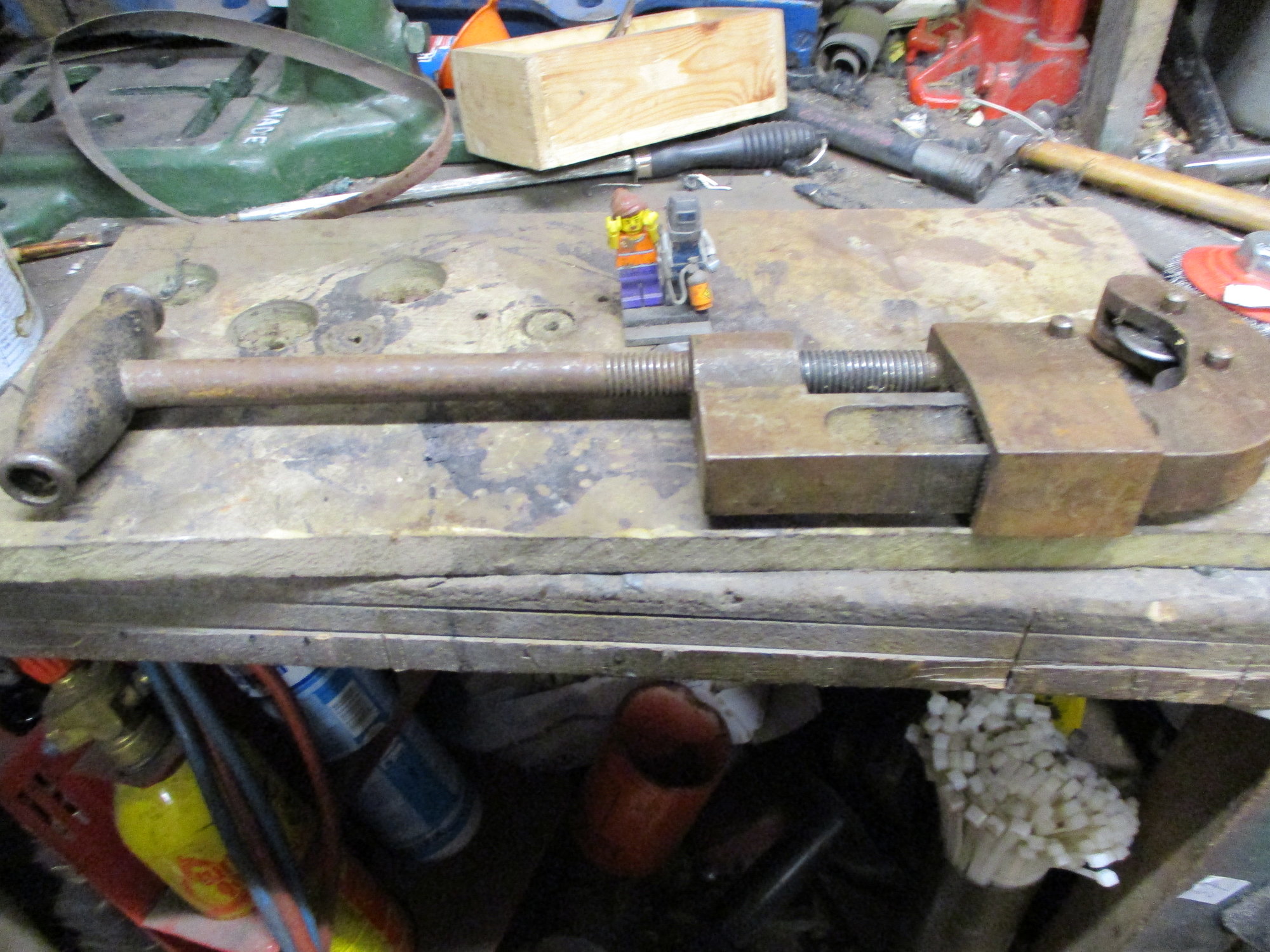

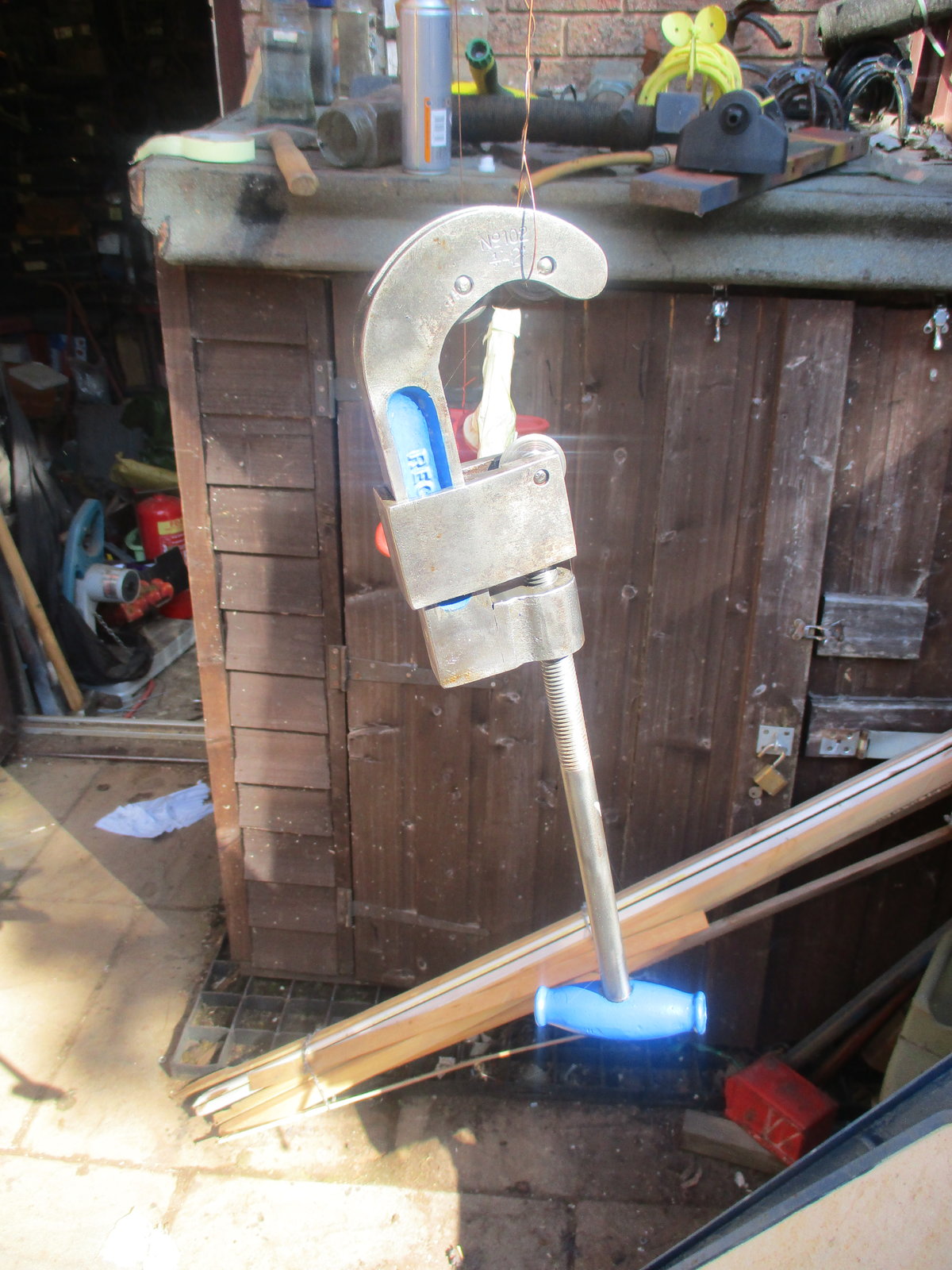

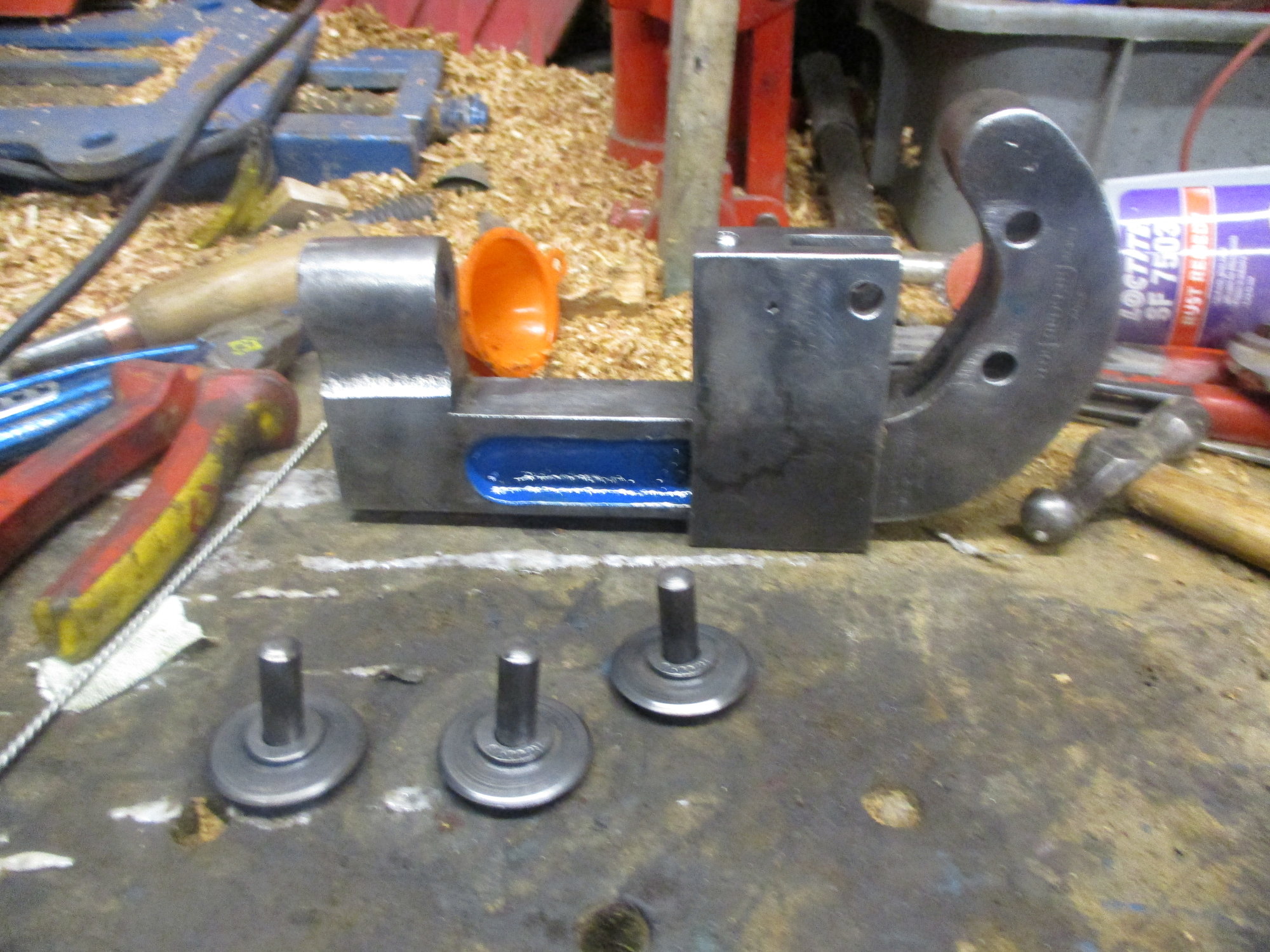

Record 2" pipe cutter.
It was seized when I got it, turns out the screw that holds the screw thread into the moving jaw was tighten up to much.
The original cutting disc were damaged. But I was given a "New Old Stock" when I sold some tools.
Painted and lacquered and drying in the sun.
No power tools were used to clean this. Just a soak in Citric acid, then wire wool to clean up.

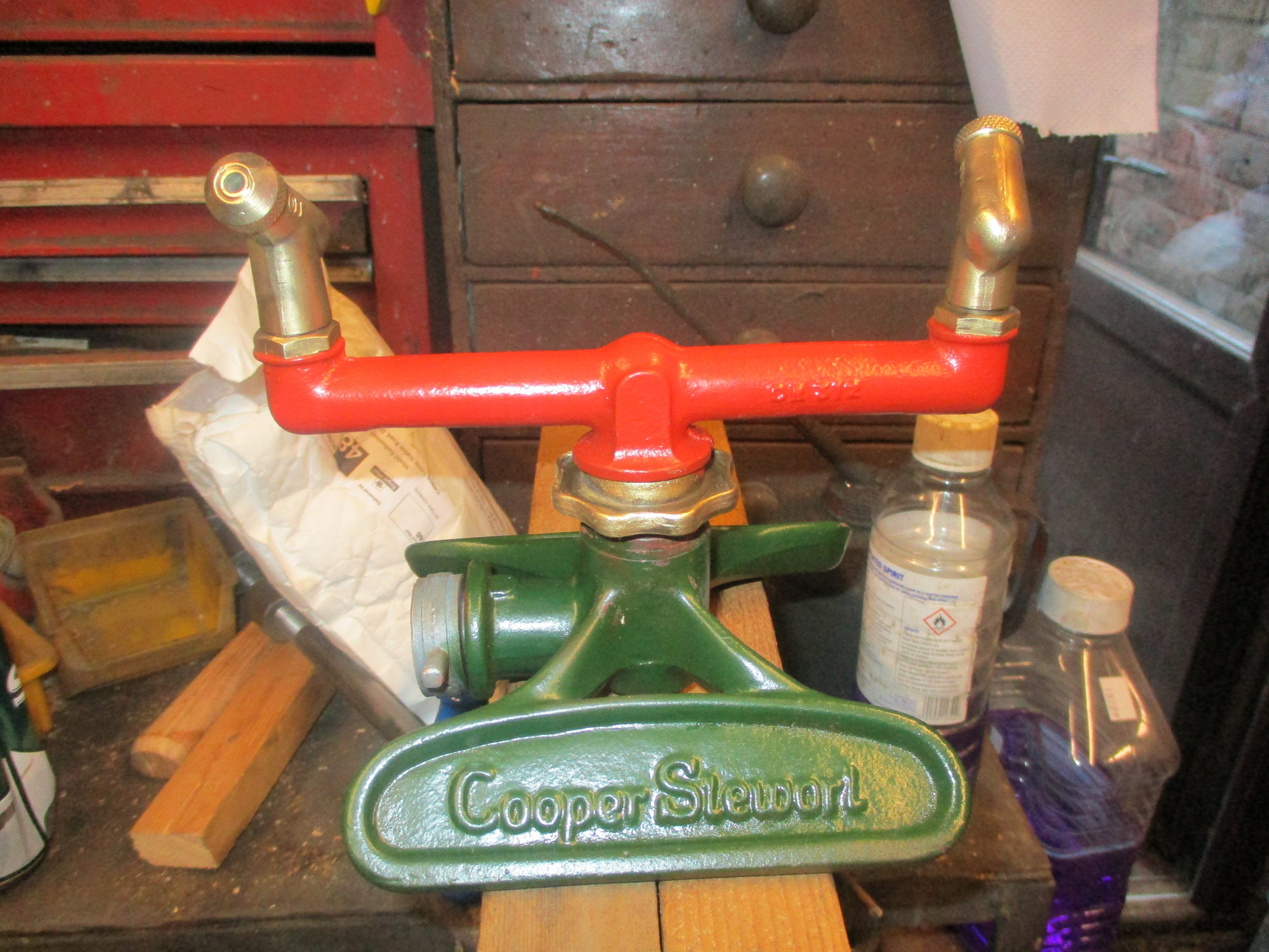

Rain King Lawn sprinkler.
AKA Lump of Jabberwocky.
I tested it, it did nowt. Just sat in the grass looking ugly.
The seals and retaining ring had failed. Should be a simple fix.
This is the Alloy base screw what holds the innards in place.
It was this bad when I got it.
Heating the case and chilling the screw I managed to remove it.
The seals are O rings and the clip that holds it all in place is a now a E clip.
Painted in those colours, for the simple reason, it was what I had to hand.
This was a simple clean with "Meths" and wire wool.

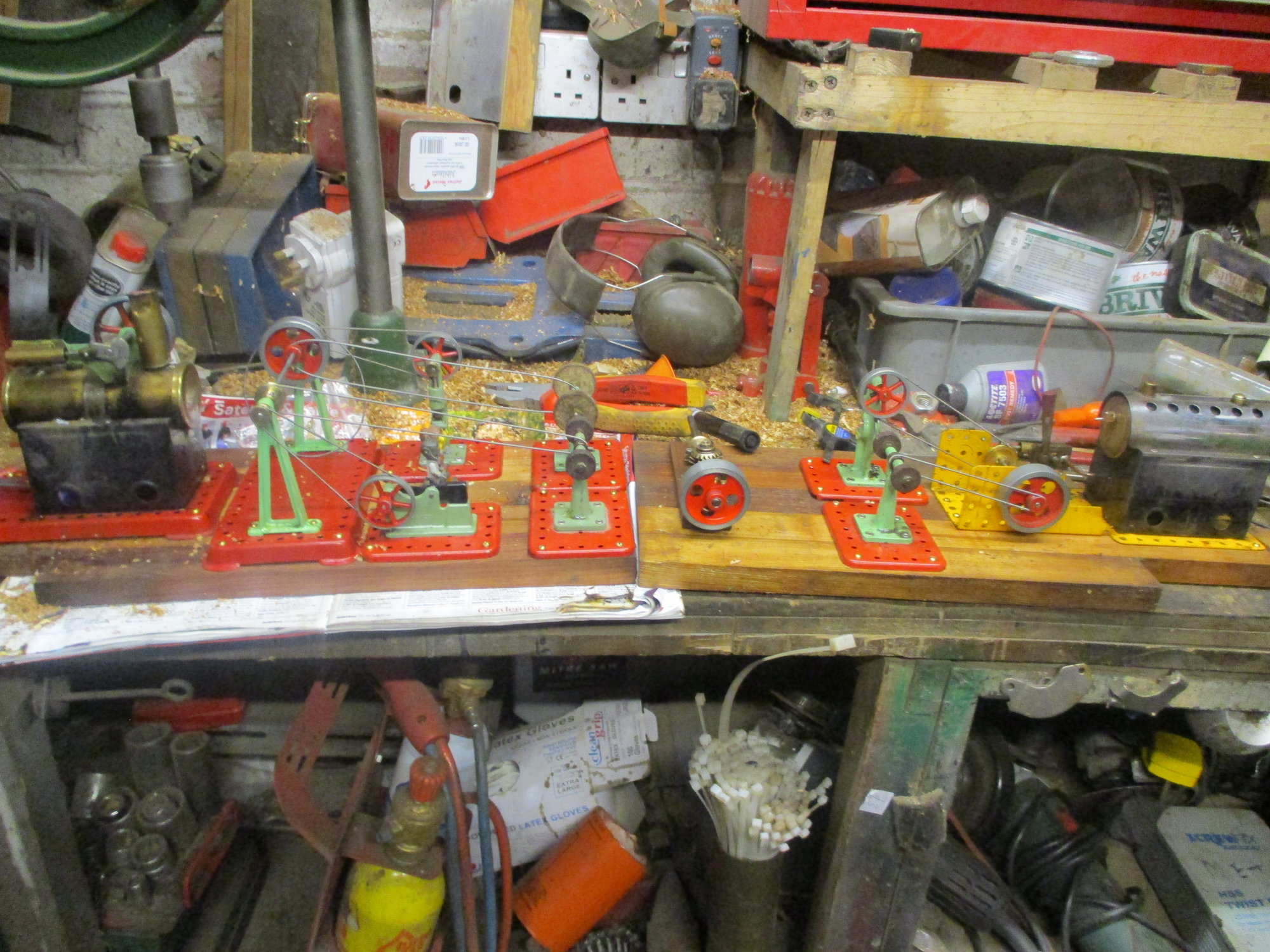

A few Mamods.
The base are both Cedar wood. Then using biscuits joints made into a decent base.
I was limited to the drive bands I had. But a few more are on order.
What's a mamod engine worth on its own?
