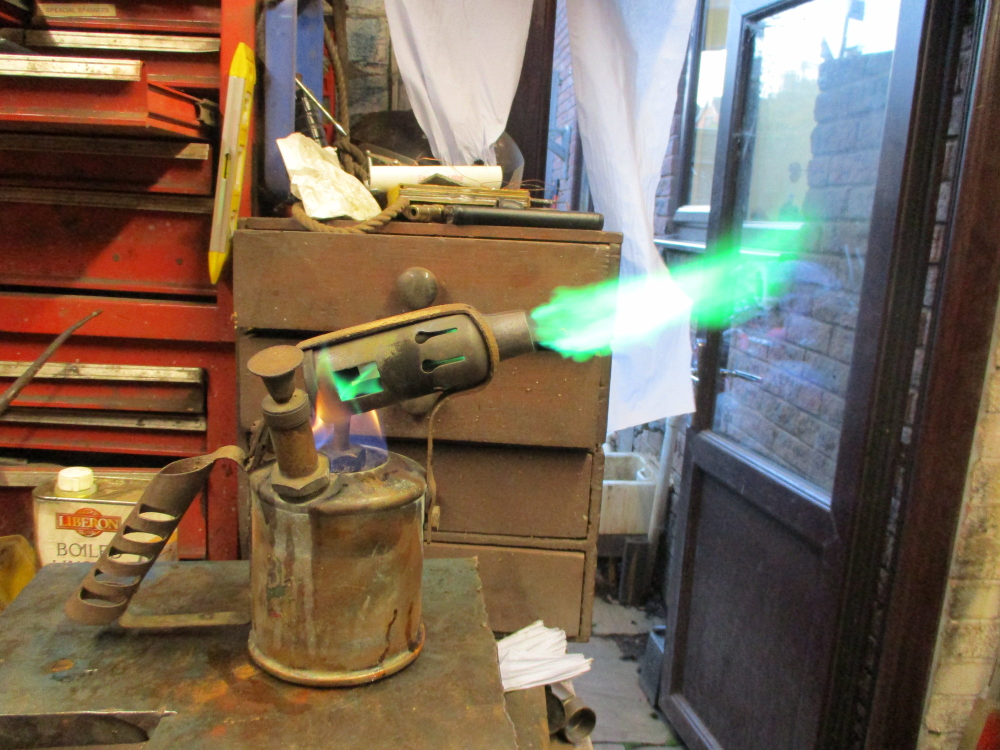

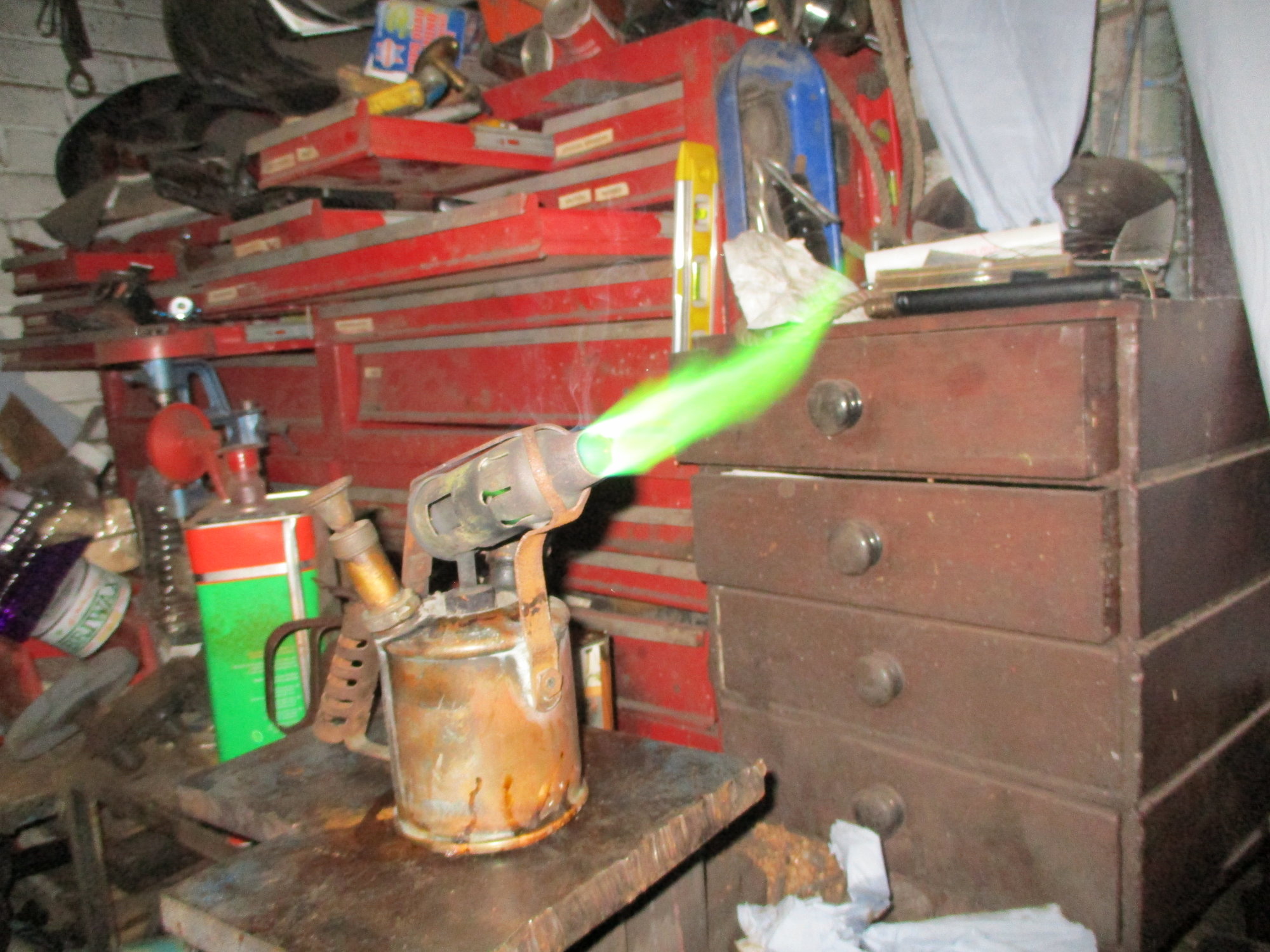

I helped to make green flames.
With help from here.
View attachment 195490 View attachment 195491
I supplied the workshop, @Chillitt the parts, 2 80+year olds the labour.

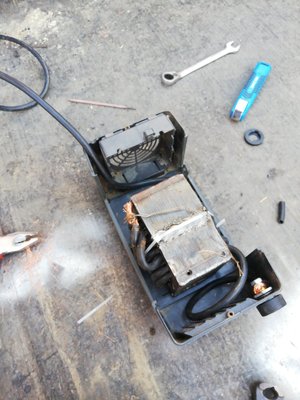

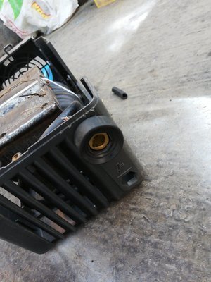

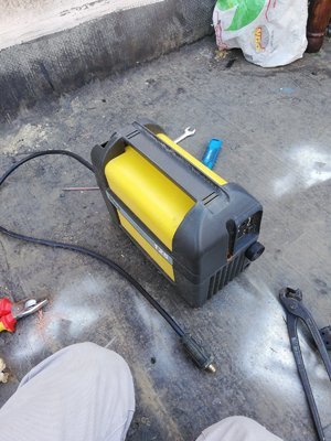

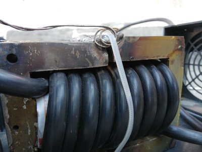

Made this inductor for the welder
I used 2 microwave oven transformer cores and I welded them together leaving a 3mm air gap between them preventing the magnetic saturation of the core
Wound 10 turns of 16mm² welding cable
The input side has an 80cm pigtail cable
The output side ends in a panel dinse connector .
All this mounted into an inverter welder housing that I got outside year taking rain waiting for a project
All this made out of scraps
I have to make better connections but I can't now because I need some materials

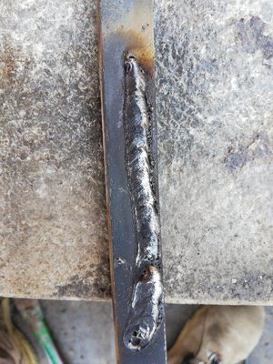

So the purpose of this thing is give hot start and some sort of arc force to my inverter welder that doesn't have both of those capabilities .
My welder alone can run E6010 no problems but only after struggling to get the arc going
But with this things now it can start E6010 instantaneously and kept a longer arc
The weld you can see in the picture is made using a 3.2mm E6010 citoflex rod and 100A straight drag no manipulation
Without this "attachment" my welder has to give 150A and again struggle a little bit to get the arc going
Now it's way easier to run this rods I just need to practicing with more.
The arc is violent seems like welding using 200A big hudge arc and a big red flame coming out of the tip of the rod
I'm very happy
