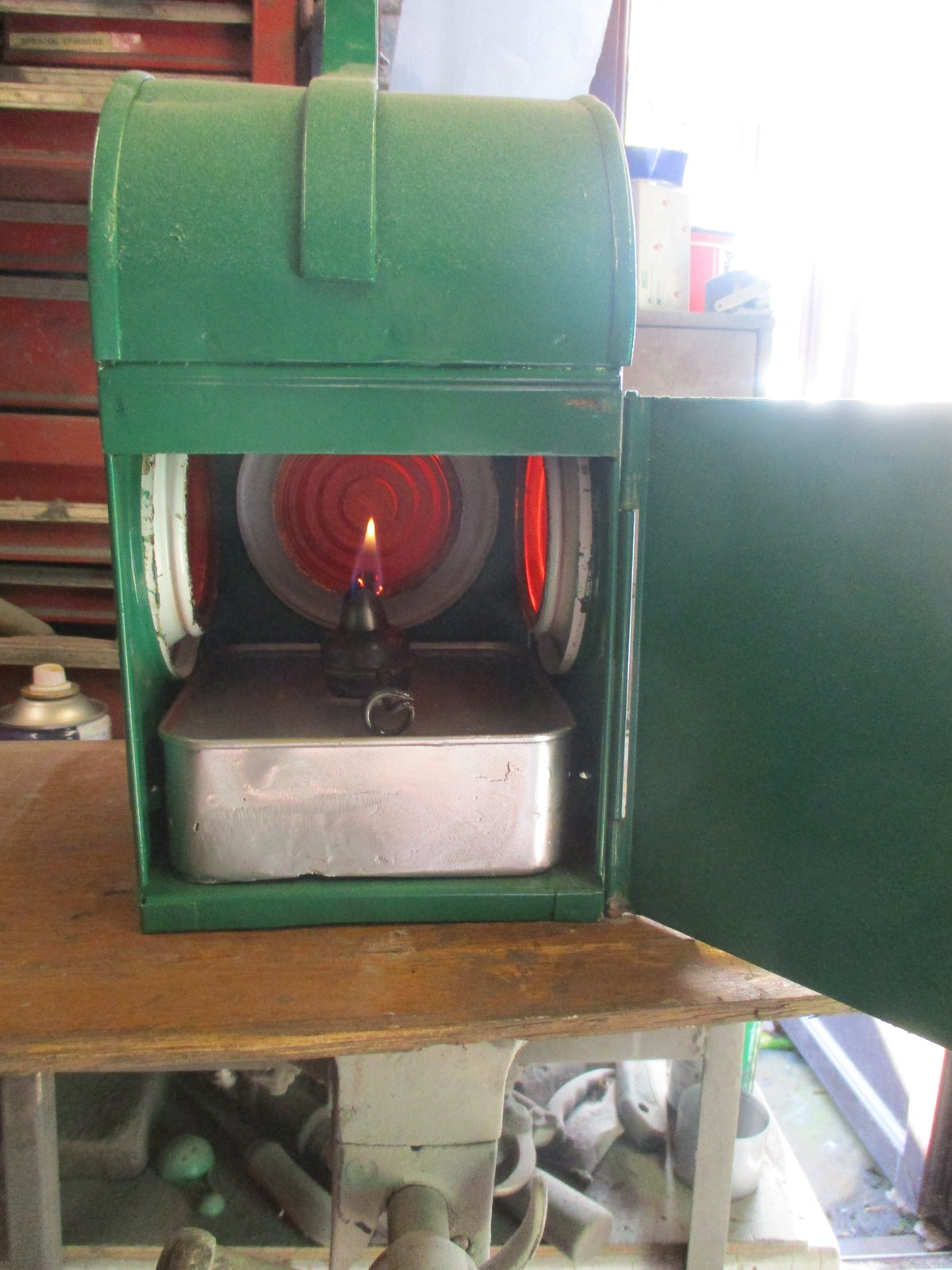

I got this Paraffin Road lamp tank.
It came with extra/minus bits.
Holes. Lots off them.
The line of holes goes equally round the 4 sides.. Clearly were the fuel sat on the water.
How to fix it?
Patch it!!
This is a copper hot water heater. It was no good as a heater for a plan I had. So it donated the copper as patches.
Warming up the torch.
Water proof 2 pack filler to hide the terrible repairs and fill any pin prick size holes the sanding will have made.
In paint, second coat off filler primmer.
Silver paint and on a dusty surface, no leaks.
Will now go with the Green Road lamp.
Not a bad repair.
Was it worth it?
No.
The time to cut, tin solder and tin the body to make it leak proof was more than I could get a new /replacement for.
Would I do it again?
Yes.
The fun of doing it, the fun of using lead/tin solder the seal and fill holes was a good fun. That I think out weighs the cost of the parts.

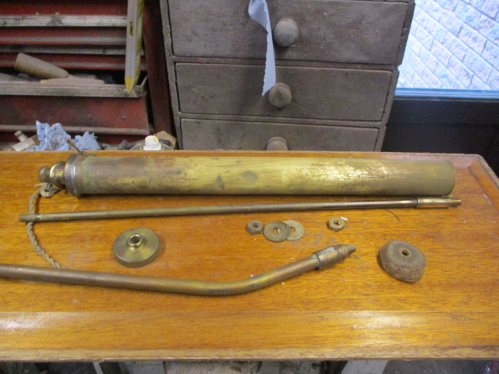

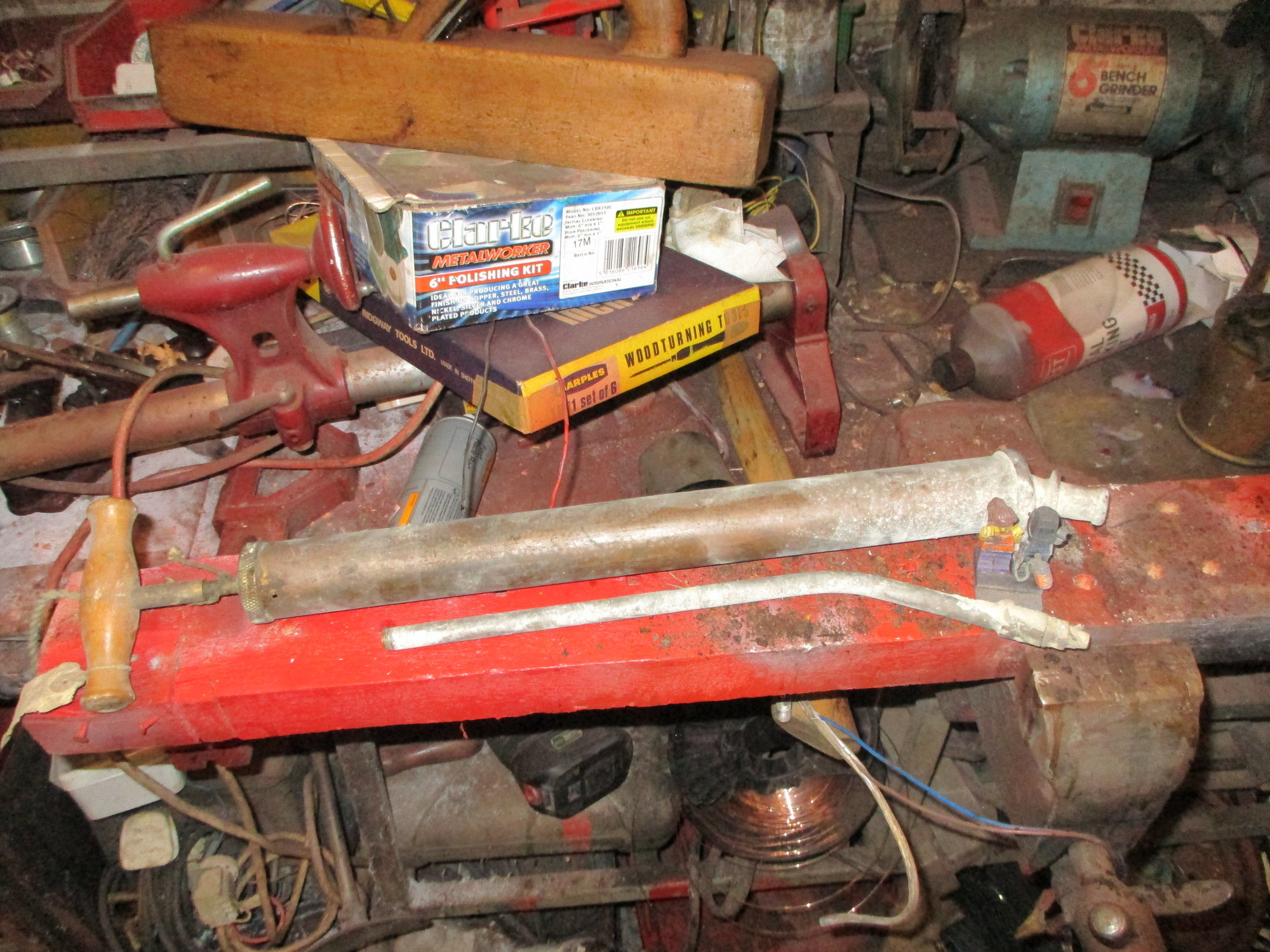

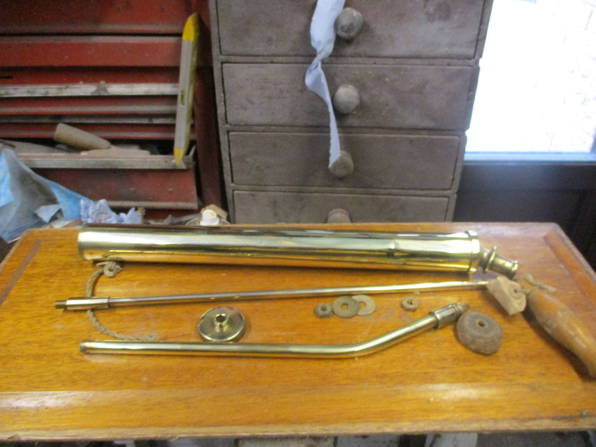

I "Acquired" this in a nice donation.
It didn't work and was very dirty.
Gentle heat was used to free off the parts, in the form of a Heated old fashioned soldering iron.
I dread to think what it was last used with.
Hand polished. The age of the brass allows it to polish up to a nice finish.
The handle was polished on the lathe and buffed with clear boot polish.

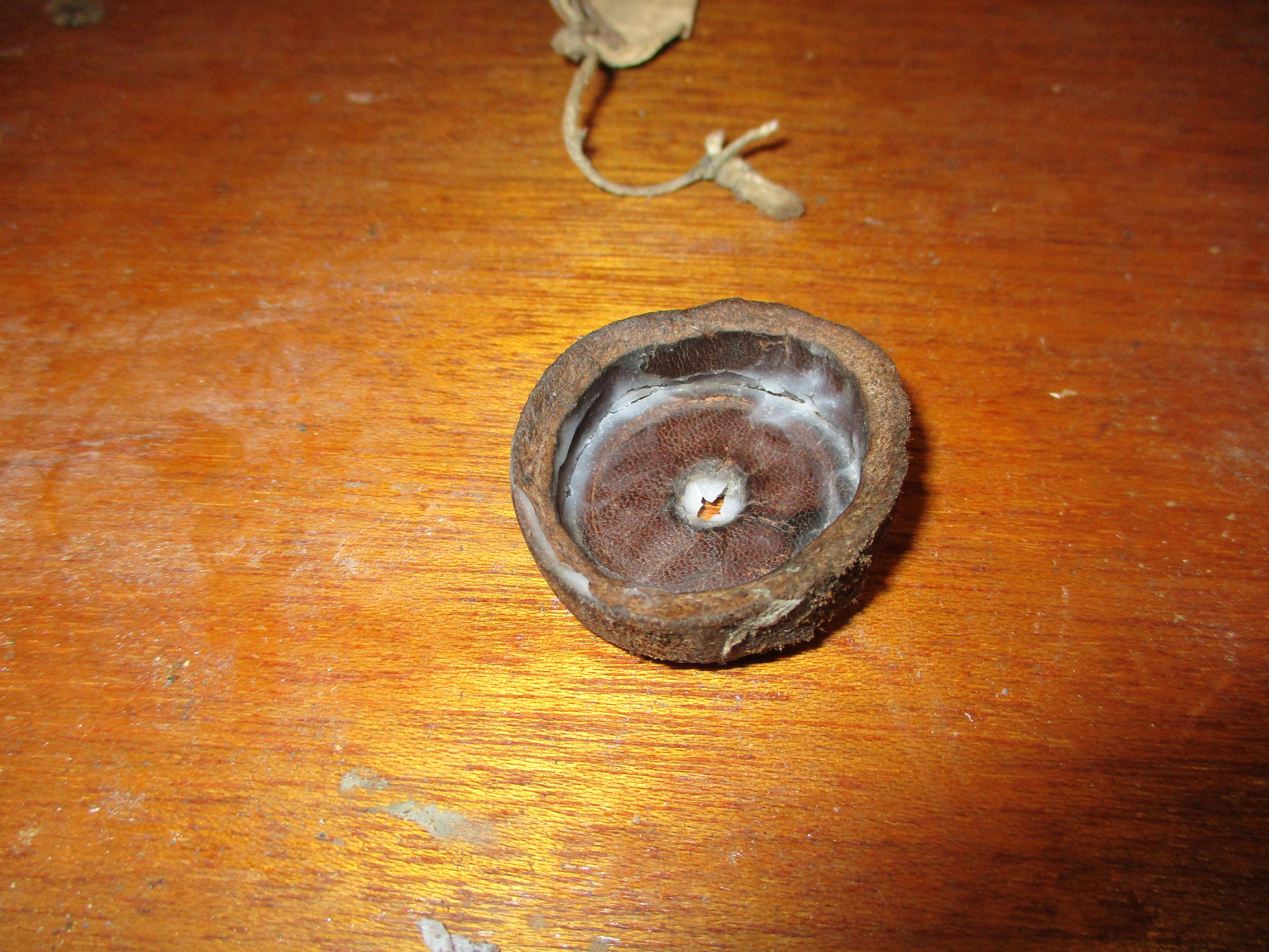

Hidden in the cap was a spare leather washer, dry as a bone. But with a leather coat restoration paste ha dit back to being a decent item.
Finished today, nowt else was planned. The pump works a treat on water. A local cat, who's has forgotten were its litter tray is found out.
The lower tube, looks like to be additional to the mail body as the 2 thread forms do not match.
There is no names on any parts. The labels what were on it had long ago lost any writing. I think I need to pick some ones brains.

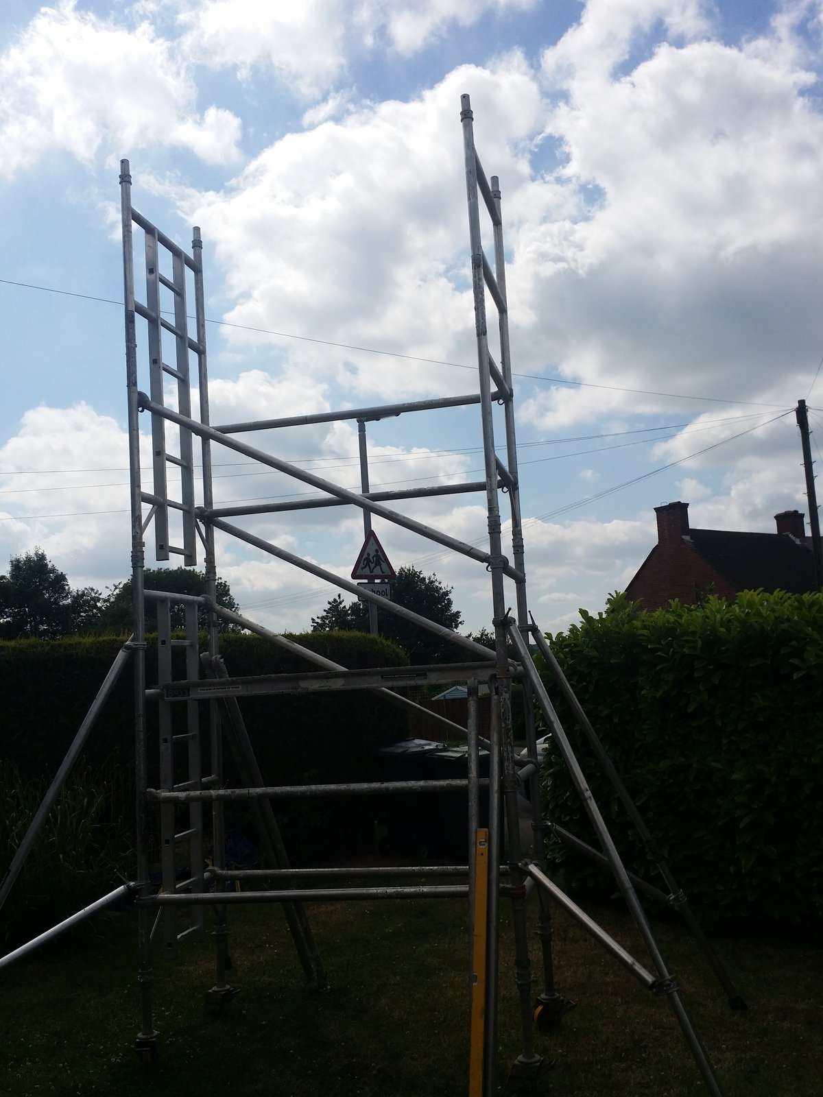

So today I've made this thing
It's somesort of scaffolding ,the neighbors need this for the olive season that's is actually now
It's made out of some 100x30mm galvanized rectangular tubing 2mm thick
Each leg is 930ish mm long
The orizontal parts are 800mm long
Upper width is 300mm
Lower width is roughly 860mm
Length is 1000mm
Hight is 900mm
Onto this thing will be bolted a piece of wood panel used in construction to give shape to the concrete (I don't really know how call those things we call them "cassero" )
I used my stamos S-MMA 250 IGBT set at 60A for flat joints and 75A for fillets
Using 2.5mm E6013
Versus every prediction I made only few holes
Because was aptemting to understand which was the better technic for the task
So little beads max 20mm long and starting closing the bead on the previous one
If I had already acquired the chop saw probably it was little bit prettier to see and probably the parts fit up was better
Next week I will take the chop saw
Another thing that I recognized when I shortened the parts on the side is that with a plasma cutter the results could be better and safer than do this with a grinder
So I have to buy a plasma cutter but I have to wait until I put some money a part to buy a Chinese unit
So I think that I said all that I done today about this project

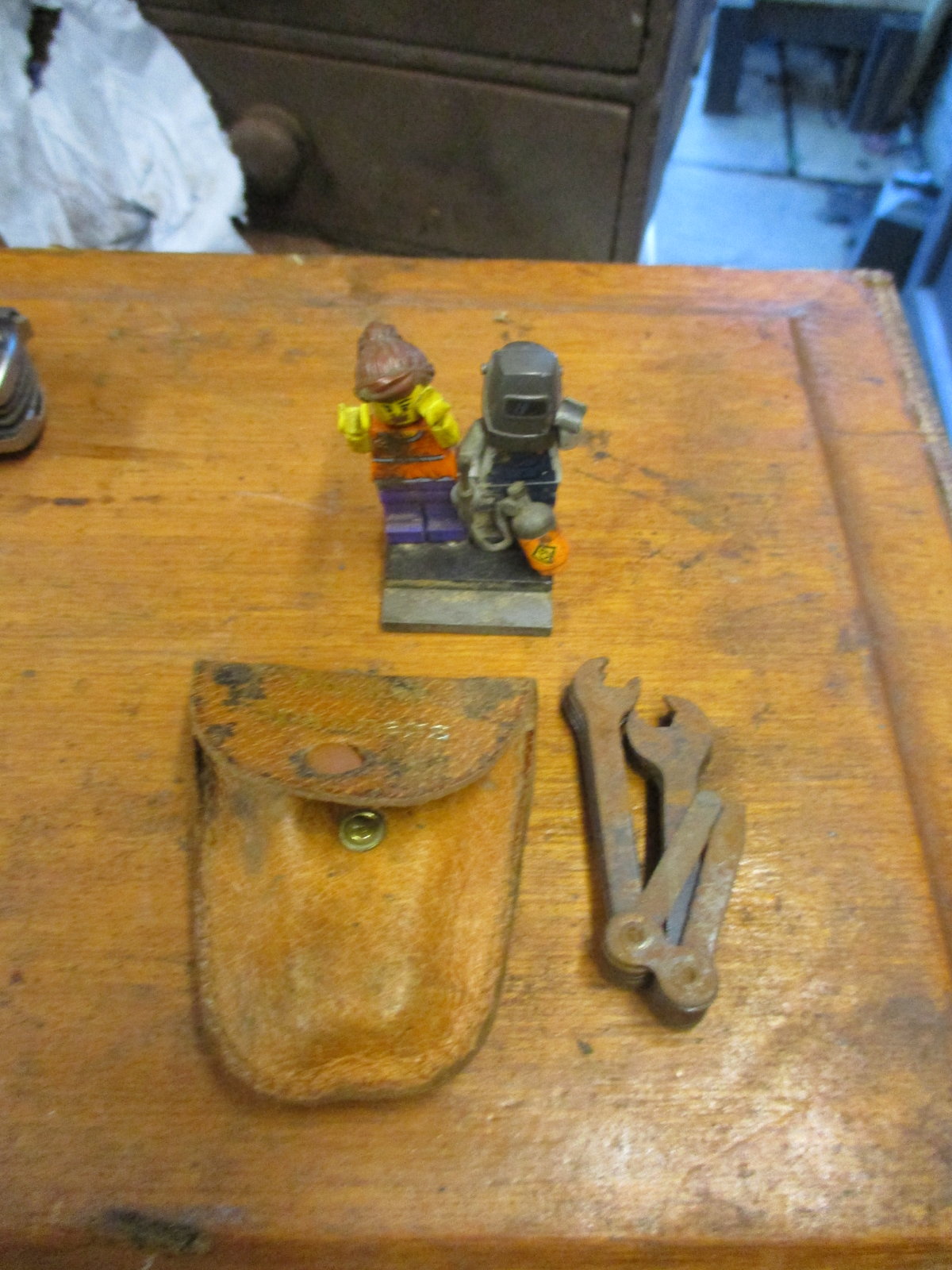

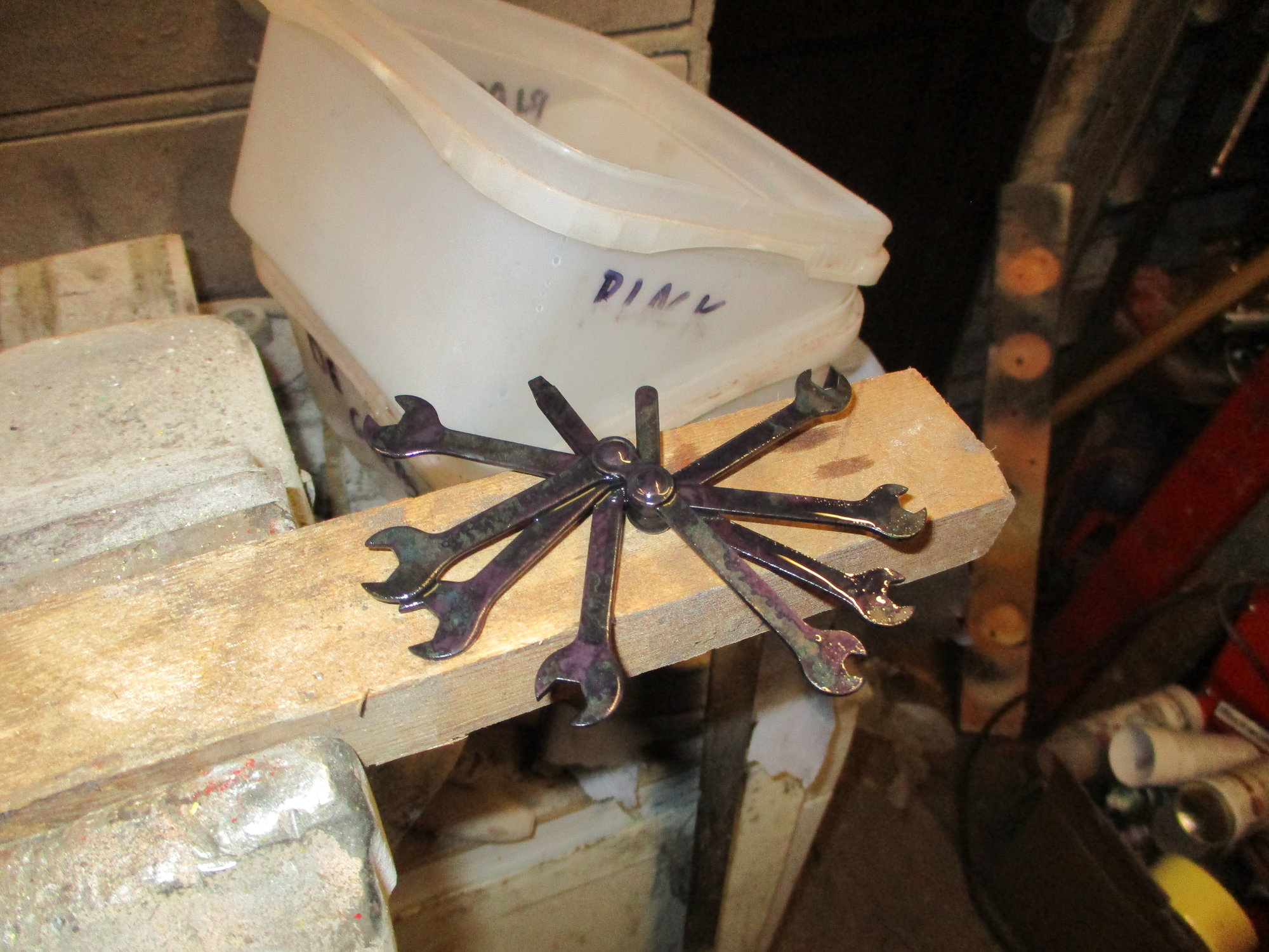

Job 1.

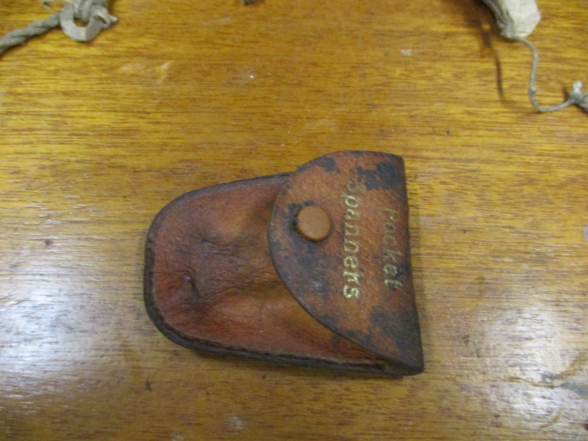

Pocket spanners.
The leather was stiff and a bit mouldy. The spanners did not move.
The leather cleaned and brought back to life with a leather restoring paste.
The spanners were then "blacked" with my kit.

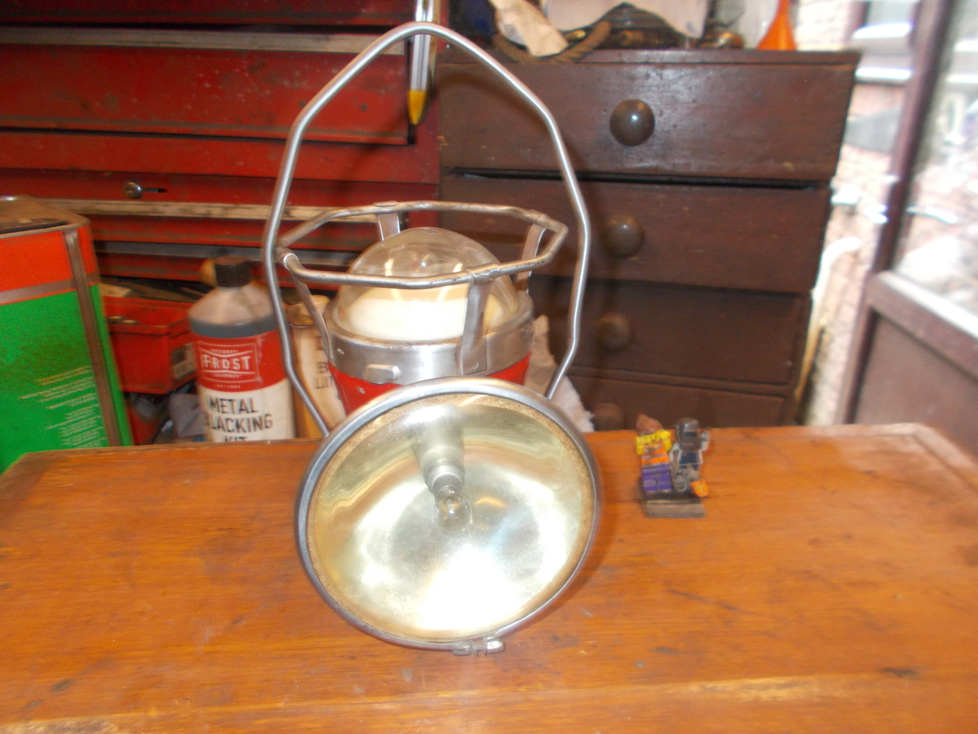

Job 2.
Pifco Fire Fighters Torch.

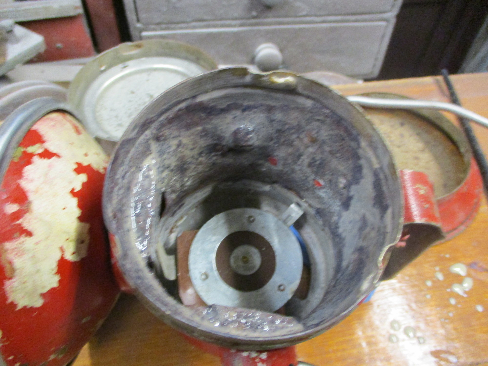

It was in a poor state, I even thought about giving up on it, it was rusted and busted. But I thought I parted with some money, I could not waste it.
This was the best view of it.
You can see how bad a leaky battery had damaged it. There are a few holes and a lot of rust.
The body was striped and washed in the battery acid cleaner we use at work.

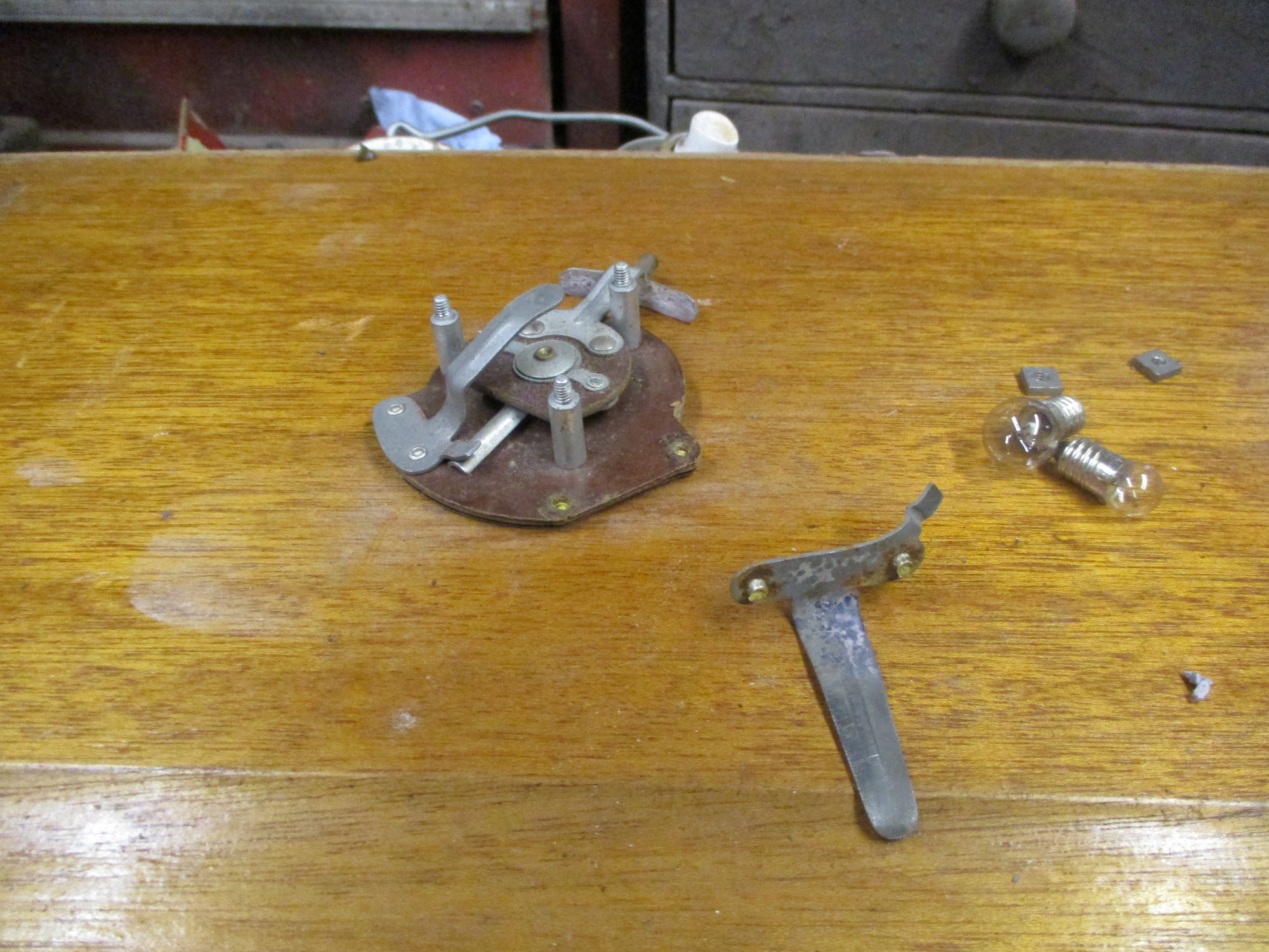

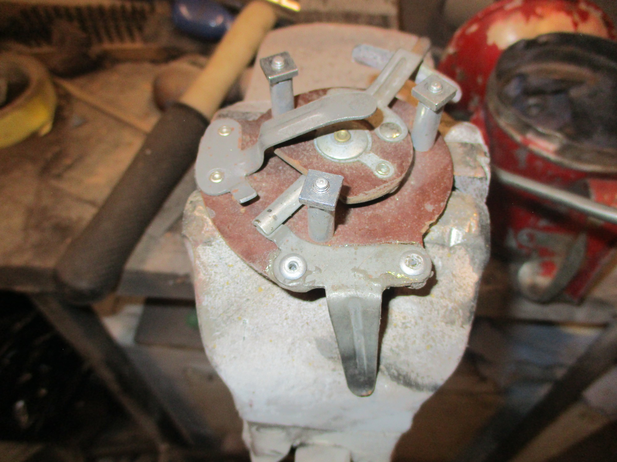

The Lamp controller fell apart, so I riveted back together.

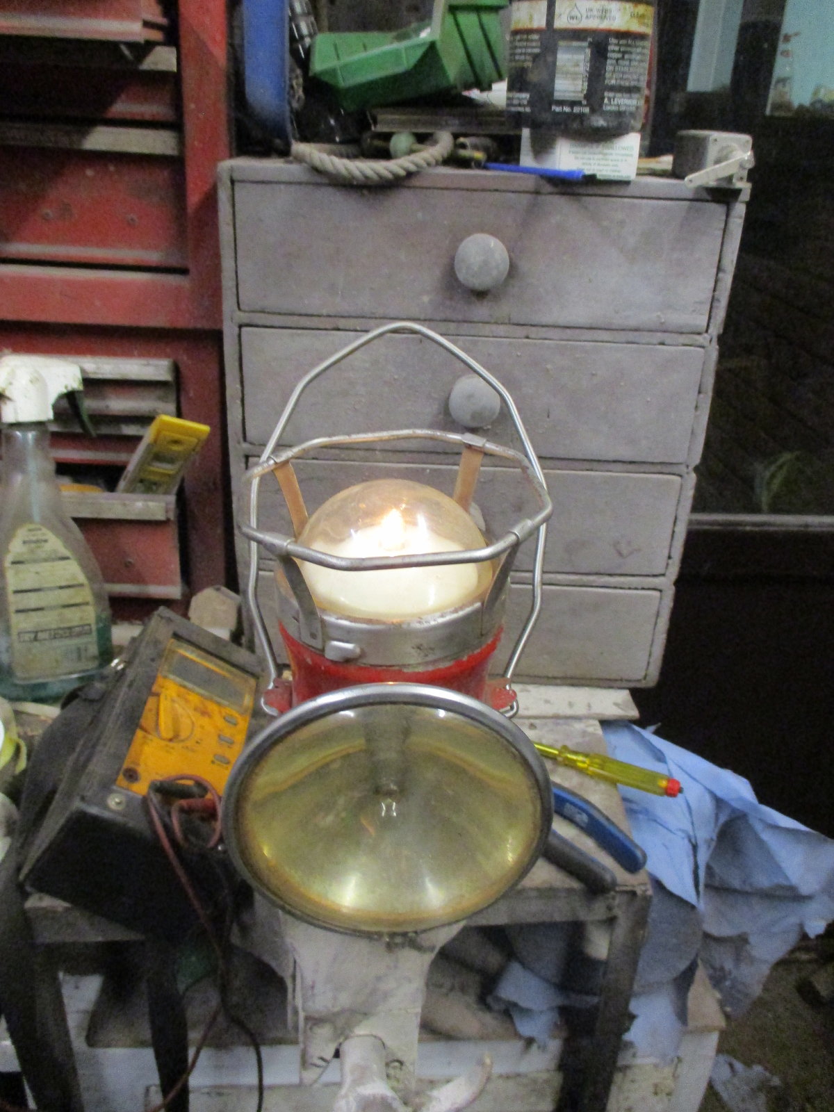

The lamp can only have one bulb working at any one time. but the top one does flash. It is the original bulb and it still worked after all the abuse it got.
The front one gives a nice beam, wide and bright, new bulb was purchased from a decent local hardware shop.
This image shows how bad the plastic lens had "yellowed" over time. This is after I cleaned it hard.
The torch has no plans for it's future, so it will gather dust for a while.
