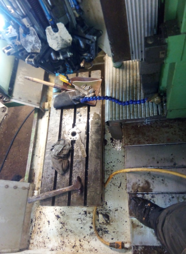

I'm worried about you mate. If you start feeling the need to paint anything then get yersel to the vet's ASAP! xI must have a fever or something, yesterday I cleaned out the swarf from the Triumph, today I cleaned the Chiron.
The Chiron was badly in need of a clear out. With me working up the road on the Cat I had been coming to the workshop to make stuff then heading up to fit it and didn't really have time to clean the Chiron. I will need to clean out the coolant though as it is kind of black with all the muck.
View attachment 202079 View attachment 202080 View attachment 202081

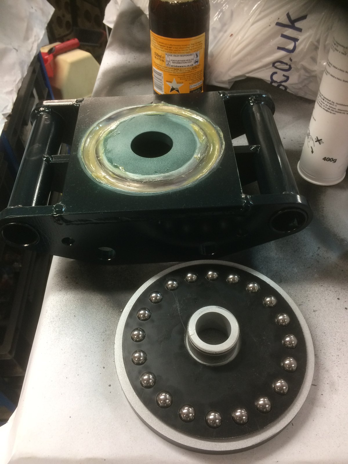

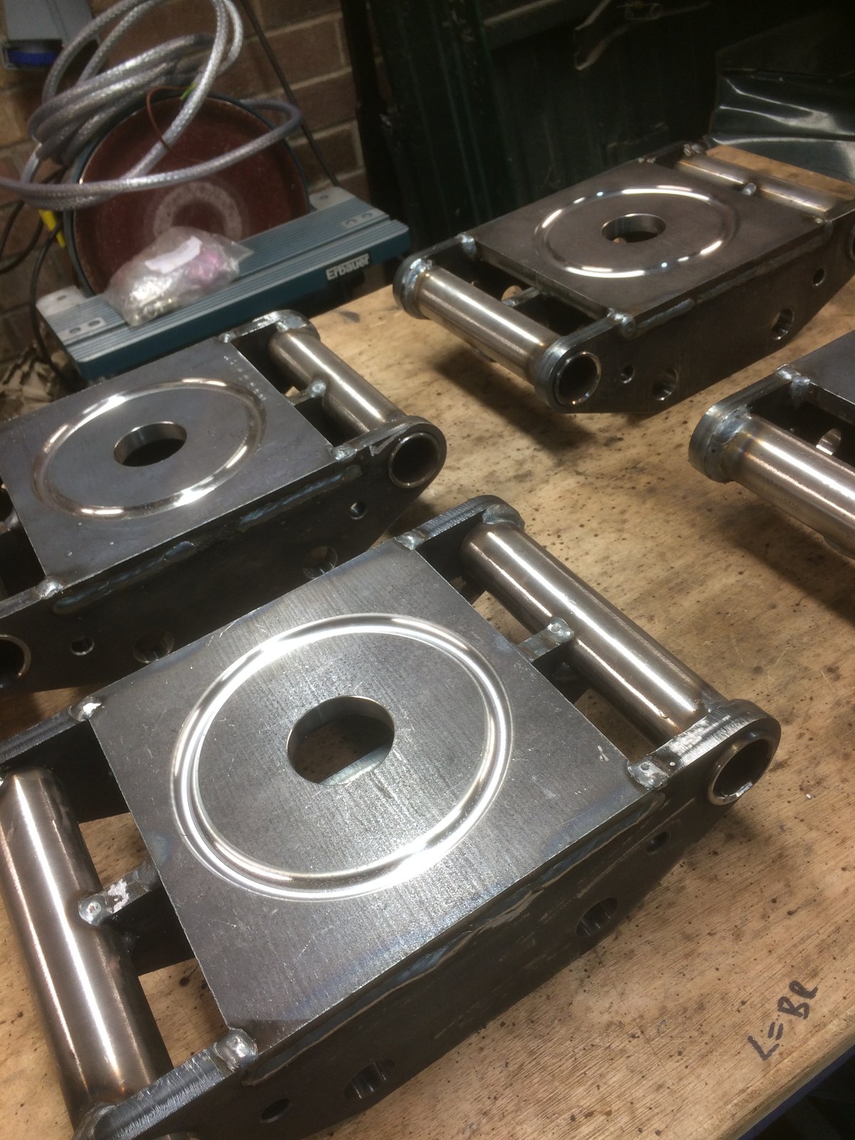

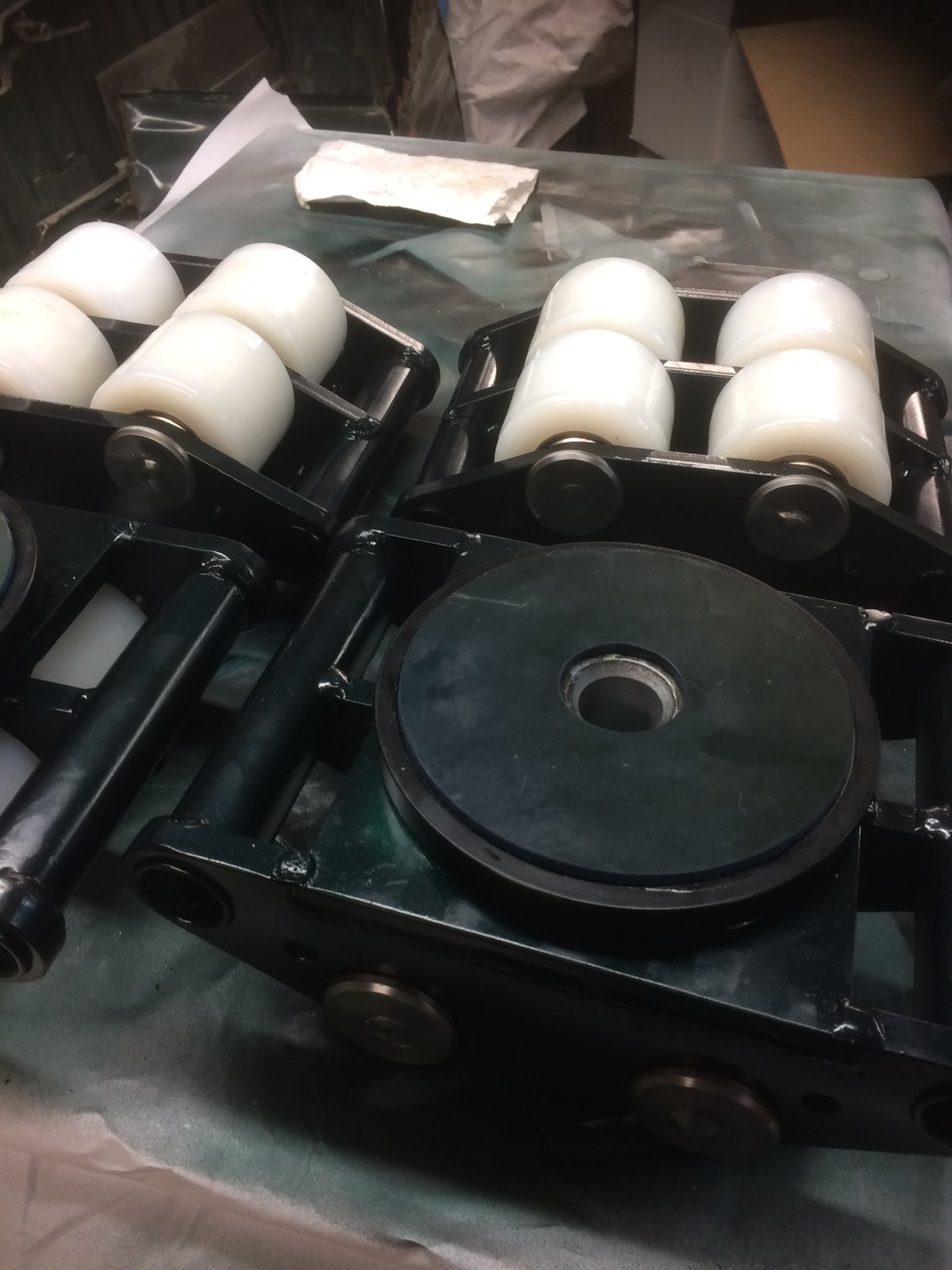

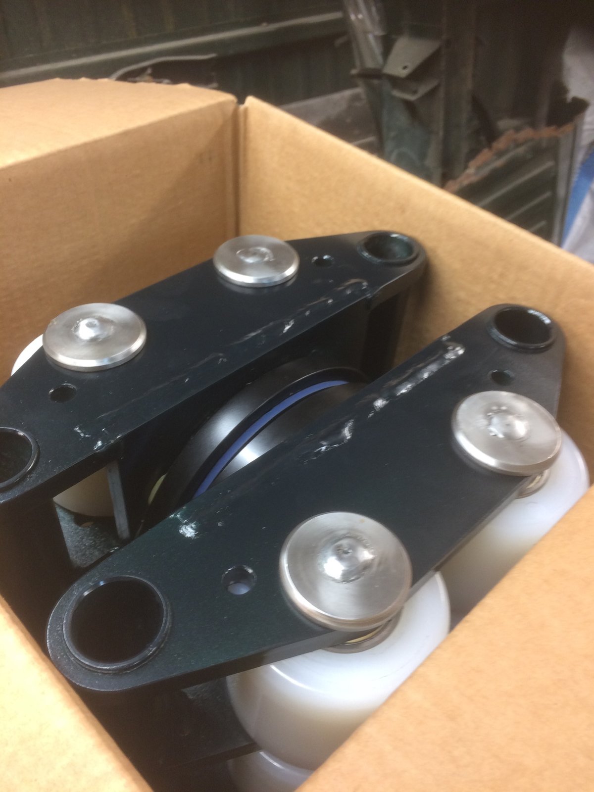

Like those a lot.Finished my machine moving skates today. Built in turntable with 12mm balls running in a machined groove. Bit of polyurethane glued to the top. Can either have all steerable or lock them together in pairs with a 30mm round bar. Next up on my list is a toejack...
View attachment 202154 View attachment 202155 View attachment 202156 View attachment 202158 View attachment 202159
Ooh, they look really good. Looks like a very good design. I might have to add that to the neverending list of things I want to make...
