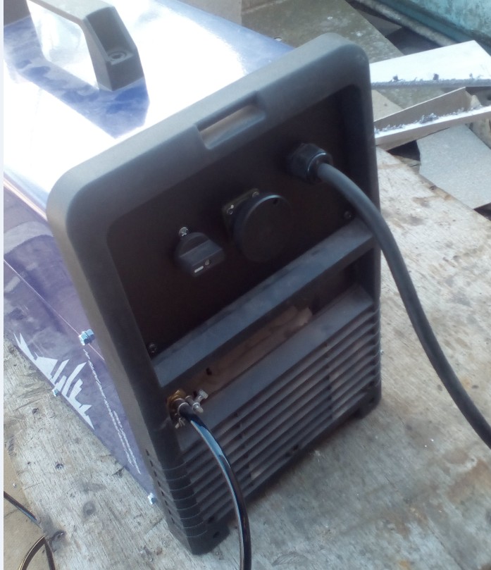

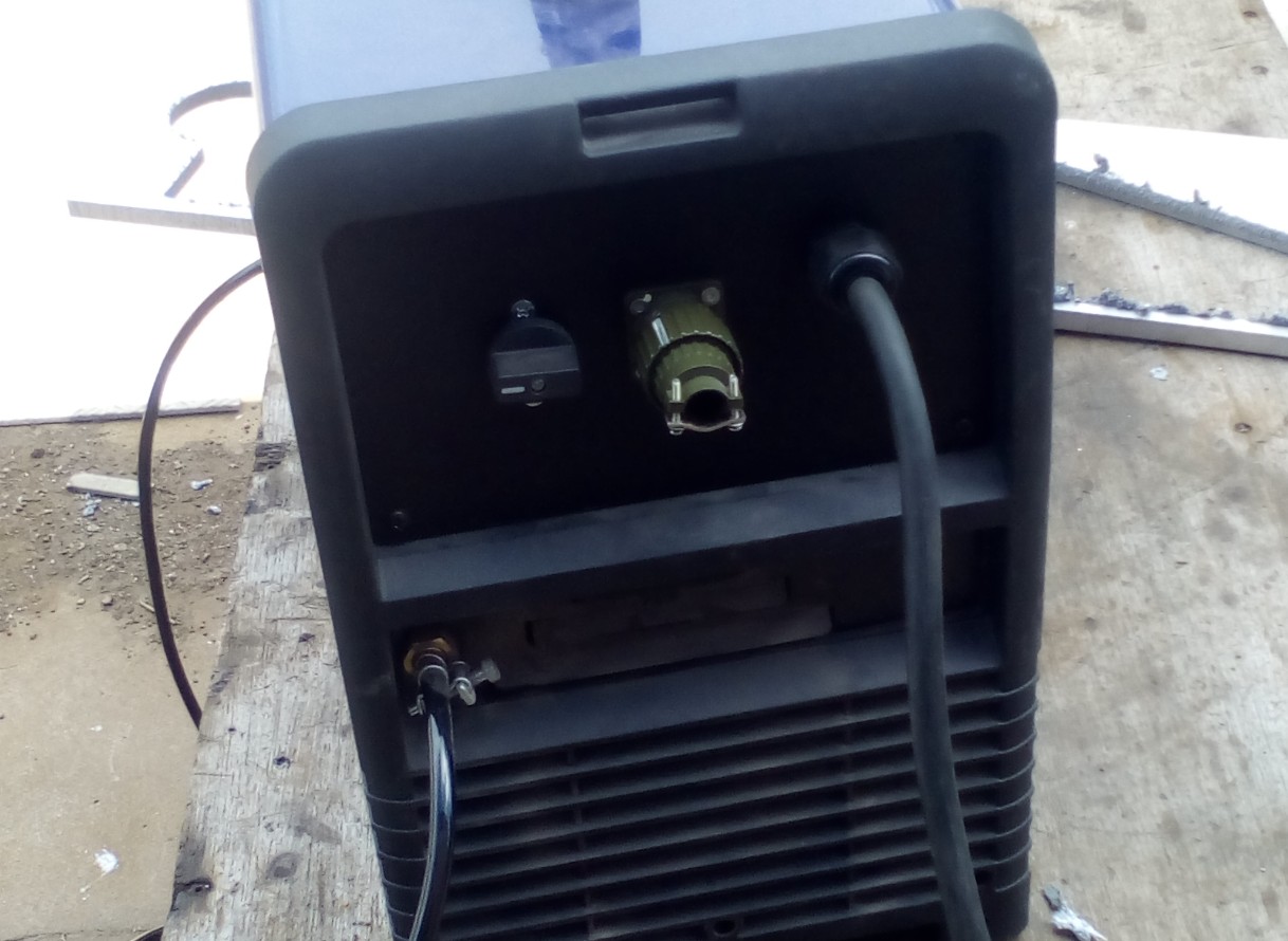

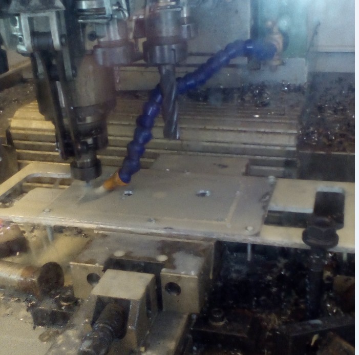

Wanted to have a socket on my Parweld Tig that was powered via the main switch so that my water cooler could never be switched off whilst I was welding, burnt a torch up a few weeks ago by exactly that happening.
Was just going to bore a hole in the back plate and fit a socket and wire it into the main switch but then decided a better option would be to make a new plate out of Alu, that way if I ever sold the welder it could be put back to the original setup.
Fixed a piece of 3mm Alu to some heavier scrap alu so it didn't buckle whilst in the vice and let the Chiron do its thing.
Gave it a quick coat of etch primer then satin black to match the original.
Here it is on the back of the Parweld.
Because the socket is actually the wrong gender (male pins) I made a Delrin cover for it for the occasional times that there will be no cooler connected, still have to make up a restraining strap so that it doesn't get lost.
I'm being thick, how does it work?![]()
Live pins are a bit (a lot) naughty.
Hey I will plead ignorance, shouldn't be hard for meDo you like prison food?![]()
Just bought some plugs and sockets the correct gender.In reality it would be very unlikely anyone would get zapped as no one gets to touch my welders unless they have a death wish AND THEY KNOW IT! so if they have such a wish it would save me the bother of expending energy if they fried themselvesYou know it makes sense. You just might have saved someone from a nasty shock.
