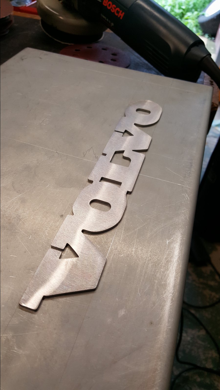

Nice job except I see jaw grip marks on it, can you not sand them out? I use steel jaw covers when I'm working with cutting out metal shapes with files etc
Yes indeed there are a few...I will sand them out before painting...I have vice covers for the jaws but have missed placed them.an idea to make another set thoe.Nice job except I see jaw grip marks on it, can you not sand them out? I use steel jaw covers when I'm working with cutting out metal shapes with files etc
Am going to make some right now. Been one of them to do jobs that never get to do.Good to hear, you've done a lovely job cutting and it'd be sad to see it with a poor finish. I have an ally set for softer metals and some folded steel ones for when you need the grip of the vice but not the cutting of the teeth. Wouldn't mind some of those rubber magnetic ones...

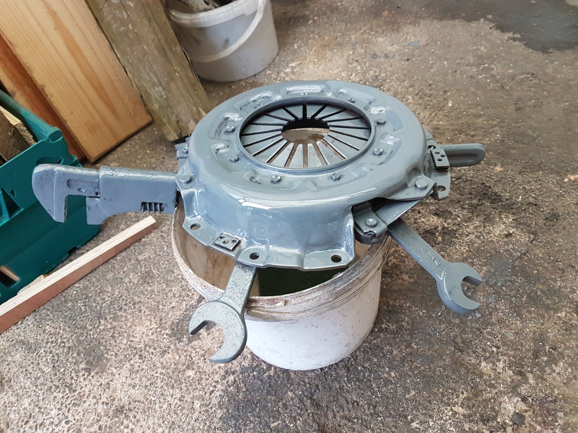

Pressure plate and fixing kit in one? Great stuff.a tortiseView attachment 109741
I can mirror polished it...yes plug weld from the back...it looks better than trying to attach it with bolts/screws ect.Great job, really nice work, Got to be mirror polished though!How are you attaching it to the box? Plug weld from the rear would be my choice,

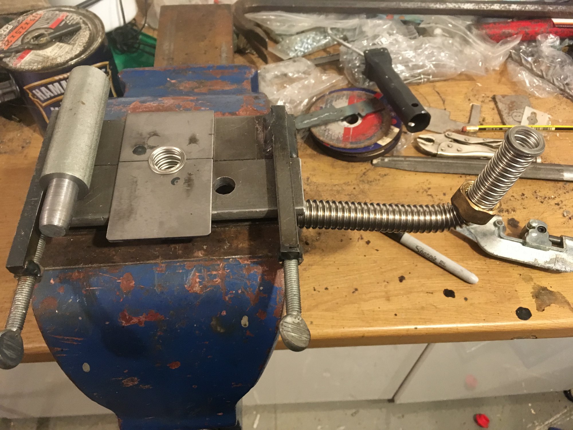

I will be making some this weekend..@spencer 427 I made ones in a variety of materials, alu/rubber/cork/plastic - cut a bit of alu angle, back it with magnetic tape and glue whatever facing you want on the contact surfaces - job jobbed![]()
