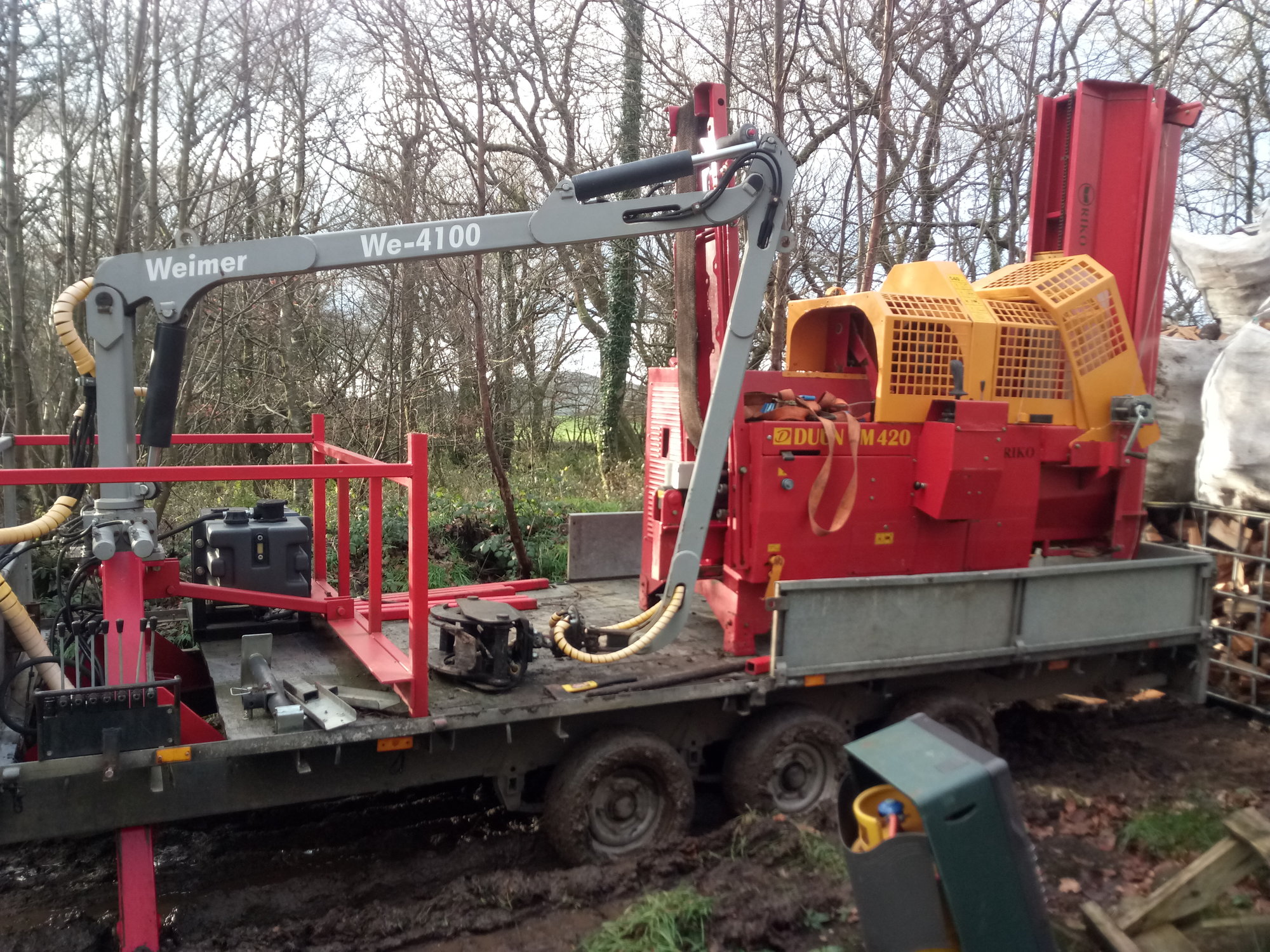

This months project is making a monster mobile firewood processing plant.
Started with the processor.

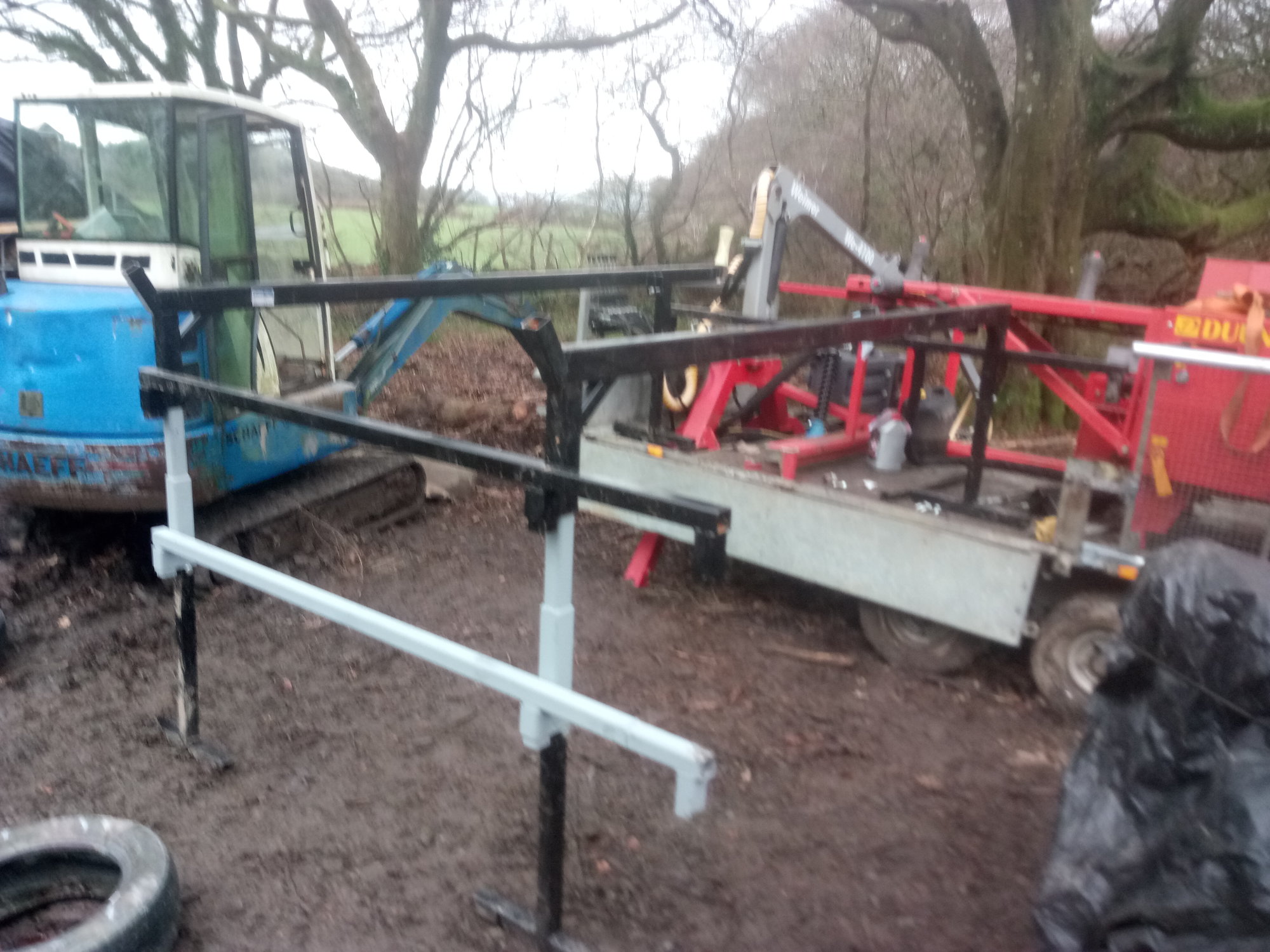

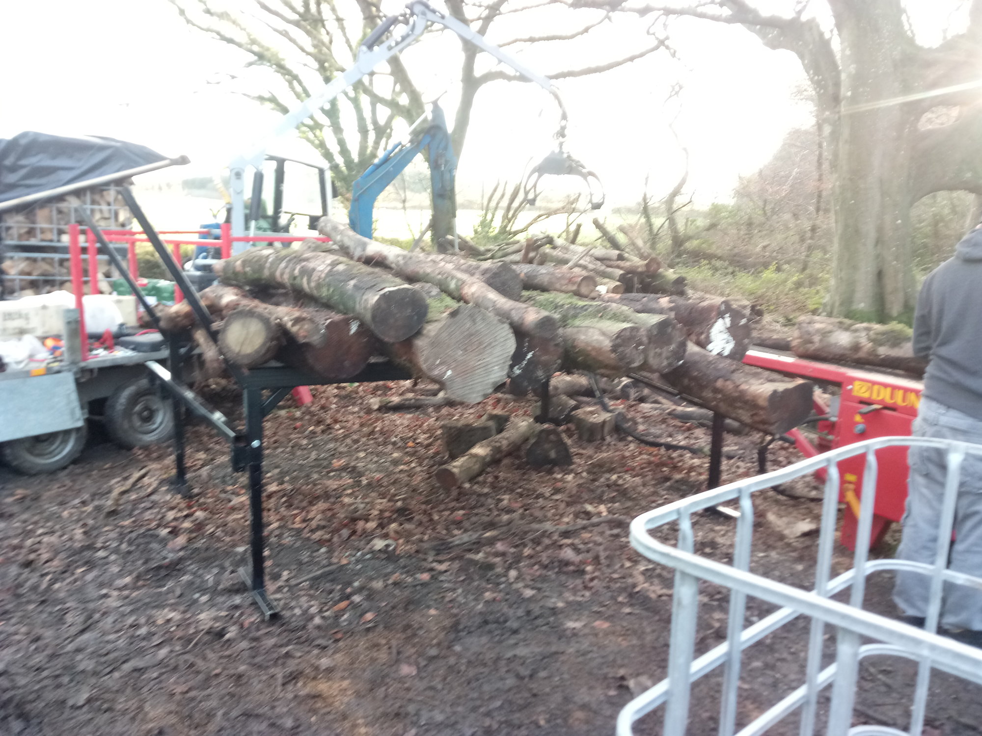

Bought a 14 foot trailer with a log crane already fitted (save a bunch of work but also created some too).

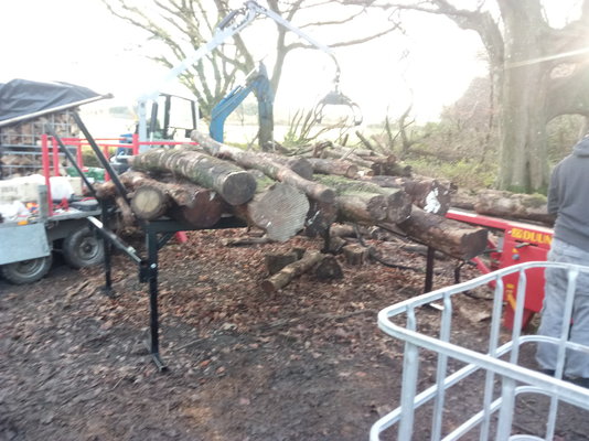

Bought a log deck as a starter kit but then altered the life out of it by adding a third beam, raising one end & altering the motor & rollers. Looking back I should have just made it all & save a bunch of money.

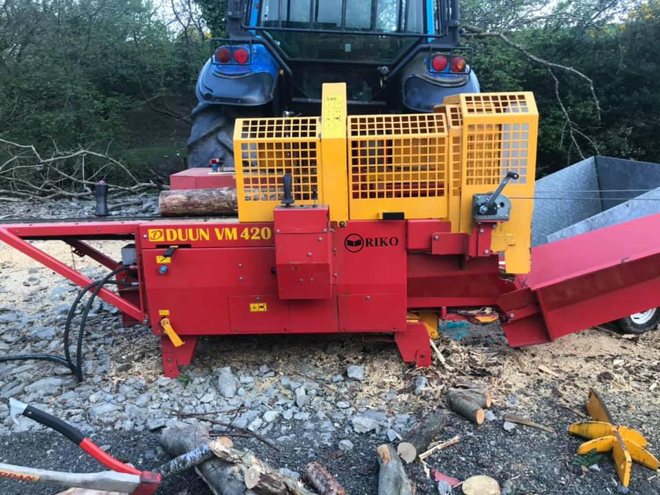

Started with this processor.
Un altered log deck
Mounted processor
Yes I know it looks well back but the crane is heavy & the engine will be mounted further forward.
The balance point of the processor is between the rear two axles.
Before its fixed down I will do balance / driveability tests.
A few stages of the build

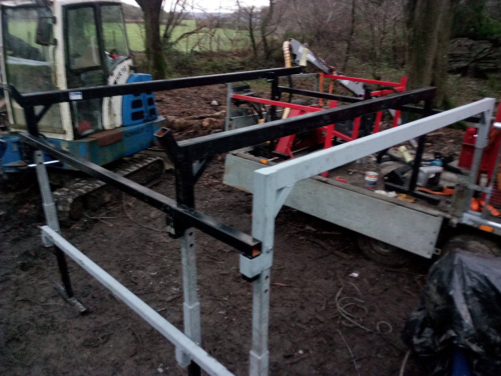

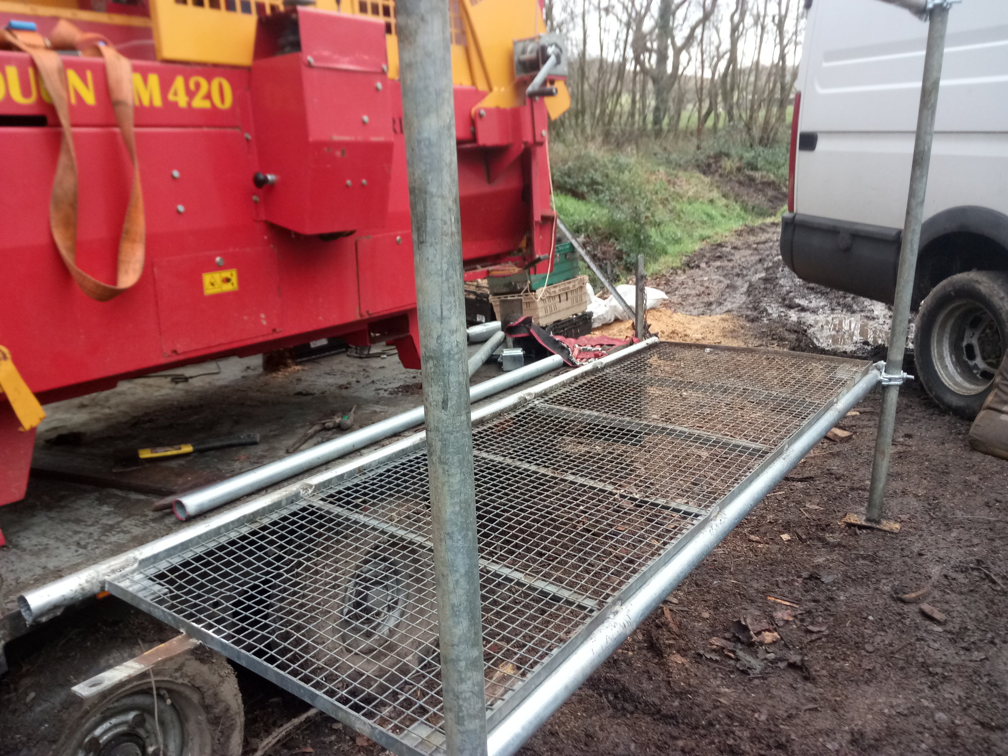

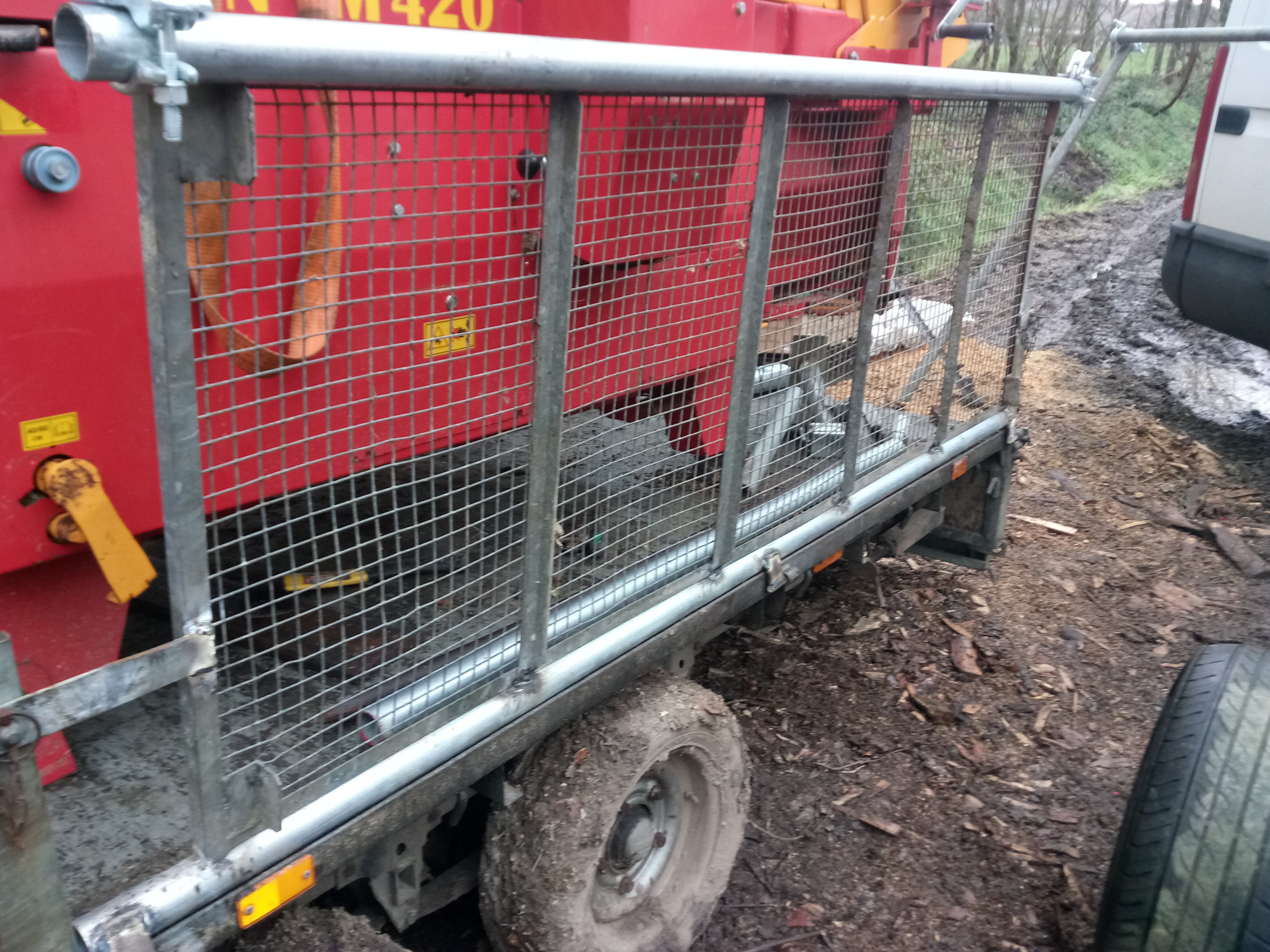

Work area up, doubling up as a trailer side.
Work area down
Still needs an adjustable cross brace underneath

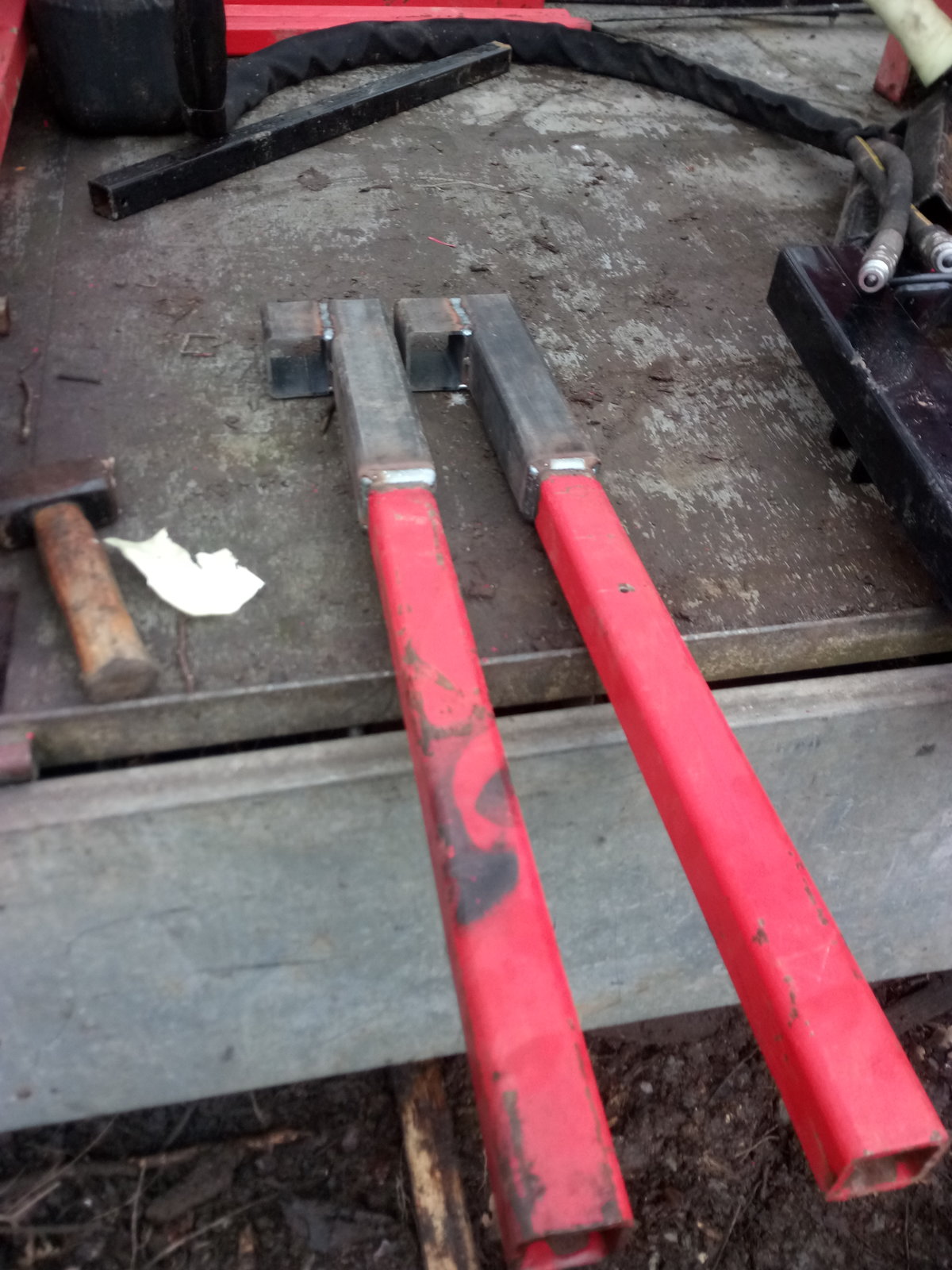

2 of the leg extension bits
Test fit of extended legs & additional brace

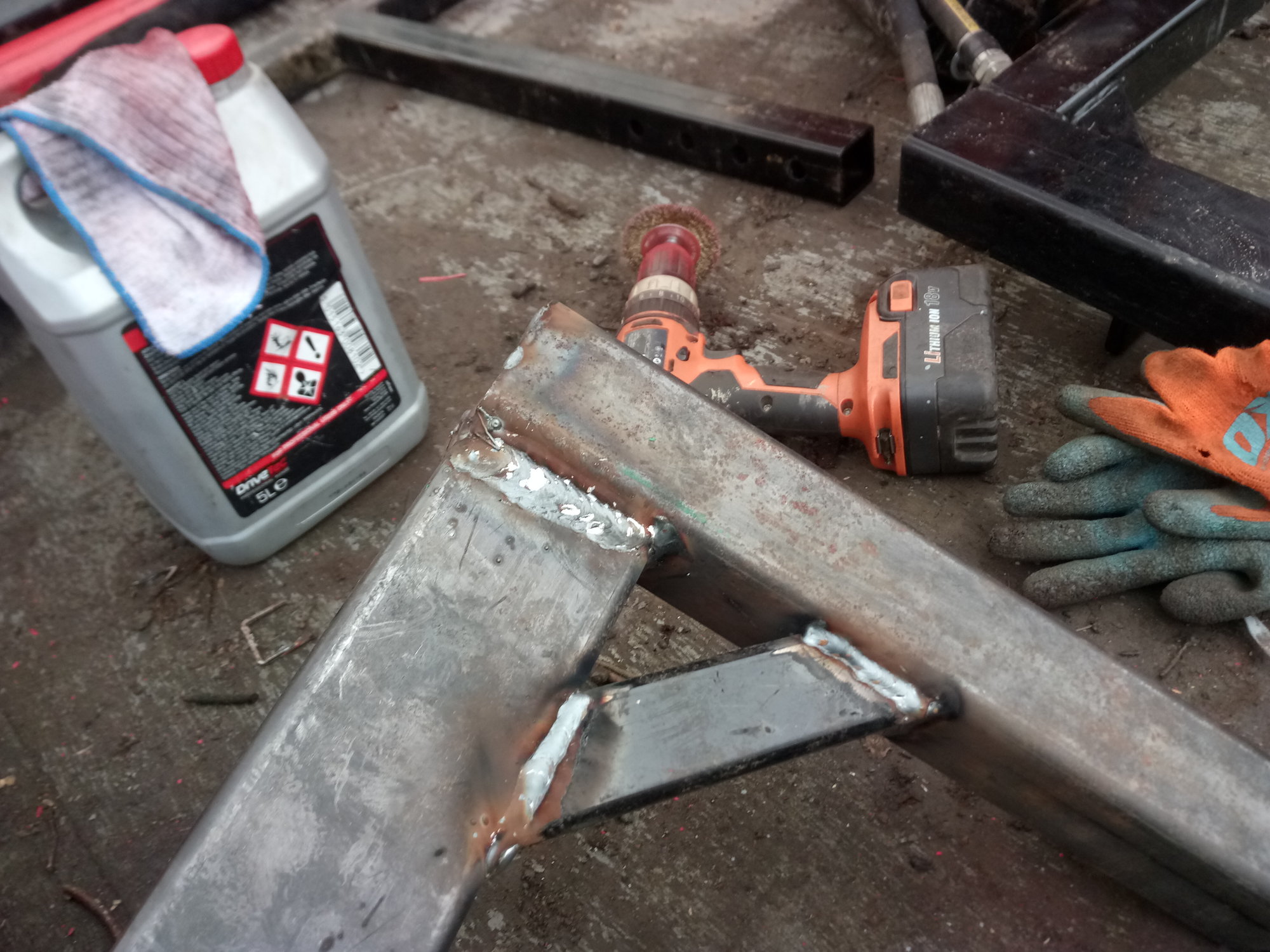

I did plan on adding diagonal bracing as well but the second brace has tightened it up so much even without the bolts I dont think it will need it.
Third beam end
Altered log deck assembled

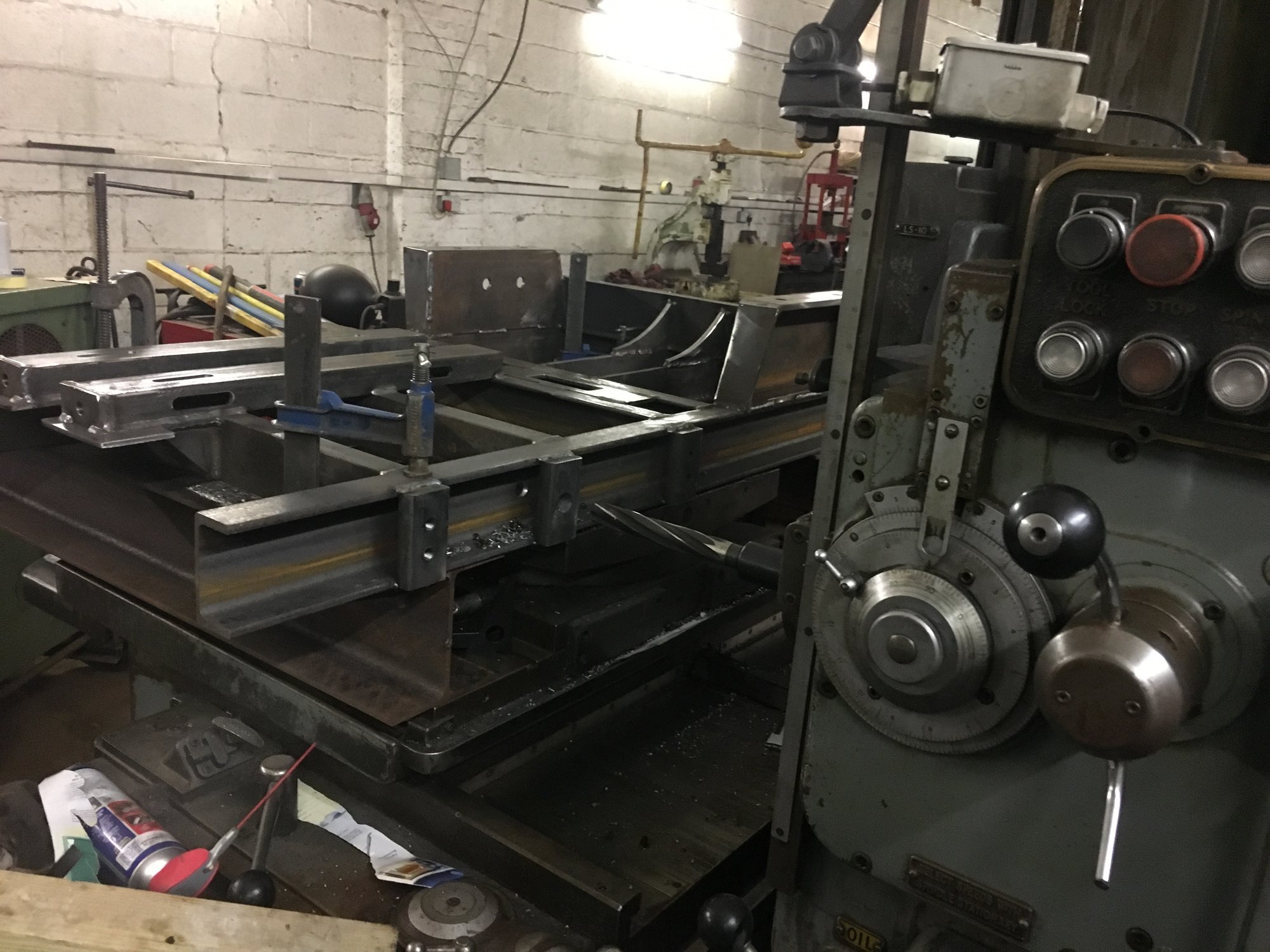

The crane had ONE snapped bolt. It was slightly leaking.
Yesterday started to strip to fix it.
Found that previous owner had glued a snapped bolt in with silicon so there were TWO snapped bolts.
Oddly both stubs came out super easy.
Yep your right that should have been alarm bells.
Most of the other bolts were covered in PTFE & some looked like they had liquid metal in the threads.
All no biggy, been there done that, grabbed the m8 helicoil kit off the shelf.
Hole one, no problem, hole two ***** snapped tap in hole.
Had a quick try to shift it but no joy.
Stripped crane down & dropped it off at the local Agri fab shop & should be done by tomorrow.
Will then need to carefully helicoil the other holes too & fit with new bolts.
I expect the snapped hole will need to be m10 once they have sorted it. No issue plenty of metal to do so.
