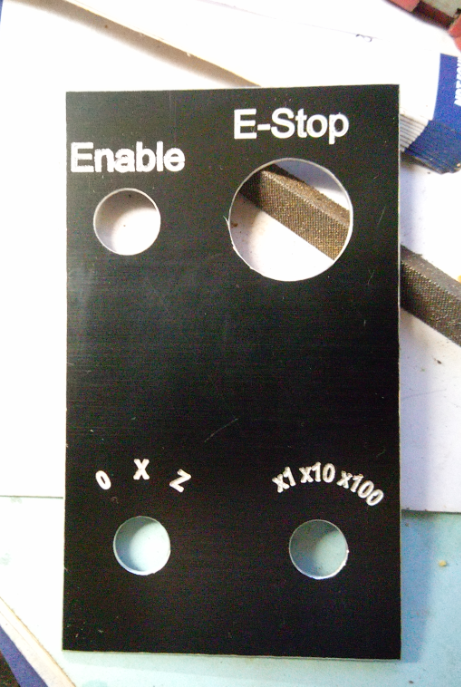

Just done the disc for the centre of the MPG, better go and get on with some real work now

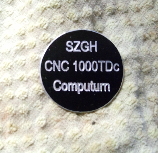

It was a v cutter, the nine9 one I use for some stuff. Just did the one pass so that is a good tip for future Not that I do much engraving but on the odd occasion I do I will give it a go.Are you doing that with an end mill, or a v cutter?
Standard practice with engraving is to make two identical passes. You would think it would make no difference, and i wont argue the logic, but it works. Its said that the first pass does the cutting, and the second does the cleaning.
Again, identical passes, no change in anything.
Gotta keep them sweet.
