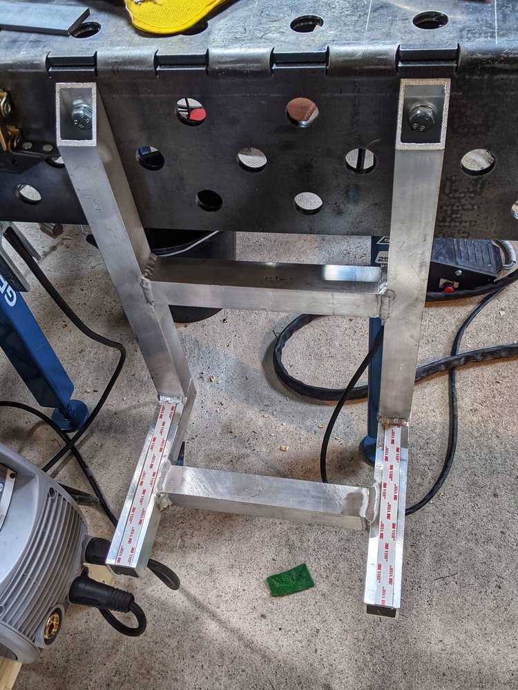

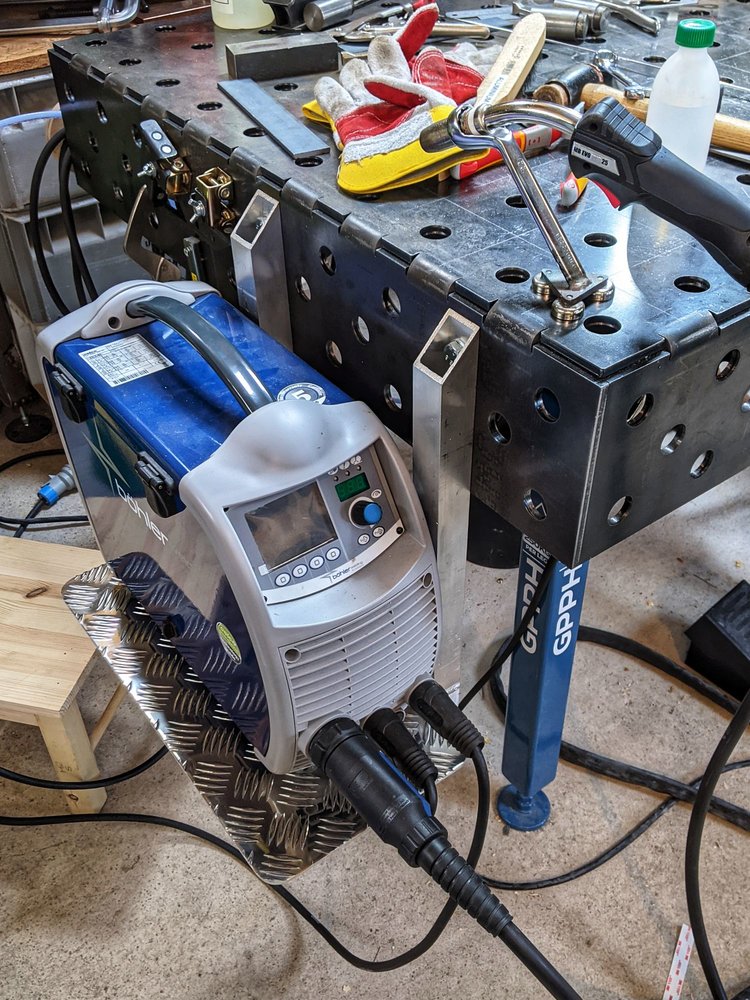

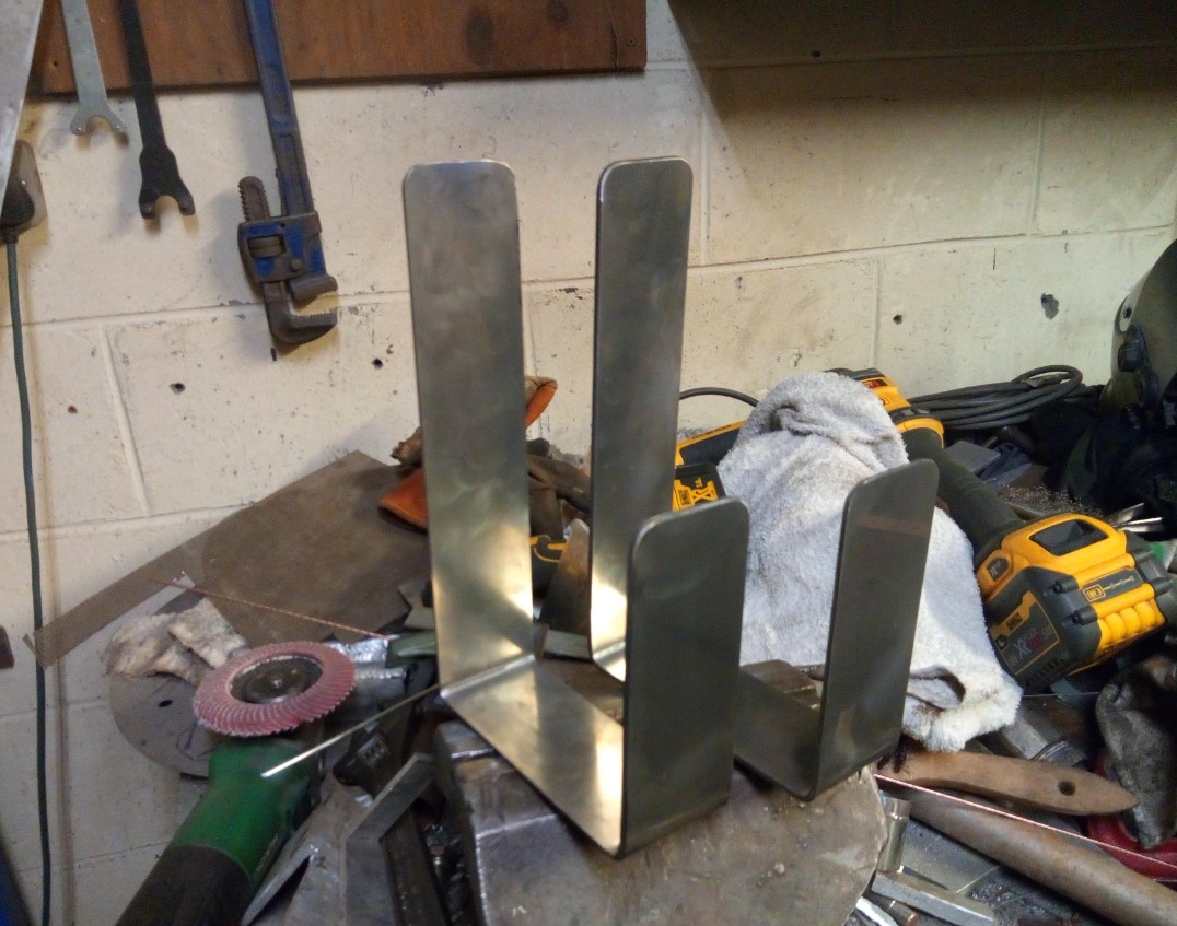

Very convenient! Nice welding bench, too! You may have already thought of this, but you might want to rig some sort of cover plate (possibly an extension of the bench top?) over the welder to protect it from sparks/slag/grinder dust, etc. Clever use of the offset box-end wrench as a torch holder.First thing this morning completed welding up this shelf that hangs off the side of the welding table. Goodness knows how much tungsten electrode I got through with dipping and regrinding, and in retrospect didn't clean the metal sufficiently - but it's the most AC TIG I've ever done!
