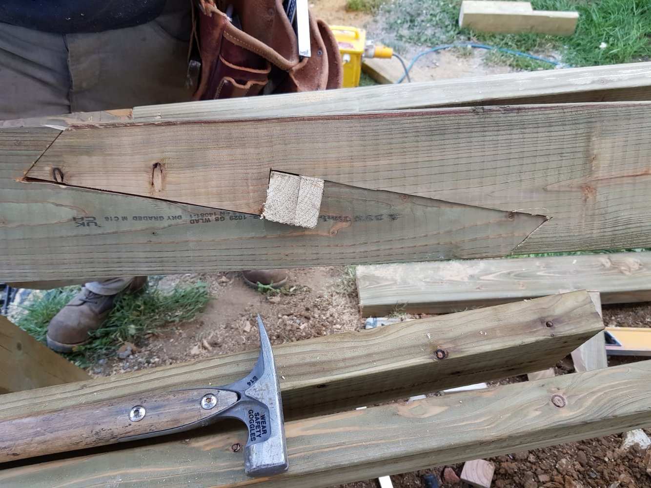

I welded the blade of a 38 mm woodworking chisel to the shaft of an SDS masonry bit in order to use the hammer action of my Dewalt drill to chop out the scaffolding planks I used in the shuttering for the concrete head over my new fireplace. The planks are new, 3 inches thick, and a very tight fit with no way to remove them but to break them out of the fireplace bit by bit. I didn't fancy the idea of doing it by hand with a hammer and chisel so this was the solution I came up with and it works brilliantly. What you see in the second and third photo only took me a few minutes to do.
