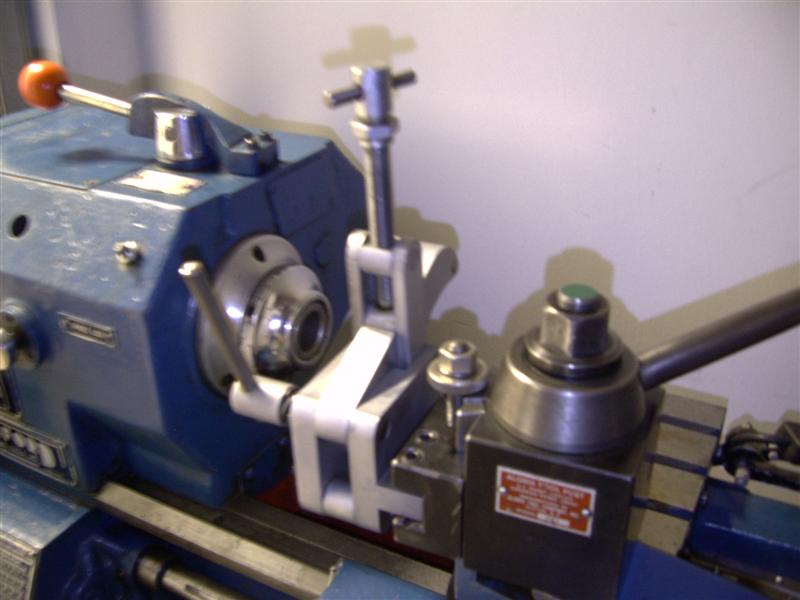

I use a clamp type on my Myford. I wouldn't use the push in type....I have a knurler of my 'to buy and try' list. I'm minded to go with the 'clamp' type over the 'push' variety as I'm conscience of the potential strain on the small Myford.![]()
I've got probably the same one, with three different knurl pitches? It works relatively well, does take a bit of tool pressure but I don't think it's an excessive amount, probably no more than a heavy cut using carbide would cause.I got a J&S push type knurler from someone on here and it works very well on steel... I think the wheels themselves make the difference, as to how sharp they are etc

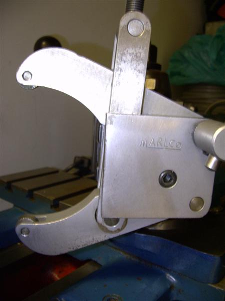

Clamp type is the way to go, but Id recommend making over buying it. My one is not great quality for the £25 it cost - the wheels are on pressed pins, one is a sloppy fit on the pin and in the frame, so it wants to walk to one side.I have a knurler of my 'to buy and try' list. I'm minded to go with the 'clamp' type over the 'push' variety as I'm conscience of the potential strain on the small Myford.![]()
Although I generally prefer making tools if I can, I was too lazy in this instance and bought a clamp type one and it has been excellent. Can't remember where I bought it from though...Clamp type is the way to go, but Id recommend making over buying it. My rgd one is not great quality for the £27 it cost - the wheels are on pressed pins, one is a sloppy fit on the pin and in the frame, so it wants to walk to one side.

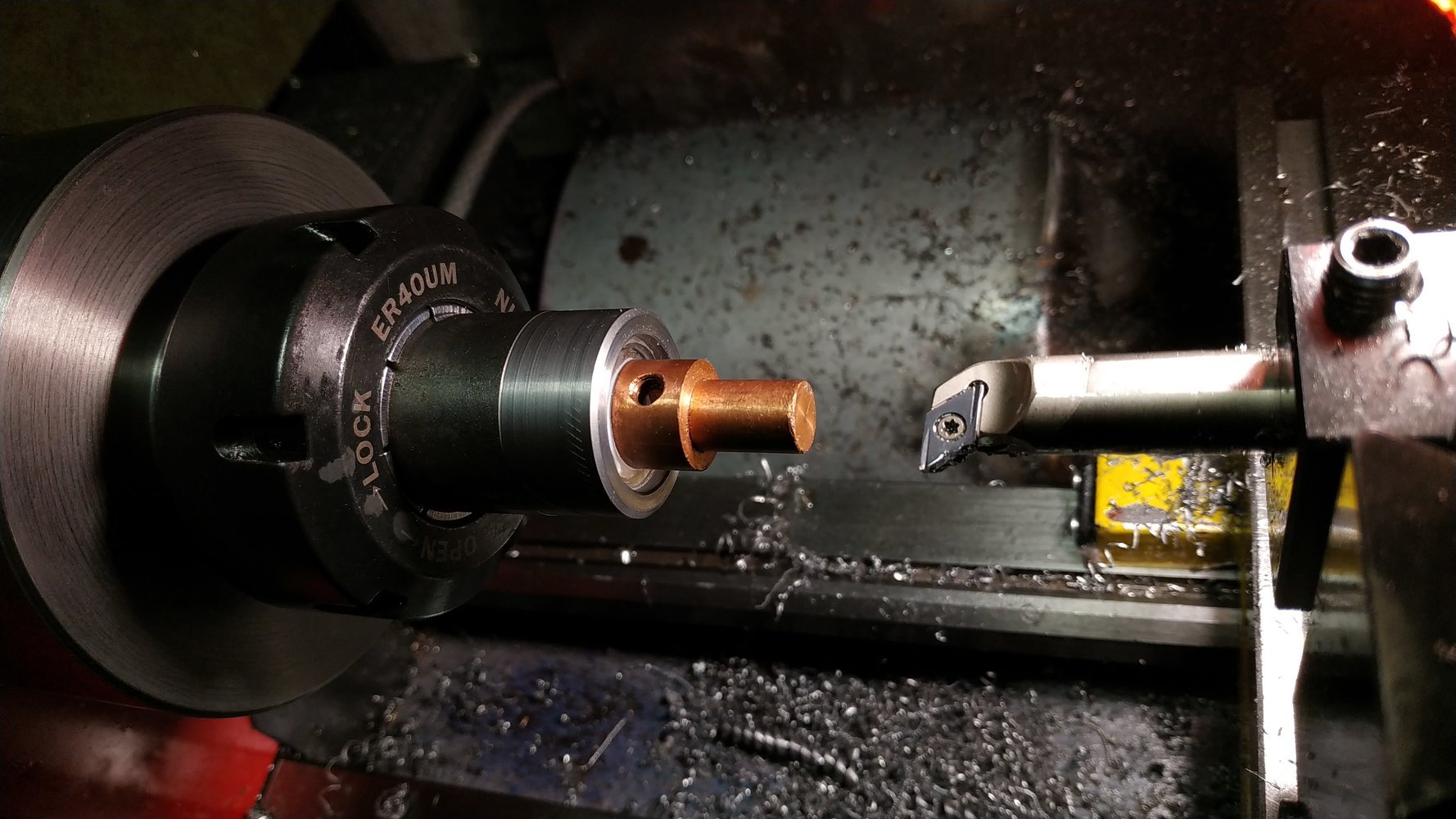

I turned up a seal insertion ring for a mate.
I didn't ask him what he was doing with itMarine biologist is he?
