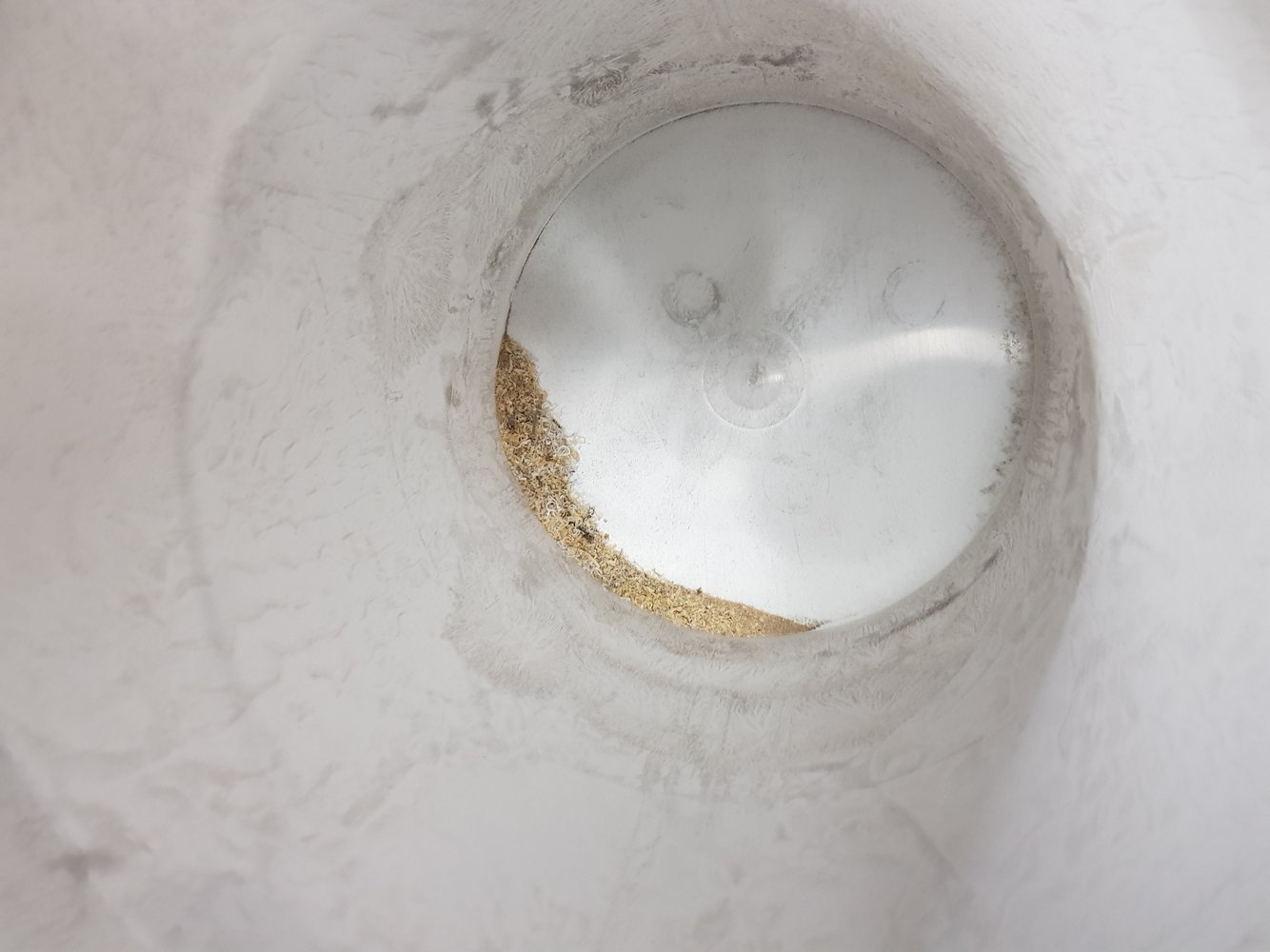

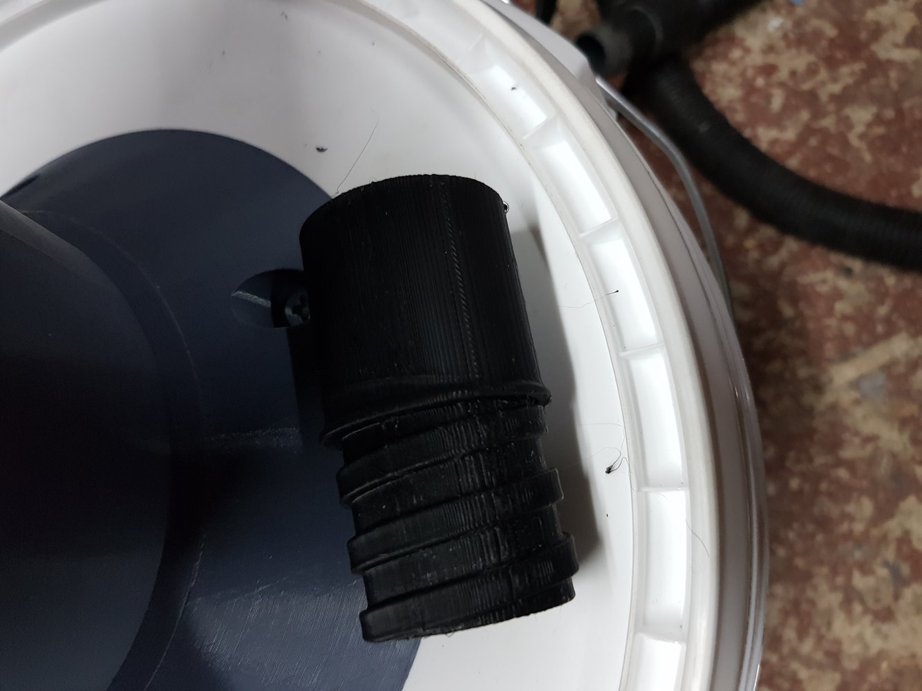

Make a secondary cyclone that has a strong clear plastic screw jar and put it between the cyclone suction and the vacuum you'll be amazed how much of the very fine stuff it picks up thus leaving the vacuums filter cleaner for much longer . If it starts to show a lot of fine muck in it it's time to empty the big bin and also clean the small jar .Decided after watching some annoying youtube videos on dust collection I needed a cyclone collector and with the power of the internet and a bit of help from my Ender 5 I managed to whip this contraption up and have to say im seriously impressed.
as theres a thread in each port its easy to make whatever connectors you need
First test on a bit of sawdust and some grinder dust and at least 90% of the dust ended up in the bucket !
Im now thinking I need another one dedicated to just the mills drills and lathe as will get oily but will capture all the swarf
Can provide links if anyone interested , bucket was £10 and used about the same in PLA+
You'll be better off using one of the heavy duty thick conical plastic dust bins or the old fashioned heavy galv steel ones if you can get hold of one.Surely you can use any size bucket even one of those 220l drums like below , that would take a while to fill ! I have a conventional 4" dust extractor for my table saw and planner that takes quite a while to fill a 100l bag but I wanted something for my chopsaw and for swarf from the metal working machines

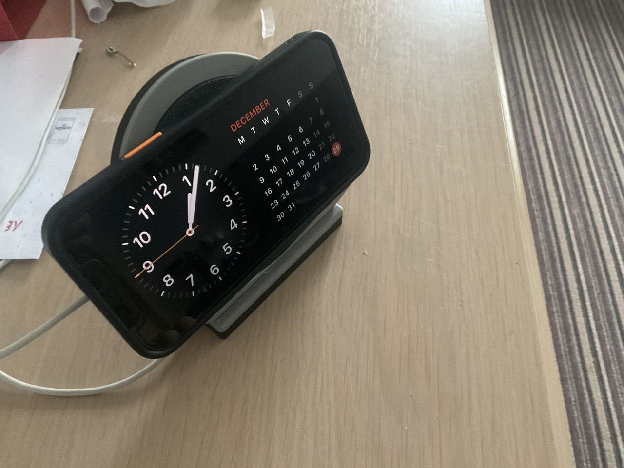

Would you share the STL please?Made one for myself too - using a £5 ikea charging pad. I didn’t intend to make it 2 tone but the filament ran out and luckily enough I had the ‘join’ option turned on so it just moved on to the next spool.

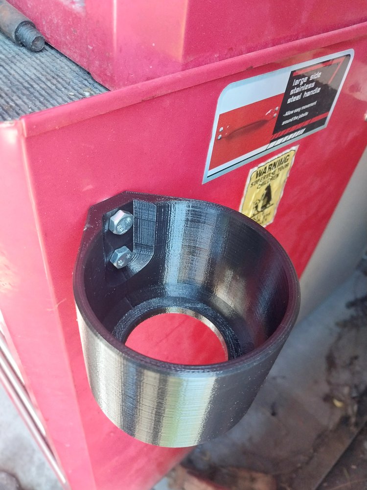

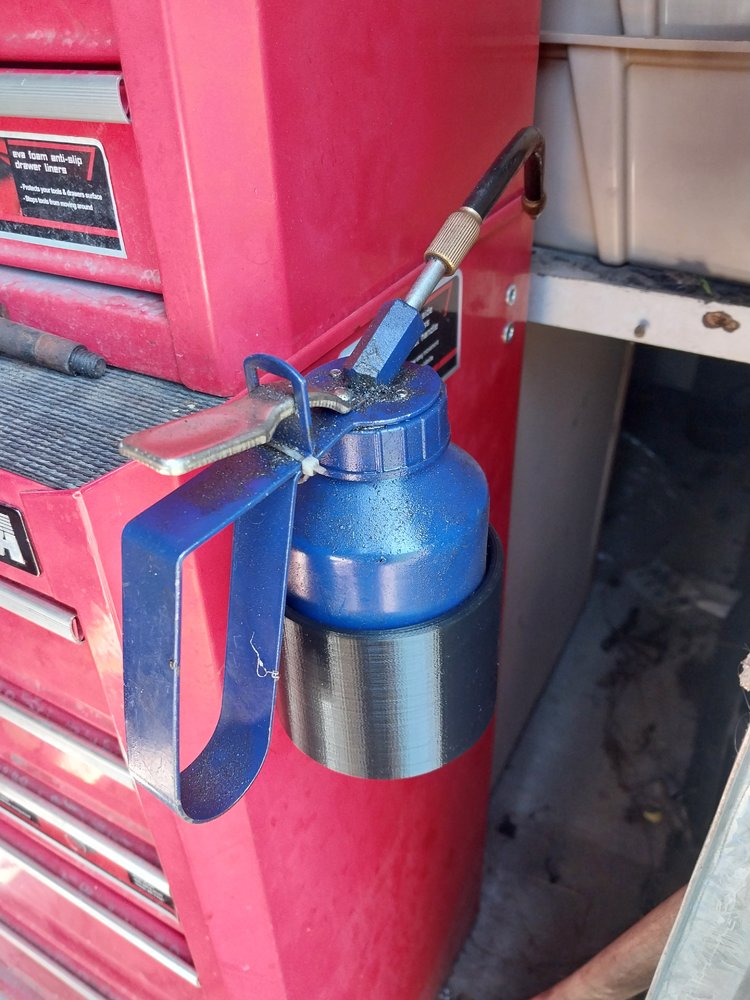

Oil can holder. Now it can't be knocked over as long as it actually gets put away.
