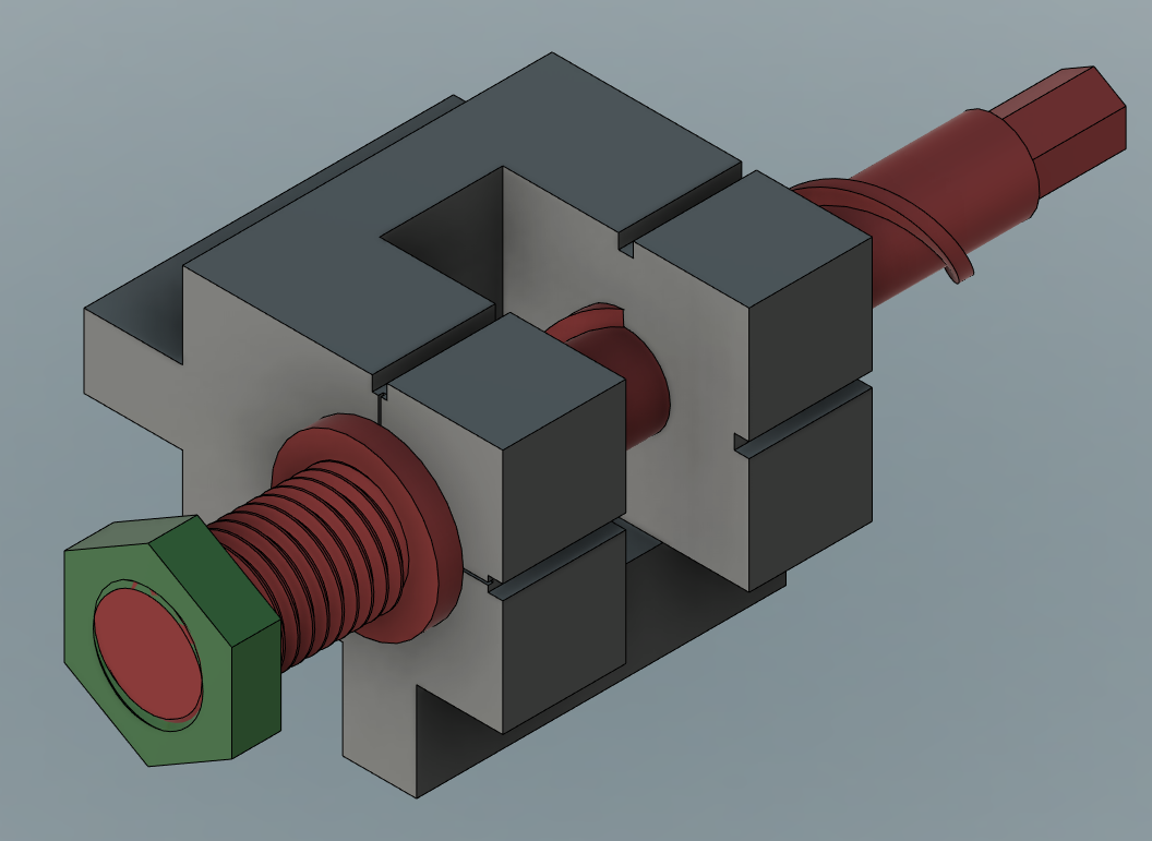

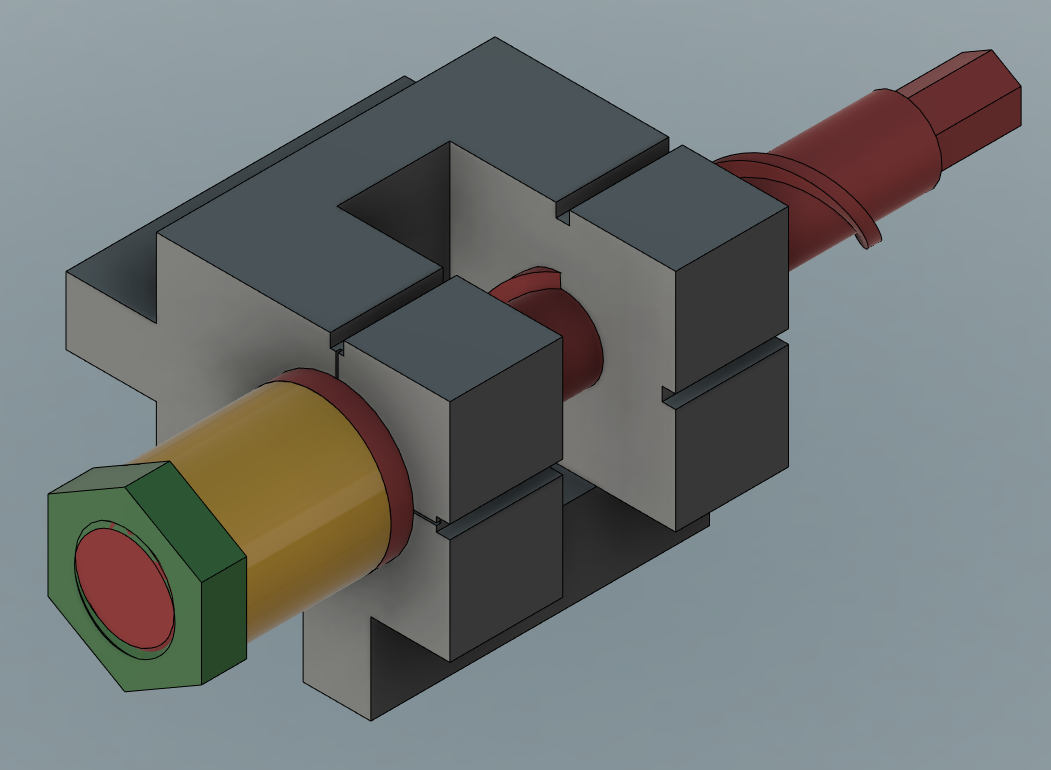

It might work but that's a LOT of unnecessary plastic!
and why is the spiral itself so thin? Might just as well be 1:1 like an incredibly coarse acme.
If you're doing it on a lathe anyway, I would use the cross slide and have a belt take-off drive from that to rotate the workpiece.
Cross slide advances the workpiece, the rotation of the cross slide handle rotates the workpiece via the belt/gear reduction. Calculate the correct gear ratio and you'll get the desired spiral.
