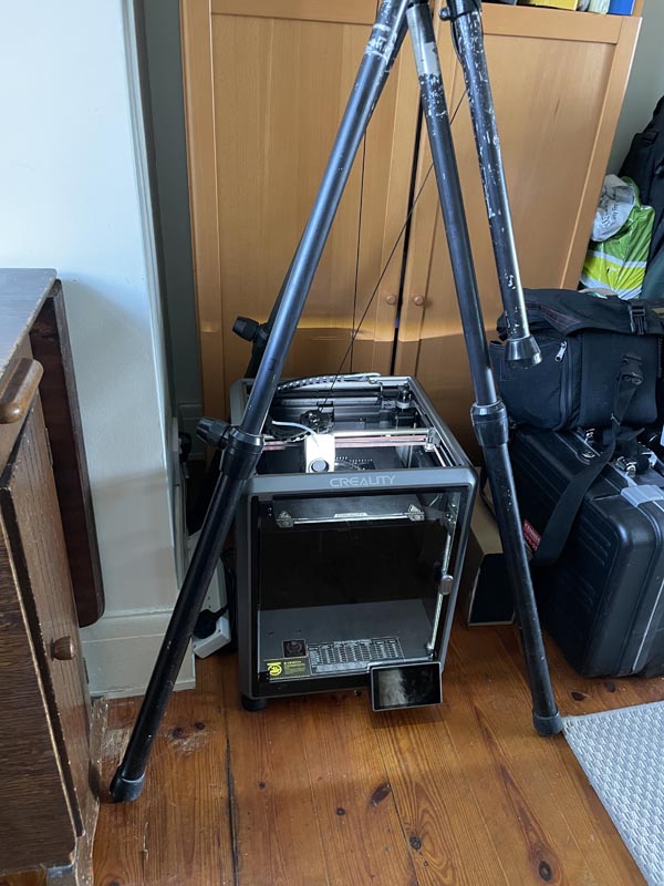

Thats exactly what worries me about the printer rabbit hole, I just know I wont have the dedication for itNot been known to learn to walk before I try to run, I have been making TPU scrap on my new K1.

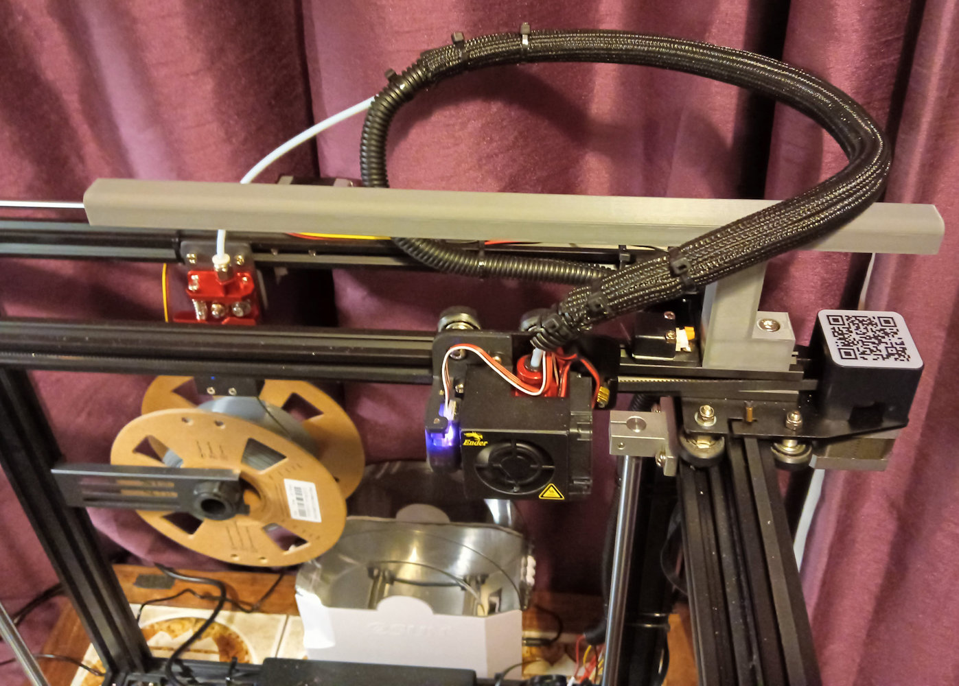

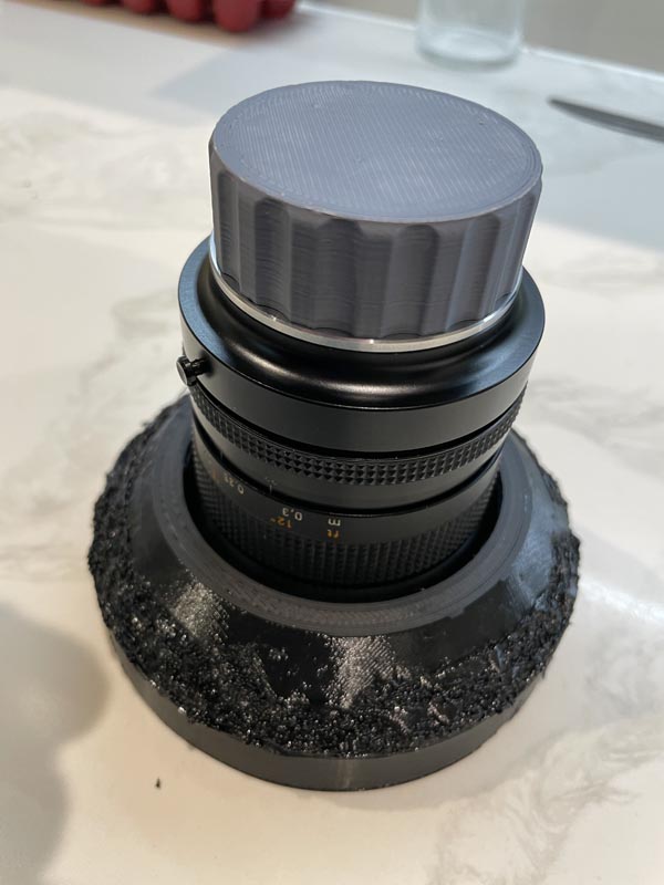

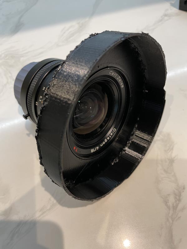

Trying to print a lens hood for my old Contax 18mm Distagon wide angle, I have had the predictable filament jams and failed prints, I have done the internet for fixes, what settings to use, cleaning out the extruder by taking it apart but it was not until I saw @ajlelectronics post that it dawned on me, its the filament getting stuck in the contorted path it has from factory. Step in the Benbo tripod filament path.
Basically having stuck a bit of filament in the filament run out sensor, off the roll up to the tripod and back down to the extruder, not what I had envisioned but for the few times I will be running TPU it is liveable with.
The results are not impressive where the supports were, it looks well pock marked but where there was no supports it looks good for a first attempt.
View attachment 428319View attachment 428320
I have taken a couple of shots indoors and no vignetting so that is good.
As this is the widest angle lens I want to make lens hoods for I am calling it good enough to move on to those less extreme like a 25mm and a 35mm. I may well revisit this one when I have a bit more experience, I wonder if you can sand TPU I think I will experiment on some of the scrap.
I will have a look for that, I have already made the skateboard bearing upgrade filament spool holder to replace the standard one which works well with the card spools but is a but too over running with the plastic spools.There is a spool support on Thingiverse which allows you to mount the spool overhead, with just a short path to the extruder. It would be perfect for that.

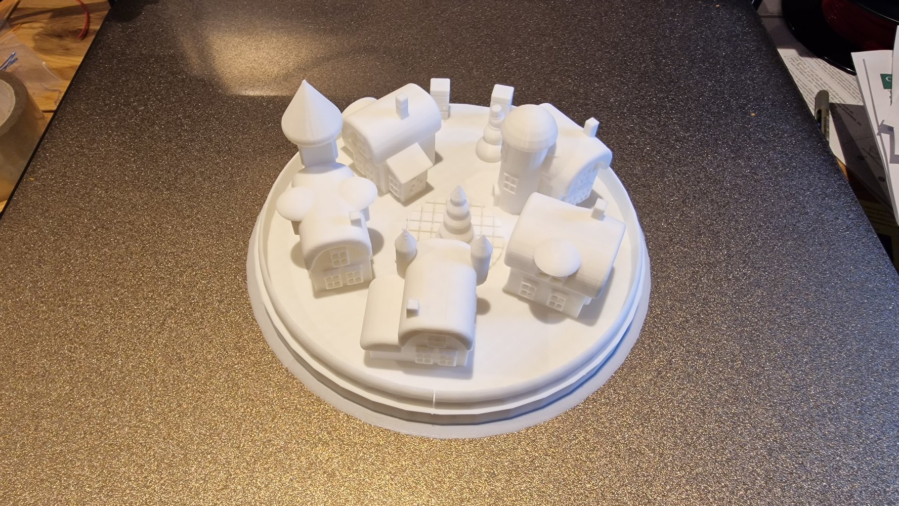

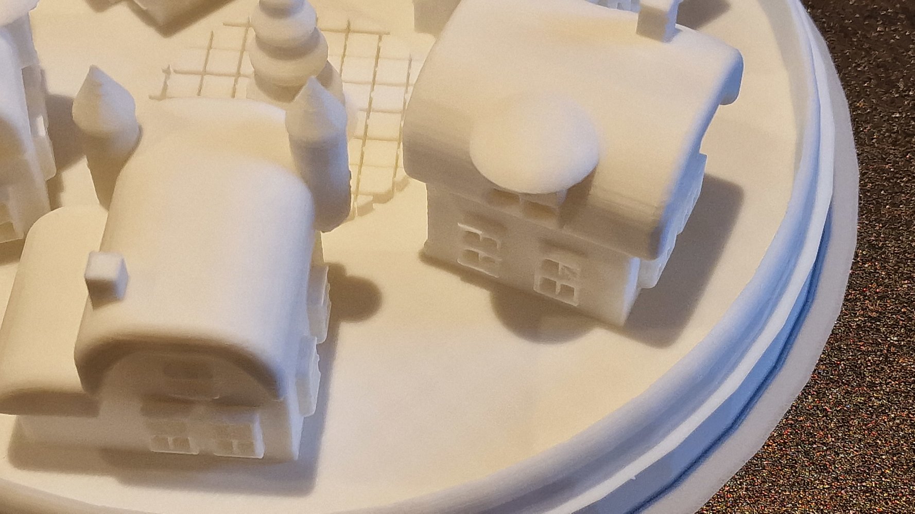

That looks excellent qualityMy new Elegoo 3d Max doing a great job as usual. Layer lines hardly noticeable.
Print is bigger than it looks. About a foot in diameter. Used 200g of filament at only 15% infill. Would make a great giant snow globe. View attachment 428555View attachment 428556

That´s the place where the elves from Santa Claus living. My doughter has Show me a Picture from a village in Comic style and has say to me, i want have such a village printed. So i have become my assignment. :-) I have draw it with 123D Design app on my Ipad. The Details are made in the way...www.thingiverse.com
Printed straight off no problems. I used Elegoo PLA - I think it's the best one I have used. No stringing at all.
Yes standard nozzle. 0.2 layer height. 15% infill. Took about 36 hours and used 200g of filament. I really am totally delighted with this printer. Our first one was a Tevo Tornado and we pretty much gave up on 3d printing it never worked right. This Elegoo Neptune 3d max hasn't failed yet its awesome.That looks excellent quality
Is that with a standard 0.4mm nozzle and how long a print time?
No other nozzles yet. I did post the link to it on thingiverse. There are some newer edits of it with battery compartments etc built in.Can you slice it with a 0.6/0.8mm nozzle to see the difference in print times or post the stl, cheers
