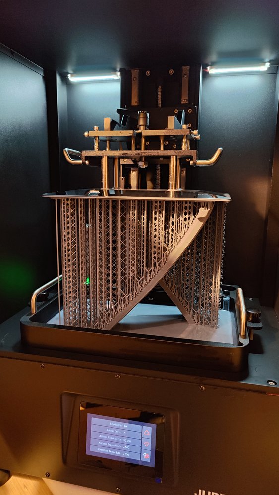

Thats an impressive looking thing, what is it?Biggest print yet on the Jupiter - 19hrs in, 6hrs to go...
and more from the same project, some 'knurled' M18 nuts and fittings...
It's part of a mould.... there's a high chance it won't work so didn't bother sharing too many details.Thats an impressive looking thing, what is it?

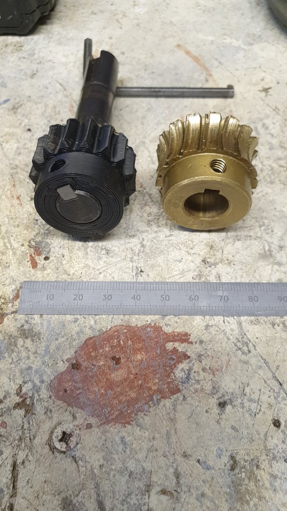

Nylon 66 blend is worth a try otherwise. I have a roll of Overture Easy Nylon that you could borrow to make that.Worm gear for my bandsaw next to the rather destroyed original
A quick fit shows it fits ok but I'll have to wait until I can put it back together to see if it's up to the job. Printed in abs 0.8mm nozzle.

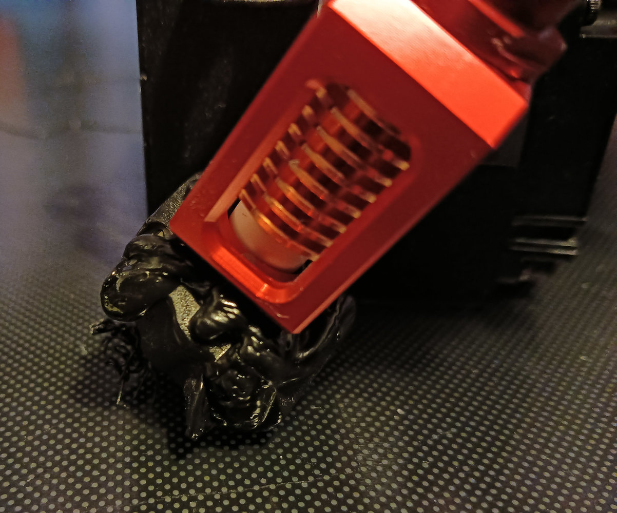

Loose nozzle?Nothing on the Ender 5 for a while. This is my new £60 all metal hot end
I have no idea. It was printing fine, put a new reel in and this happened.Loose nozzle?
It has annoyed me somewhat as I don't know why.
I have ordered a direct extruder, it sorted the problems on the E3 so hopefully it will help with the E5.Looks like a typical issue with the bowden tube adaptor.
Here is the fix: #16
TLDR: fit a short length of perfectly fitting bowden tube into the hot end before connecting it up...
