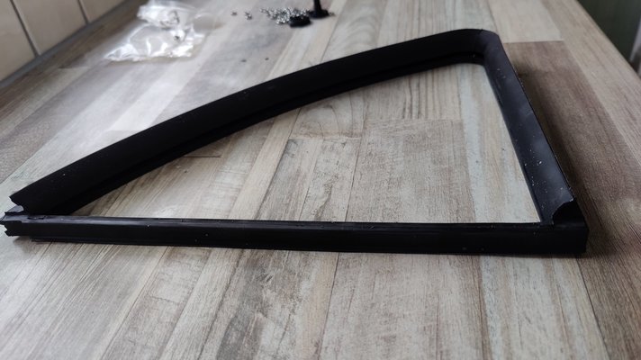

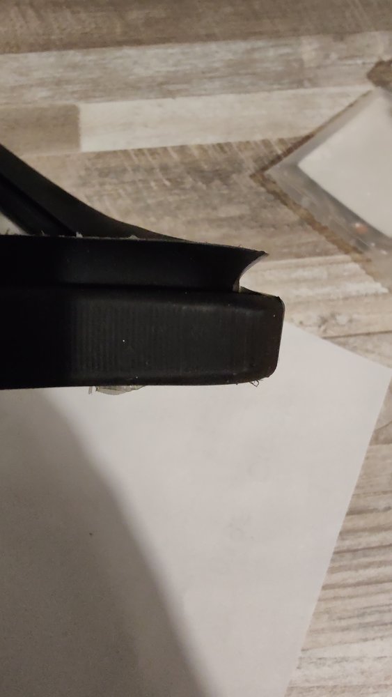

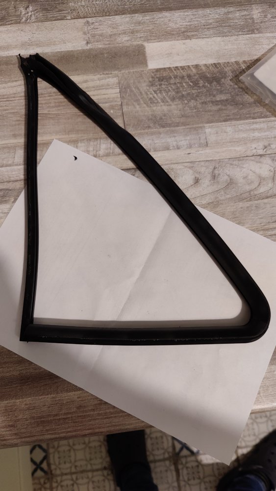

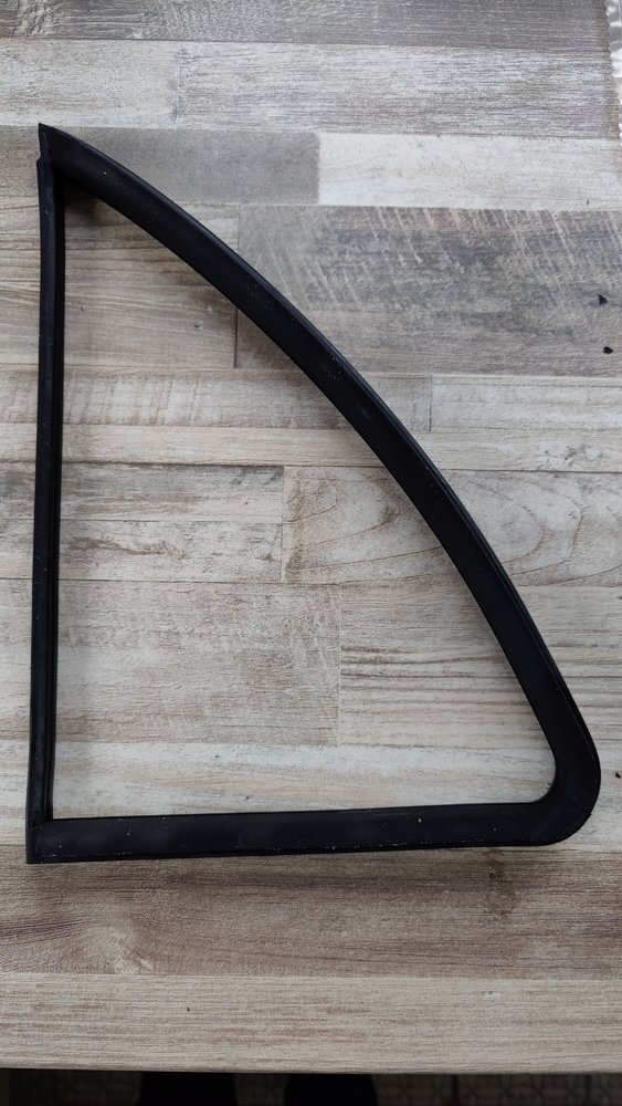

Printed with what?Well...not 100% success but the mould itself has worked out pretty well - the filling needs a lot of tweaking though.
It's the rear quarter light rubber for a 1956 Vauxhall...
Printed with what?
I believe that print a few posts back is a mould for that rubber item.
It's polyurethaneYes, but what rubber?
Perfection on the second attempt...Well...not 100% success but the mould itself has worked out pretty well - the filling needs a lot of tweaking though.

Can you not get them from Australia or are they too expensive?Well...not 100% success but the mould itself has worked out pretty well - the filling needs a lot of tweaking though.
View attachment 430615View attachment 430616
2 pack polyurethane rubber2-pack rubber?
Not currently available, someone was supposedly making them over here but not heard anything definite.Can you not get them from Australia or are they too expensive?

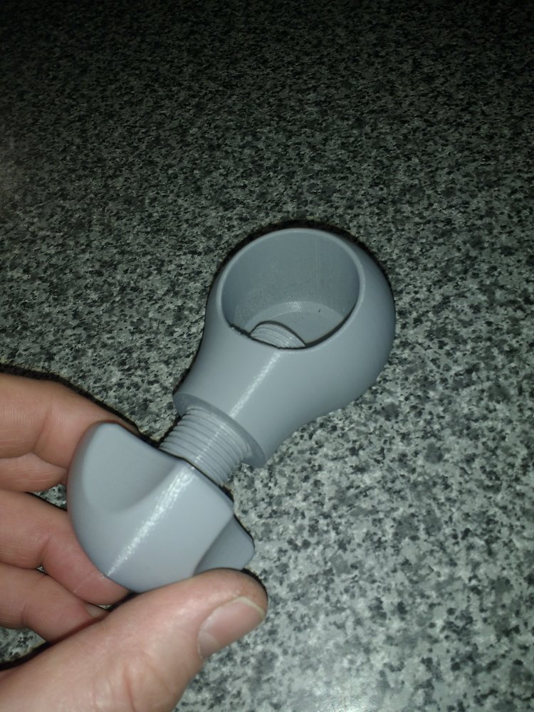

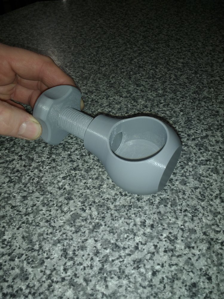

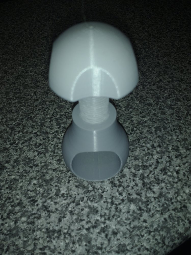

so.... what's it for?
Legs firmly crossed hereIt's a nut cracker. Used on walnuts so far.
