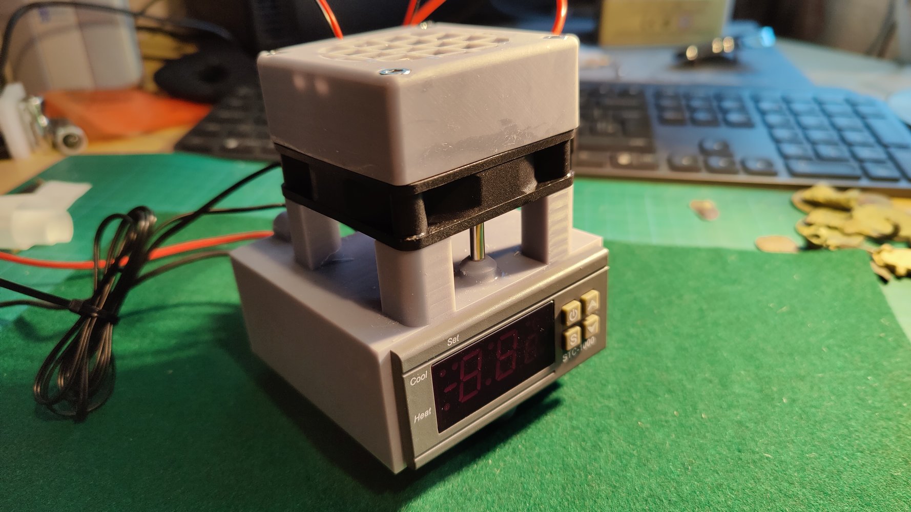

Soo just did some measurements with this...Ooh, that's nice, I've been looking to do similar to keep the chamber heated in my Bambu, I can't get it over 45-50c atm. Think I need more like 300w though.
Can't you stick the bambu in a container itself?Ooh, that's nice, I've been looking to do similar to keep the chamber heated in my Bambu, I can't get it over 45-50c atm. Think I need more like 300w though.
so if I get a bambu I cant put it in my cupboard?Nah I'd rather not, the electronics on the back won't like it much.

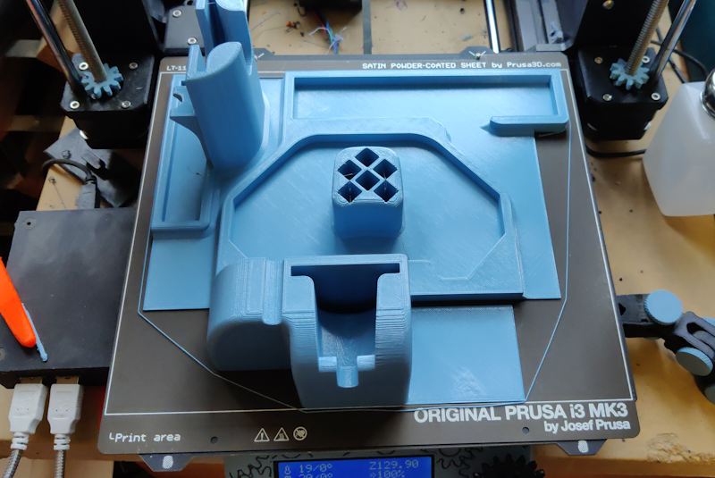

About 8 hoursYou certainly made full use of the bed there
What was the print time on that?
Good grief mine would have been 8 days. LolAbout 8 hours

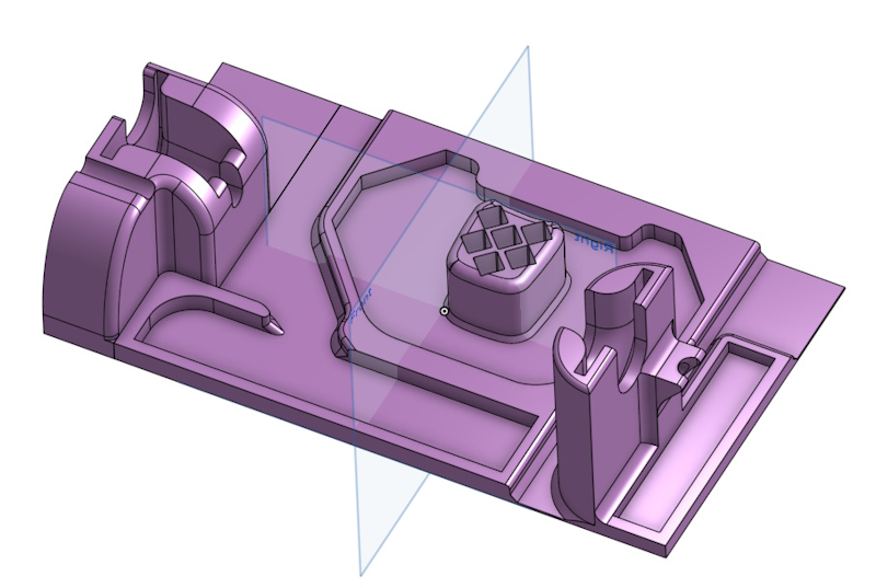

Measuring the shape of things like this is a bit of a pain in the proverbial posterior
It would have been 16 hours in my normal "0.2 mm QUALITY" setting, but I did this in "0.3 mm DRAFT" and it was a lot quicker. The draft setting has a much simpler (and quicker to print) infill as well as the thicker layer height, which helps a lot. When I do the final version, I'll probably go back to the quality setting. 16 hours isn't that bad really: I can set it running in the evening and it'll be done by the time I'm home from work the next day.Good grief mine would have been 8 days. Lol
