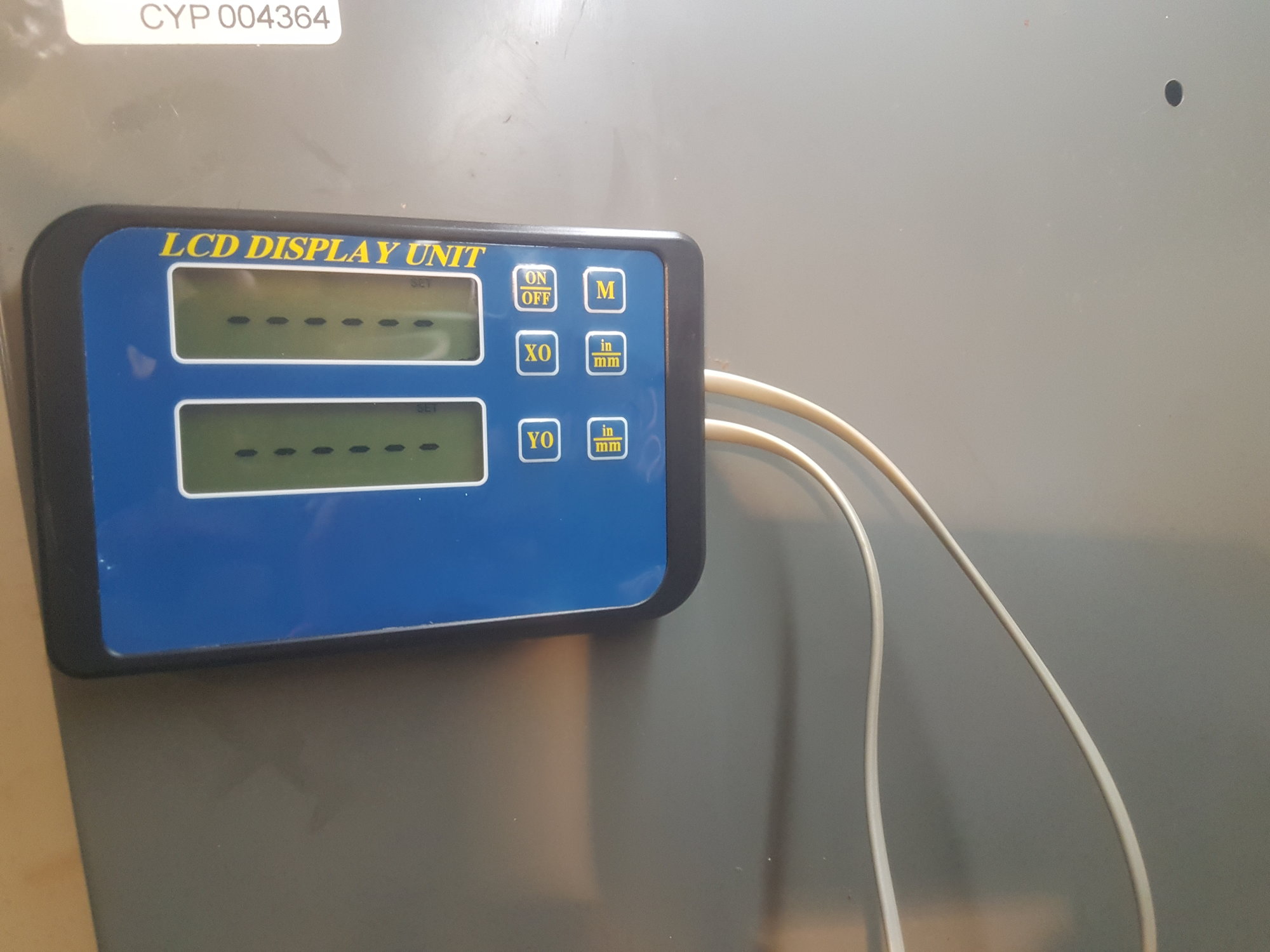

I just looked the USB is a balanced data bus so data+ and data-Well I am baffled now I have a + and - on the display. And 2 others I presume data and clock. On the calipers side I have a - and 3+

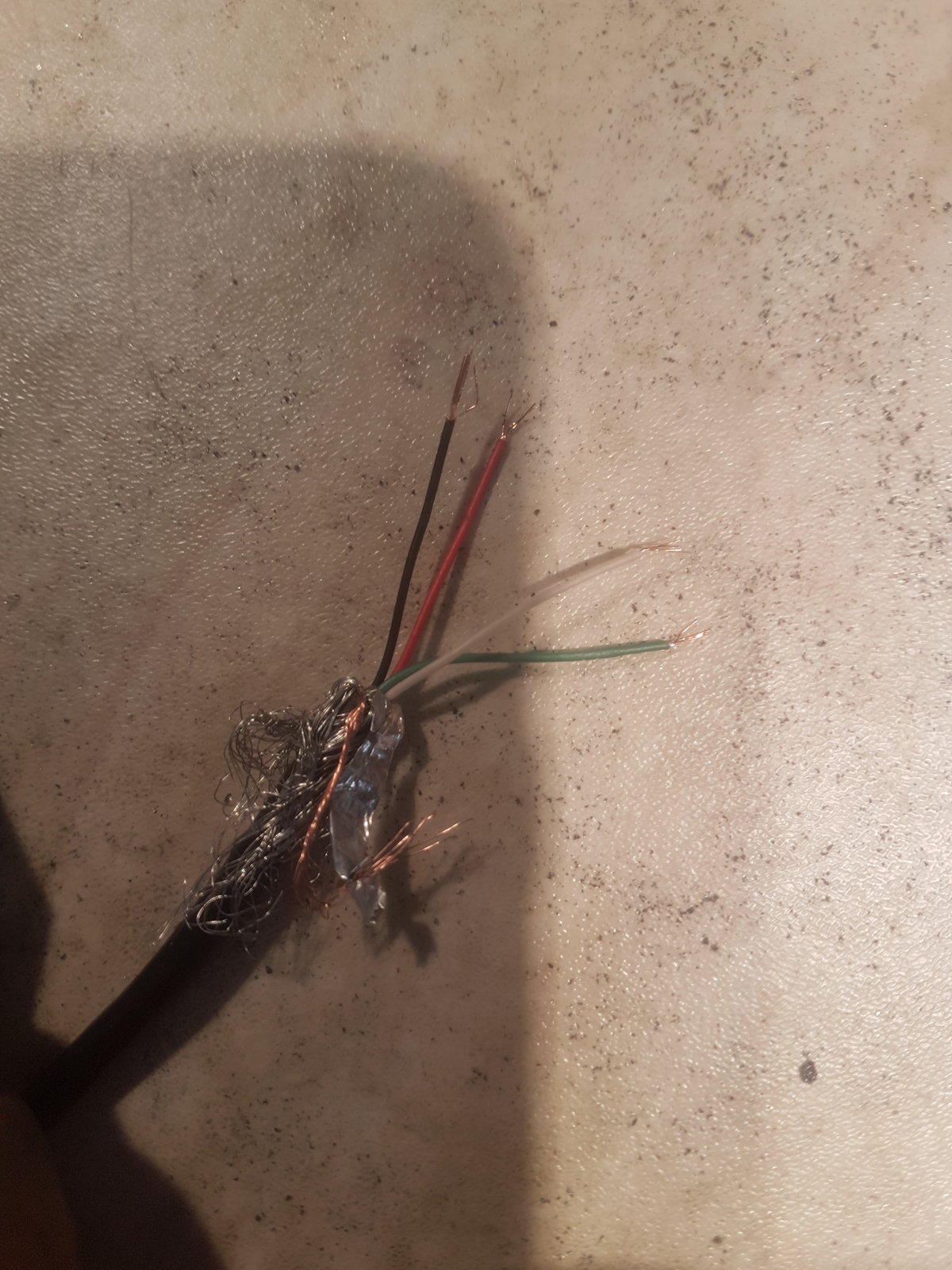

Assuming the callipers have a five pin connector 1is +ve 2 is Data- 3 is Data+ 4 is via resistor to Gnd 5 is Gnd.
I would be taking the battery out of the caliper connecting + on display out to your +3 on your calliper (1 on the USB) and - on the display to pin 5 on the calliper. Try the calliper will it power up from the display? If it does connect the other two from the display to the calliper pins 2 and 3 does it work ? if not reverse pins 2 and 3.

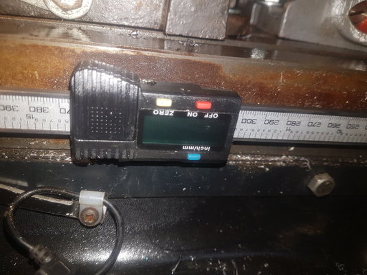

It may well not be USB at all. I hadn't realised that the calipers (as in digital calipers?) would have their own batteries rather than being powered by the DRO.
If that's the case then I wouldn't think you want to be sending that power to the DRO, just ground and one (possibly two) signals. Do you have a pic of the calipers?
Just found this from your earlier post:
So it looks like it's a home made affair? If so then you'll probably need to open it up and find out where the cables go.
What make / model is the DRO?
