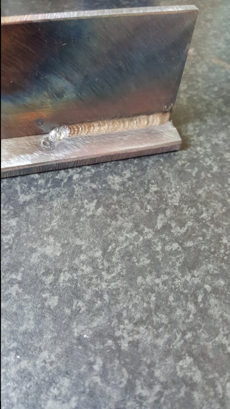

Thanks mate...Spencer those are lovely beads on the mild and the Al ones are frankly, gobsmacking. Excellent work buddy!
