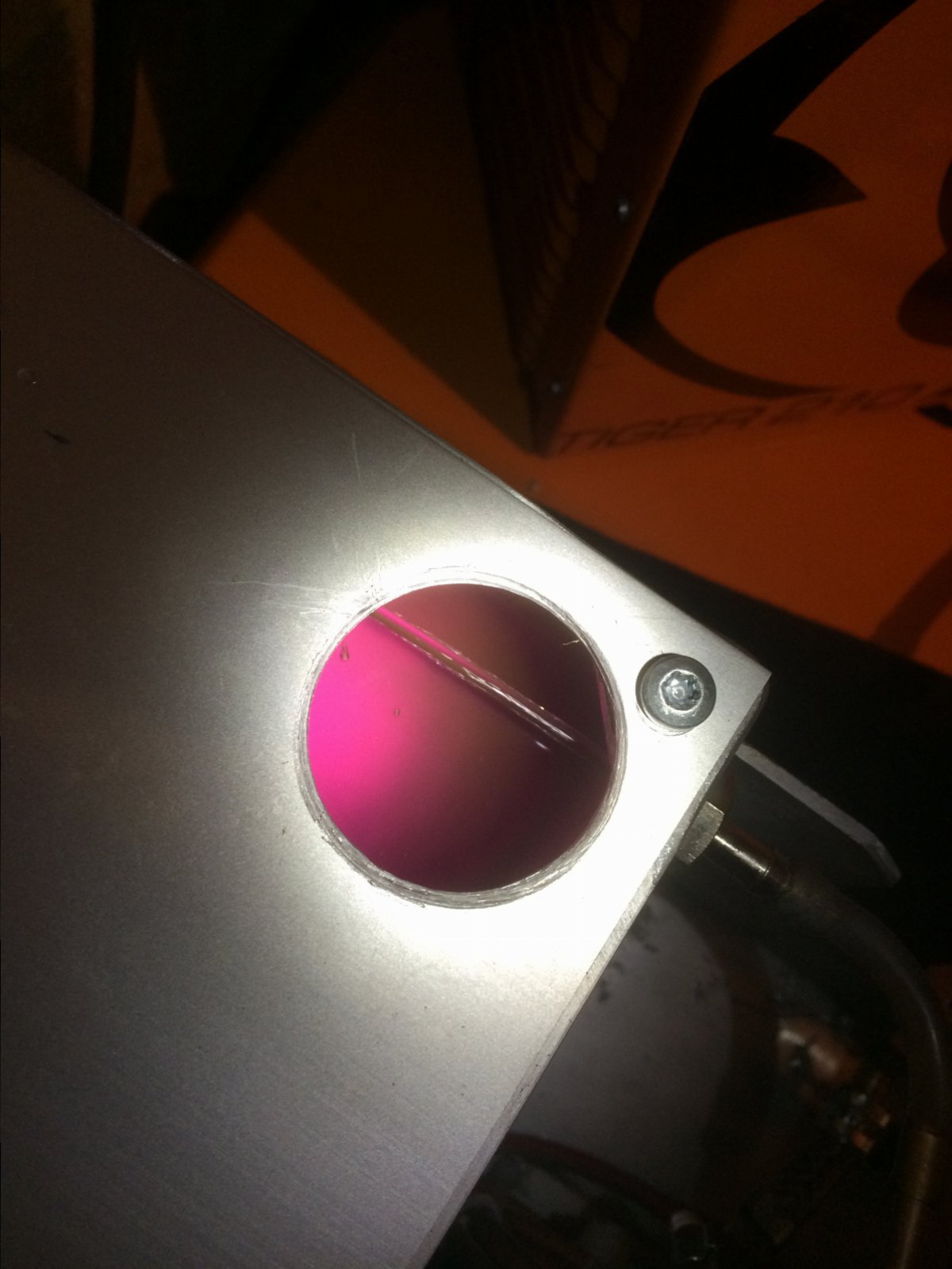

You only want a trickle coming back to the tank or it might burst lines. 40-60psi is sufficient with 1-2 lpm going back in the tank.
Here's the return on mine. It's quite feeble by the time it's worked its way up and back approx 10 Mtrs of line.
