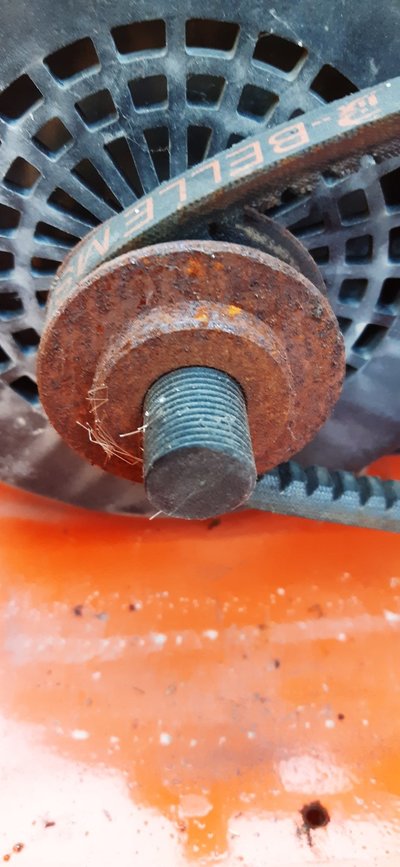

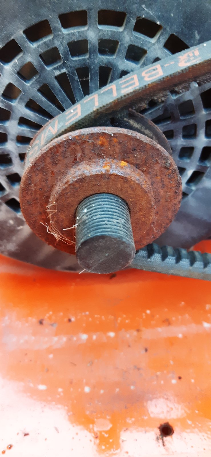

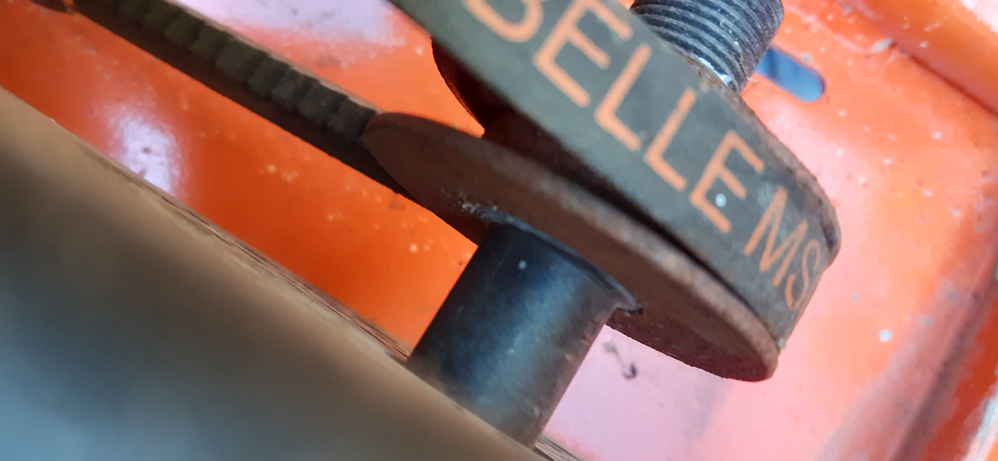

A neighbour lent me his Belle mixer to use and keep as long as I needed it, which I am grateful for. He said it might need a new belt. However, when I took the guard off I couldn't believe what I saw, the motor had a "Plastic Shaft " which had stripped itself out of the steel pully; an engineering design fail for sure.
The damage was too severe to remove the pully, but I did manage to repair it by using 3000 lb epoxy and then drilling through the pully & shaft and inserting a roll pin; how long it will last is questionable, but so far I've put about a couple dozen loads through the mixer without issue.
Thought I would let you know about this poor design feature, which might also be of interest to anyone who owns a Belle mixer, or those considering buying one.

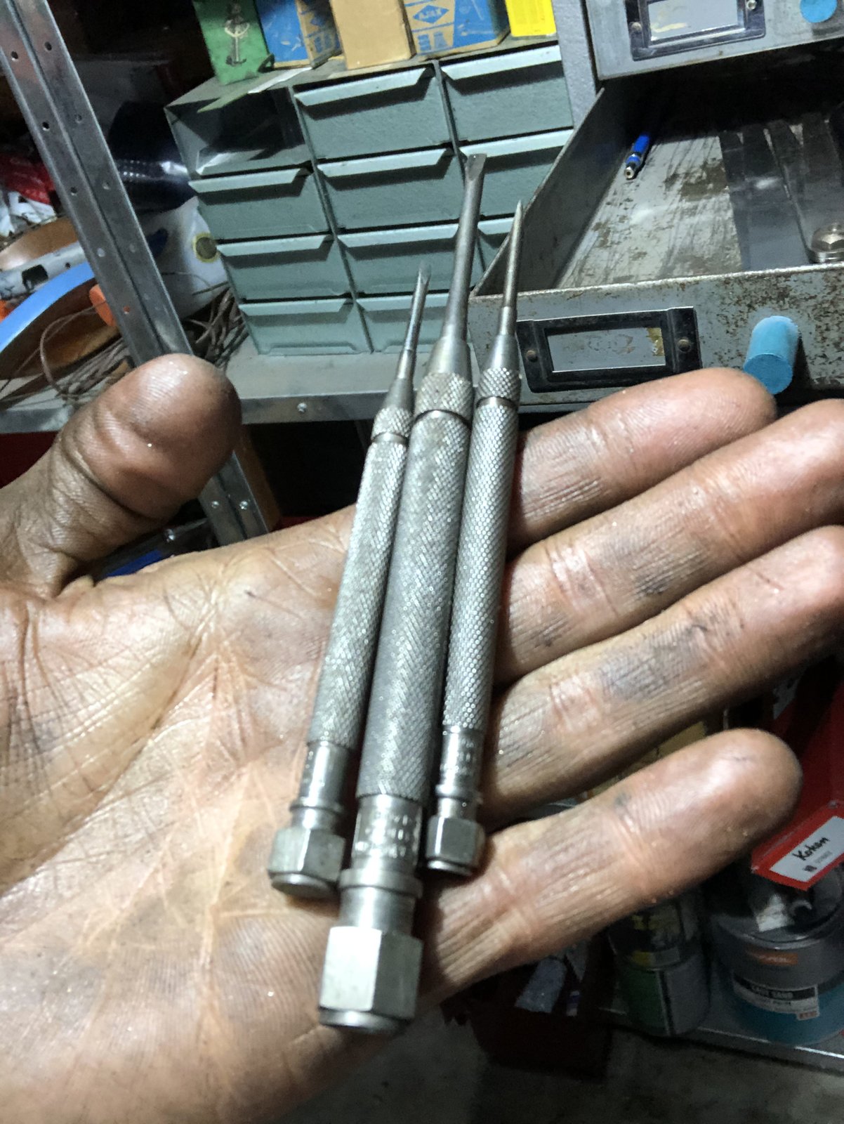

It’s not just measuring equipment though... these lovely screwdrivers are M&W so they make it into the box!
