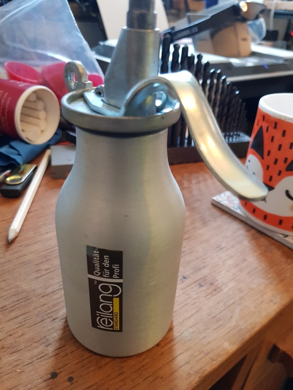

A new oil can, I wanted one that didn't leak, a tall order I know. I have about 20, they all leak. This one can pump upside down, or at least on the tilt I believe, I'll let you know, Its Swiss, a Reilang.

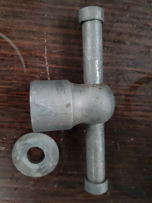

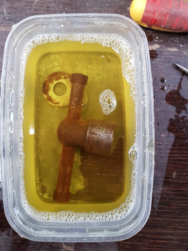

Evaporust - I thought I would give it a go considering it is supposed to be virtually PH neutral. Something to do with chelates strong enough to grab hold of iron oxide but not iron itself.
So in with a rusty handle. Its supposed to last a long time, you just pour it back into the bottle until the next time you need it.
It was like this just over an hour later, probably earlier but I was on a work call. There were no visible bubbles so obviously working differently than acids.

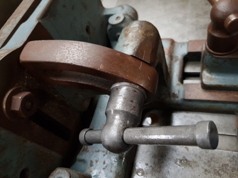

And back on the machine after a wash and some WD40. The spots of rust is where PVA glue was on the handle, it is a wood working machine.
Conclusion, it works. Non toxic and not acidic. Probably not as cheap as citric acid but less messing about than hydrolysis. I guess time will tell how much it costs depending on how long it lasts. It's about 35 quid a gallon.
I only used the handle as an example, these will get buffed up anyway. The intention is for small parts and tools, and a small vice I have, and being non-toxic I can get the kids involved. I will tell them not to drink it mind

That's the one I use, cheaper on Amazon and free delivery. https://www.amazon.co.uk/gp/product/B07JKTCZBR/ref=ppx_yo_dt_b_search_asin_title?ie=UTF8&psc=1Interesting post Andy, is this the stuff?
I've seen it before and assumed it was from the school of modern weedkiller, paint stripper etc i.e junk.

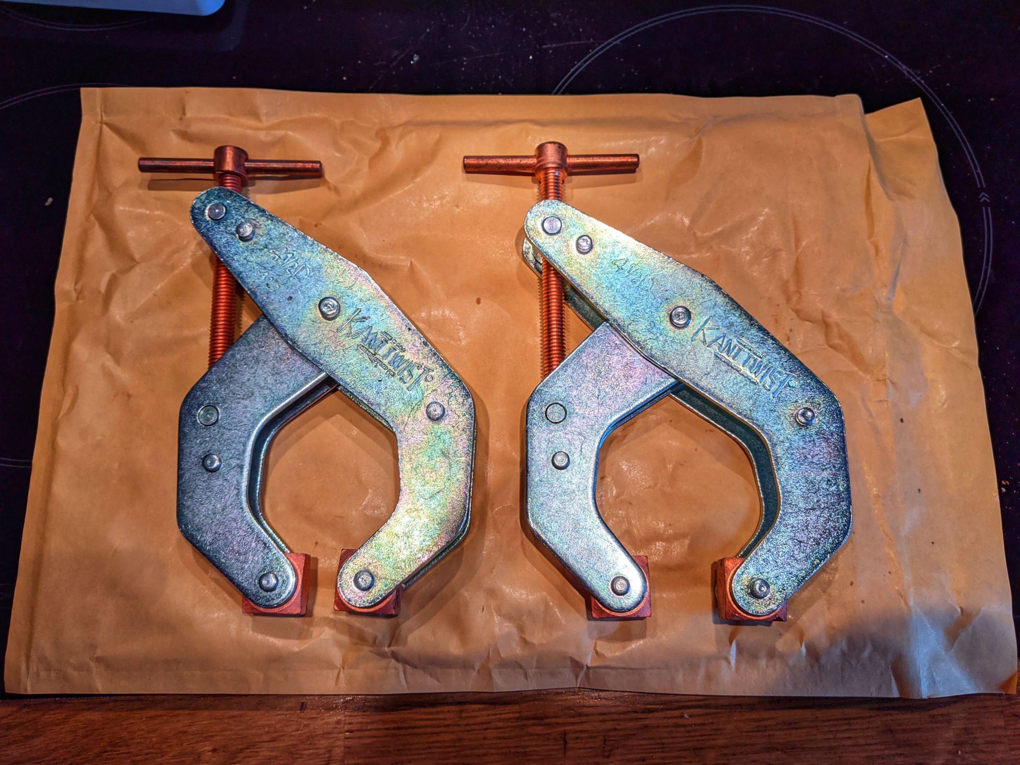

A couple of Kant Twist clamps from MSC Direct, thanks to @Dcal for pointing out that they're currently on offer - have you bought any yet @arther dailey ..?

un decided wether to get the small or 2 1/2" pair , would like more but would end up spending too much ..which did you go for ?
