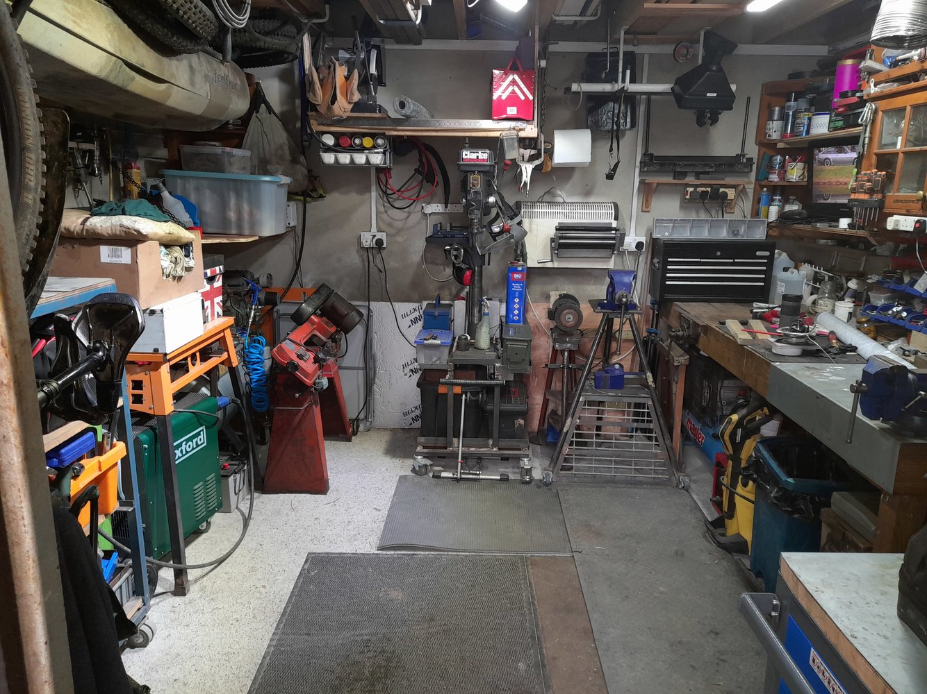

Been the same in my garage for quite a while. One learns to exhale when squeezing one's way around.how do you ever work in there theres not even steping stone places let alone a walk way
That's just a corner and I'd dragged a small 100L compressor out that was in front of it.how do you ever work in there theres not even steping stone places let alone a walk way

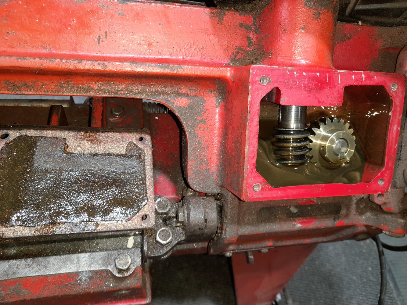

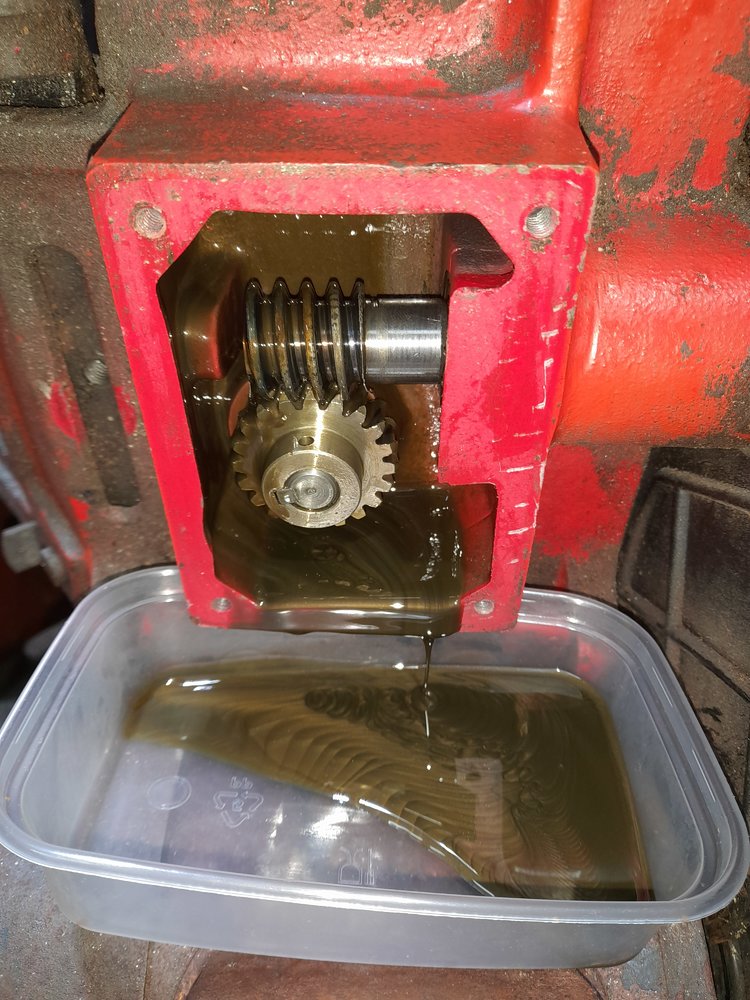

Worth putting a gob of grease in the gearbox they tend to wear quickly........ this unloved but working Sealey SM5 Bandsaw of 1984 vintage.
Needs a clean at the very least and I dare say benefit from a new blade, but it'll do everything to a level that I'll need & I'll get to practice a bit more making a vice-mount vertical saw plate for it
Thanks for the advice. It needs a good clean and get all the metal filings and grime off it and off the bearings etc - so I'll give it a good look over.Worth putting a gob of grease in the gearbox they tend to wear quickly.
Thanks very much for thatUpgrades I would recommend-
Make a new base from decent angle or box section & fit good wheels to it. The supplied folded tin one is a joke!
Replace all 6 guide bearings with rubber sealed variants. They are better at keeping the swarf out & you can strip & regrease them when needed!
Fit a motorbike adjustable steering damper to slow the drop speed. It will increase the accuracy & extend the blade life.
Fit a M42 blade from tuff saws - a 10-14 varitooth is a good all round pitch.
Some gearboxes have grease & some have oil so have the saw tipped back with the lid level before opening it!
Plenty of info out there on setting up the saw, including some utube vids but this is the version I follow.
https://wiki.hsbne.org/_media/tools/4x6bandsawadjust.pdf
Follow every step through, including checking the wheels are parallel & you should end up with a surprisingly accurate machine.
Search on the forum for 6x4 bandsaw & there are a few posts on them.

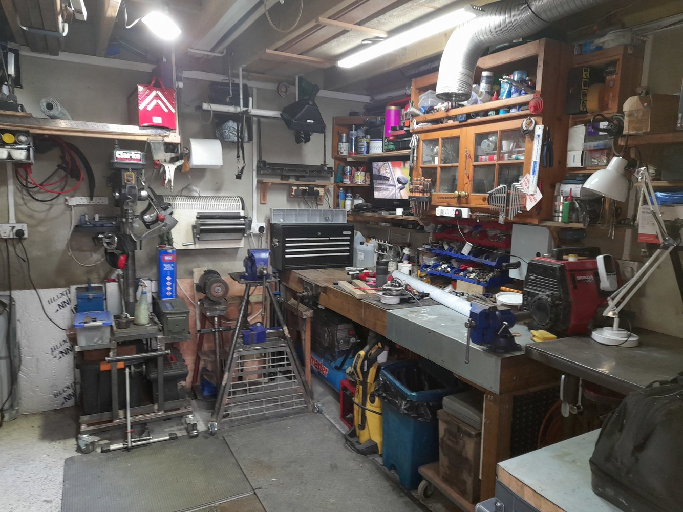

Not quite as cluttered as my first pic suggested.... but you can see why I need stuff on wheels (including the 6x4 Saw).Been the same in my garage for quite a while. One learns to exhale when squeezing one's way around.
You must be very organised and/or much better at being totally disciplined regarding having nothing but essentials in your space!The centre, empty area of your workshop is probably wider than my workshop wall to wall.

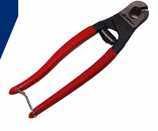

They look like wire rope shears, 40 Irish dollars doesn't sound a bad price.Got a bit carried away with tool fever when in the farm store this afternoon.
A fairly ordinary fencing tool... not too expensive, about €17
They seem quite well made and have a good heft to them. Time will tell whether the steel is decent or just recycled tin cans.
Then, just to round it off I thought a nice little set of wire cutters would go nicely.... €40. I nearly didn't.
These feel lovely in the hand. For that price, they bloody well should.
