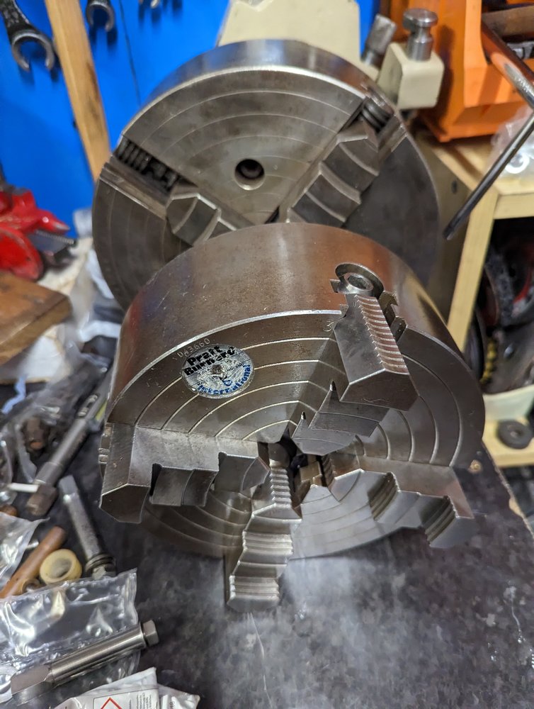

Had to press on with the bad blade as I'm cleaning things up in the lathe's four jaw chuck for a precise fit as well as using the router bench to put radius on the edges on all four long edges .
