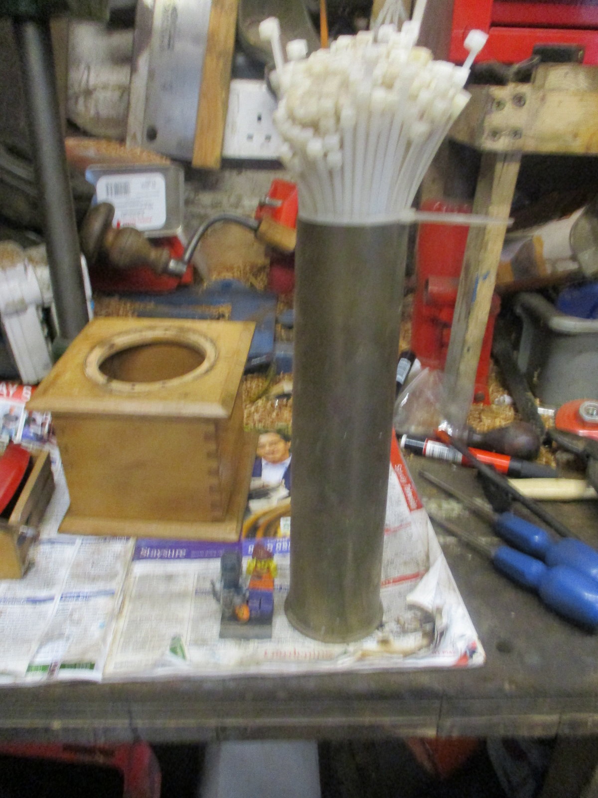

I'm ruthlessly stealing your idea for a cable tie tidy.Well it’s now 3.5 inches shorter, degreased, cleaned and assembled fitting onto the bench nicely

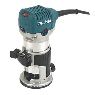

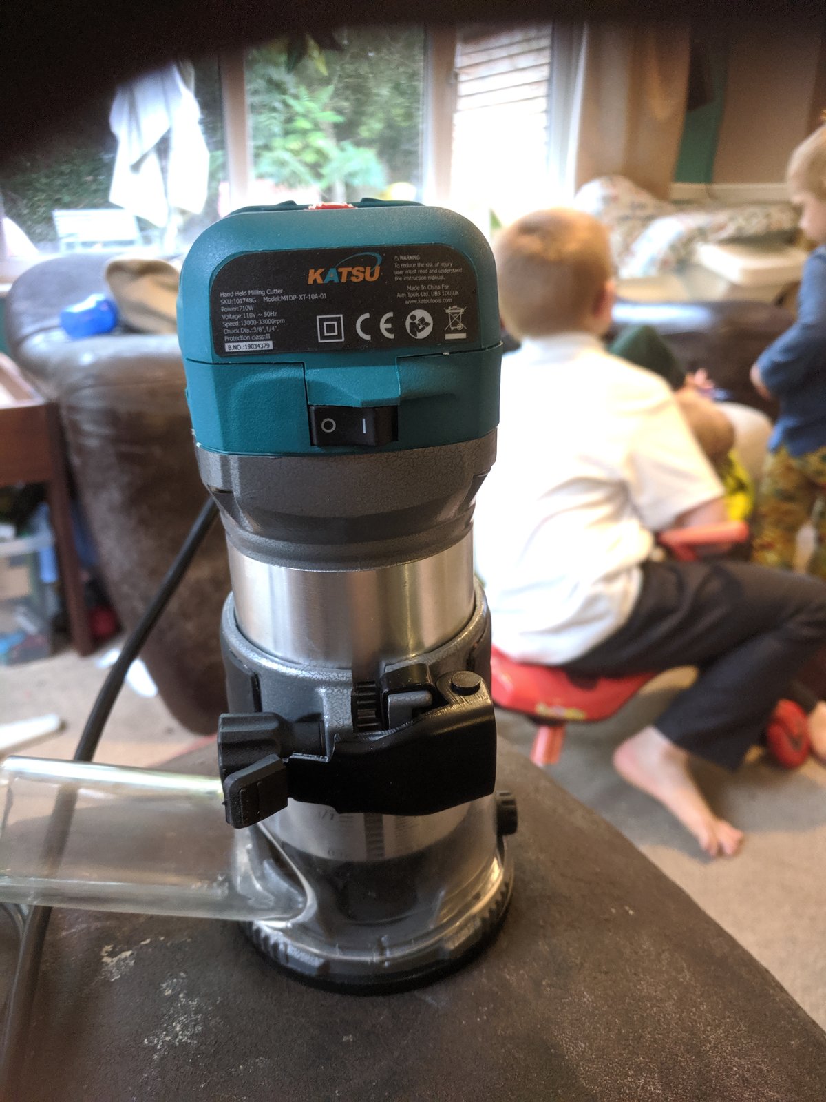

Watching with interest I have one sitting in the workshop, unboxed it the day before my accident in January, haven't power up and had a play either.Thought I'd give a Katsu bottle trimmer a go as my old Hitachi is on its last legs.
Seems well made . Il power it up tomorrow. No transformer within easy reach
Il give it a decent test in pine and oak tomorrow. Feels solid enough.Watching with interest I have one sitting in the workshop, unboxed it the day before my accident in January, haven't power up and had a play either.

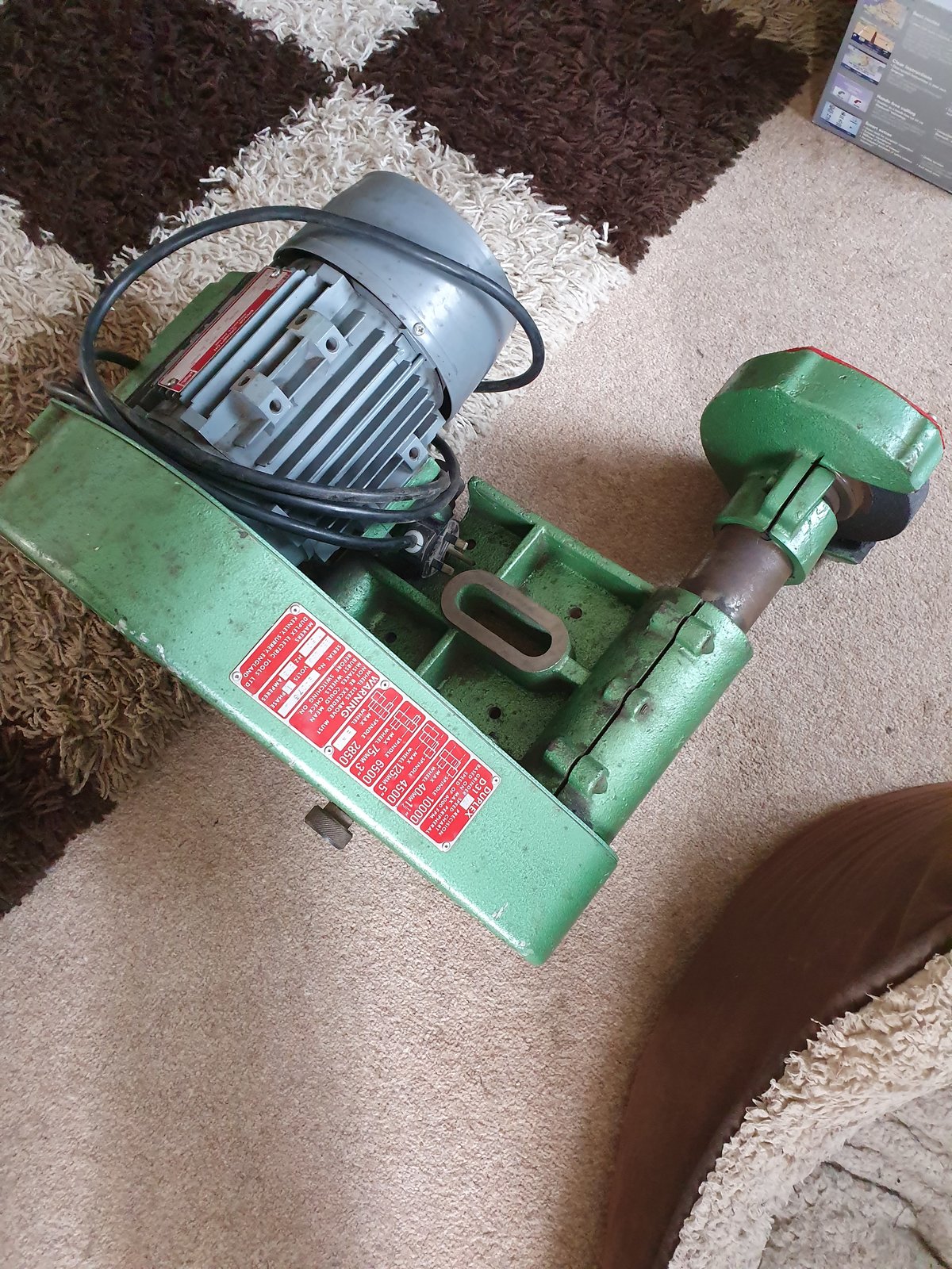

If is Morse taper 2 I've repaired one few months ago
But this was three phase , is your single phase?
If he spindle has a tapered bore for the chuck (or big drill bit) to fit into, it's a morse taper. If not it'll most likely have a male "Jacobs" taper on the spindle that presses into the back of a chuck. If you extend the quill as far as it goes, a morse taper spindle should have an elongated slot in the side of it a few inches from the end to allow a drift to fit through and knock the chuck/big drill out.Yes, single phase. The first part of your post, you've mistaken me for someone much more intelligent as I have no idea what Morse Taper 2 is but please enlighten me.

Morse taper is the name of the conical taper systemYes, single phase. The first part of your post, you've mistaken me for someone much more intelligent as I have no idea what Morse Taper 2 is but please enlighten me.
