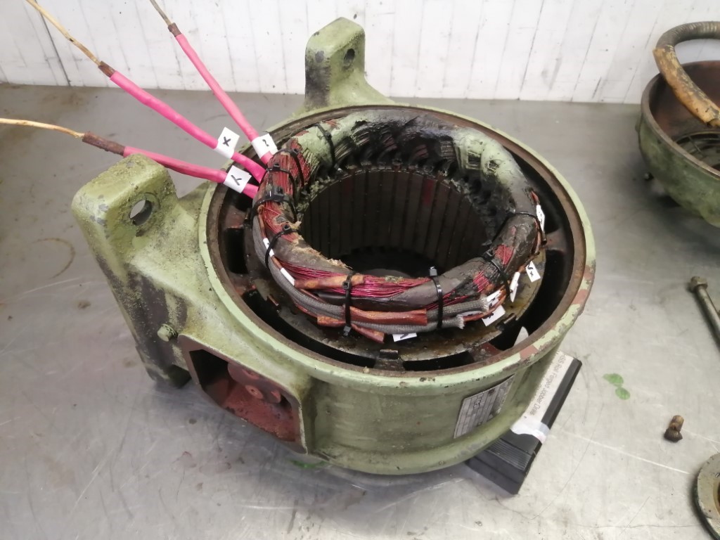

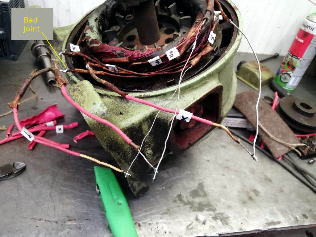

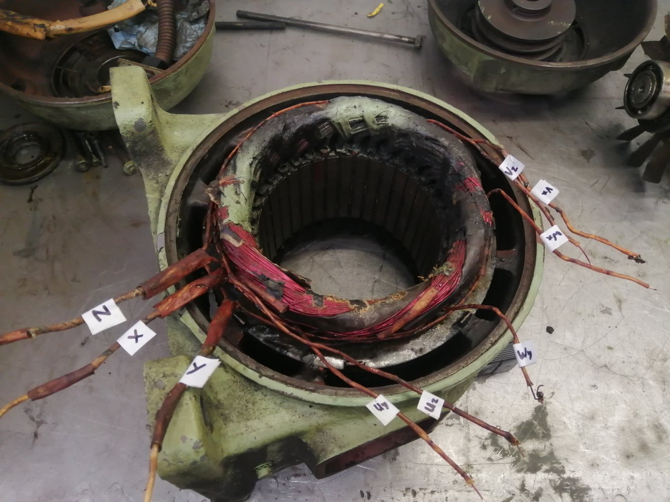

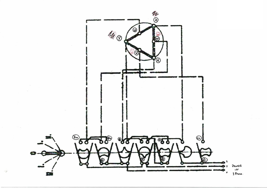

Wow!! i envy your knowledge mateI got the multimeter out today and did some checks to make sure I had all of the wires and windings labelled correctly and it was a good job I did because I found that two of the windings were reversed compared to what the schematic said they should be, inside the motor terminal box. Perhaps it was someone's clumsy fiddling that caused one of the tails to short and go open circuit, or perhaps it was just 'done that way' and the tech adjusted the wiring to compensate, or maybe someone just didn't like which way they had to turn the fwd/reverse lever. Whatever, my job was to find out what was wrong.

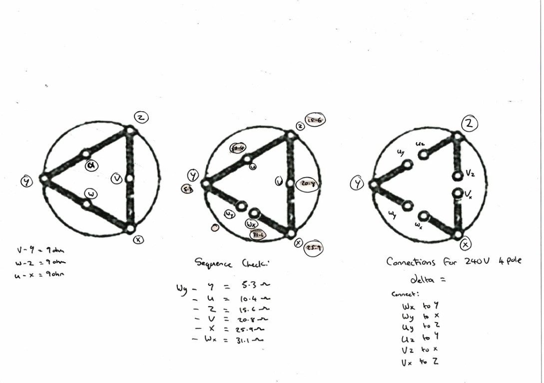

So I checked the switch connection sketch I made, transferred the labels from the switch and from the terminal block onto the schematic and I already had the windings labelled from when I stripped the motor. This all gave me the info I needed to cut and join the connections how I wanted. However, when I did my checks, I found that U-X had a resistance of 9ohms whereas Z-V and Y-W had 6 ohms each. Clearly something was labelled wrong so I double-checked the schematic and that was all ok up to the motor terminals, they must have two of the connections reversed internally. I knew it had to be the two 6 ohm ones that were backwards because you can't have ONE thing wrong, two must be swapped.
At first I thought it was Y and Z that were backwards but then I realised it couldn't be those two because they X, Y and Z are brought together in a star point for high speed so if they were swapped over the motor would turn one way in FWD low and the other way in FWD high. It must be V and W. I re-labelled these and the my readings then all made sense at 9 ohms each.
So first I checked (as above) that the U,V,W points were properly opposite the X,Y,Z points - check
Then I had to double-check that they were opposite, and also in the same sequence as the schematic, important to get straight in my head before I started cutting wires. To do this I split the connection at W and then took sequential readings all around the loop. They all tallied up at about 5.2ohms per winding. I also checked visually which direction the wires were running and found that all of them were going in the same 'sense' for all three phases.
After that I labelled the split at W as Wx and Wy, check with a multimeter, split V and labelled them as Vx and Vz, then split U and lebelled them as Uy and Uz.
To complete the job I have to take each of these six split points and reconnect them to the corner that they are pointing towards. So Wy will connect to X and Wx will connect to Y which will put those two windings in parallel, and then do the other four the same so that I can use the motor with a 240V VFD.

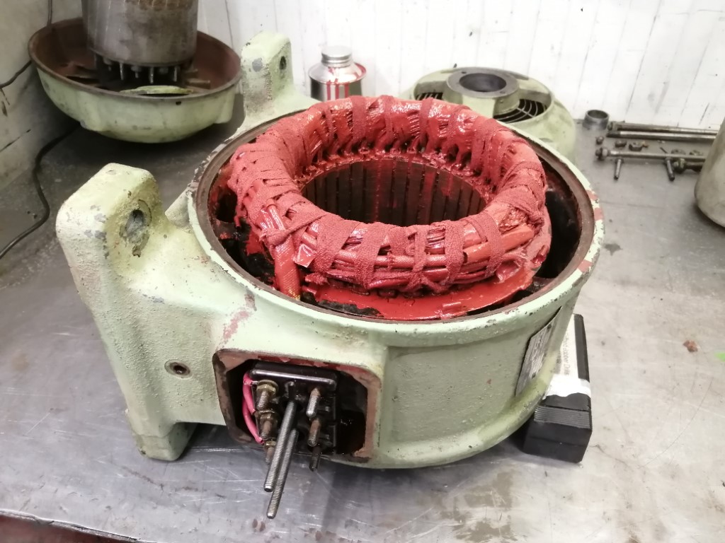

Here is it right now all labelled up ready to go.
Now, I do realise that this might all be in vain. I might have damaged the enamel on the windings and cause a short, but it looks pretty good right now (I've done a bit of motor rewinding in my teens) or the VFD might cause the aged windings to break down, or any number of things might go wrong but the way I see it if the motor was going for scrap anyway I don't see that there's much to lose except a few quid and half a day's time that I would have spent making mounting adapters anyway. I've got some fresh air-drying enamel coming and I'm going to order more binding so I will carefully coat all the bits I've worked on then cook it gently to dry the coating, bind it up then coat it again to give it the best chance. If it goes pop, I'll buy a new motor.

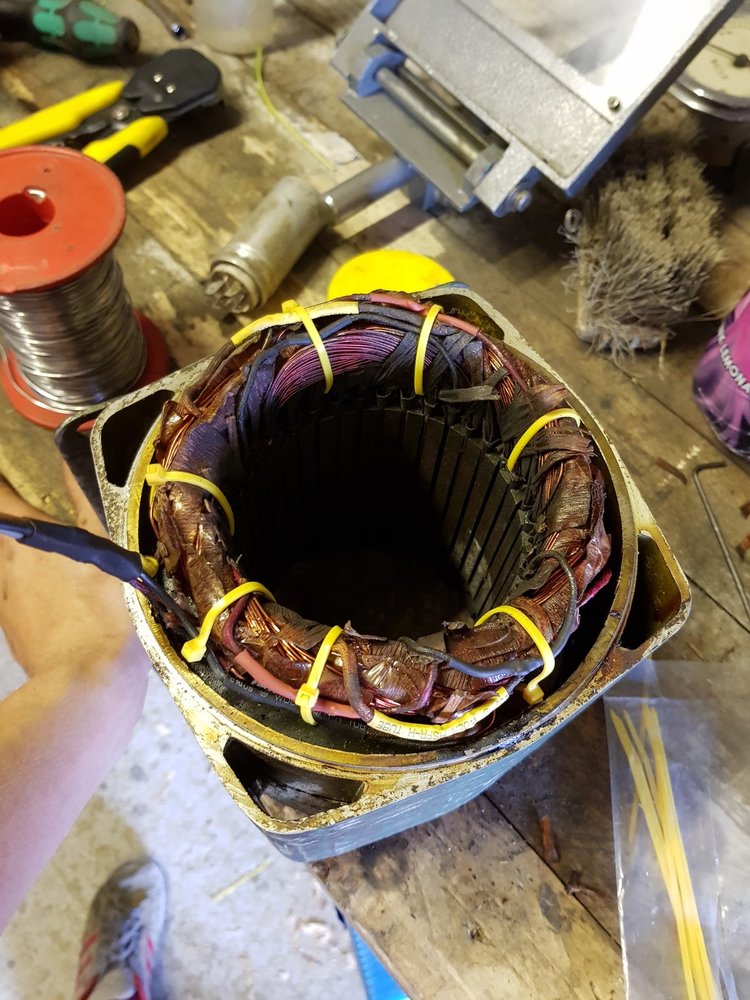

You have posted that before as I used it as inspiration and did my Raglan motor in the same fashionI'll have to get myself some of that winding varnish, last one I did I used heat shrink and tie wraps, pretty sure the one on my drill is tied down with butcher's string.

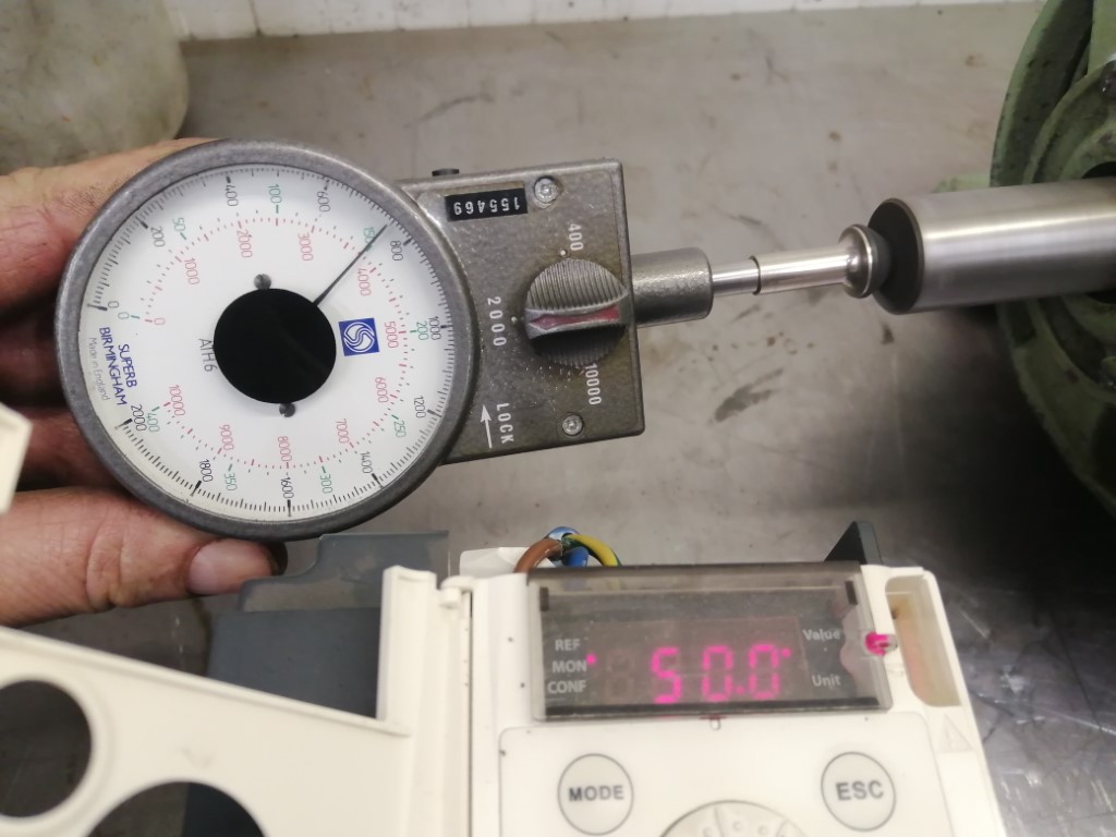

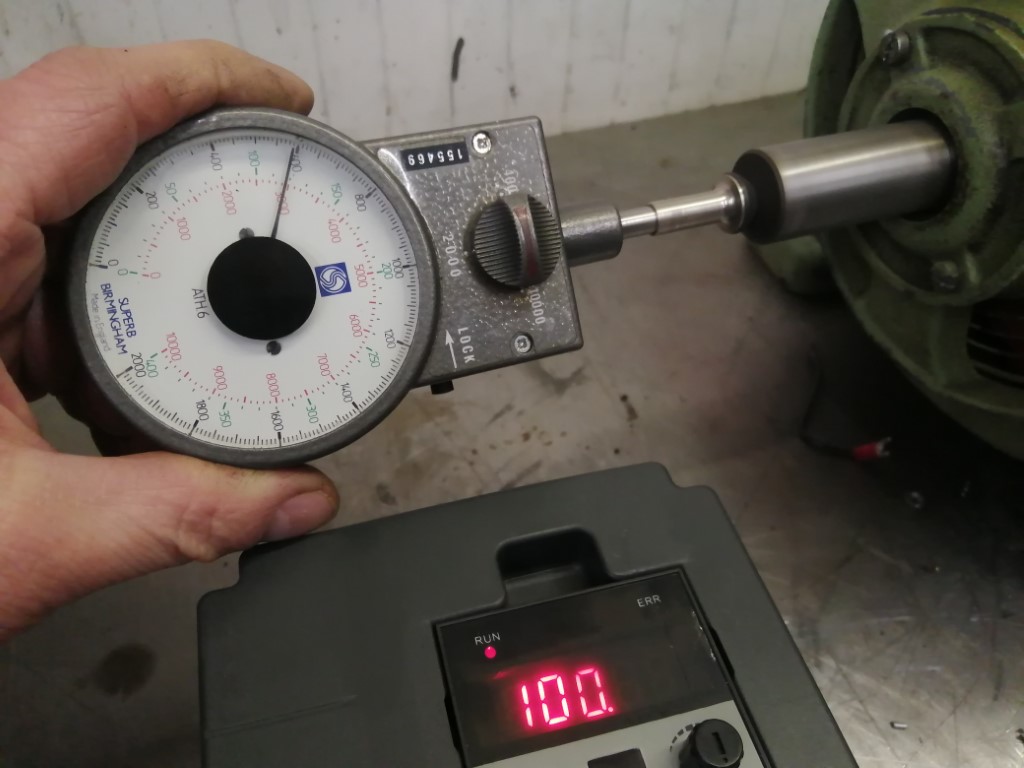

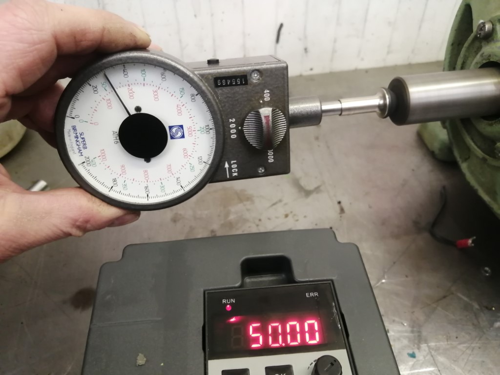

Dude let me take it round to DaveWell, the motor is built and hooked up to the VFD and it's running great. However, this has not been a success. It's gone wrong in a way I never would have expected:
At 50hz the motor is running at exactly half speed. I've checked the parameters and they seem to be pretty spot-on so the only thing I can think of is that hooking the windings up in parallel has converted this 4-pole motor into an 8-pole motor. either that or something else is going on which is completely beyond my ken.
I've now reached not only the end of my knowledge but also the end of my resolve with this so the motor is going for scrap and I'm fitting a new one. As a matter of fact I'm giving serious consideration to pulling the very nice NOS Siemens motor from my HLV and fit that and the new WEG vfd into my mill. I can then fit one of my two spare 1.5KW vfd's into the Hardinge and get a 2HP motor for it which is still bigger than the original so it won't suffer a lack of power. I#ll give all that some more thought over the weekend.
Not yet kimosabiDude let me take it round to Dave
That would only affect the speed (rpm) reading - the hz would be the same no matter what motor pole. I’ll have a look through the software and see if there’s anything obvious.The vfd is probably set to 8 pole
No probs - I think It’s called Spd or something(??) - I’m not in front of pc at mo but will have a scout through a bit later. Even if you don’t use the software I find it useful to go through as stuff is grouped logically.Thanks Dale.
I can't even find a parameter to set the pole count and doing a erch through the PDF for the word 'pole' yields zero results :/
Yeah I did that last night.Have you tried resetting to 'factory defaults' ?
