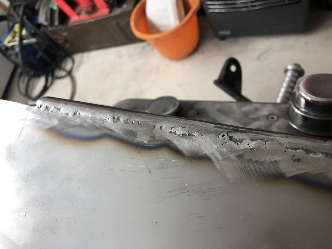

Probably red oxide first time round, until I work out what it fails MSVA on, then I'd like a spun alloy fuel tank.What colour fuel tank are you going for?
You can tint raptor and if sprayed at a higher pressure you can get it smoother than a roller finish

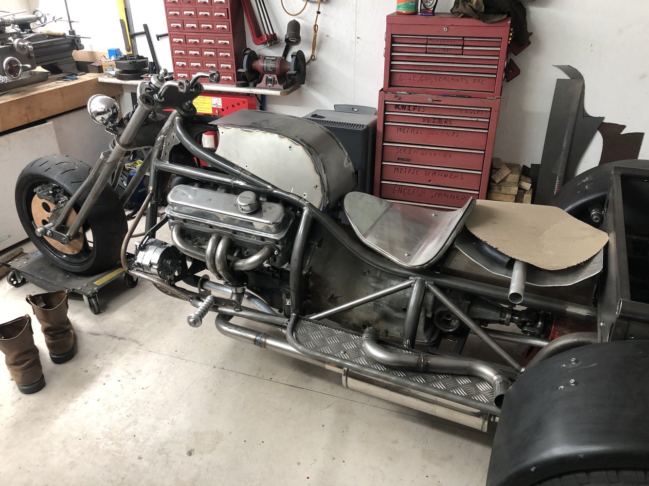

Just thinking about the mudguards

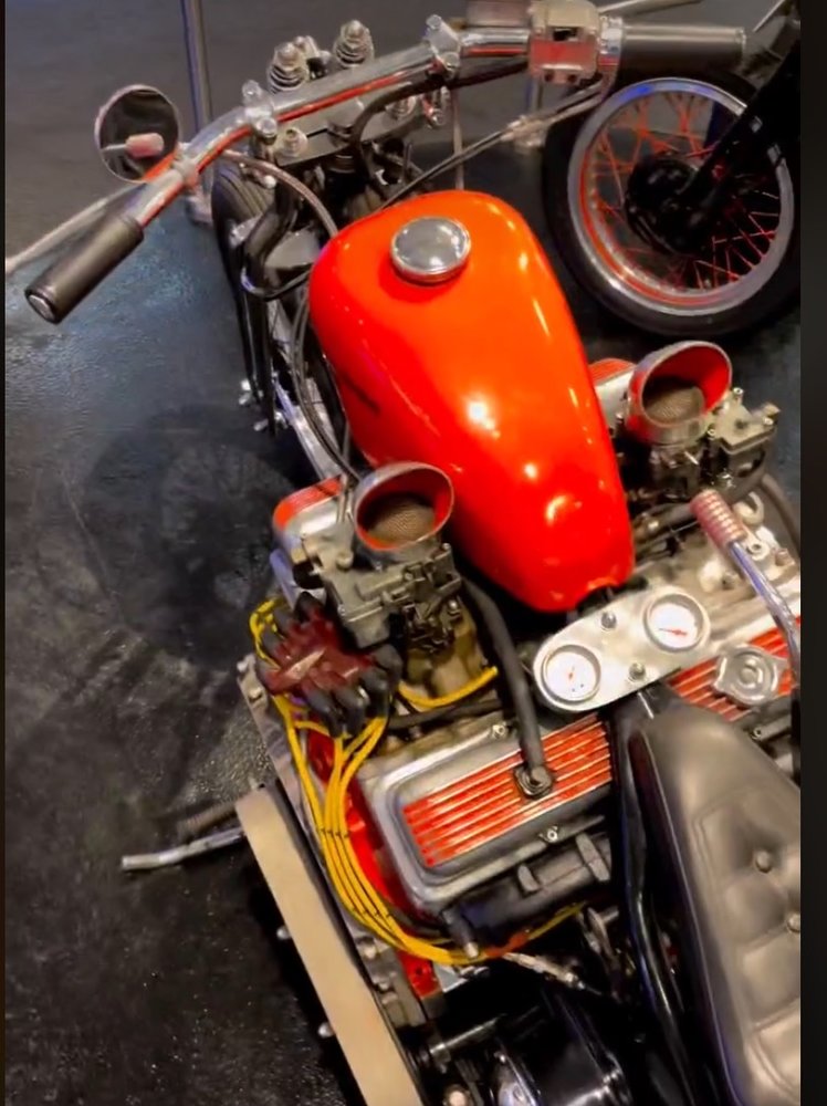

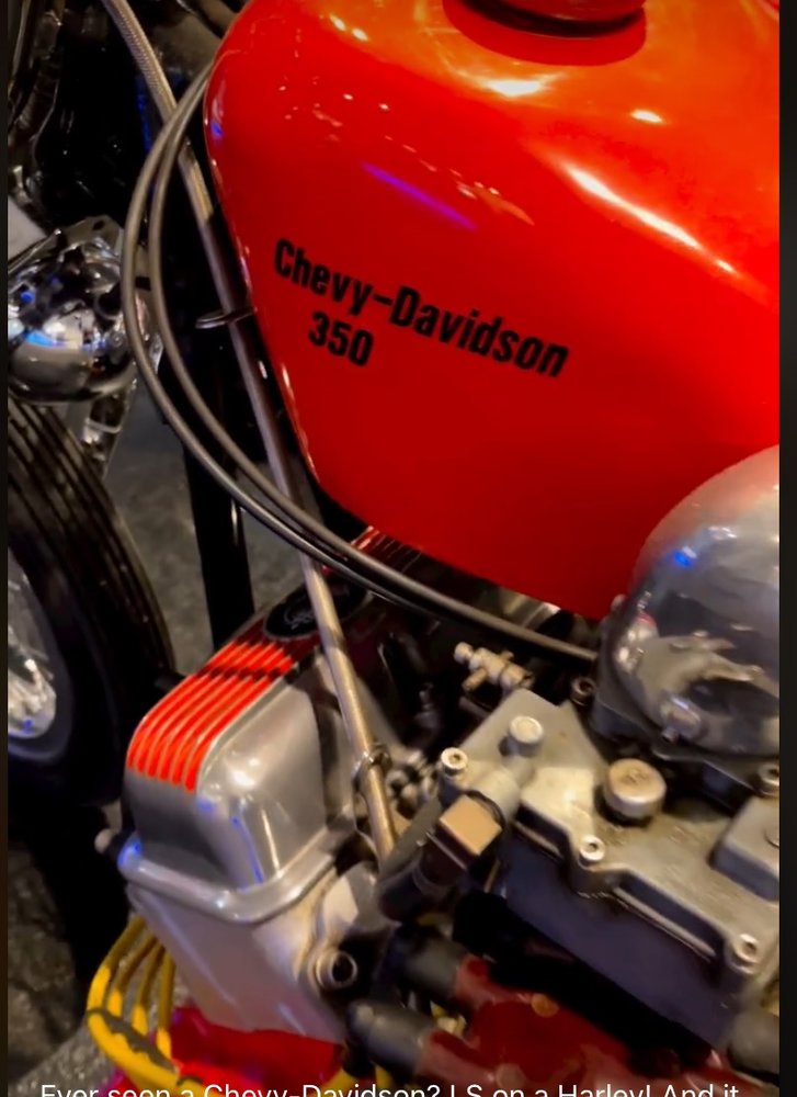

Seem that one before, I think, it's quite tidy. If it's the one I'm thinking of it runs through a stock Harley gearbox.
Now that's something, a hemi trike.It is a Harley box, it was built by Steve Coe in Florida. No radiator, he just runs it for a few minutes and then that's it. Too much money and time?
Here's his Hemi trike, I think the radiator is round the back on this one.
Yours is looking great @Morrisman

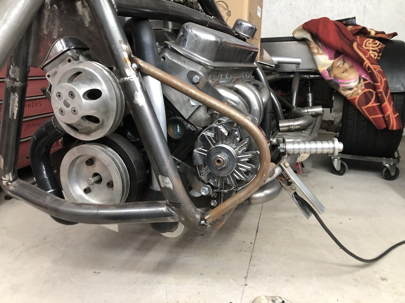

I thought that was drums only ? there again it's mounted much lower than conventional stuff ? Could you not do a diff mounted alternator drive or it packaged too tight ?

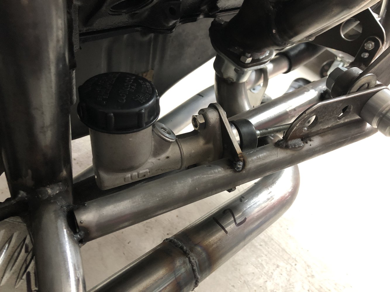

Drum brakes have springs on the shoes that will pull the slave cylinder fully in when not braking, discs don't. But discs use a lot more fluid so sometimes they need residual valves too.I wasn't aware there was any difference - a master cylinder was a master cylinder - a piston in a bore. Any I've used, or taken apart to repair have simply been that.
I have this T shirt from my last trike build. took more than two miles and didnt do it all the time. New wilwood cylinder sorted it.Caught me out when i fitted a master cylinder with a built in residual valve and discs all round, by the time i'd driven 2 miles the brakes were jammed on and didn't know why ... i do now ! It's mostly used on an all drum set up
So far not come across one with a valve built in.Drum brakes have springs on the shoes that will pull the slave cylinder fully in when not braking, discs don't. But discs use a lot more fluid so sometimes they need residual valves too.
