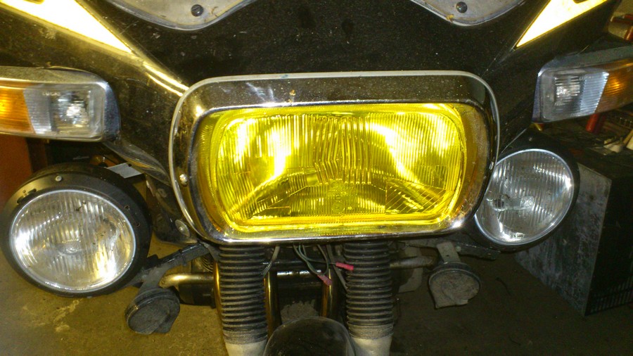

I just had a word with Sooze, she told me that it is a motorcycle type for just that reason.A motorcycle based trike is one with handle bar steering, but the weight also comes into it. You only need the double headlight if its more than 1700 wide.

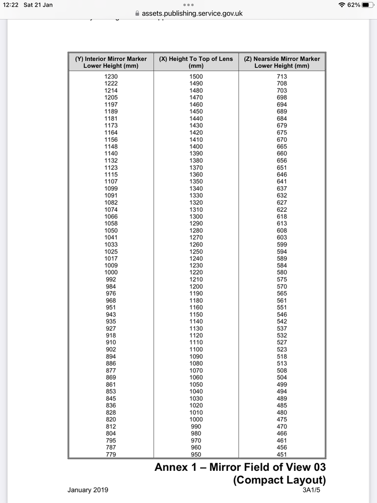

Very complex but none of it applies to your build.Mirrors, dead simple, make sure you can see behind you, for your own safety.
One of several pages of MSVA mirror regulations and parameters...
I know, I was just giving an example of the complexity it can go into.Very complex but none of it applies to your build.
Re-read my post, following that would show that section 3 (which you have quoted)does not apply and you can ignore it.
Section 2 is what you want and it's all pretty straight forward.
That complexity is explained clearly on the page previous.I know, I was just giving an example of the complexity it can go into.

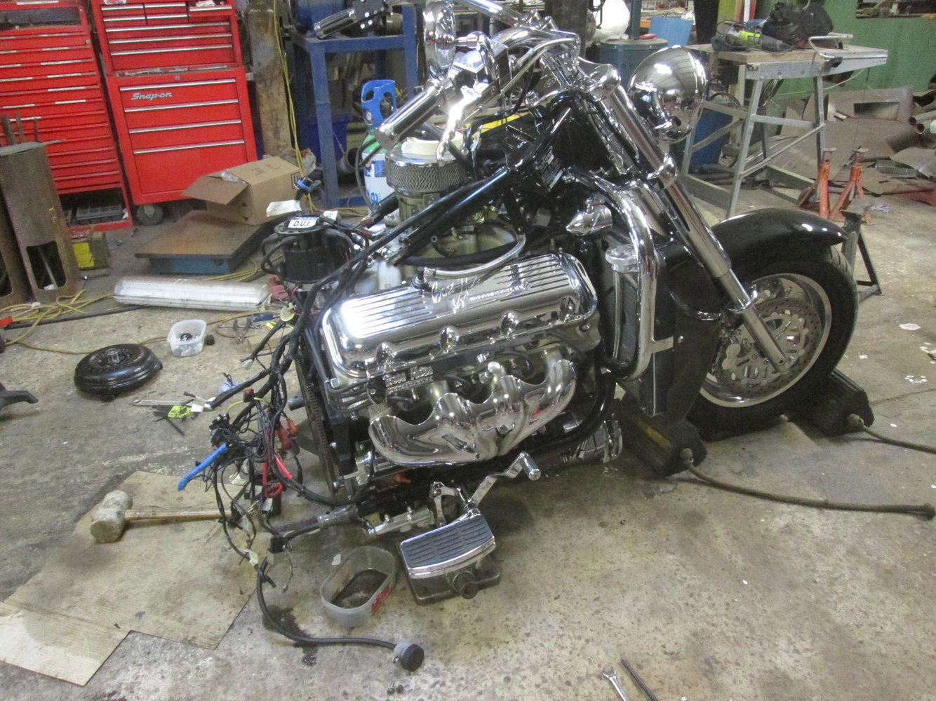

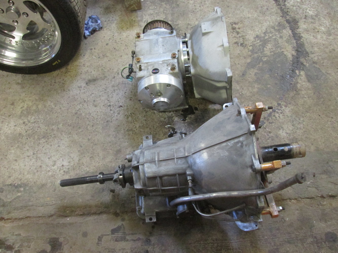

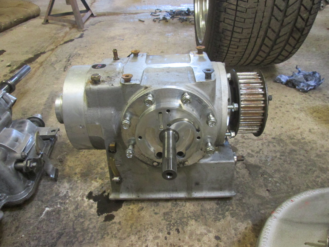

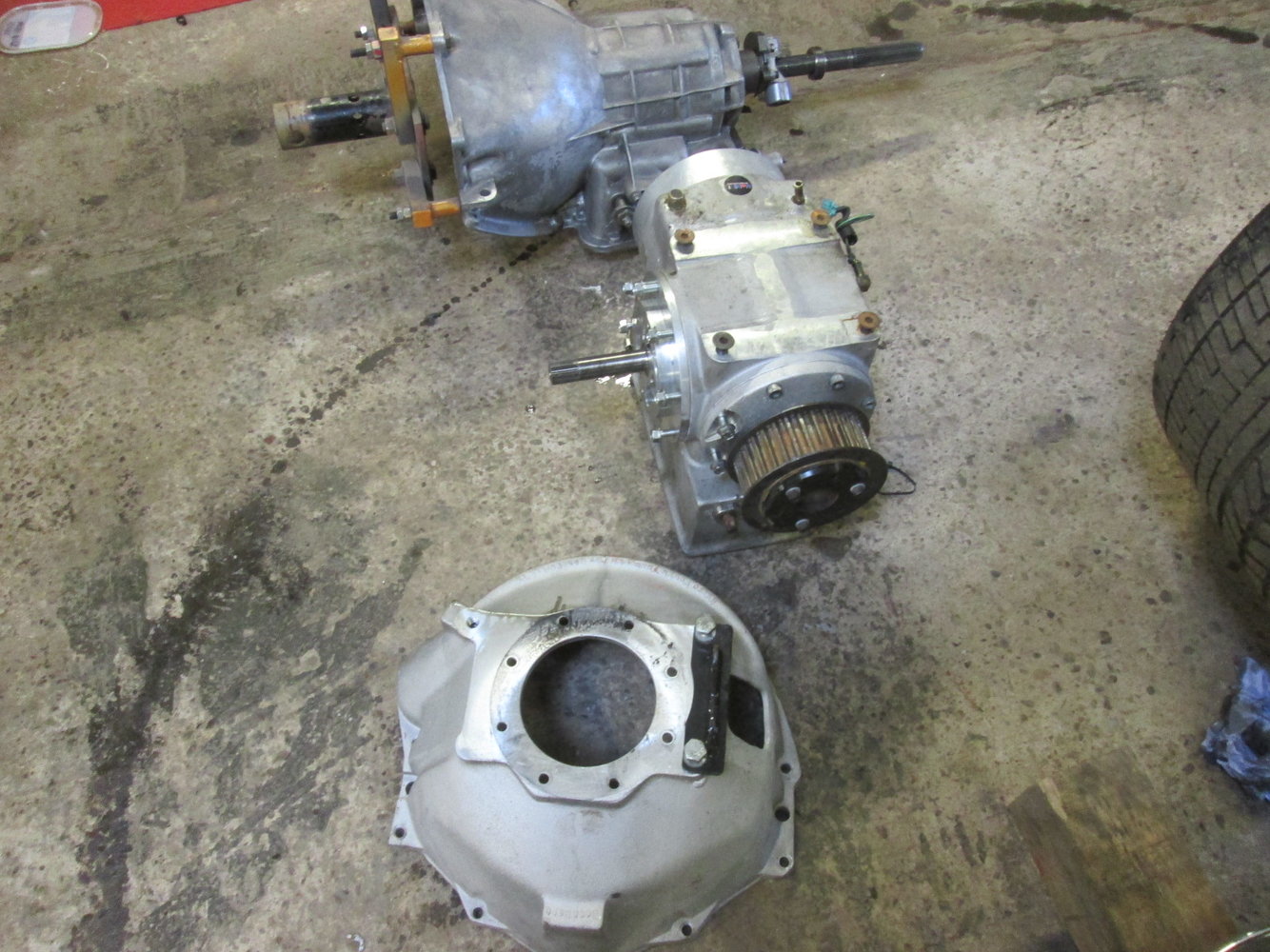

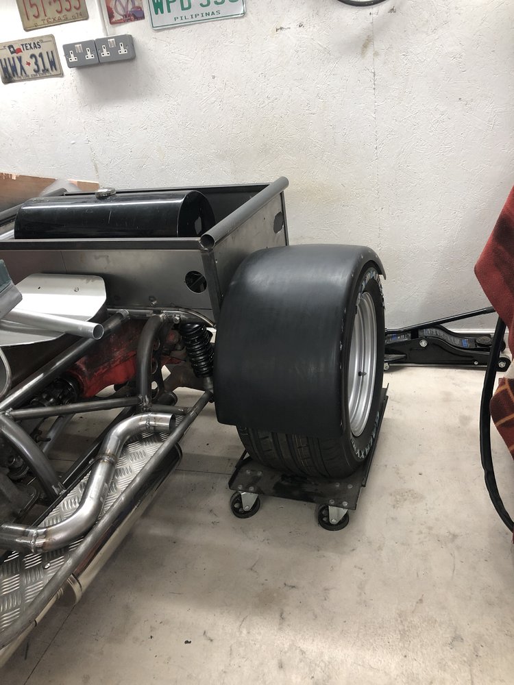

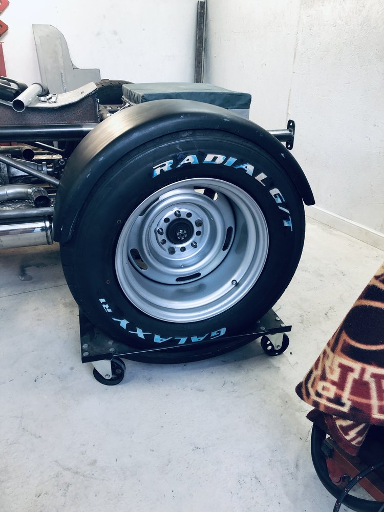

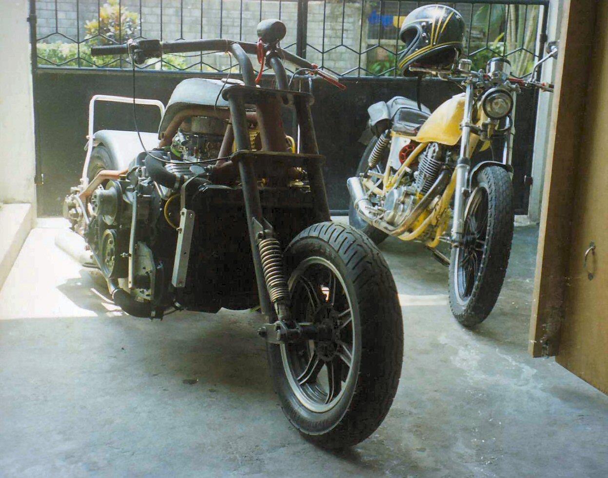

I'd have had the issue of connecting a belt drive to a differential then, but if I'd know it was available I'd have built a V8 bike instead.Just found this thread. Cool stuff..... if I had found it earlier I could have offered the planetary box from a Boss hoss to keep it short.....belt drive unit. Slipping clutches but still of use to someone building a Chevy based trike. I changed it to a powerglide 2 speed. Engine was a 502ci.View attachment 382170View attachment 382171View attachment 382172View attachment 382175
