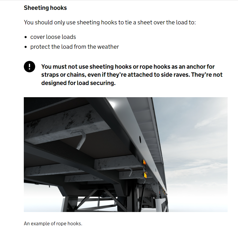

(1) Nothing I attach to the trailer will be formally testedRope hooks aren't any good for ratchets for three reasons.
1. They aren't load tested
2. If you put a rope on them the rope sits right near the corner meaning it would have to sheer the hook, if you attach a ratchet strap the load is applied further away from the corner increasing leverage and bending or snapping the hook.
3. To attach a ratchet strap to a rope hook people typically use the triangular hole.
I thought I had read that somewhere but wasn't sure, think is was a VOSA posting where they had pulled a trailer and they picked up that the load was secured via the rope hooks and it was a no-no
3 points if you get someone on a bad day as well. Or a day to meet the traffic commissioner if you’re really luckyYes, its quite a big fine per strap. The offence is insecure load, not sure whether they award points for that. @Pete.

(3) I've never seen anyone do that. That's similar to saying never use rope for anything because you might not tie a proper knot. I'm not sure on the bending argument, it depends on the orientation of the hook and the load. Worst case would be one side of the strap hook tight into the corner, the side 20 or 30mm along the free leg.

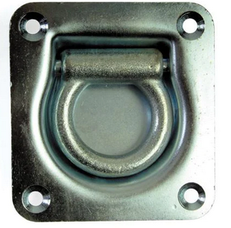

Having said that it might make sense to see if i can source and fit rings at the new locations. I'm not going to cut off snd replace the existing fittings but conceivably a bar could be added to close them.
Can anyone link to the sort of fitting I should be looking for?

These are exactly what I used on my trailer. Only thing I dislike about them is the crap that get`s stuck in there like leaves, mud etchave allays used recessed trailer lashing rings, made a template up for a router that cuts the hole. and use it to line up on the chassis rails, they are rated to 500kg each and have 8 on my trailer, happily towed 3 tone dumper all the way back from Wales using them.
should only take an afternoon to fit 8 and they cost around £5-6 each, and when not using them they store nicely out the way when carrying flat loads
